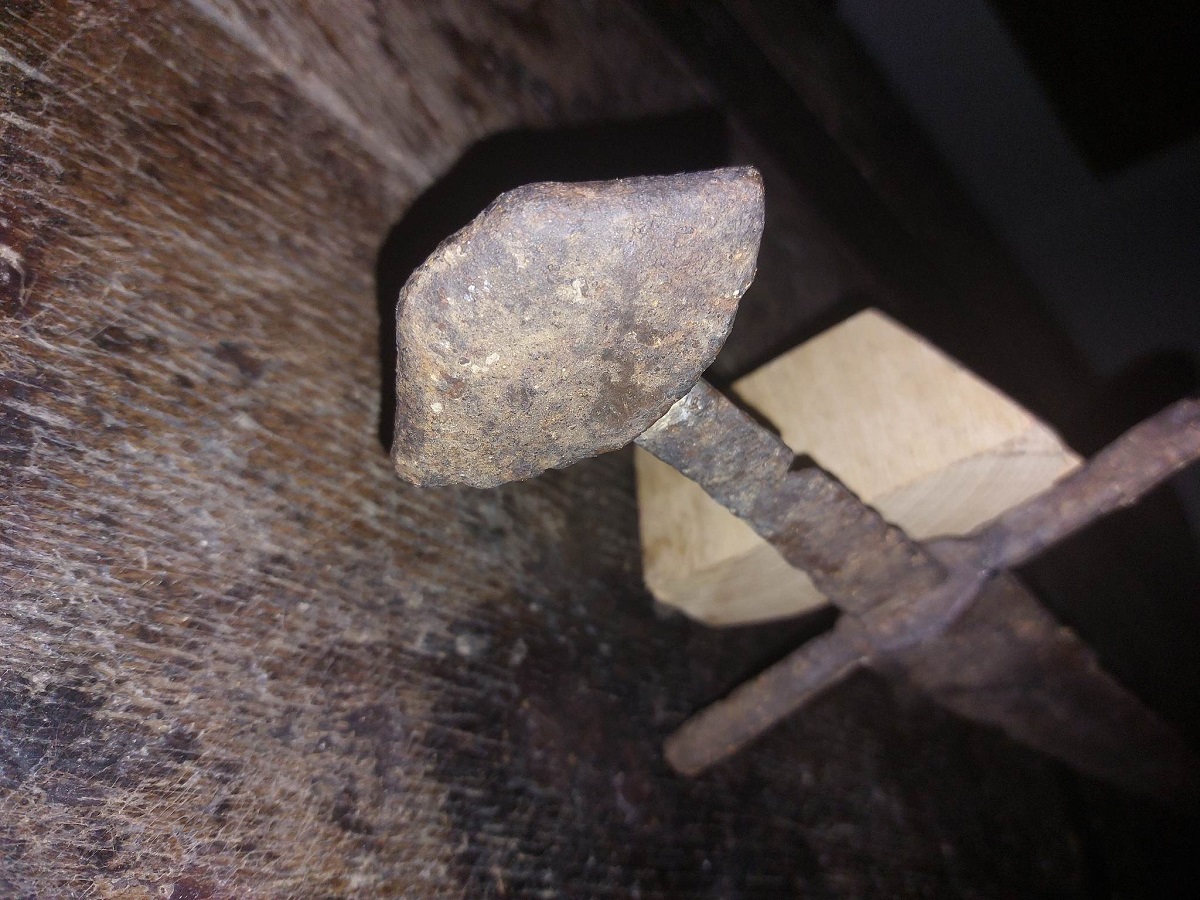

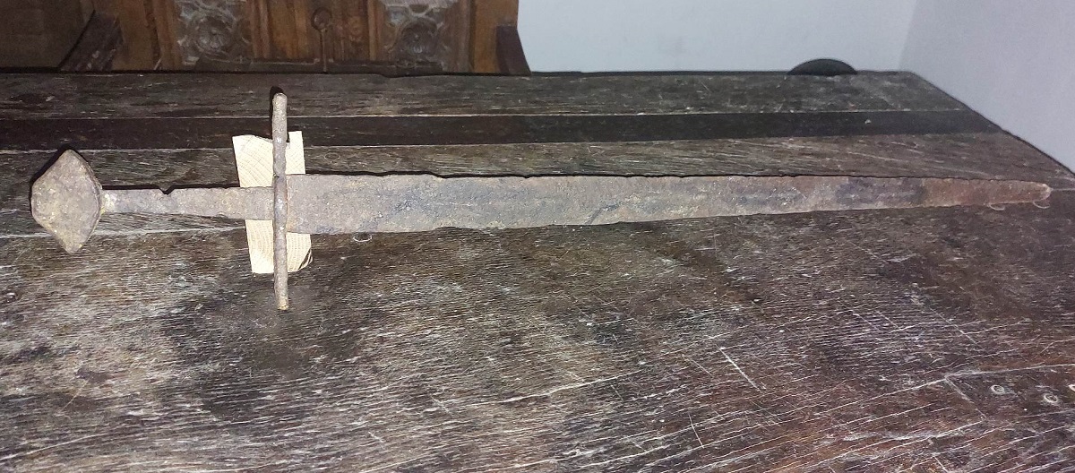

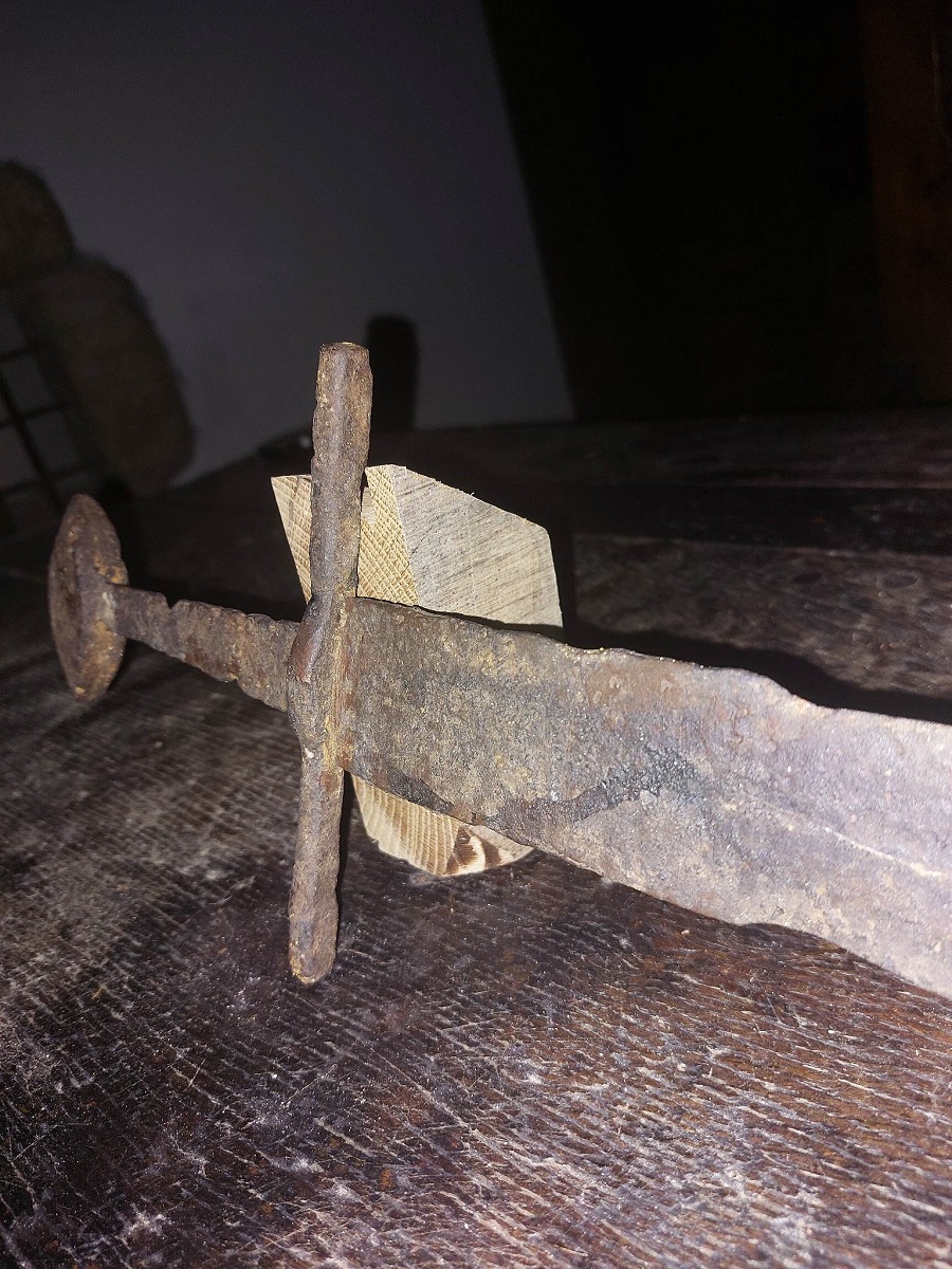

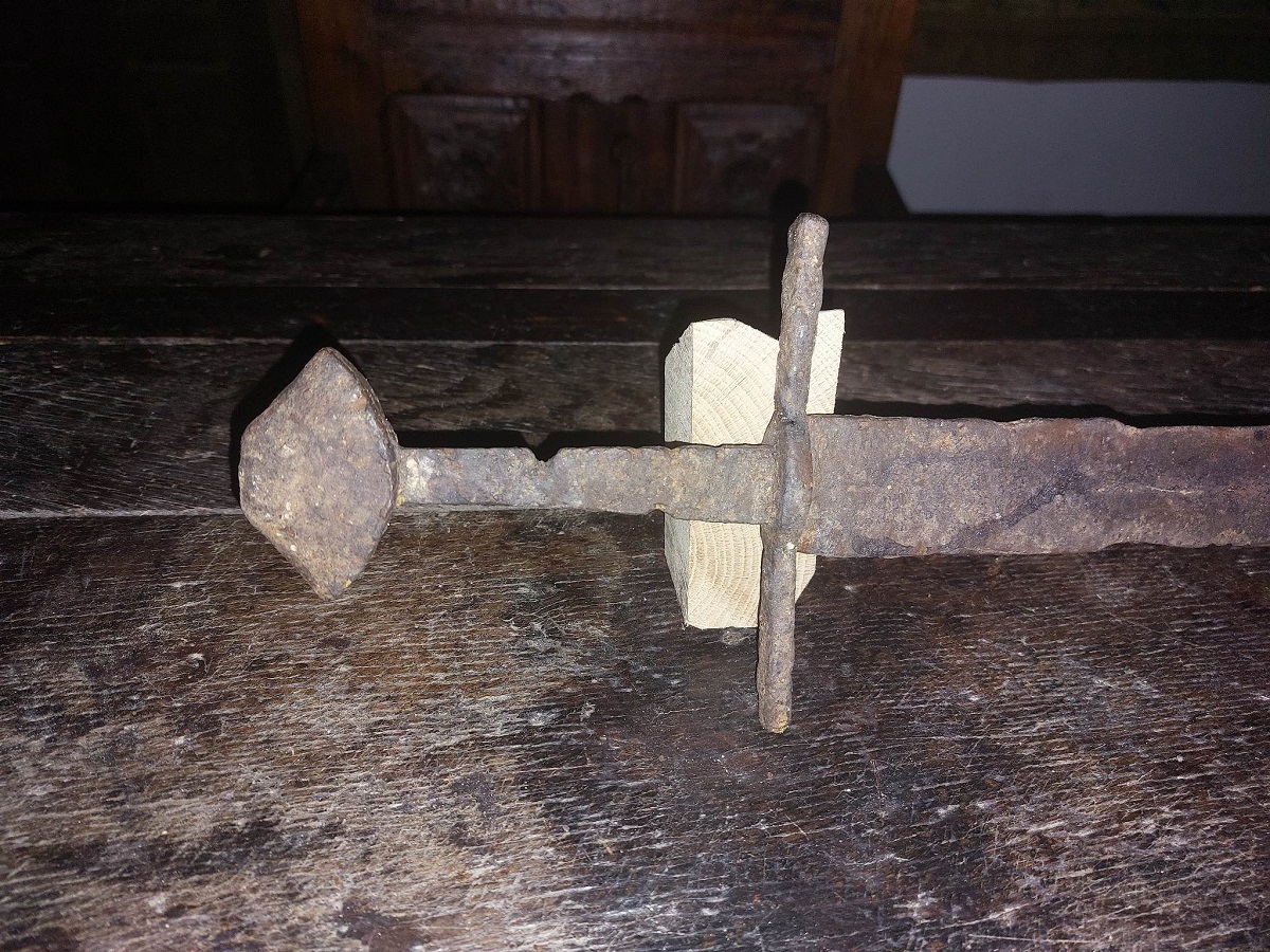

Ussually swords do not find their way into my collection but this one sparked my interest. Someone more knowledgeable told me it could be dated to the 1150-1250s. Found in the Donauknie.
Total length is 90 cm
Blade is 74,5 cm
Pommel is 41 by 70mm
Guard is 153mm
Blade is 46mm in width

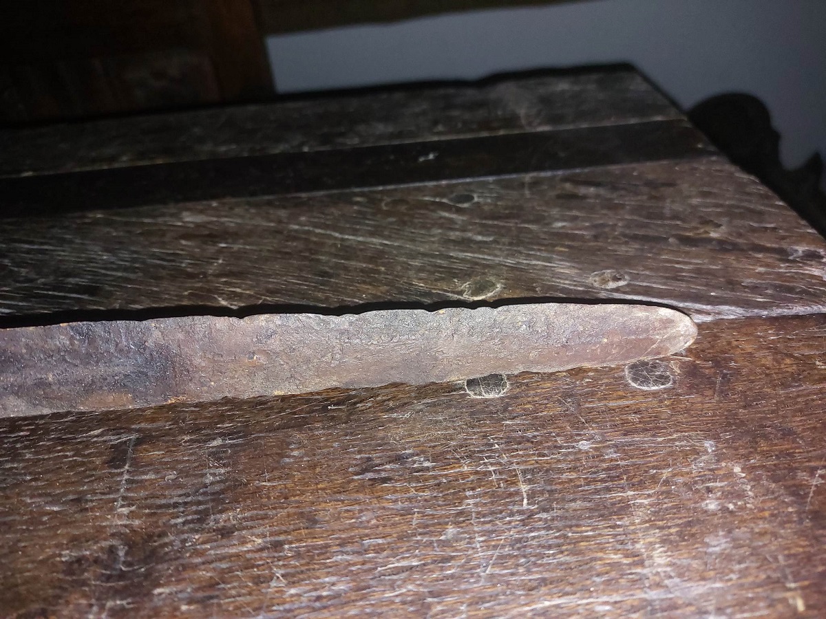

Single fuller runs up to 57cm on the blade
Curious to know more

Thank you Jim for your reply and exictement in investigating with us
The Donauknie is a bend in the river within the region of Budapest. This used to be a strategic point in the medieval times due to the many river connections to other regions/countries. The English term would be "Danube Bend".
If i were to guess, it is a Oakshot type XII due to the tapered blade form and long fuller.
Personally i don own any reference books but a friend was so kind to show me these sources for the pommel shape. It would date the sword to 1150 up to 1250 (?)

I would agree on the XXII classification,
Oakeshott (1960, p.202) notes, "...after 1100, swords were alike-though in infinite variety".
Still efforts are made at designating some sort of categorical designations.
On p.206, Oakeshott notes on of these type XII c.1265 to a figure who was a benefactor of Naumburg Cathedral with a 'peaked' type pommel of similar form and notes further that nearly identical hilt found in Hungary.
It is also mentioned that this type (XII) are noted in good number in the Maciejowski Bible of c. 1250 (now held in Pierpont-Morgan library in N.Y.).
The cross is apparently not really a viable element of identification, but the blade and pommels seem most tenable.
This pommel and blade seem to best align with German war swords of this period 12th-13th c. and the pommel (Oakeshott type E p.224; Geibig 1991, type #19) noting probable German pref.).
It seems that swords in these river or lake finds, as typically not near bridges etc. suggest, according to Oakeshott, to have been result of the ritual type cases (as in Arthurian legend, 'Lady in the Lake' ) and were apparently thrown in as a kind of offering or invocation. It would be interesting to look more into the intents and meanings of these kinds of 'offerings'.
Very much looking forward to the input from those here well versed in these areas of arms study.

Thank you for sharing this interesting find!
In my opinion, the pommel can be classified as Oakeshott's sub-type E1, a late variant of the old brazil-nut form, that can be seen in Naumburg as mentioned by Jim. The distribution of this type is mostly in Germany and Eastern Europe, a good reference on this is Aleksic's Swords of Southeastern Europe.
Many examples (especially in the East) can be dated to the 13th century, appearing sometimes with type XIII blades, sometimes with multiple fullers. Not the case here, but the grip seems proportionally quite long, which is more likely a later feature rather than earlier.
Here are two of the most similar examples I could find, with the flattened top and slightly concave sides, from Romania and Moravia.

Looks a bit like these:
http://clasate.cimec.ro/Detaliu.asp?...075BEB0E4B5AF4
http://clasate.cimec.ro/Detaliu.asp?...AFDA7495D1E5F1
