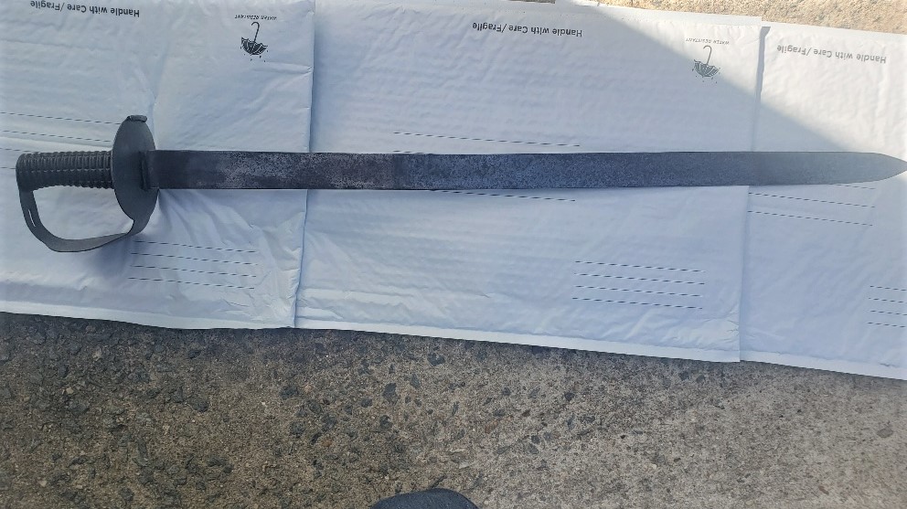

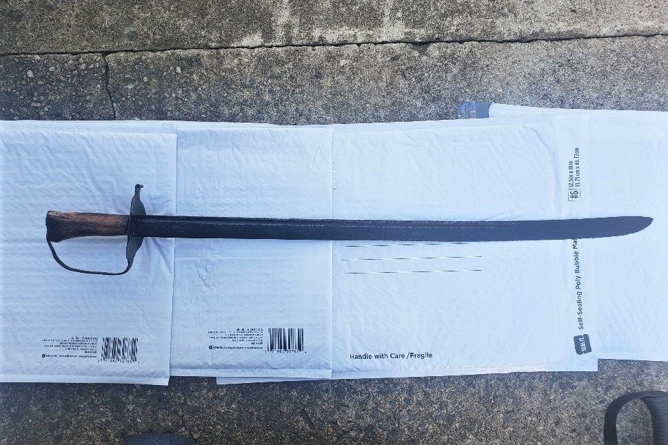

It has come to my attention that we've never discussed this pattern in much detail in the past and while no expert, I'd love to open the table for discussion on these interesting pieces.
First off, a little background for those seeking future information on these. The model 1804 British cutlass developed from the single disc knuckle guard pattern that predated it by fifty years or so (I'll display one shortly). Around the same time as the single disc came another pattern, so called the figure-of-eight pattern because it resembled the number 8 with it's double disc guard. Yet another pattern came from these early types, popping up around the time of the American Revolution and resembling the predecessor with the only exception being the grip. This pattern had a smooth iron core (see pic). Finally, after the beginning of the 19th century, we finally see our m1804!

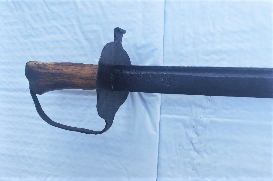

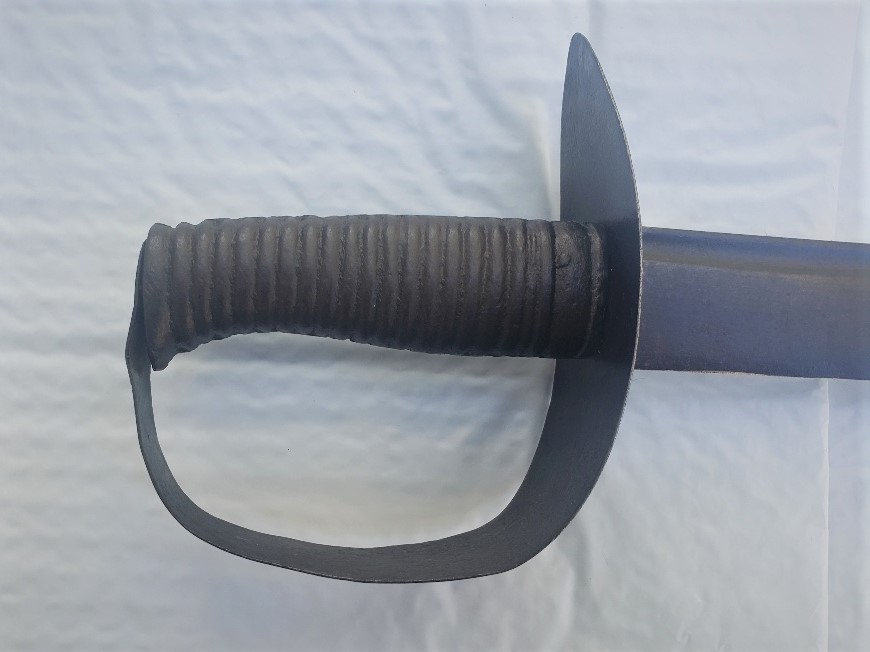

Pics of the mid-18th century single disc guard cutlass. Note the rolled metal quillon, an extention of the sheet-metal cut guard, which transitioned over to the later models. Also of note was that these single discs were used by both the Brits and Americans. This point is important when we look at the m1804 and how the American patterns swords of the time (the so-called Baltimore pattern, see Gilkerson's Boarders Away) copied the same patterns-

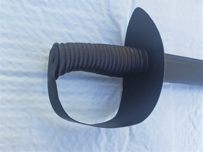

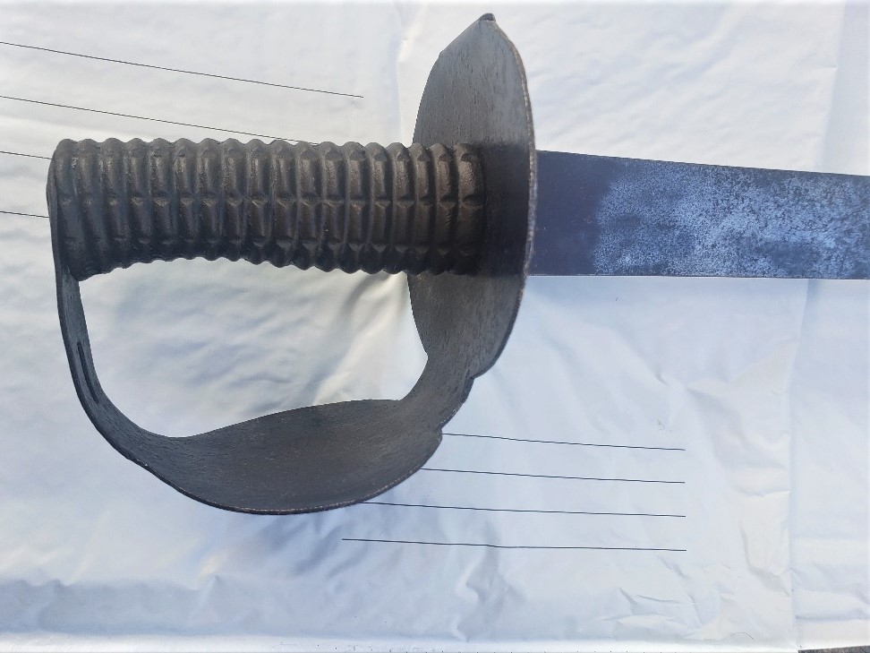

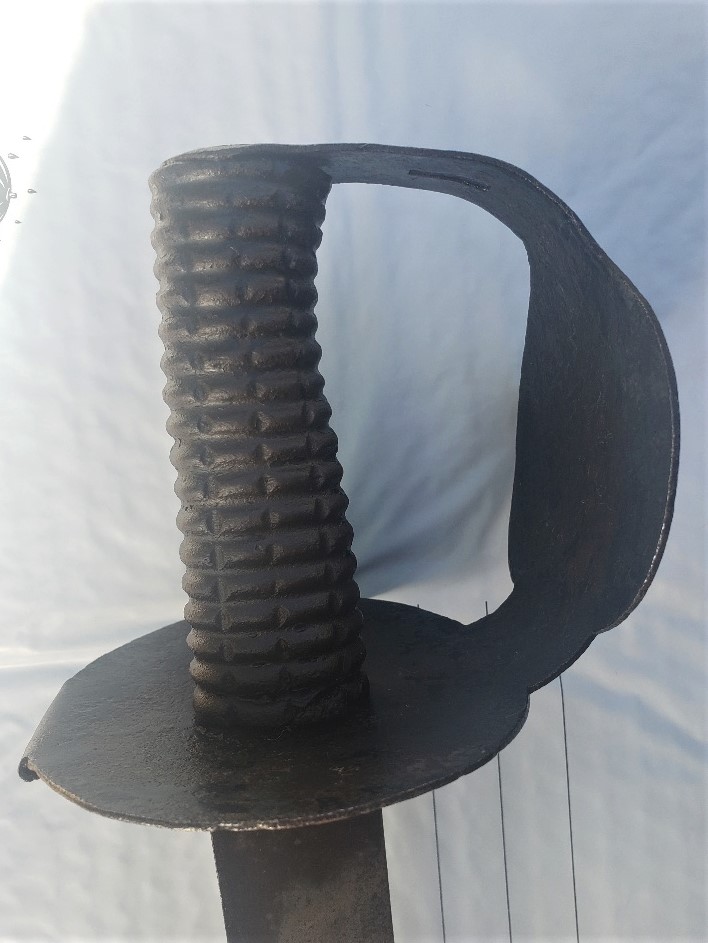

The m1804 cutlass retained the figure of eight double disc to the knuckle bow and guard, but unlike its predessors, it developed a ridged/grooved iron grip. This cutlass developed during the time of the Napoleonic Wars and was also used during the War of 1812 against the Americans. It was a simple, yet sturdy edged weapon perfect for combat at sea. The blade was heavy and straight, blunt except for towards the tip. The weight of a good swing could break bone with the dull edge or cleave a skull with the sharpened tip (this weapon inspired enough fear that the American forces invented their own 'boarding cap/helmet' of thick leather to prevent such attacks). The plain iron weapons were painted black on the hilts to prevent rust and were rolled out in barrels to dispense to the boarding parties/defenders during combat.

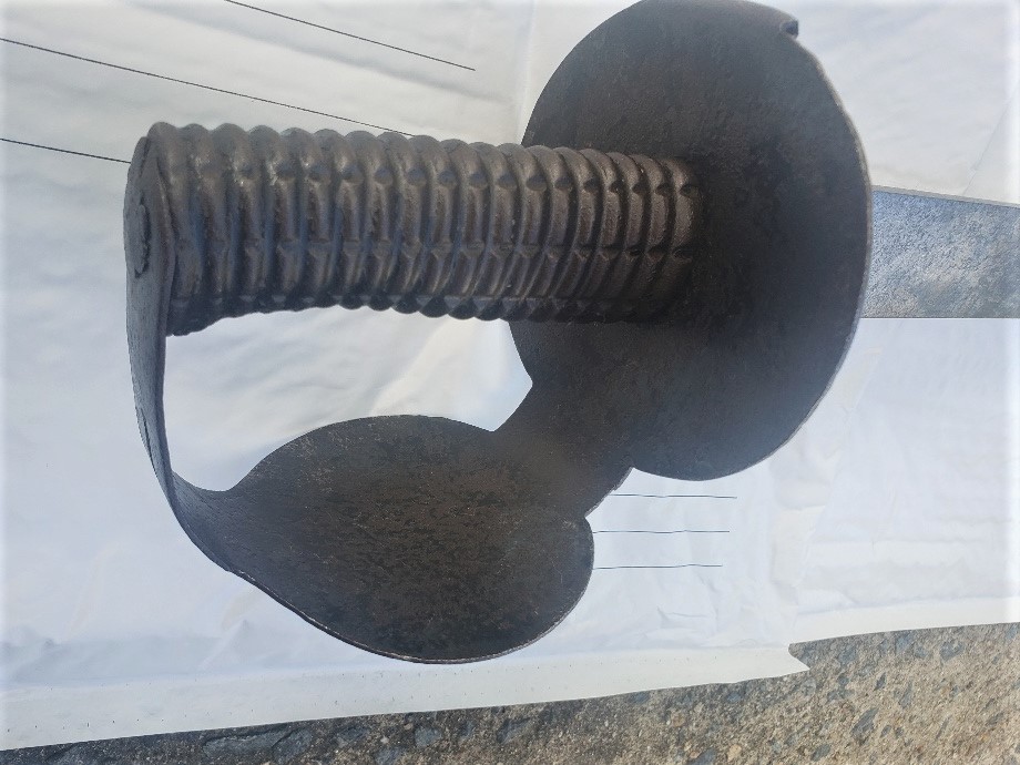

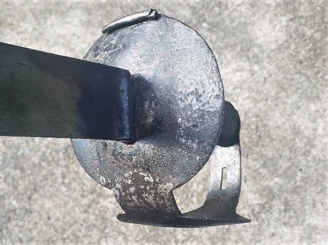

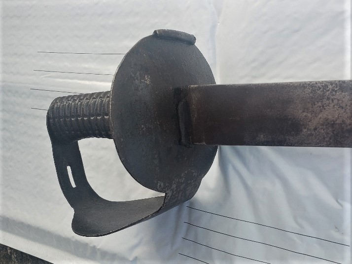

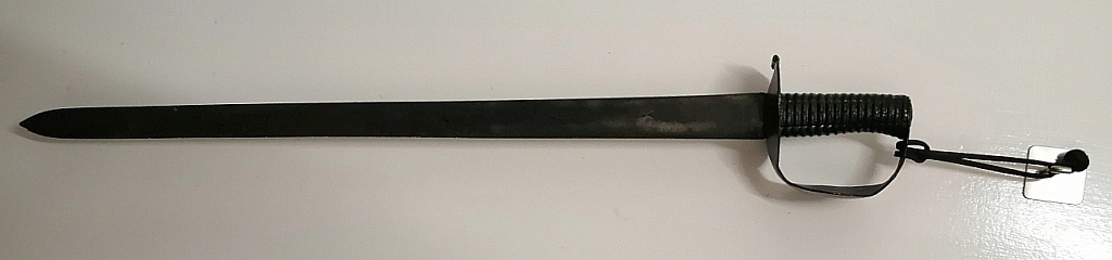

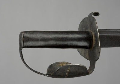

Note the peened tang at the pommel and the simple cut sheet guard that was simply folded over the grip. The small open slot near the pommel was for a leather lanyard that a sailor could wrap around his wrist to keep him from losing his grip during battle on a moving ship in hand-to-hand combat and often with bloody hands! The guard of the cutlass could likewise be used as a weapon to punch adversaries in the face!

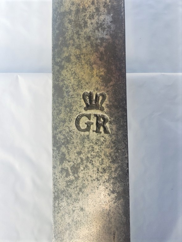

Markings on the m1804 vary. The classic fancy-scripted GR under a crown marking (for George Rex, Latin George III and IV for these pattern swords) are found on many of them. When i first purchased mine, the cutlass had block letter GR under crown, which both intrigued and concerned me. I had heard of spurious markings of this block letter type appearing on later swords of the m1804 pattern made by Schnitzler and Kirschbaum in Solingen after 1850. However, upon doing research, I soon came across information that many different cutlers and merhants were involved in supplying the British Navy and many of them used the exact marking (block letter GR with this specific crown) as found on my example-

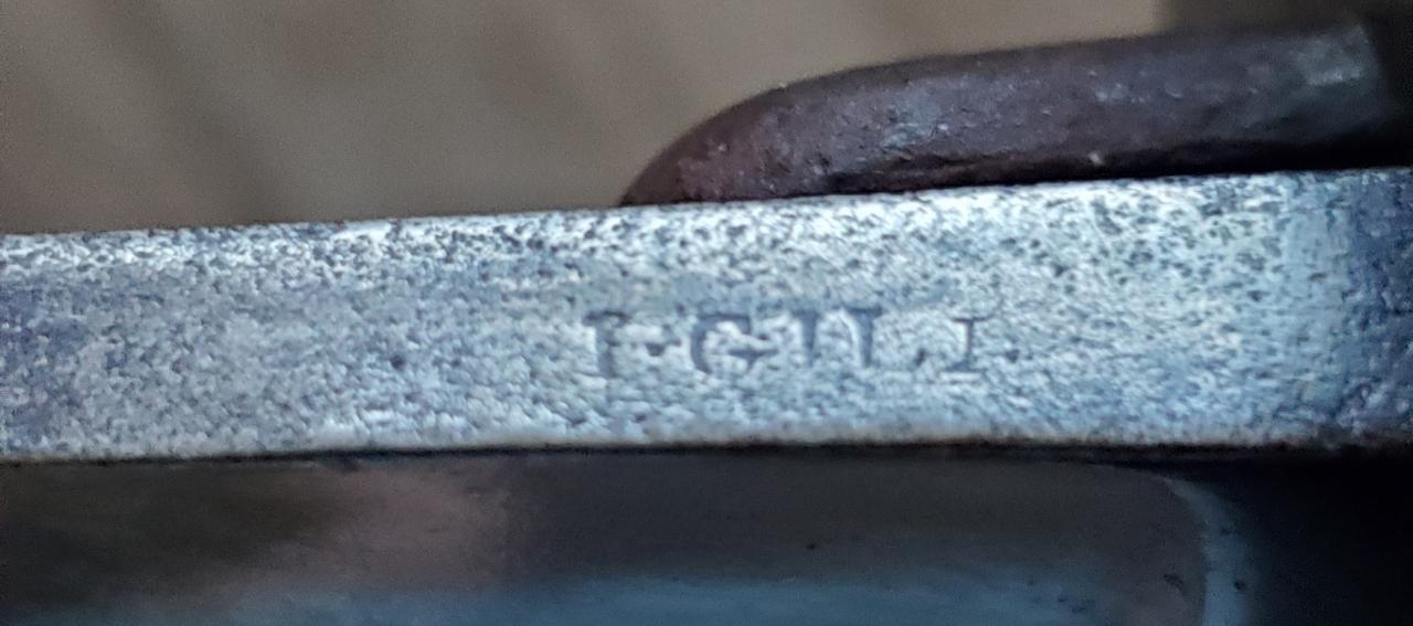

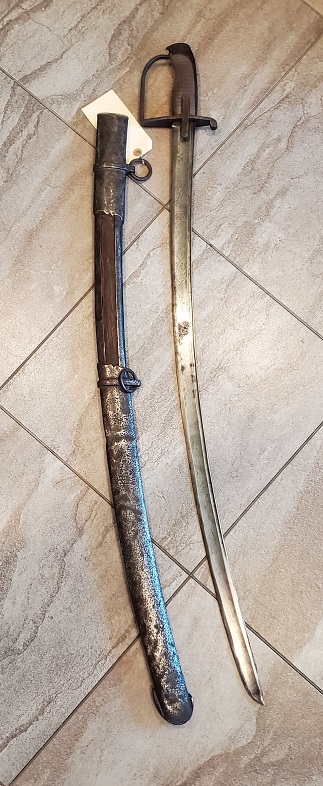

Not all m1804 pattern cutlass are stamped. This presents a puzzle, as the British marked everything government issue with either the GR or the broad arrow mark (for a great nautical book, see Heart of Oak:A Sailor's Life in Nelson's Navy by James McGuane. This book shows to what lengths the ordnance department stamped the broad arrow on everything from nails to glass panes to hard biscuit!). It can only be assumed that the unmarked 1804's were overstock and perhaps used for private purchase merchantmen and privateers of the British commerce fleet. As no new patterns were issued after 1814, perhaps these were 'late-comers' to the war effort and were sold to other nations? I don't believe they would have been issued to any of the other semi-naval departments (Revenue Cutters, Dock workers) for the exact reasons explained above.

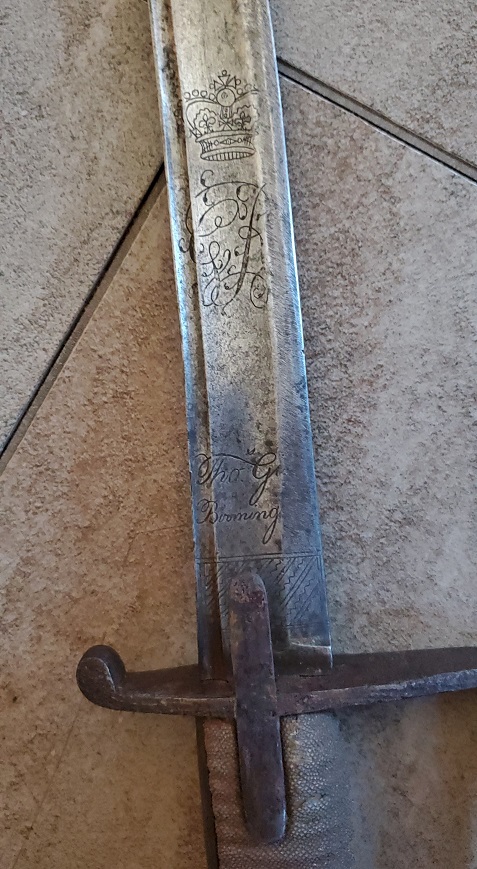

To show how popular the m1804 pattern was, here id a British private purchase sword which, although it has a sheet pattern guard, still retains the ribbed iron grip and straight bladed spear point of the discussed pattern. Note the weak punch mark. Is it a GR? WR? VR? Hard to tell-

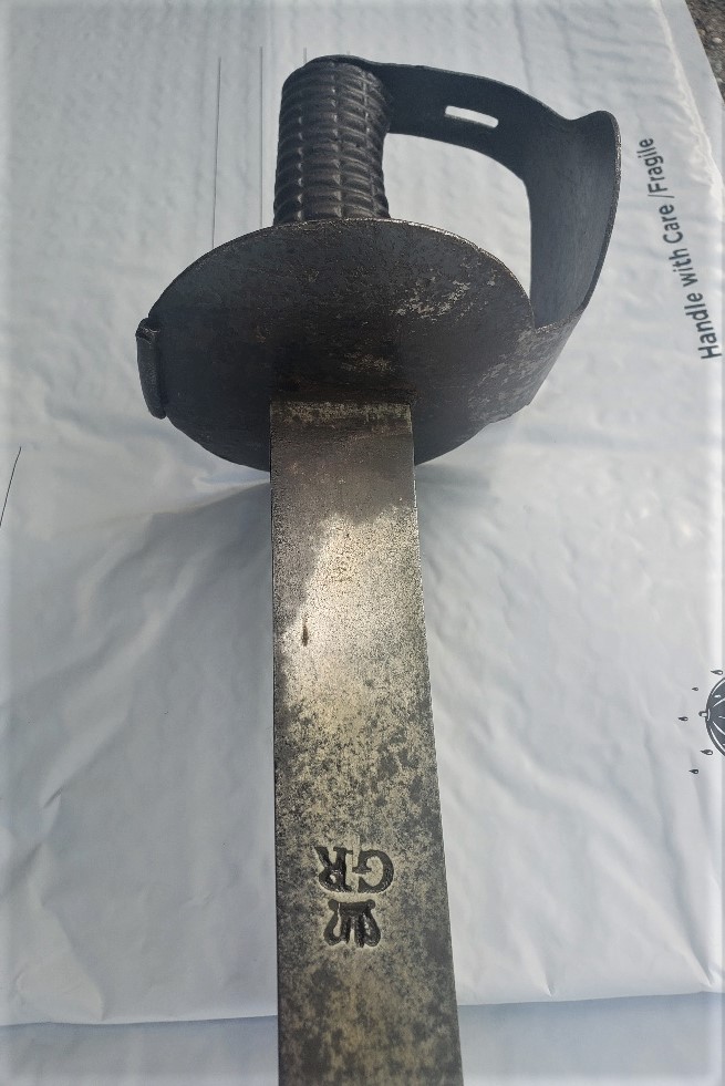

My 1804 cutlass, blade, serrated grip, cleaned of red primer smears and retaining its dark patina, and spectacle guard painted flat black with MOD spec paint. NO markings other than a double 'sold out of service' broad arrow of the BOE. It has a very faint maker's stamp on the spine ??????LEY. I accidentally found a period braided, ball end, cutlass knot, a bit stiff, which I used to hang it on for the picture.

Excellent example, Wayne! It seems that either the GR or the broad arrow were the preferred BOE marks. Thank you also for that information on the sword knot slot. I always felt it was rather redundant as well. These cutlass are so heavy, I think if one slipped from your fingers during a swing and you were tethered to the beast, you'd either break your wrist or be flung in the current dirrection it was headed! Could the partial name be Hadley? He was one of the suppliers, from what I understand.

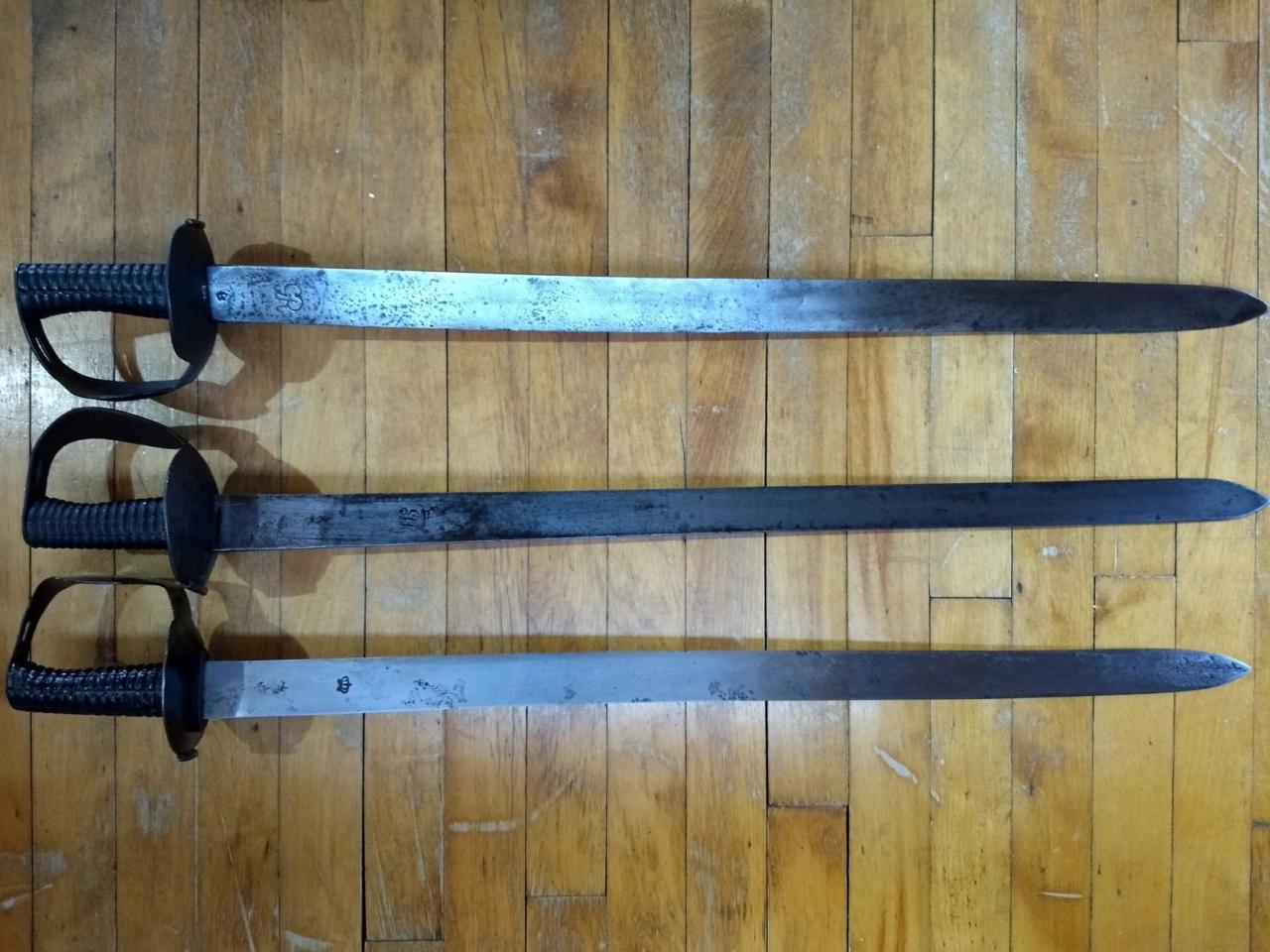

These are my three. The top one is a Harvey marked on the spine and the second Thomas Craven marked on the blade. The third is the Norwegian/Swedish almost exact copy - a little later 1810.
What always surprised me about the 1804 is that although it was heavier and longer than many other cutlasses it still feels good in the hand. Well balanced and 'light'.

Hello CC and great to hear from you! Thanks for posting these and it is great to see the subtle differenes to the pieces based on each maker. They are not all 'cookie cutter', as some would surmize. I had quite forgotten about the the Swedish varient of the m1804! Do we know how these were contracted out? As they still fell into the time period of Fighting Sail, did England purposely stock them to help protect Swedish shipping from Napoleonic privateers? I've seen the Swedish crown marking and, I believe, some with the king's initials? CR or ??? My memory is a little lax right now-

Jim, do you happen to have any photographs of the J. Gill stamp?
There is evidence that James Gill did continue as a cutler for a time after the passing of his father, however, it is believed that the blades he used were supplied by his brother, John. It would be great to see evidence that supports the possibility that John made his own blades as well.
Richard Dellar has a great chapter on the Gill family in his book on British Cavalry sabres.
Richard Dellar's book is outstanding!! as is the supplement added later.
This image is from a M1796 heavy cavalry disc hilt made in 1814, According to my understanding of Dellar's chapter, John was indeed the one making blades .
He passed in 1817, and his widow Elizabeth took over the business. It is unclear who made the blades at this point.
