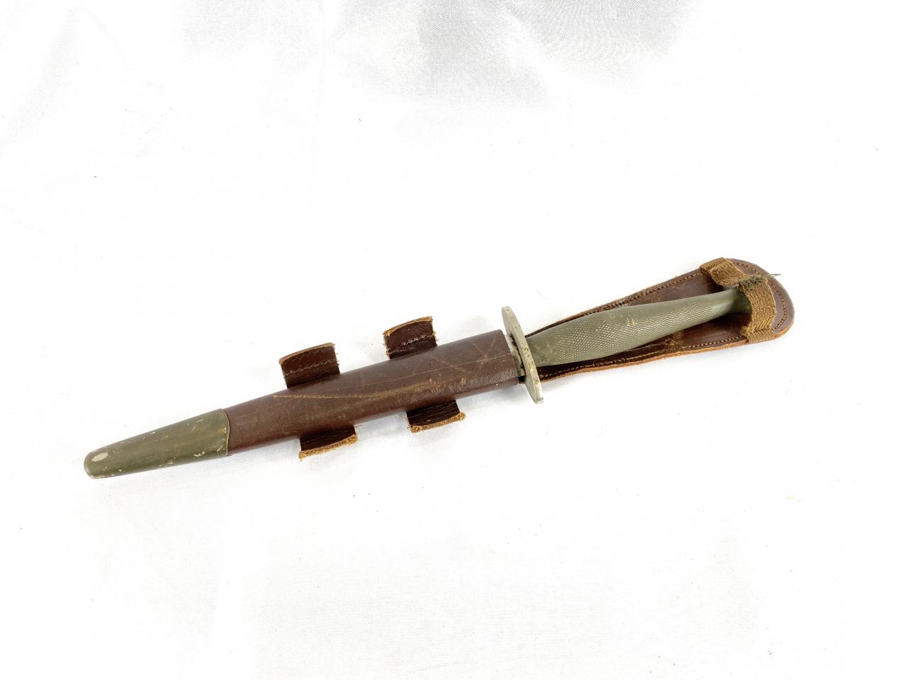

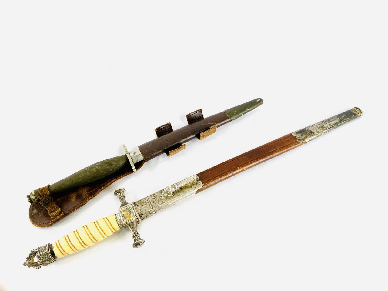

These recently sold in the UK for £2250 (with commission and taxes that's nearly £3000). Seems a lot to me. I don't want to start a discussion on whether they were worth it or not, but it would indicate to me that at least two persons saw value that I didn't. Can anyone enlighten me?

Hi Richard
The top one is a WWII commando Fairbairn–Sykes dagger second pattern, desirable, I am not up on prices but mine cost around xxxx pounds 15 years ago
This model has the chequered grip and not the more common ringed grip (3rd pattern) From the picture though it does not look to have an etched Wilkinson panel which was on the very early 2nd pattern knives.
The really valuable Fairbairn–Sykes dagger are the 1st pattern has a s shaped cross guard, these cost xxxx.
I have no idea on the bottom knife though.

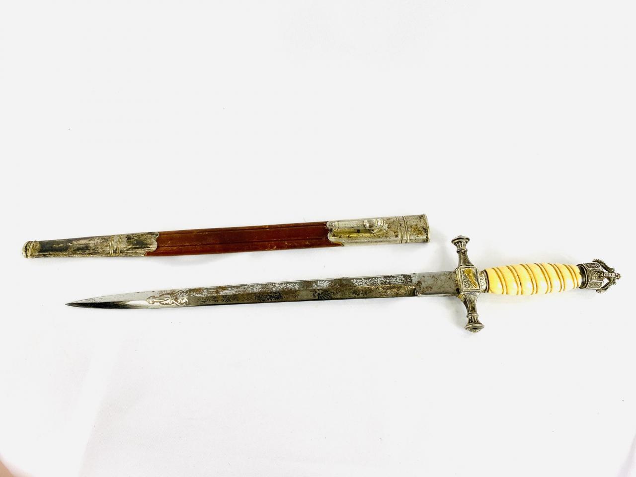

The other dagger is a (unusual?) German imperial navy cadet dagger.

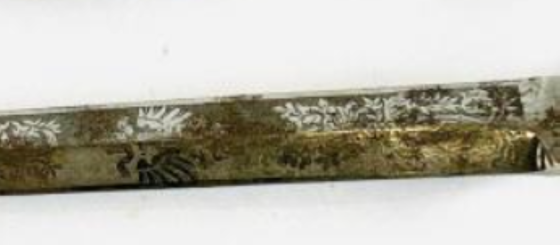

What is the second knife? Post 1900? Handle material? Wire wrap missing on handle. Pommel in shape of a crown. I can't make out what is depicted in the three panels showing on the eight-sided pommel. Hunters horn on guard? Do I see a double headed eagle in the blade etching? Austrian or Russian, I can't tell? The claws do not seem to be holding any objects.

the dagger with the ivory grip is a dagger for members of the German Imperial Automobil-Corps.
