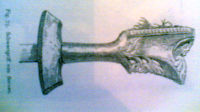

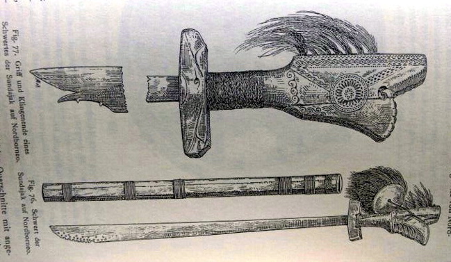

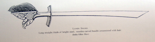

I had a look in two other books and found the following illustrations of Kampilans collected in North Borneo in the 19th C.
The first is from Ling Roth, The Natives of Sarawak and British North Borneo, published in 1896.
The two other illustrations are from W Hein, Indonesische Schwertgriffe, published in 1899.
Michael
PS Sorry about the picture quality on the Hein 1 but I only have my mobile phone camera available at the moment.

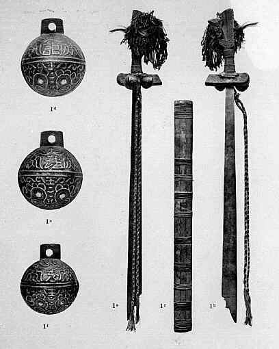

Here is another resembling Kampilan, collected in Sulawesi.

I think the pictures you show above from the two references clearly illustrate the similarity in style between Artzi's example and the well provenanced published examples. These shorter hilted forms do seem to be attributable, at least in part, to the N. Borneo muslim group (albeit perhaps translocated from Mindanao). Since we are talking basically of transplanted Moro people, the style of carving may be quite similar to Mindanao, but the shorter hilt seems distinctive to N. Borneo.
Ian.

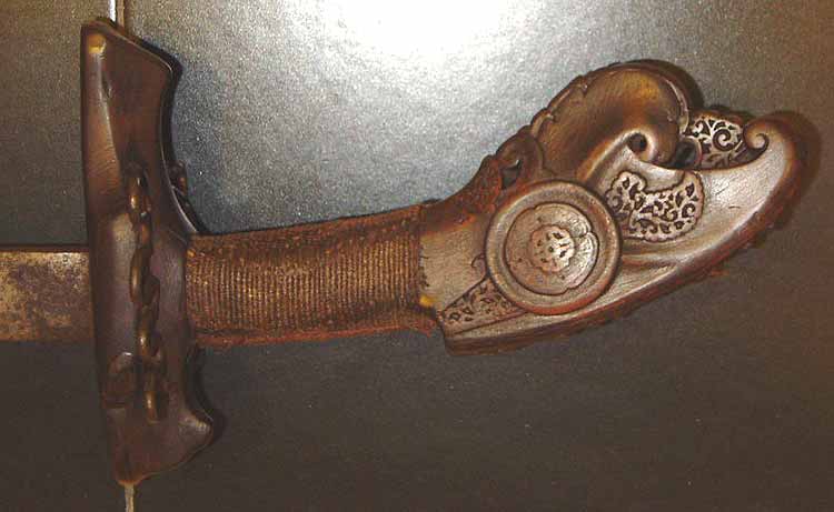

And then there is this one that Dan Wilke and I found in Manila. Where is this hilt from?
