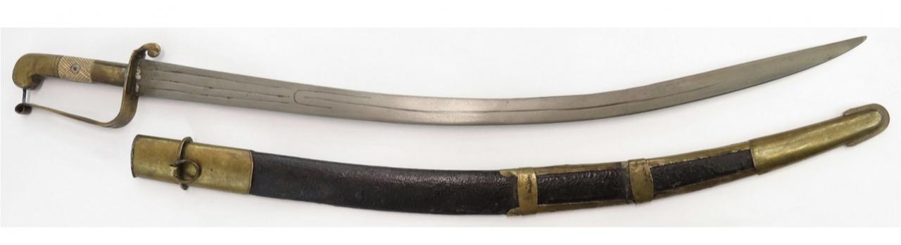

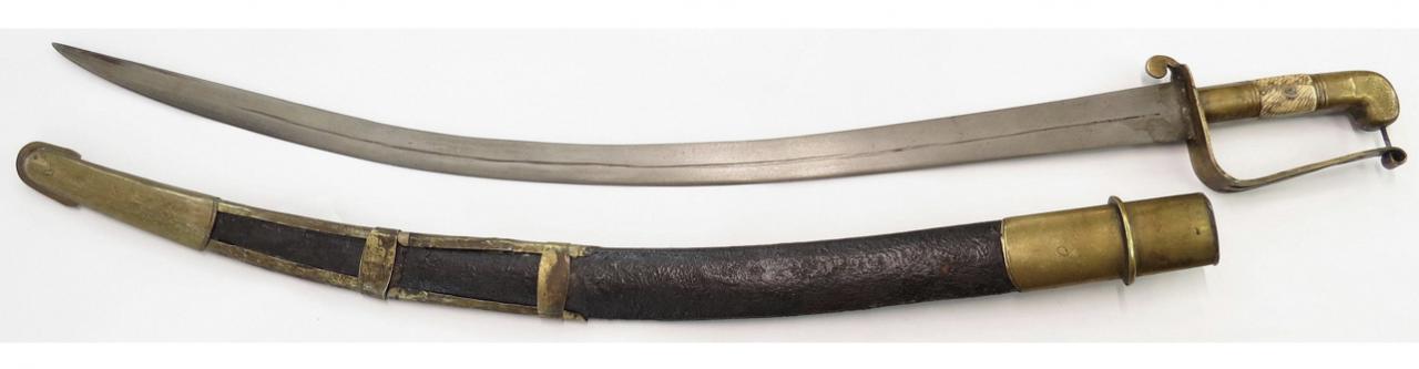

I recently obtained this Afghan Sabre at auction, the handle is quite similar to the “regulation Khyber knives” made in the late 19th century at Kabul, however this is full length Sabre, not a European style cutlass. Have any forum members seen this type of sword before?

Hello Sakalord364.
This curious saber is made as an imitation of "regulation Khyber knives". There was no "standard" for them. Everyone ordered the sample that he wanted to have. For example, in my collection there is a similar version of the "arbitrary saber imitating regulation Khyber knives" with wootz blade

Hi,
Do you think these were made in the official government factory in Kabul, or were these forged by private blacksmiths for their clients?

Judging by the wide variety of blade shapes of these sabers, they were made by private craftsmen. This, in my opinion, is also indicated by the fact that their blades were made both from ordinary steel and from wootz steel. I think that these were private orders from representatives of irregular units.

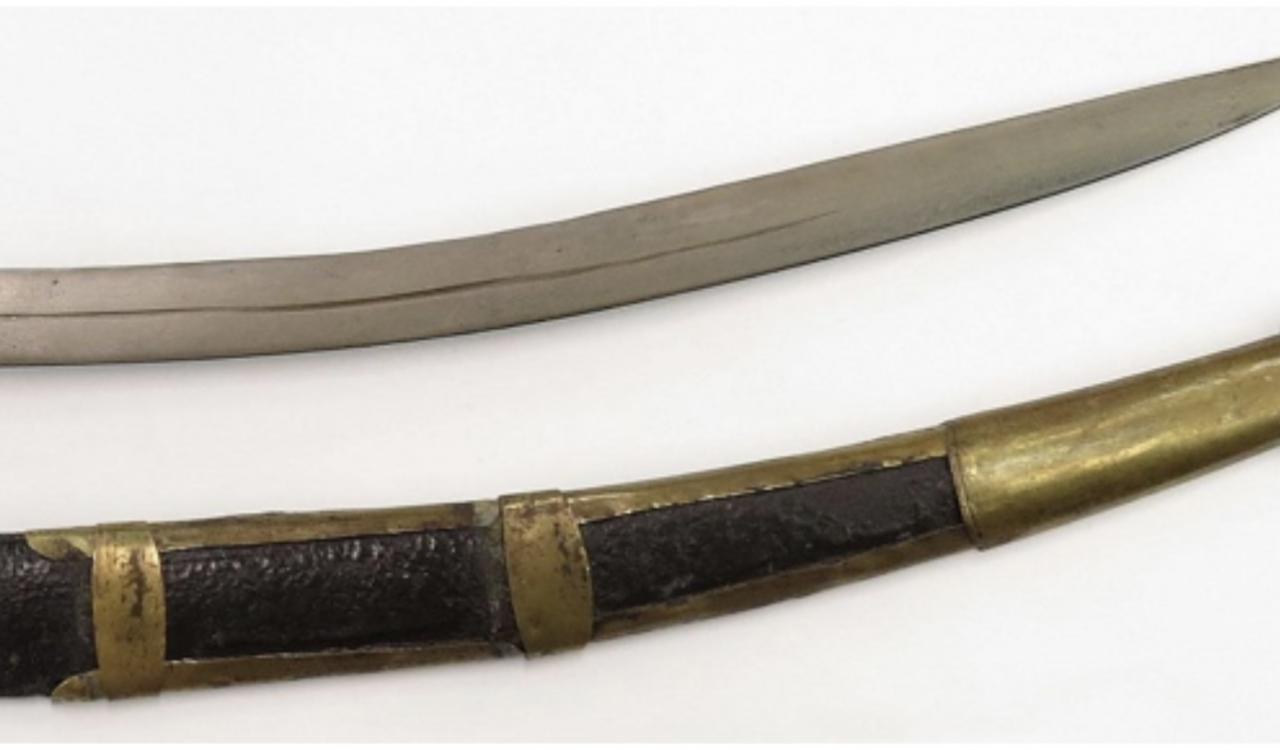

I am curious what these brass strips are, contemporary (or modern?) repair work to support the leather scabbard, or Some kind of decoration? It seems rather crude compared to the rest of the fittings
Sakalord364 is offline   Reply With Quote
Old 17th June 2022, 10:56 PM   #9
Lee
Lee's Avatar
Posts: 1,006
I think those could be later "purely practical" reinforcements for a scabbard that had split or had been cut through.

I had thought that some modern bazaar dealer who originally sold this sword installed those hasty brass repair strips on the scabbard, but it seems it was done at least a century ago correct?
Old 18th June 2022, 04:14 PM   #12
Posts: 10,872
That would be a good assumption ideally, but in the volatile tribal regions in Afghanistan, local artisans busily refurbish and repurpose weaponry constantly as they have for centuries. It is true that items that end up in the bazaars (i.e. Chicken Street) up to modern times reflect a lot of such innovation, but many may have actually been in use by tribesmen prior to arriving there.
As noted, these swords are not 'old' in arms collecting parlance as we are used to, but they were still using swords in warfare well into 20th century. These scabbards had wood inserts and would be subject to cracking etc. (mine has lost most of the already replaced leather) so even with newer leather cover, these bands probably were to secure the wood if damaged.
This example seems likely to be from the period around 3rd Afghan war (1919+) and probably refurbished any number of times over the years. With ethnographic weaponry, especially from these regions, it is more about the 'exotica' and turbulent history of these regions, the warriors and their arms, than age.
Though couldn’t the owner just commission a new scabbard instead of trying to repair it like this?
Old 22nd June 2022, 12:26 AM   #15

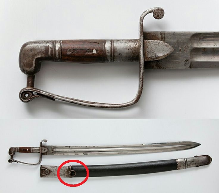

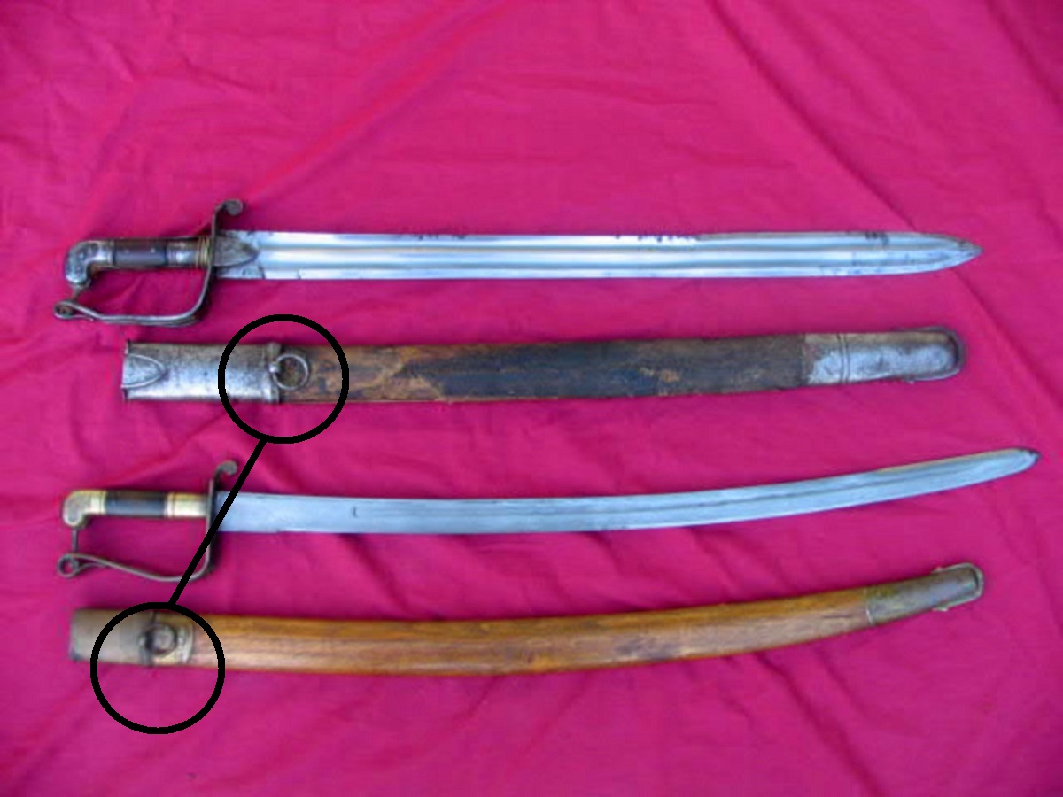

It's a good repair, perhaps even better than a new scabbard: wood and leather would be cut thru in a couple of years, but brass reinforcements will hold almost forever.
A significantly more interesting question is how was it carried? Where are its suspension rings?

It does have a lone suspension ring, similar to other European sabres of the period.
Though I have noticed that some Afghans pulwars do not have any suspension rings at all, which is odd because securing your sword properly is very important for the cavalry based warfare that Afghans specialized in. So I’m assuming these are all from the late 1800s when cavalry slowly started to become obsolete. Here you can see this warrior suspends his pulwar from a series of leather straps
Thank you very much for the photo. The photo once again confirms that your sabre is a certain imitation of “regulation Khyber knives”:
