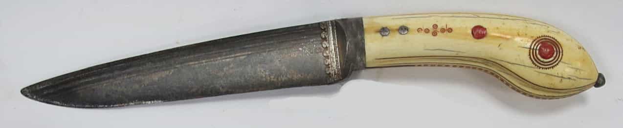

Anyone know where/when this knife came from?
Looks cool. 😉
I'm guessing India...

This looks like yet another of the always confusing Malawi 'Yao' knives.

Sorry, I still doubt the Yao origin!

I have to agree with Sajen.

I think it has been heavily cut down, does it have a T shaped back? I keep seeing Northern India with the bolster.
Definitely a worthy find.

Very good example! And I am with Sajen:Yao.

I DON'T think that it is Yao!
ROFL
I still think India.

Sorry, my bad.
I see why one would think it is Indian: too rich and those small decorative crenellations at the base of the handle. But I still think it is Yao. I just cannot recall anything similar from India, but pimping up a Malawi dagger is much easier than creating a new and unique style.

As far as can be determined via research & opinions here, The ivory appears to be hippo, but other more expert people would have to make comment on that as I am not an expert at ivory of different types.
The size of the knife in total is 14 inches long, the blade does not appear to have been cut down as was suggested by one guy, although it does have signs of sharpening and appears to be 19thc.
The link below which shows 3 knives very like this knife, even down to the style of the bolsters on them and mine, the pins through the hilt which are silver or nickel on the one I posted initially, and on all 3 of the knives in the pics and link, and the style and designs of the hilts, materials etc, they are very alike other than the gold medallions in thin sheet gold, so much so that I expect this knife is actually from the same region as these 3 knives, I also think this knife would have had gold sheet medallions on it where the red lacquer resin in places in the holes on the hilt now but the gold has at some time been removed (?), seems perfectly logical to me, it would also seem quite logical to think that the knives were not African made as in the link here attached but made for the African tribal people of the region by migrant makers of Islamic origin.
So, the idea is that these knives may well have been used and collected from the Yao minority tribal peoples of this region Tanzania and possibly from other tribal peoples there to, they would likely have been high-end pieces to and well regarded by those native tribal people '' the Yao '' and possibly others, but likely they were made by Muslim Indian or Arab migrant peoples of the region and who distributed them in the region, hence the idea that they are Yao and the few museums that have them in Britain having been collected by British colonials having attributed these knives to the Yao tribal regions and people of the region mentioned here below.
Also, these are not uncommon to UK, they seem to be here in more numbers than anywhere else, which likely would explain the colonial link and trade during 18th and 19thc, it appears perhaps some were higher end than other to but all appear to have certain traits materials and marks that have been used in the making of them.
