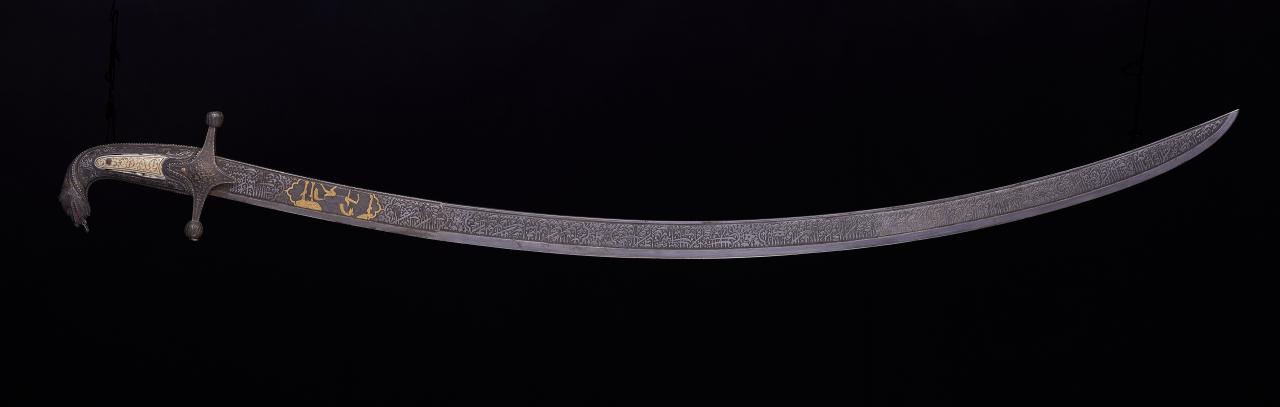

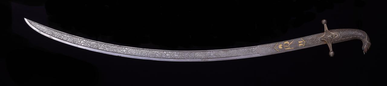

I would love to get some help translating the writing on this blade, and learning a bit about the country and date of origin.

The grip widening toward the crossguard was an almost characteristic feature of Caucasian shamshirs ( khmali). Also , the animalistic pommel ( snake head?) suggests Daghestani origin.
Also, the depiction of a man in Сaucasian attire with a long kindjal supports the above origin.
Thus, I would suggest Daghestani work from Amuzgi, second half of the 19 century.
On the other hand, I do not remember another Caucasian sword with so profusely etched blade and cannot help with translation.
But it is not a modern fake, which by itself is a major plus in this day and age of Internet acquisitions.
I am sure you got yourself a nice, old and genuine Caucasian shamshir-like sword.
Is it my imagination of a photographic defect , i.e. a transverse line across the entire blade distal of the cartouche? Was the blade broken and re-welded prior to the etching? The lettering seems to be uninterrupted.

I think that might be an optical effect; the etched or engraved area narrows suddenly by a step at that point, which creates the illusion of a line running across the blade.

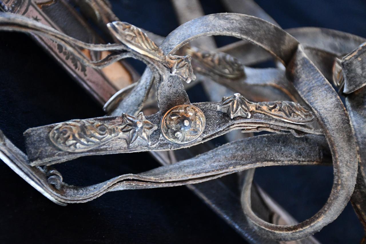

There is no damage or alterations that I am aware of to the blade. Here are some additional photos of the grip/pommel, scabbard and sword belt (a bit brittle). I assume this was a ceremonial or decorative sword given all of the decoration and engraving...

It doesn't strike me as a modern souvenir (though I could see the scabbard being a replacement), but I could be wrong of course. It wouldn't be my first oopsie.
