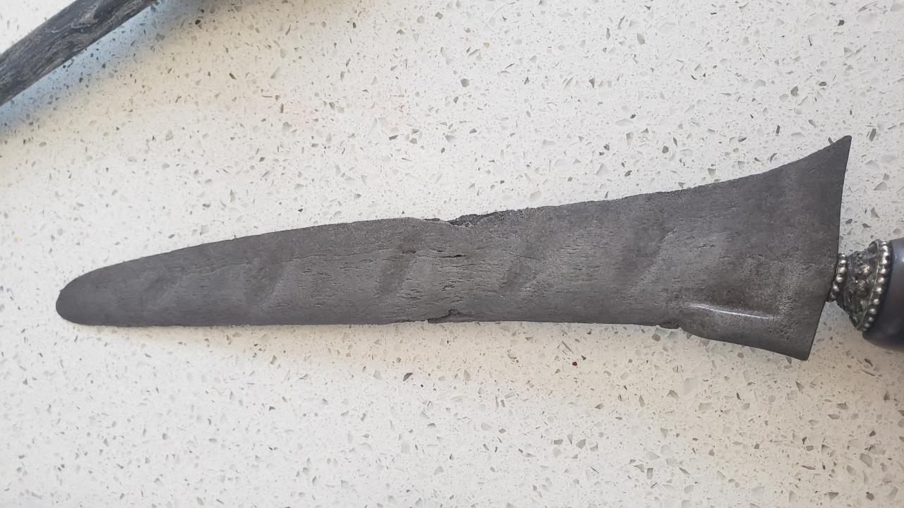

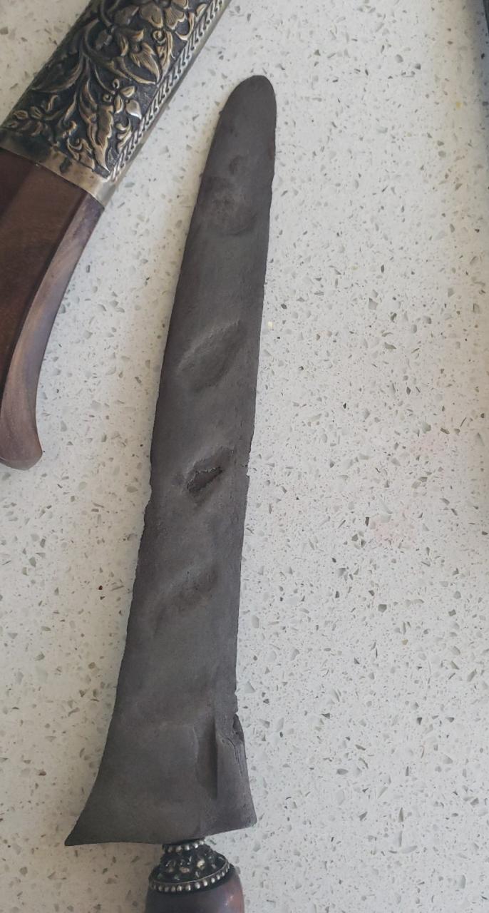

Just got it from abroad today
I can thumbprint whorls

I'm skeptical about fingerprint whorls.
Layers of pamor might present as such, but look at your own thumbprint, compare how fine the print lines on your thumb are.
Good close-up shots might help confirm.

This is an old blade, it is not likely that any actual impressions from finger print whorls would remain after a few acid cleanings, if any were present in the first place.
Lets say, just for the sake of the exercise that this blade is somewhere between 100 & 150 years old, and it is likely older than that, how many times has it been acid cleaned during that period of time? How many times has it been forgotten for a few years, rust has built up, and the subsequent cleaning has removed both rust and any light indentations.
Impossible to be certain from a photo, but to my eye, this blade presents as a very plain, very difficult to sell keris. Totally unsaleable on the local market in Jawa as a dress keris, and it would need a lot of "support" to find a buyer anywhere.
The way that layering is lifting in the mid portion of the blade seems to indicate that this blade has been subjected to high heat long after it was first produced. Possibly localised heat, something like an oxy torch.

Yes it has fingerprint whorls
I examined it closely...im across the country right now and can't post closeups but will
It is a very, very old blade...been looking for a picit like this for a long time and finally found one.
I have no desire to resell it..am happy to have it
True pusaka!

GP, I'm very pleased that you have acquired a keris that brings you such a high degree of satisfaction, however, you have not acquired a keris pusaka.
The way in which finger print whorls are applied to both old & more recent keris is by the method that in Jawa we know as the "batik" method, it is called this because the blade, or an area of the blade, is covered in wax, the finger tips are pushed into the wax when it is still warm, this leaves a print in the wax, if necessary, these finger imprints are improved with a needle when the wax has hardened.
Once the finger prints or other design have been inscribed into the wax, the blade , or the localised area of the blade, is treated with acid, the finger print whorls that you can see are the result of acid etching.
After the pattern has been etched into the blade, the wax is removed with boiling water and the blade is cleaned and stained.
This topic of "batiking" a blade has probably been discussed previously on this forum, the practice is very well known to established collectors and students of the keris.
