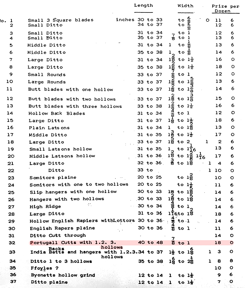

Attached, is a transcribed page from the 1703 contract that the German swordmakers in Shotley Bridge signed for the Company: it lists all the possible blades they must be prepared to supply and, in particular, 'at what cost'.
The names and details require much modern interpretation, and anyone so-inclined is encouraged to oblige... thank-you. 'Latsons' ? English Rapiers with 'Lottors' ?
However, down at the bottom of the list, and highlighted, are the specifications for what I must assume are rapier blades, as the name Cutts is also a mystery to me.
More to the point (oops!) are the dimensions: 40 to 48 inches!
I have read about excessive fashion peccadilloes producing in-feasibly long rapier blades and, in fact, royal pronouncements as to acceptable dimensions; can anyone expound on this issue?
All in all, I thought this list might appeal to some of you folks out there.

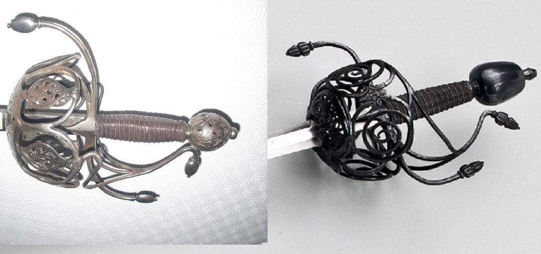

Precisely ... the reach is the issue. The laws legislate on how far you can reach (your foe) with a whole sword and not how long is the blade. Blades may be short and hilts may be long; it is the whole thing that counts for the legislator.

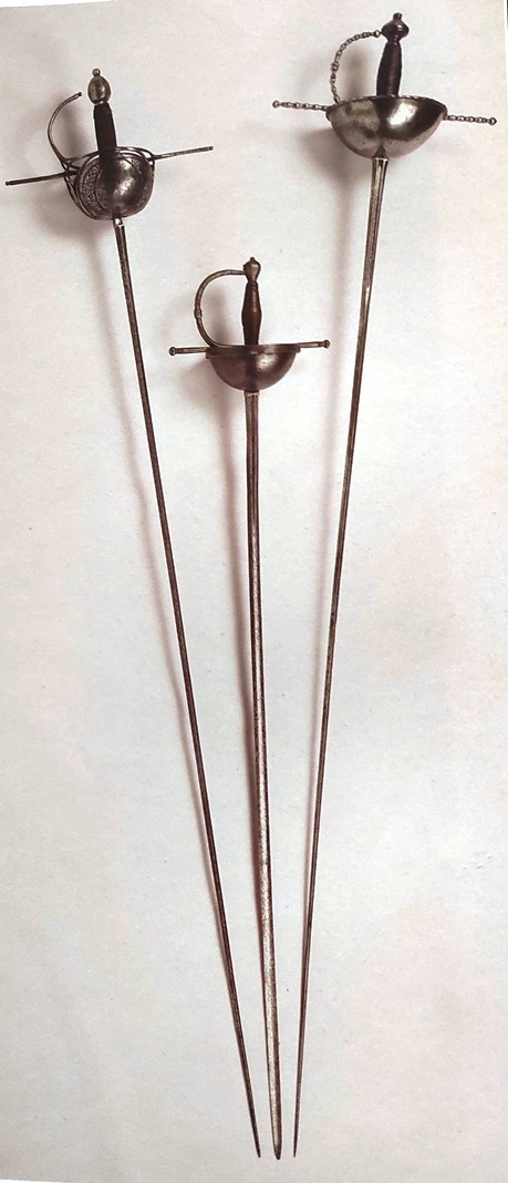

Let me show ou a 'growing' rapier, one in that when in its 'normal' version does not challenge the law but, when you stretch it, it extends up to a seven span sword.
FYI, even Kings (secretly) had them, as you may read in the (left side) caption

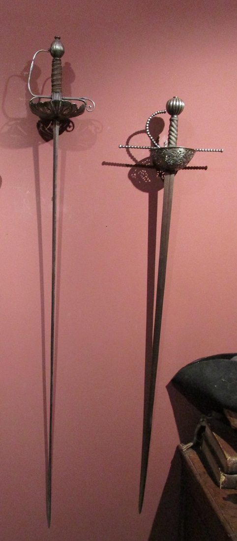

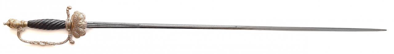

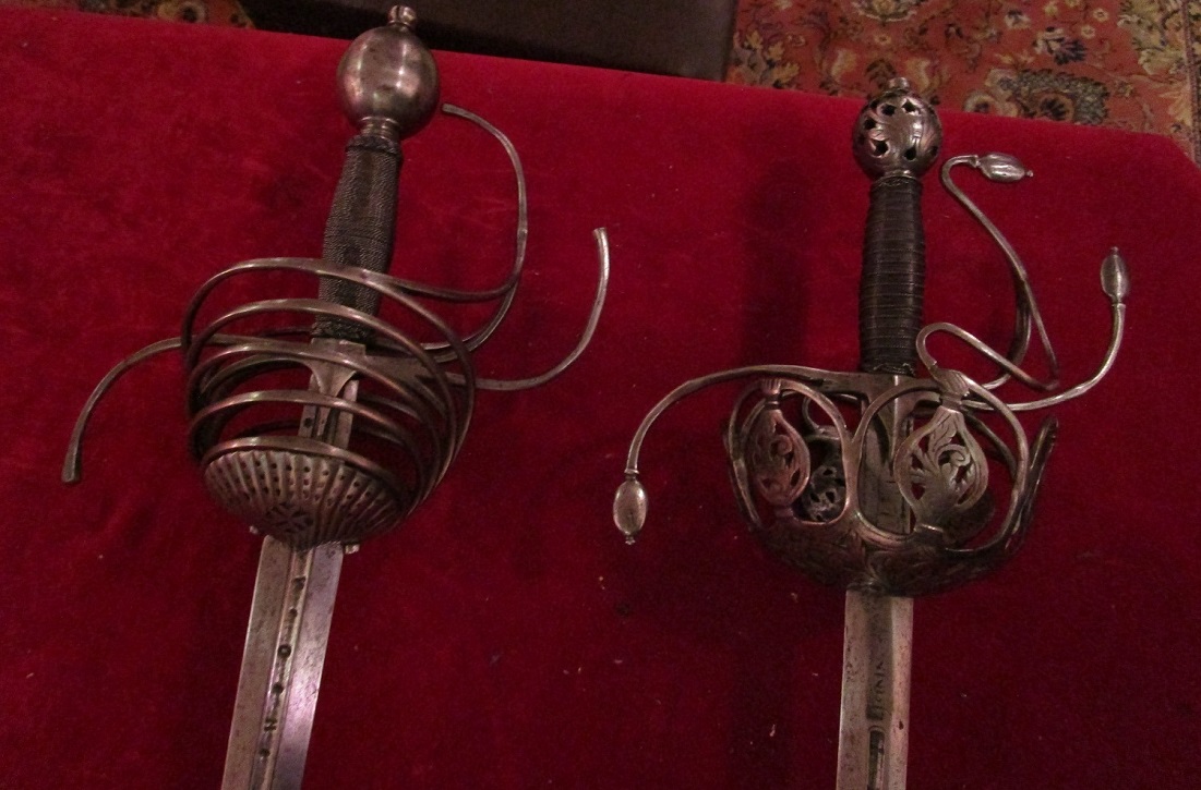

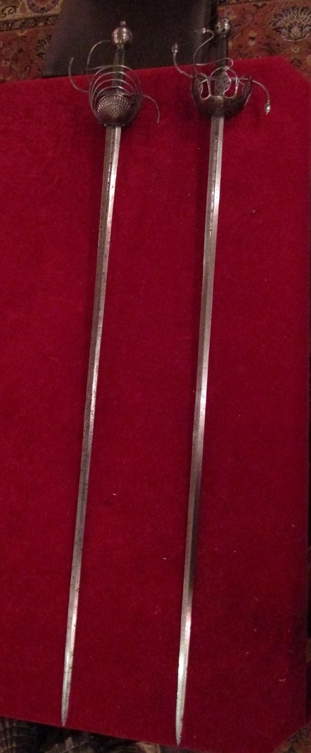

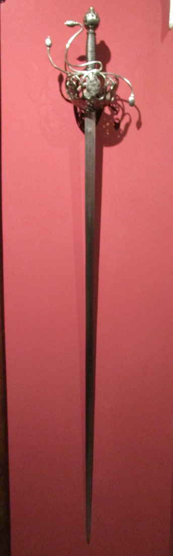

So: I got some swords down from the wall to experience simulated combat usage (see pics below).

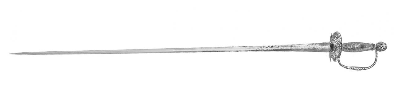

The first was a typical smallsword with an 80cm blade (I am measuring up to the start of the hilt; I am not including the hilt in the measurement) with a trefoil blade.
It handles exactly the way every description I have seen suggests i.e. very fast and delicate.
Then I tried a typical Portuguese slim bladed rapier of 100cms. It has been re-hilted with a court-sword hilt of very large proportions. If I was up against a practised smallsword opponent I would be struggling to match move for move but then I am not a swordsman in any shape or form so this is a layman's attempt to understand length and weight.

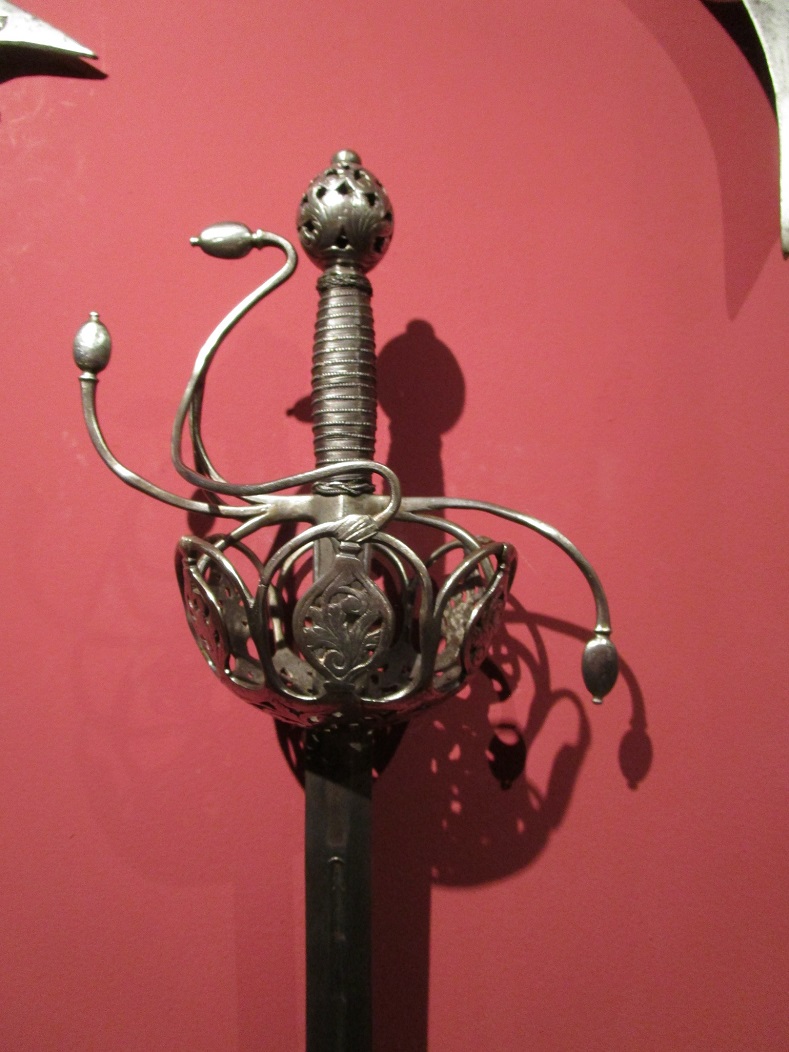

Finally, I have a City Guard northern Italian swept hilt rapier that has a relatively narrow blade, probably typical of the late 1500s and a good bit broader and heavier than the Portuguese blade, but of course it has a substantial guard to balance the blade. Even so, I am certain a smallsword could get past it very quickly and easily.
Anyway: I do not understand how you can manipulate such a long blade (145cm: even if that includes the hilt) so effectively, but maybe if I was a seasoned fencer with experience of such a blade it might be obvious.

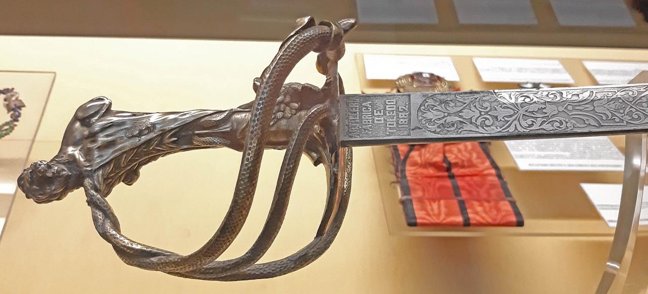

Default Lisbon Armoury
Very fine pictures. I visited the museum three times in the past and they never allowed me to take pictures. Would have they changed the rules ?
When I was there, in December 2018, I was the only person in the building. I was on a cruise ship and it was raining heavily and as I had seen the museum two or three times in the past, and not visited, it seemed like a perfect opportunity.
I photographed everything in the glass case - that didn't amount to much - with no interference from staff who were nowhere to be seen.
There were some magnificent displays in there, and the building itself is glorious, but there were only a handful of blades... and three of them were plugs: fine plugs yes, but surely they have a lot more available in the archives... why not put it out.
Of course, not everyone shares our enthusiasm for weaponry.
When I reduce the file sizes I will post some of the pics I took - other than the ones above.

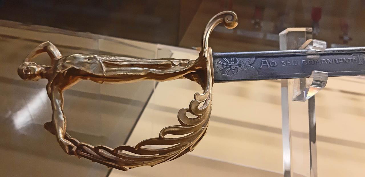

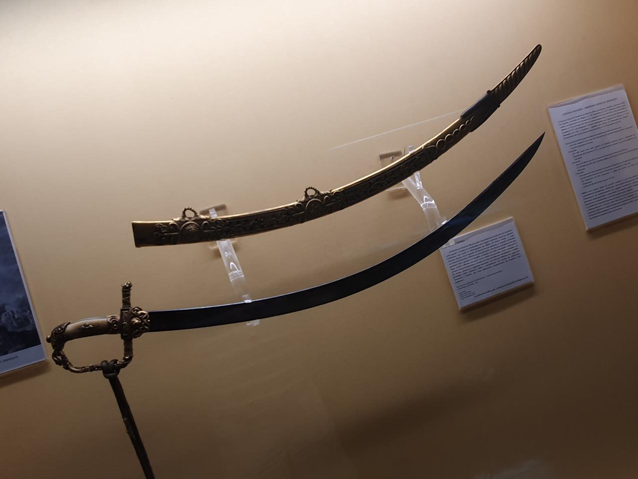

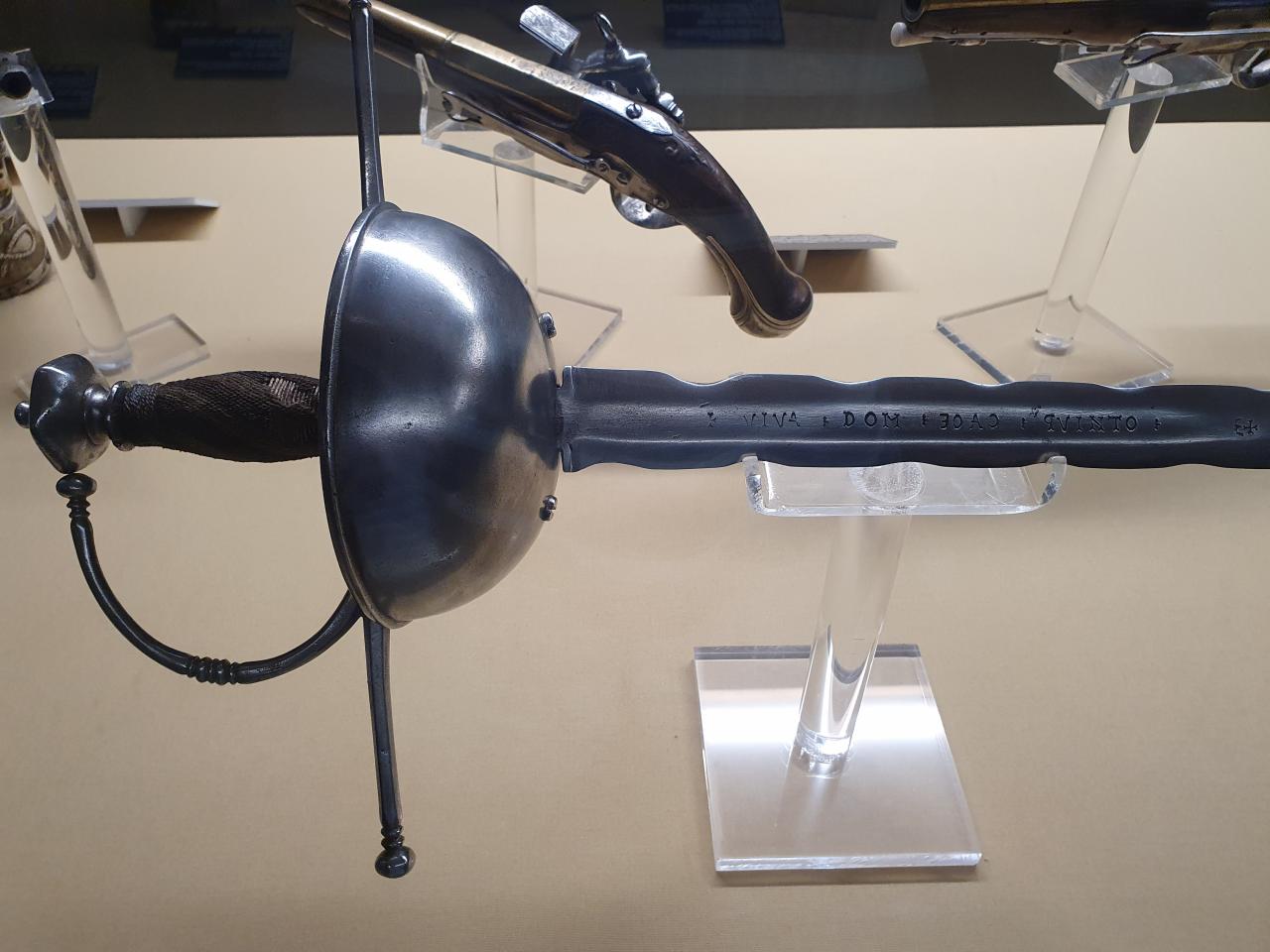

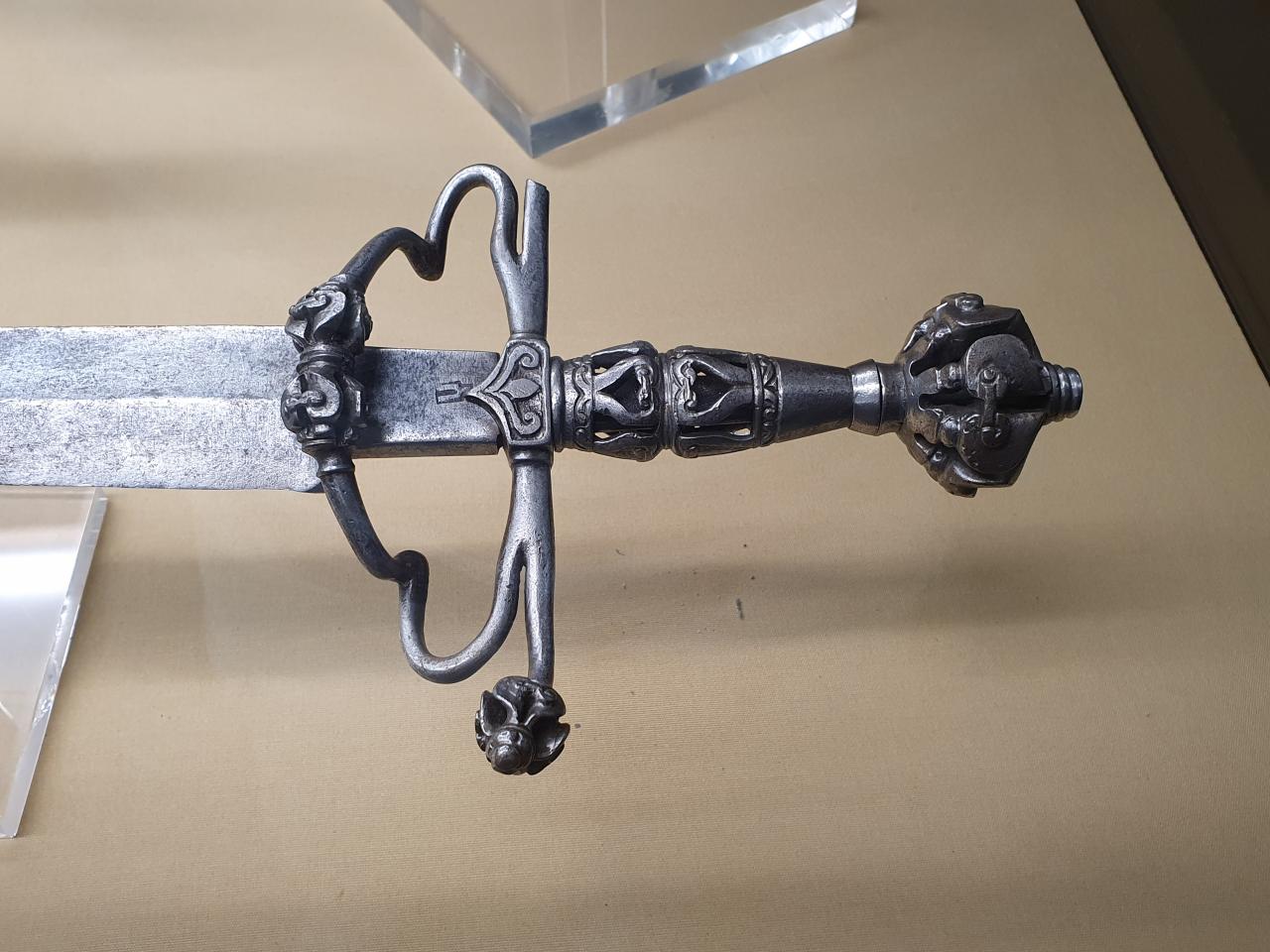

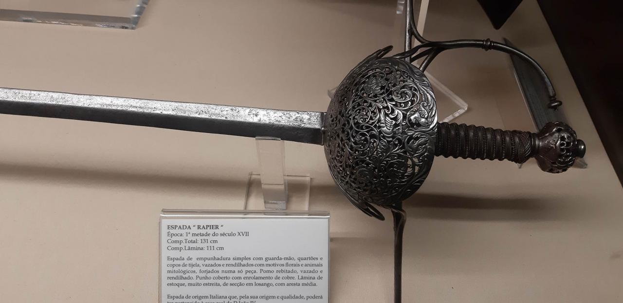

Here are four from the Lisbon Armoury:
Old 25th November 2021, 10:04 AM   #21
Excelent pictures; you sure have a steady wrist ... and a good camera .

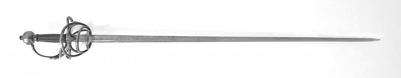

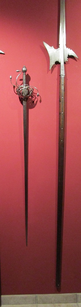

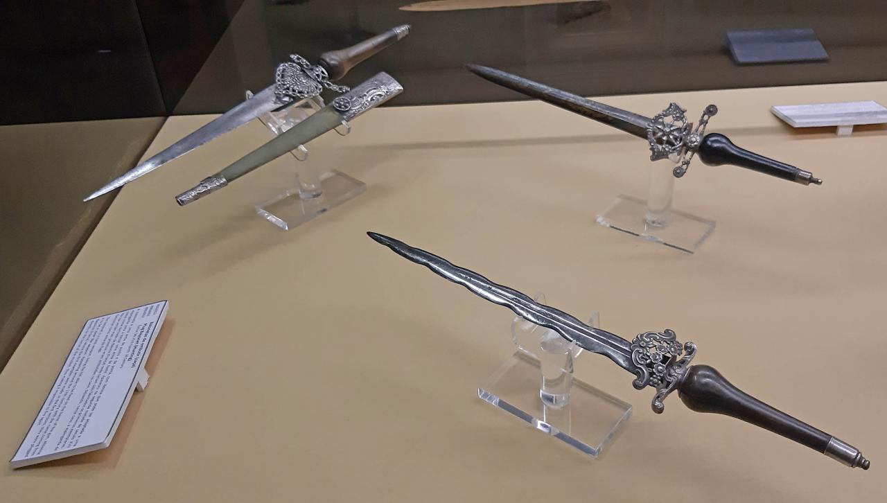

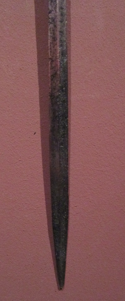

Here is such a rapier, I oput it next to a halberd so you can put things in perspective
The total length is 135 cm the blade without the angel 120 cm or 4 feet. The blade section is hollow ground, the maker is Antony PIccininni. The cup pierced as it the pommel all very fine and delicate work to save weight. This rapier can be handled from the wrist and feels just like a small sword.
Long rapiers are rare and very hard to find, lengths can vary from 110 to 145 cm total length.
Most rapiers are around 120 cm total length, all rapiers longer than 130 cm can be considered exceptionally long.
kind regards
Ulfberth

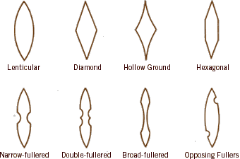

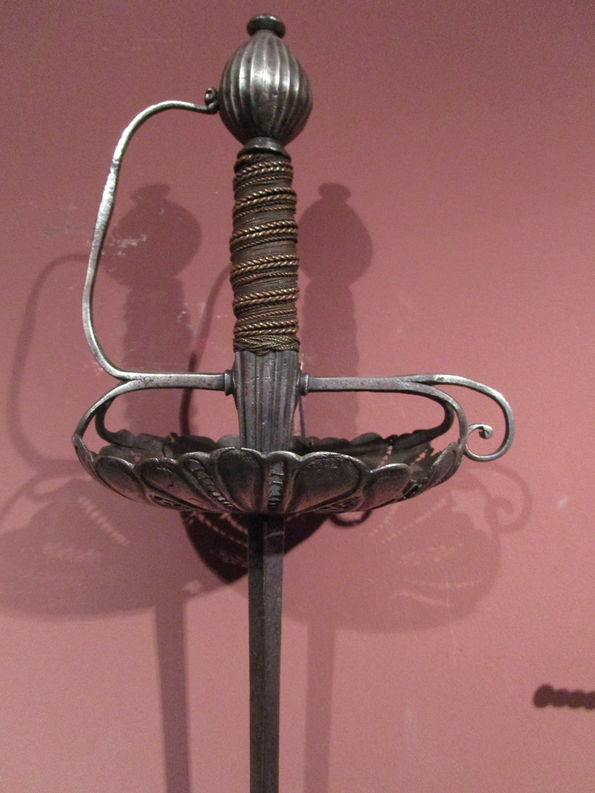

It is hard to tell from the pictures, but you say the blade is hollow ground, do you mean it is of smallsword trefoil design?
Incidentally, the combination of swept hilt and cup seems quite unique to me; is it?

The one one the left a dish hilt with diamond section blade and a spatula tip to cut with is 145 cm total length that's 4 foot 9,9 .
the one next to it is 130 cm still longer than most rapiers.
This type of guard is rare yes, there is a similar rapier in the Hermitage museum in ST Petersburg Russia.
Here is an example of what i mean by a hollow ground blade.
