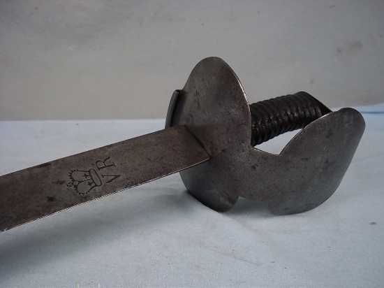

The number of different patterns of the British Naval Cutlass that date to the 1840 - 1850 can be confusing. Not to mention the several different new models, there were 1804 blades fitted with new hilts and even cutlasses made from the ubiquitous 1796 heavy cavalry blade shortened to suit. Added to this mix were unaltered 1804 cutlasses marked with the royal cypher of Queen Victoria.
‘Swords for Sea Service’ notes that no 1804 pattern cutlasses were ordered for the Royal Navy after 1808, so why then are there seemingly authentic 1804 cutlasses marked with the cypher of Queen Victoria who reigned from 1837 to 1901?

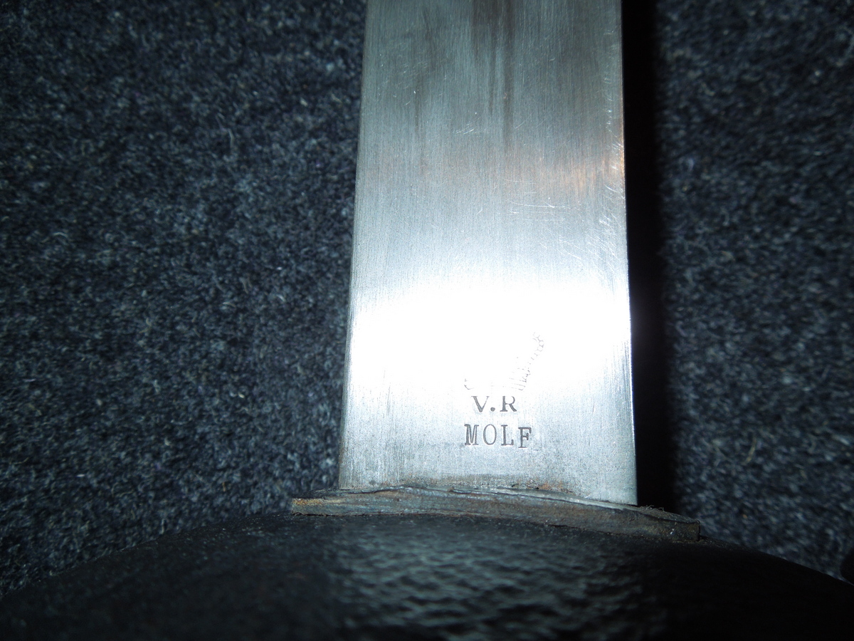

Replicas or fakes are always a possibility and yes there is an 1804 replica stamped with the letters VR, see picture. But stamping the letters with readily available letter stamps is a very different matter than producing an inch high cypher and in any case why fake an 1804 with VR when GR would make more sense.
In 1840 following complaints from the navy it was decided that an improved hilt and guard would be fitted to existing blades to improve hand protection. Initially 10,000 1804 cutlasses were ordered to be fitted with the improved hilt and all available cutlasses were sent to the Tower of London armoury for modification. By March 1841 only about 1000 of these modified 1804 cutlasses had been re-issued when a major fire at the Tower destroyed a large number of the remaining cutlasses and left the navy seriously short of weapons.
Is it possible that, because of the shortage, the survivors of this fire and possibly those still en route to the Tower were simply inspected, stamped with the royal cypher and sent back into service unaltered?

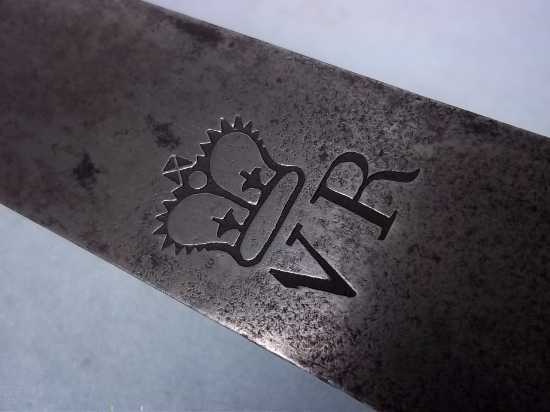

Well it’s just a theory but look closely at the two cyphers. I think they were made by the same stamp and I also think the ‘V’ on the stamp itself was made by removing the first part of the ‘W’ on the WR cypher of the previous monarch William. If true this may indicate that they were stamped early in Victoria’s reign before new cyphers had been made.
It’s hard to be sure so any opinions would be received with interest.

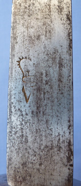

The picture with small letters is a replica. The other two are from two different seemingly authentic 1804's. One mark is very faded - any comments?
Regards CC.

CC, you have asked the very question that has been puzzling me for these past years. If you remember in a previous thread, I mentioned that my M1804 has block letter GR under crown, but not like the spurious mark of the S&K German swords, as shown in Gilkerson. The GR on mine near exact to the m1814 Brit cutlass with block letter GR. I further mentioned an early cast iron ribbed grip cutlass with straight blade and sheet guard with a very worn VR under crown marking. This sword's mark is so worn that only a slight portion of the V visible, leading me to wonder if it were a later (and weaker) stamp of a sword put back into service in its working life. You have asked that fundamental question that I've hoped others might be able to answer, as I have only guesses. I remembered reading of the destruction of many of the older models in the Tower fire and likewise suspected that some of the existing earlier models might have been issued to naval ships. As this would have been after the Age of Fighting Sail, they would have more or less been for emergency use and just sat in a rack, awaiting the need. So many questions remain, even if we can determine that the marks aren't spurious, which they still might be (notice I said spurious and not fake! S&K marked thier swords to inspire buyers that theirs was a mark of quality. Were there other makers at the time perhaps doing the same with similar marks? VR marks? Were these reused in the Royal Navy? As surplus on merchants? As exports? Certainly, British swords were being shipped out to India, Africa, etc, at the time. Until someone can document the markings that appeared on Kirshbaum swords with clarity, we can't even rule them out as the producers of said swords. Anyway, just my two cents. Hopefully, someone else might come in on this one? Anybody?

Although I think the overall style of the stamp doesn't quite "look right" I would certainly agree that the VR is an altered WR, not only from the odd left hand side of the V but also because the VR is off center to the crown, if it were WR the WR would align perfectly to the centerline of the crown. As to when it was placed perhaps more examples would help give a feel if this was something done approx. 150 years ago or not.

................ I would certainly agree that the VR is an altered WR, not only from the odd left hand side of the V but also because the VR is off center to the crown, if it were WR the WR would align perfectly to the centerline of the crown. As to when it was placed perhaps more examples would help give a feel if this was something done approx. 150 years ago or not.
Well observed Adrian and yes that does seem to make sense. It would also indicate that the cypher stamp was made in one piece rather than the letters being separate from the crown. CC

Concerning my example, the marking is so barely legible, that it wouldn't help in identification. The R is badly rubbed, but visible, as is the top right-hand corner of the V. The crown is illegible save for the bottom ridge. Looking at where the corner of the V meets the mid-portion of the crown, the mark was probably just like the one on yours, being that it might have been the WR type, reduced to VR where the V doesn't quite sit well under the crown, if you catch my drift.
