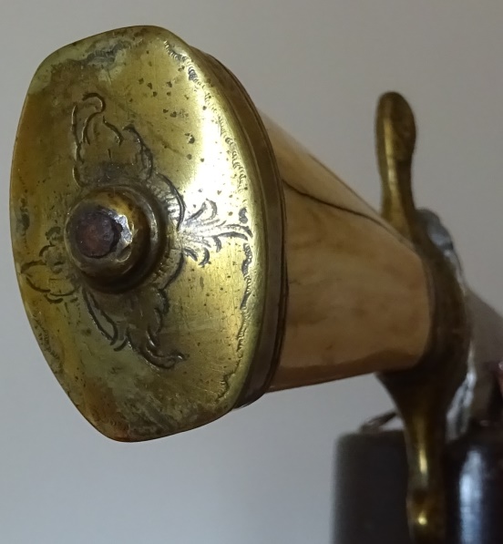

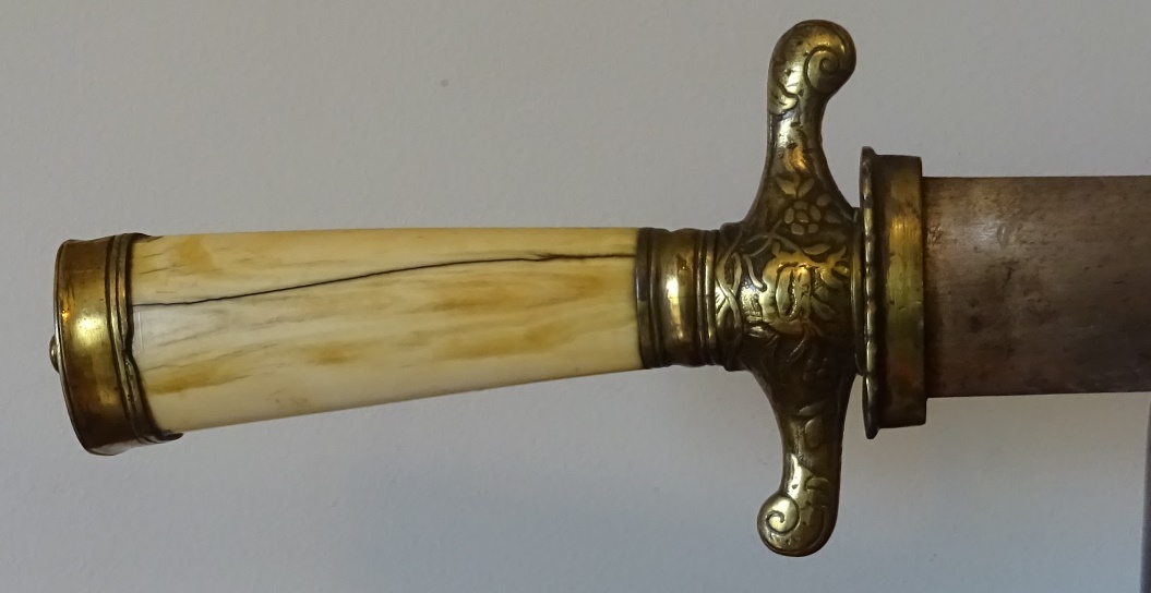

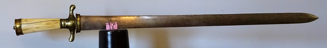

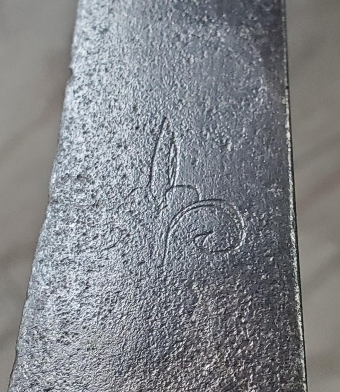

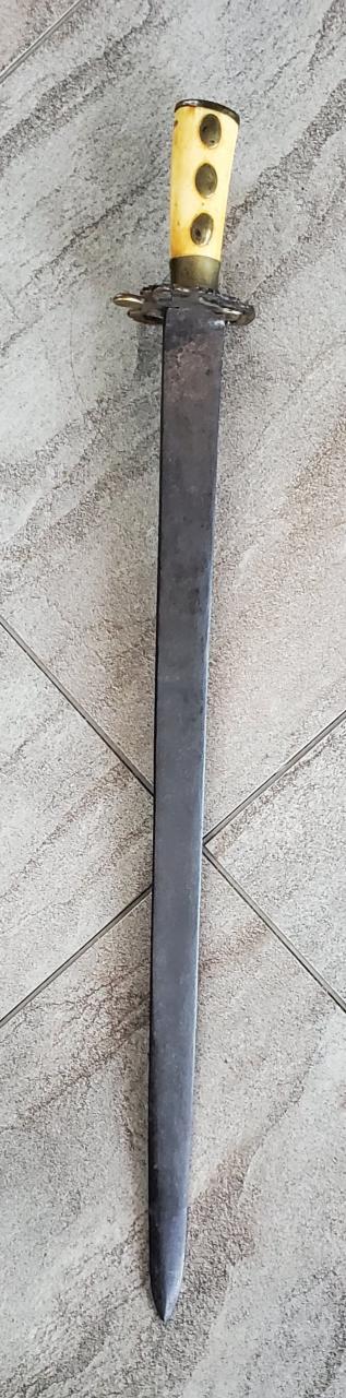

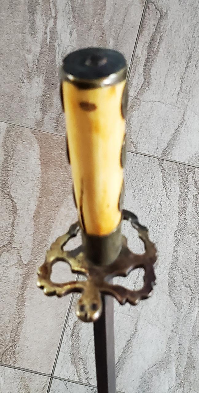

A sturdy blade, double edged, sharp, length 51 cms.
The grip in ivory, with a nice patina; the hilt in brass; the peen untouched.
Could you Gentlemen help finding its age and country of origin ?

Very difficult to locate because of the very few identifiable details. German or maybe French?!
Late 18th to early 19th century?!

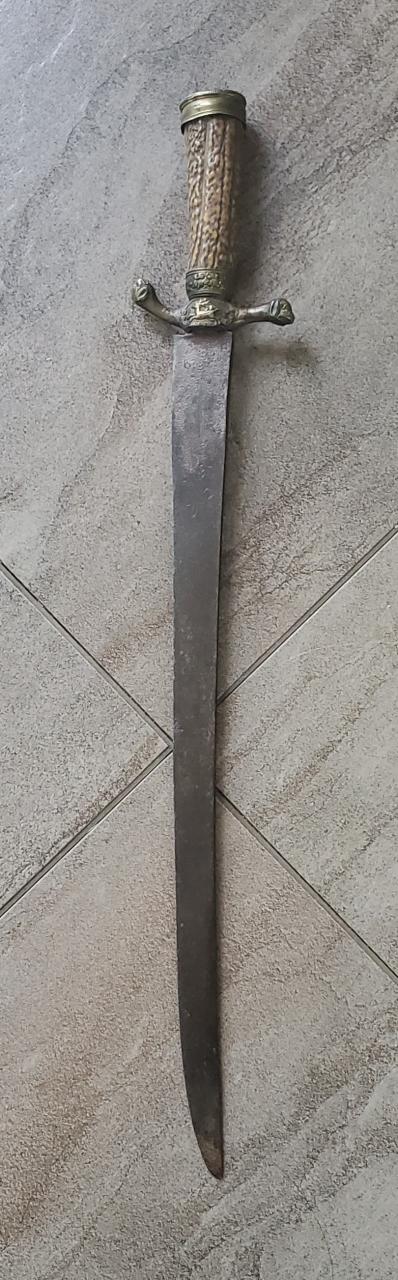

Based on an example I have (attached), I would say this is English, first quarter to mid 18th c. The blade on mine seems a cut down hanger blade, the fluer de lis, while suggesting French, also is found on blades traded to cutlers in England. There was a street, do not recall details, actually named 'fluer de lis street;'where lots of blades were sold to cutlers, who then mounted them accordingly.

I'd place it mid to late 18th due to the 'cap' type guard that would fit over the scabbard throat to prevent rain water drainage into the sheath (and thus a risk for rusting). I've never seen this affectation on (later) 19th century pieces and it was sort of an 18th c. thing. Beautiful example, 'Nando and I like the honey patina of the grips!

As the Capn has astutely noted, that 'cap' over the ricasso at the bottom of the guard does suggest 18th century. While these features may of course have extended into 19th in degree, it does lean to the earlier date.

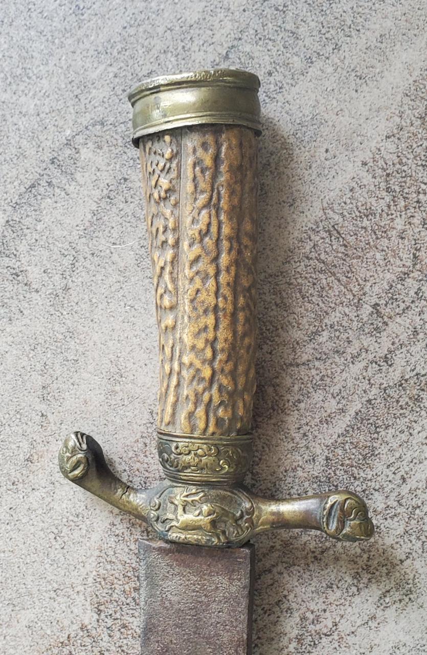

On the example I posted, that feature is missing, and perhaps might have been there with the notable gap suggesting a remounted blade. Note the ends of the quillon terminals with hunting dogs.
These were known as 'talbots'.......anybody remember 'The Wolf Man', Lon Chaney Jr. ? His character was Larry 'Talbot' (the wolf man) in a bit of canine pun.
Here is what I believe to be a Continental version, probably 18th,and it seems to me the 'buttons' and open guard lean toward some French and German examples.

Great information on those opposing dog head finials, Jim! I always wondered if they had a name. 'Talbots'...very interesting! In themselves, they also IMHO lend to an earlier (pre-19th) dating. My 1660's Dutch hanger has them as well. I like your hanger as well, Jim. Besides, of course, being used by the gentry for hunting as well as infantry/army, the plain hangers were also popular at sea for their simplicity, brass fixtures (those that possessed them, that is) and relatively short blades.

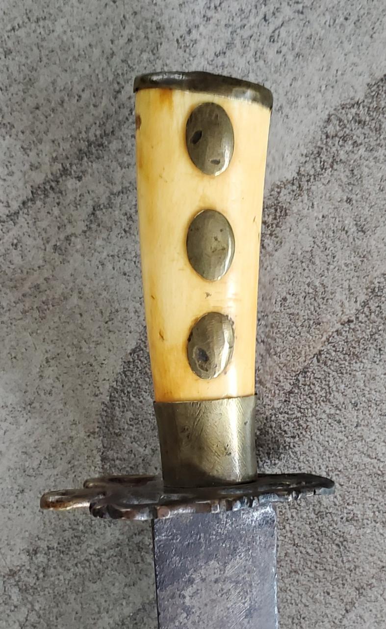

I finally dragged out my Bashford Dean (1928), and I think Marius is right on the hanger in the OP.
Notes also from "Edged Weapons" , Frederick Wilkinson, 1970, p.94,
"...another type of sword was in favor at this time (2nd quarter 17th c) had a simpler hilt which comprised a cross quillon, usually straight with slight curves at the ends, but NO knucklebow at all. "
I have noted that most hunting swords, especially English, seem to have had knucklebows.
The flared out pommel seems to be French or German, and as I earlier notes the 'buttons' (medallions) in triple (or often 5), seem also to be French or German.

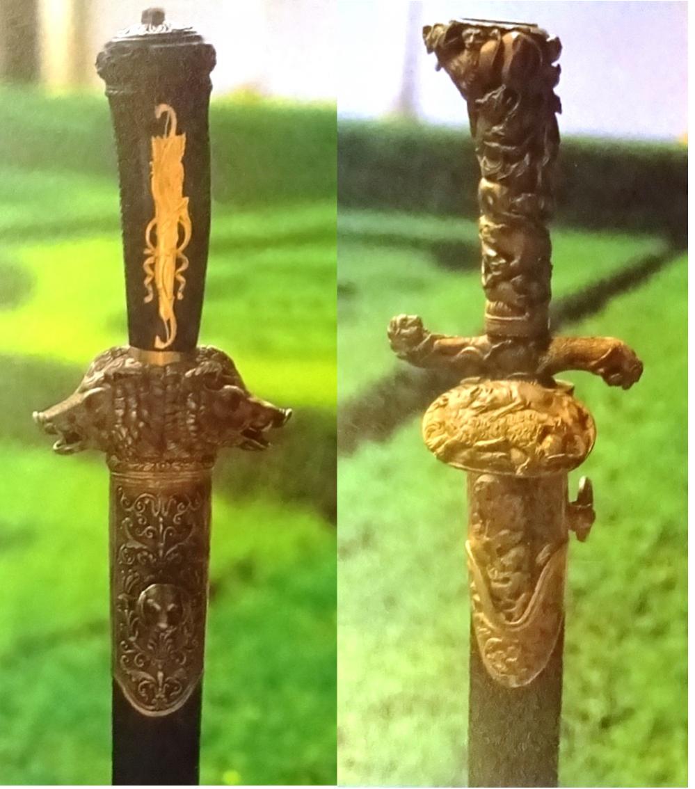

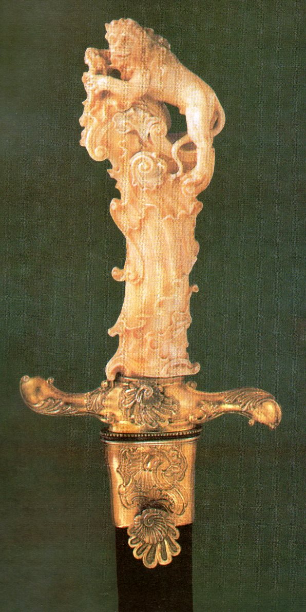

Not forgetting that, apart from 'normalized' patterns, there were in the period examples made by rural smiths for the regional hunter, as also high end specimens ordered to skilled smiths by the wealthy class.
From a book of mine ...
1 - an example with an inscription on the blade "Donné par l'Emperor de d'Austriche à Mr. Jules Gerard 1854" (collection ducal Palace of Vila Viçosa - Portugal).
2 - an example signed by the famous Le Page mid XIX century (collection Ducal Palace of Vila Viçosa -Portugal).
3 - an example of the second half XIX century (collection Ducal Palace of Vila Viçosa -Portugal).
4 - an example equiped with a pistol (a not uncommon resource) of the XVIII century (Private collection).
5 - an example with a carved ivory hilt, Germany mid XVIII century (Metropolitan museum USA).
