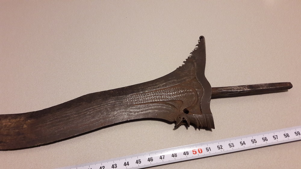

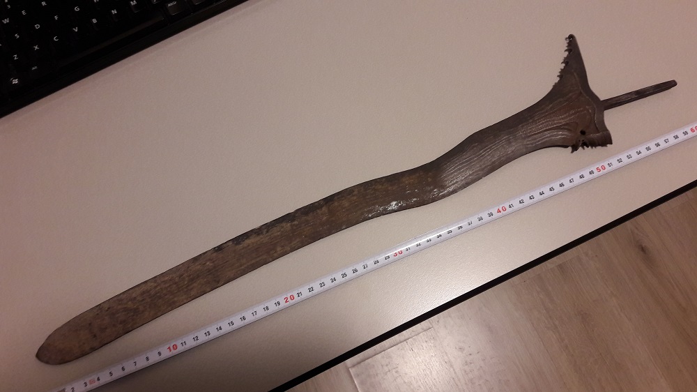

Default Philippene/Malay (?) kris with naga
Dear members,
this kris crossed my path, the blade shape seems Philippene to me but the base with a delicate Naga and curved ganja with very nice greneng don't. Contrast forging pattern shows and should be very nice after cleaning. It shows age with some pitting and a few dings in the edges but nothing too serious
I'd appreciatie any thoughts on origin and age, and input on what kind of hilt and sheath this should have!
Kind regards,
Eric.

This could be a Malay Sundang.
Try using those words in our search engine and list ethnographic weapons as the forum to search.
IIRC Malay sundangs can be found with a round peksi or tang whereas the Moro kris usually has a flat tang.

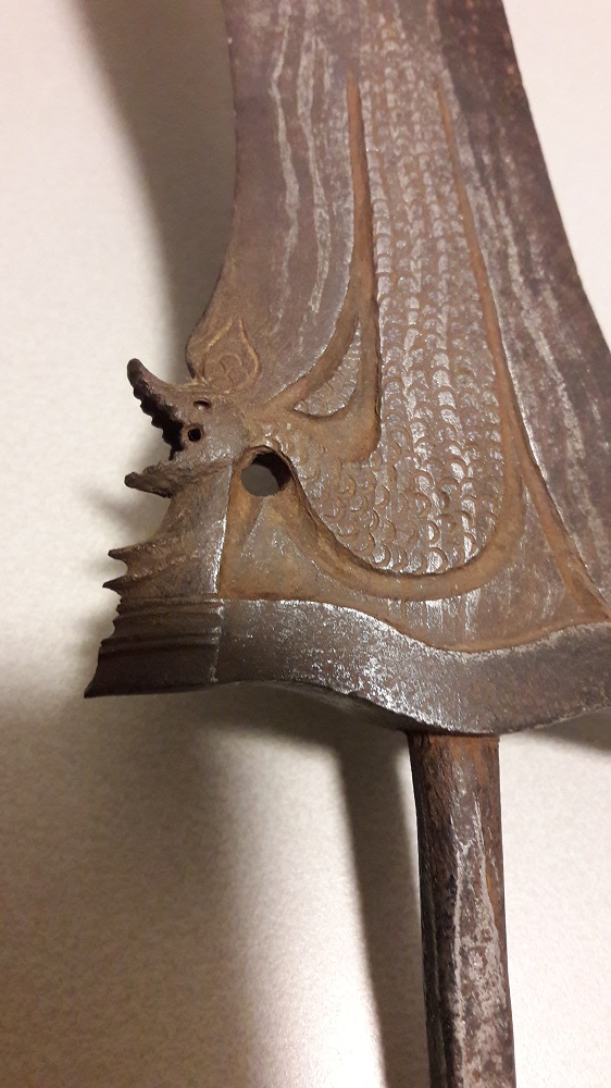

thanks gentlemen! I have scanned the posts with sundang (there's a lot to read) and will dive deeper into it later, interesting new area for me.
In the pictures of examples I didn't see a naga head like this, doesn't appear to be a textbook example.
The peksi starts round at the base but is forged square, some remnants of resin on it. About the hole behind the naga mouth, do you think this is meant for a baca-baca or just decorative?

oh and what I forgot, any idea's on which part of Malaysia? North/north east Borneo?
Kind regards,

The hole seems a bit incongruous in its relation to the Naga's head so it could have been for attachment of a baca baca, but I see no evidence on the blade to indicate it was used as such. The sword having a Ganja Wulung might complicate the attachment of the aforementioned piece.
Is the Ganja a separate piece?
Old 13th February 2021, 04:50 AM   #8
Hello Rick,
modern renditions of keris Naga often exhibit holes:
http://www.vikingsword.com/vb/showthread.php?t=23571
I don't think this hole was meant for fastening with a clamp.
Old 13th February 2021, 04:52 AM   #9
BTW, good call to question the gonjo construction, Rick.
Based on the heavy pamor of the blade, I'd guess it is separate though...

Hello Eric,
As the others have mentioned, certainly not Moro work. Kris from Brunei seem to be very close to Sulu work, too.
I can't positively prove that this wasn't made on the Malay peninsula. Based on the features at the base of the blade, I'm inclined to believe that this piece was made by a Madurese pande...
IMHO, it would be interesting to stain the blade.

Hello Gents,
thanks for the additional input.
the ganja is indeed a separate piece, after some mild cleaning the pattern is more clear on the entire blade. Interesting feature at the tip is that the pattern runs to one edge and a separate dot in the tip is visible on both sides.
At this moment I don't have a container big enough but I'm certainly going to give this a bath in lemon juice to clean the rust and etch it, should be nice.
Kind regards, Eric

Hi Eric. Thanks for the additional photographs.
This is definitely a sundang of Indonesian though it is difficult for me personally to pinpoint origin. If it came with original dress it might be easier. I know Kai has suggested Madura, but i am having a hard time seeing that. If i were forced to make a guess i might suggest Sumatra. It is a lovely sundang though. It would be great to see it with some new clothe. I'm not sure that you have access to the anyone in Holland to do that kind of work though. I personally would hesitate sending it back to Indonesia to a mranggi, but maybe you could find someone willing to work from line drawings and tracings of the blade and do the finishing work at home.

Hello Eric,
Thanks for your additional pics!

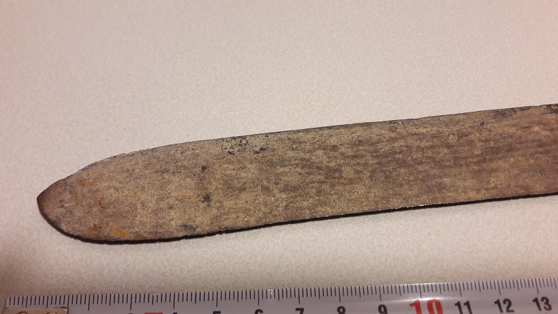

I'm afraid there are no genuine keris sundang originating from Madurese culture. Blades that probably might have been crafted by entrepreneuring Madurese bladesmiths appear to be a fairly recent phenomenon. From my observations, it seems that native styles (typical for Madura/Jawa) tend to shine through with these blades.
I believe this piece has been artificially aged: There is a considerable difference of surface corrosion and damage between the tip and the base of the blade (as well as the pesi).
I already mentioned the weird pamor and the carved naga both of which do not really vibe well with a traditional Melayu origin IMHO.
Also the features at the base of the blade do not seem to be compatible with a traditional Melayu origin for me.
Thus, there seem to be way too many red flags with this piece. Please don't see it as a final verdict though: More info gained from a detailed analysis (staining, etc.) may help to gain more insights.
