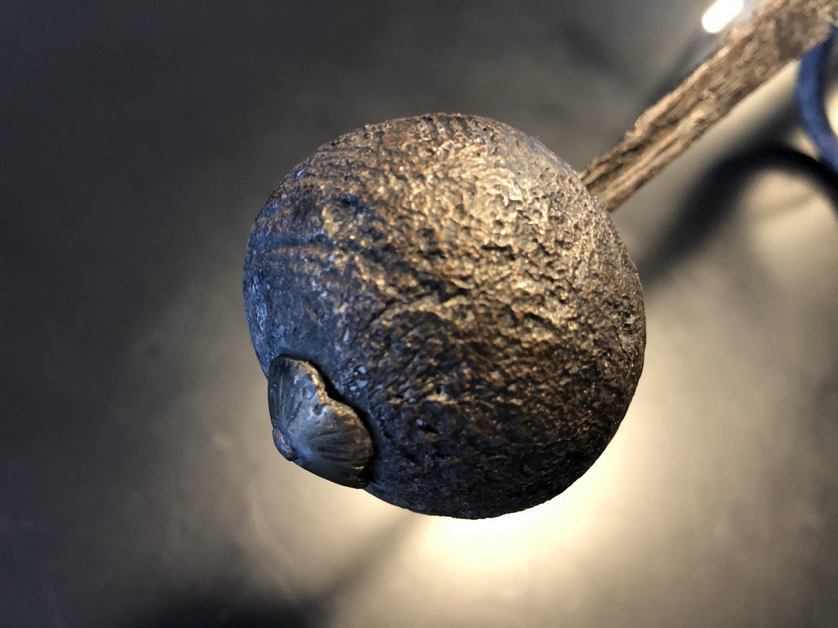

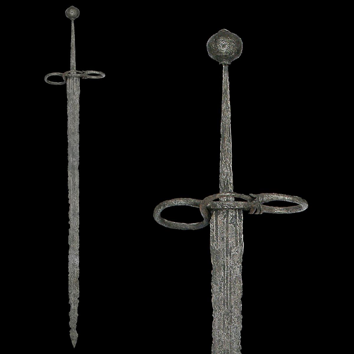

recently received this special katzbalger.
The sword was found in 1973 in the river meuse near roermond.
was in the Visser-collection, hereafter the famous San Diego, California Collection and now ( luckily) back in the Netherlands.

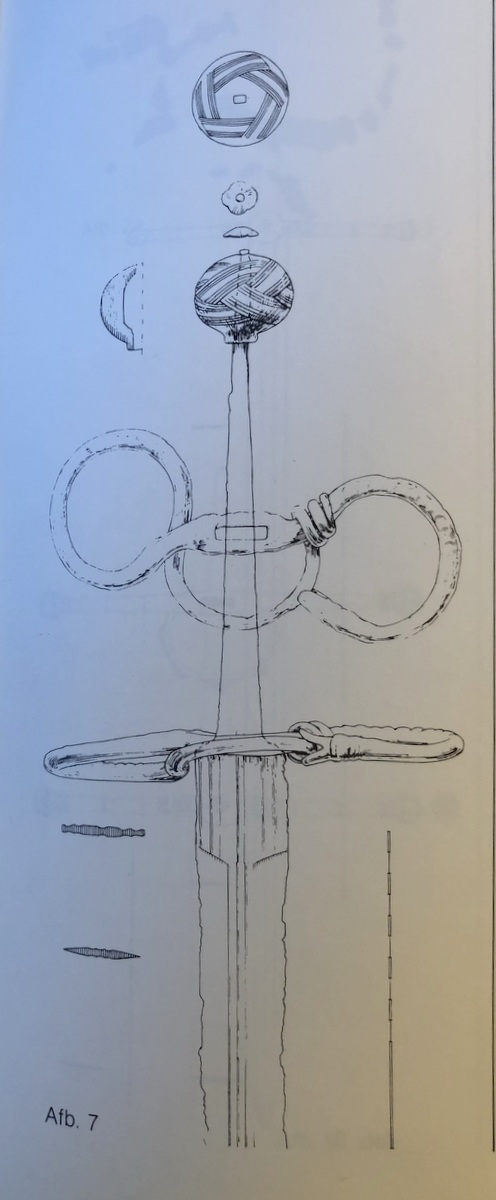

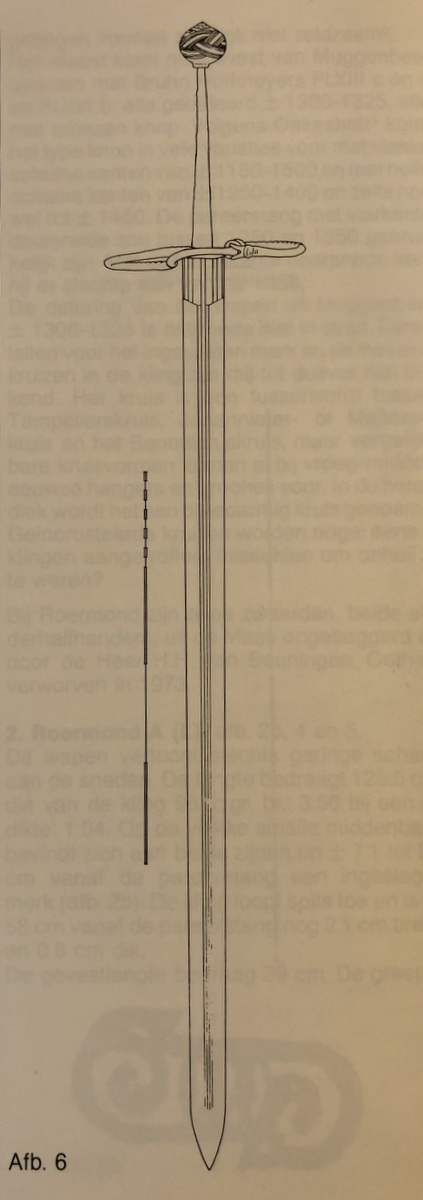

The length of the sword is 117 cm, the blade 93 cm and the grip 19 cm. The pommel is onion-shaped and decorated with woven bands and has the characteristic for the 16th century flower-shaped brass blade-button on the pommel.
With a grip of 19cm it can be handled with two hands, so it is slightly larger than a one-and-a-half-hander. its a big 1 1/2 hander or a small two hander.
a katzbalger is very rare in itself, but this one in particular , it has a cross-guard shaped like a snake, which twists and bites its own tail, here the characteristic katzbalger hilt is formed.
The snake biting its own tail is a common motif in the 16th century. The time of the Renaissance, a time when the tail-eater was frequently depicted in paintings and on and around sculptures and statues. This made it even more a symbol for rebirth (= literally renaissance). And stands for eternal repetitive life.
the Landsknecht's sword can be dated somewhere between 1520-1530.

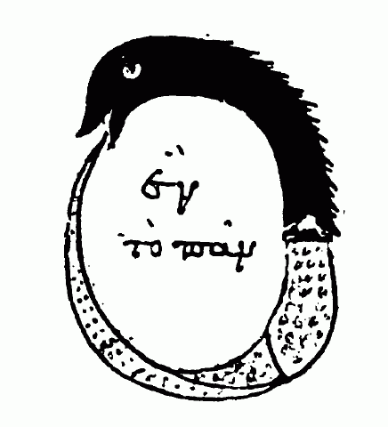

Pretty fascinating sword, and as mentioned, the snake biting its tail is a well known allegorical symbol of the 16th century. I always think of the 'ouroboros' serpent (tail eating) from alchemical lore and included in the dogma of the Gnostics, where loosely the meaning, 'the all is one' etc. are associated.

Attached the Ouroboros of alchemical association.
