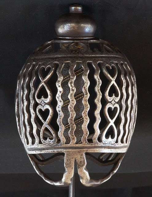

In the recent thread posted by Mark Eley of a fantastic Jacobite basket hilt of late 17th early 18th period, thoughts came to mind of the symbolism or aesthetics of the piercings and structural elements that may be at hand.
While most references acknowledge, term, and categorize the variations of these, there is virtually no attempt to acknowledge what these features might represent. Years ago in my efforts to delve into this, most of the authorities and reference authors I queried informed me that their avoidance of these kinds of matters was obviously because of the subjectivity.
The exceptions were in the case of the more artistic Stirling type hilts, the symbols were clearly formed and incorporated into hilt themes.
On a side note here, it has been agreed that the 'S' in basket hilts was not intended to mean 'Stirling' or 'Scotland' or 'Stuart", but was simply a structural aesthetic joining shields and saltires.

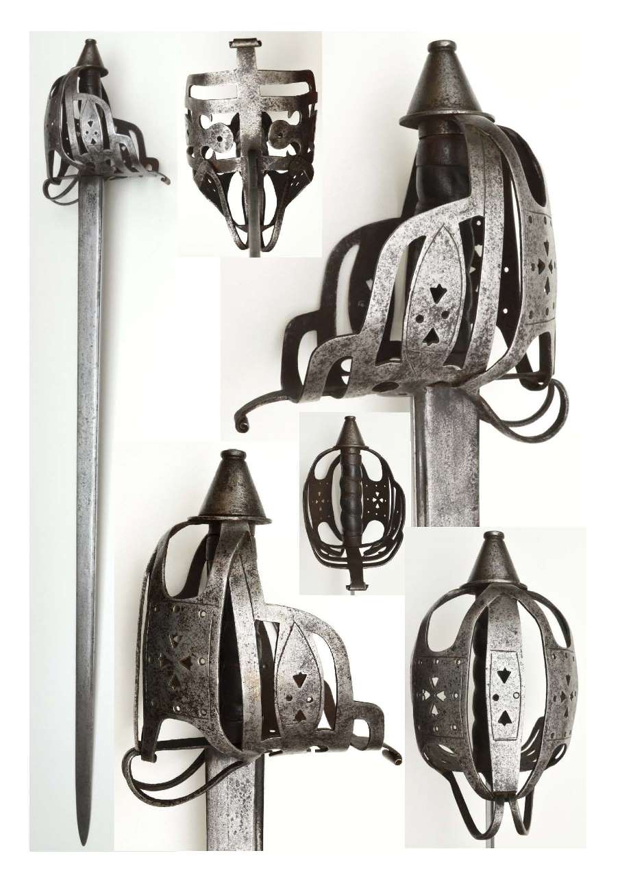

The 'Glasgow' form hilts are more the subject here, with the pierced designs in the shields being the primary focus. Also the designs along the edges of these and saltires often seem to have nominal symbolic potential.
What brought me to bring this up, is finding examples of certain markings on early German weapons of c.16th century inlaid in latten, but resembling some designs. Some of these almost resemble the devices used in card suits, as Mazansky tacitly noted.
However, in many cases these may be highly stylized Jacobite symbols, of which there are a good number.
I am hoping others out there with interests in Scottish basket hilts, or simply in symbolic designs and markings on them might join in here.
I did not wish to detract further on the other thread as this is a much broader topic.
The first two hilts are 'Glasgow', while the more decorative one is Stirling. It has been suggested that the wavy designs represent 'the waves of the sea' across which the Stuart king waits to return to his throne, the hearts the devotion to him. Perhaps fanciful, but there is a degree of viability, but who knows?

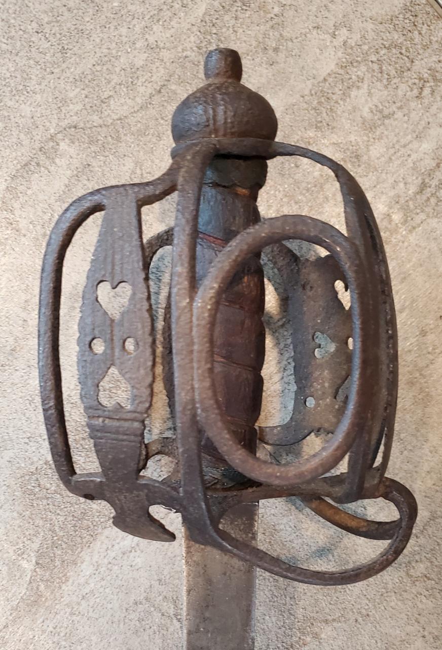

As noted previously, these Stirling hilts (this one by Walter Allen of Stirling, and the hilt by Colin Mitchell at Canongate). ...carried more artistically designed symbolism.
Glasgow's more fundamentally styled hilts had more subtle and stylized features pierced in the shields and guards.
The mention of the Highland broadsword in Gaelic poetry well describes the passion and symbolically imbued swords, and this entry from "Culloden" (John Prebble, 1961.p.237) says,
"...Reverend Allan MacDonald, at Prestonpans and Falkirk rode along the line of his tribe blessing their broadswords".
After the '45 and the proscriptions of weapons, ESPECIALLY the broadsword, led to the continued production of traditionally formed hilts in the garrison towns (i.e. Glasgow) still having some degree of stylized piercing. However the English produced hilts commonly had the structure but shields and guards were blank without piercings. The exceptions were the well known hilts produced in London c. late 1750s-60s for Black Watch and other units.

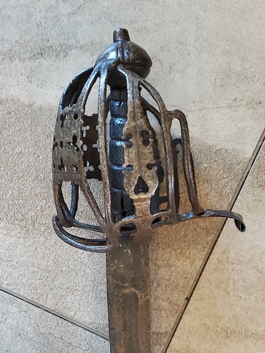

This is one of these, rehilted after 1784 when Black Watch ceased carrying these, this one remounted with M1788 Lt. cavalry blade.
Note the stark rudimentary piercings after the Scottish style.

Jim, that's an interesting hilt. I notice that the side bars have been lowered to the underside of the pommel to allow better wrist extension in the thrust.
Does anyone know just how early this feature came in? I have heard it referred to as a primarily 19th centaury innovation when British Military Swordsmanship became one discipline encompassing broadsword, spadroon and sabre under a single system as championed by Rowath etc.

Thank you for coming in. I am not sure what you mean about the side bars being lowered , for wrist extension for thrust? I'm afraid I am not aware of any such intention, nor any deliberate adjustment of the guard system for this purpose or other.
It is unclear exactly when these hilts came into use, but we know they were produced in London notably by Jeffries and Drury primarily. These are described by Anthony Darling ("Swords for the Highland Regiments 1757-1784", 1988, p.16)"
stating they represented "...a degeneracy in manufacture". and that,"...the guard is fabricated of thin sheet metal and devoid of line engraving. The triangular perforations are exactly that: triangles".
While most of these seem to be from 1770s, there are possibilities these or forms of them were around earlier. Clearly they sought to follow the 'Glasgow' styling in rudimentary form, and mostly seem destined for fencible and foot regiments, most notably the 42nd Highlanders, "Black Watch".
Most of them were turned in c. 1784 as these regiments ceased the carry of swords.
As I earlier noted, my example and several others I have seen were apparently mounted with M1788 cavalry saber blades.
