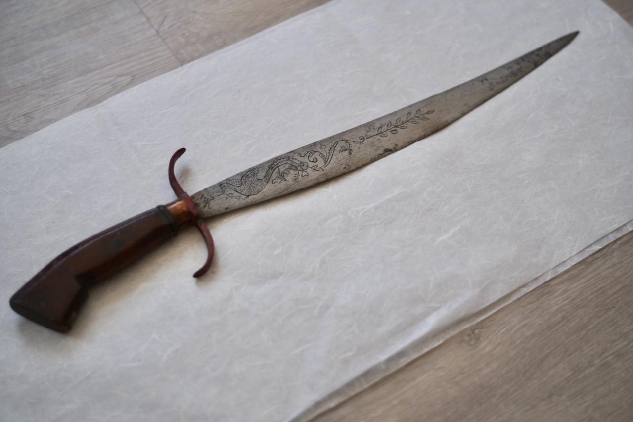

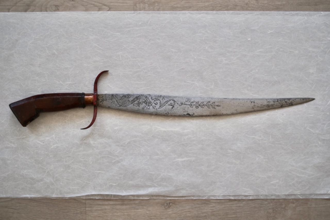

Sharing my Tailbong blade from the Pulahan movement in the Philippines.
The provenance of this blade from the person I got it from was that, it was taken from a dead native man in 1906 in La Paz, Leyte during the Pulahan Campaign.

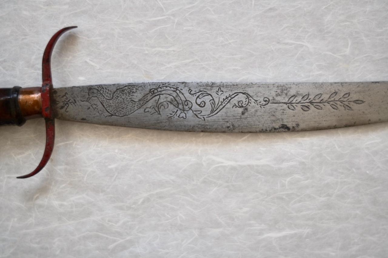

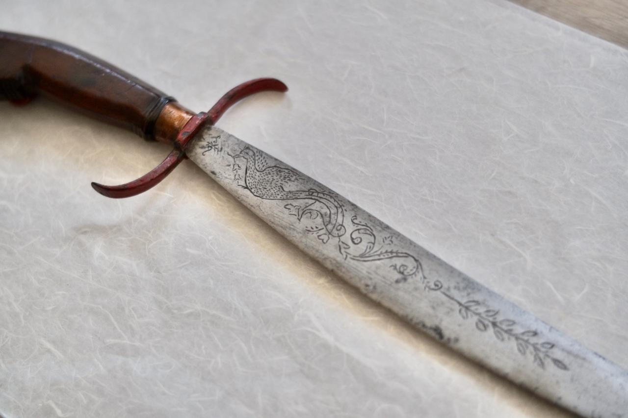

There is an engraving of a bird, I'm thinking perhaps a Sarimanok (?)
Hilt - 6in
Guard (tip to tip) - 4 3/4in
Blade - 15 15/16

I love the engravings.

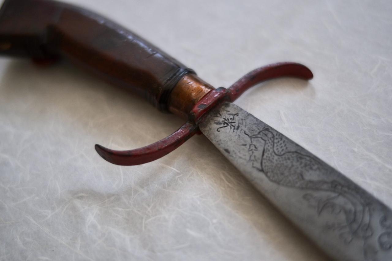

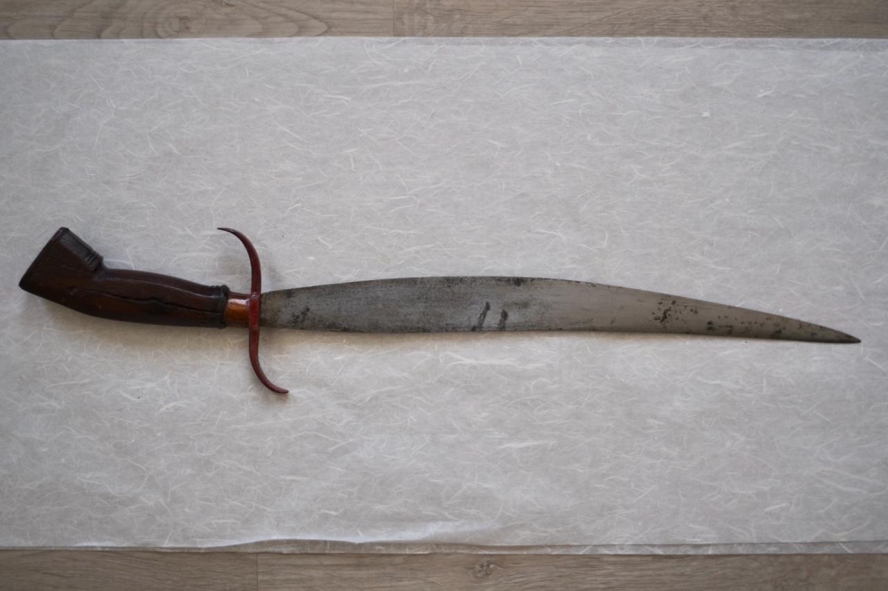

The blade looks more Tagalog to me. Hard to see details of the hilt. Does the tang go through the end of the hilt?

Most unlikely to be a Visayan knife. I agree with battara, this looks like a Central Luzon knife with a hilt often associated with Apalit (Pampanga) manufacture. The edge appears to have a convex grind (rather than chisel grind). The small iron ferrule and a "lip" on the hilt adjacent to the ferrule is often found on older knives from Apalit. Might also be from Lake Taal/Batangas area.
The sarimanok is essentially a Moro folk symbol, especially used by the Maranao people.

Agreed with what the others have said. The blade profile is a dinahong buo (sometimes called dahong bolo) of Luzon. It may have been mislabeled, a lot of bringback pieces have incorrect tags and provenance.

Thank you all for the feedbacks.
It could have been mislabeled indeed.
I’ve never seen another Pulahan blade besides this one- but the red guard definitely is a good indication wouldn’t you all think?
Pulahan (those wearing red) chosen color is red after all.
Would be great to identify the engravings as well.

Not necessarily. Many bandoleros (bandit groups) used red as the color of their standard during the insurrection eras, including but not limited to the Katipunan. Contrary to popular belief and as cited in several historical documents, the pulahans didn't actually wear red clothes in battle, and not all of them used the red standard (which may be why their were called "pulahan" in the first place).
...as my mentor would say, imagine wearing red on the battlefield. That makes you a very easy target, doesn't it? The Waray knew better than to wear red trousers + white shirts as their battle uniform. The pulahan, for the most part, did not have such a uniform. It's in the lesser-known books and historical accounts...one just needs to dig really deep and veer away from mainstream references.
The engravings are typical of Luzon bolos and can also be seen in Luzon leather scabbards.
I've read somewhere else that you've started a YouTube channel- best of luck on that. I'd strongly recommend getting a copy of the publication entitled "A Warrior's Armament and Ornament: The Edwin R. Bautista Collection of Philippine Bladed Weapons."
No offense to Cato, but a lot of info is either incorrect or inaccurate in his book. This latest publication sorts out a lot of things, and has the latest data. I suggest you get a hold of it, as it's been vetted by the best Philippine traditional blade experts, from both the academe and collectors' circles. It would be a good reference to base your content on.

Back to the piece - would you be able to provide close up pictures of the hilt, even of the butt of the hilt?
