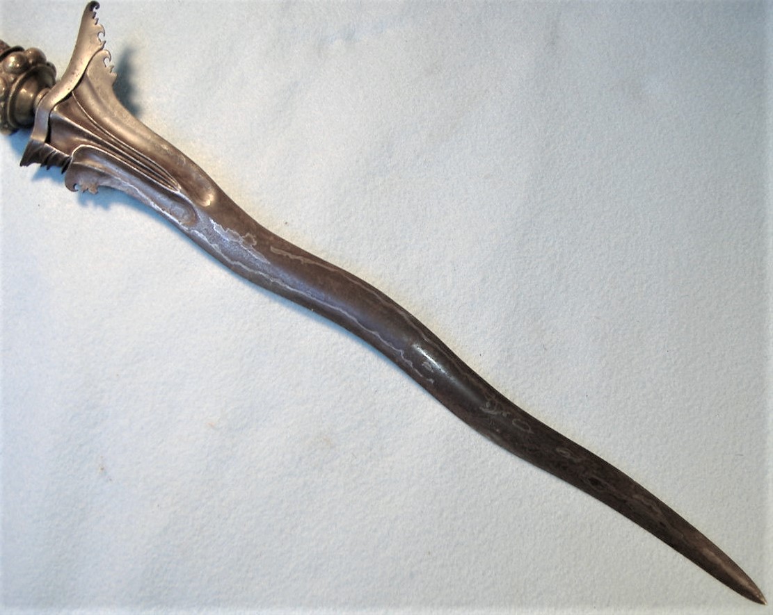

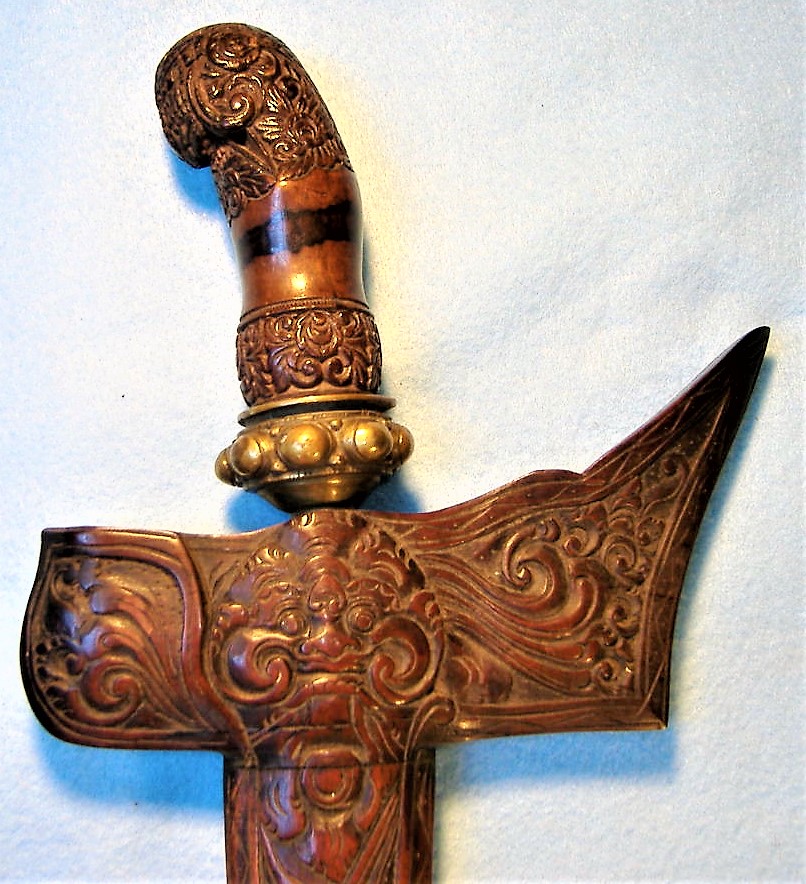

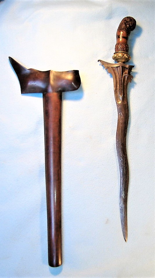

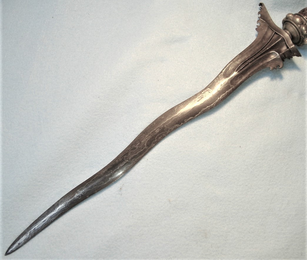

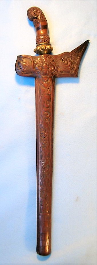

Default A Balinese Keris for Analysis
Here is another one for you guys to analyze. Normally, when I see a scabbard of this type I instantly think "tourist" piece, but this one as a serious heft to it, and the hilt reminded me of Balinese "cundrik" hilts. There patinated wear to the hilt and scabbard.
Sometimes you have to learn the hard way, so, your thoughts?
Old 21st September 2020, 01:10 PM   #2
Posts: 7,217
Blade:- Bali
Scabbard:- Bali, 20th century dancer's dress
Selut:- Bali
Hilt:- East Jawa
not bad individual component parts, but wrongly combined.

Alan, the hilt is far too large for any Javanese keris.

Hi Charles. This is a lovely Balinese keris.
On the sarung, does it appear that it was made for this blade specifically. Certainly it was made for a blade with gonjo wilut so it seems possible. I have not seen many dance keris sheath made for gonjo wilut, but if this sheath was made specifically for this keris than i can't see calling it a mismatch.
As for the hilt, i have a Bali keris that was once in the Frey collection that has a somewhat similar hilt. It too has led to some head scratching, but since this keris has been known to exist in this form since at least the early 1970s it is not some mismatched dealer special. It is, like yours, certainly an unusual hilt for a Bali keris though. So i am not going to dismiss you example as a mismatch too quickly, especially if, as you say, this hilt is too large for the usual Javanese/Madurese blade.

Hello Charles,
The hilt looks large because of the wrong balinese selut fitted to it but this type is originating from East Java/ Madura indeed.

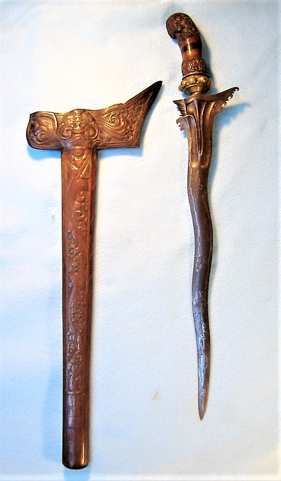

Thanks David. The blade and sheath are a perfect fit, with the mouth of the sheath following the curvature of the ganja. The hilt is maybe like an E. Java keris hilt on steroids, but particularly its girth would not match a Javanese hilt, much like the example you have shown. It would simply overwhelm and take the balance out of the aesthetics of a Javanese ensemble.

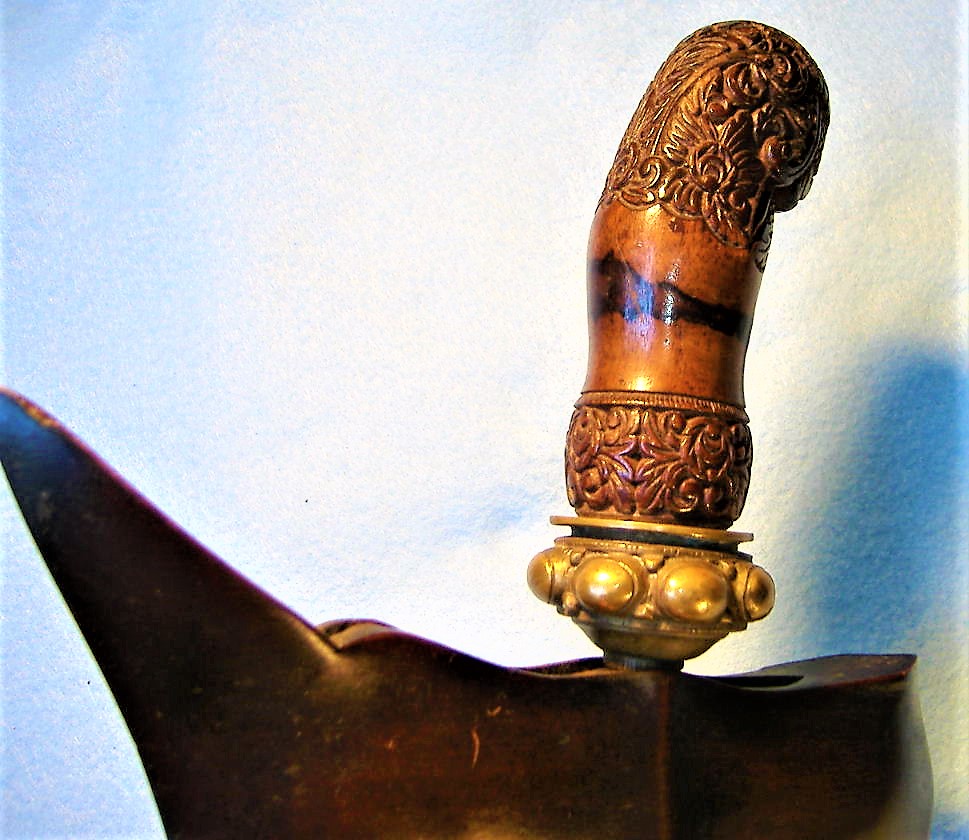

I think my pics just do not properly convey the size of the hilt. Its selut is a perfect fit.
These pics may help show the comparative size of the hilt, but I am not even sure these pics do the dimensions justice.

I would said this keris is awesome except the warangka (personal opinion). I would love to own this keris with a beautiful polished bilah.

Thanks Jean. Yes a similar( and lovely) hilt, but the size is much smaller than on that Balinese keris. It's easy to tell by the way it sits on the mendek.

Pics of a Madurese hilt more similar to yours, its height is 10 cm. The balinese selut is definitely misplaced IMO. From my experience these pieces are relatively recent (mid 20th century).

Charles, I suggest that you remove the hilt from the keris.
I believe that you will find that this hilt is sitting on top of the selut, not fitted to the selut.
Any selut is effectively a ferrule, it is supposed to fit around the base of the hilt, and was originally used to prevent the hilt splitting. On the keris under discussion I believe you will find that the hilt simply sits on top of the selut.
The hilt itself is an East Javanese style, it can also be found in Madura, and Madura itself is a part of East Jawa, and it can be found along the North Coast of Jawa, but only a small distance to the west of Surabaya, whereas it can be found anywhere east of Surabaya. There can be no question at all that this is an East Javanese hilt.
We can forget about the size of the hilt being any sort of indicator, size is totally irrelevant in this context.
There is at least one hypothetical, but I will not address that until after the hilt has been removed from the keris.

The hilt is, indeed, sitting centered on the selut. So, you guys’ observations of it not being properly set seem to be correct. If I wanted to get a new hilt for the good blade, what kind of hilt should I get that would most correctly go with the scabbard???

Charles, this is a jamprahan sarung, in olden times, say, pre-puputan, this style of sarung was normally worn by very religious people, not necessarily priests or preachers, but usually lay people who took their religious duties very seriously.
It was usually paired with a kusia hilt. The kusia hilt style is rather rare, and these days the kusia and the kocet-kocetan style are more or less considered to be the same, which they are not quite, but the difference is very slight, off the top of my head I forget exactly what the difference between the two is, something to do with the face I think, but I'd need to look it up.
I'd say either a kusia or kocet-kocetan hilt would be the hilt of choice for this sarung.
However, since this sarung is a rather recent creation I am relatively certain that it was not intended for the original purpose of this style, so an ordinary bobondolan style that was inlet to accept the selut would also be just fine.
