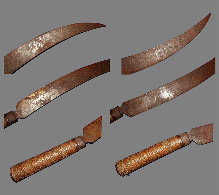

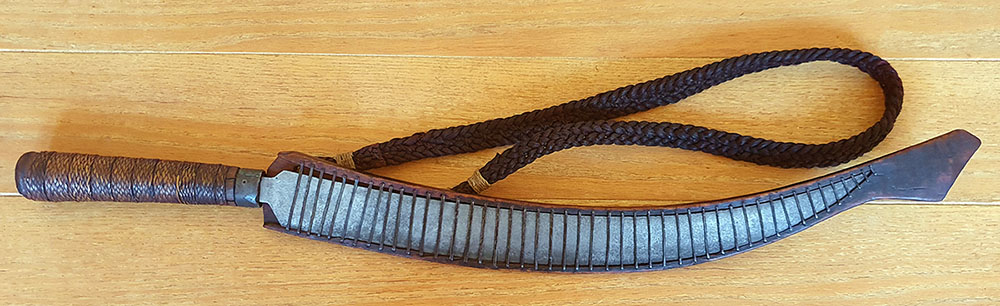

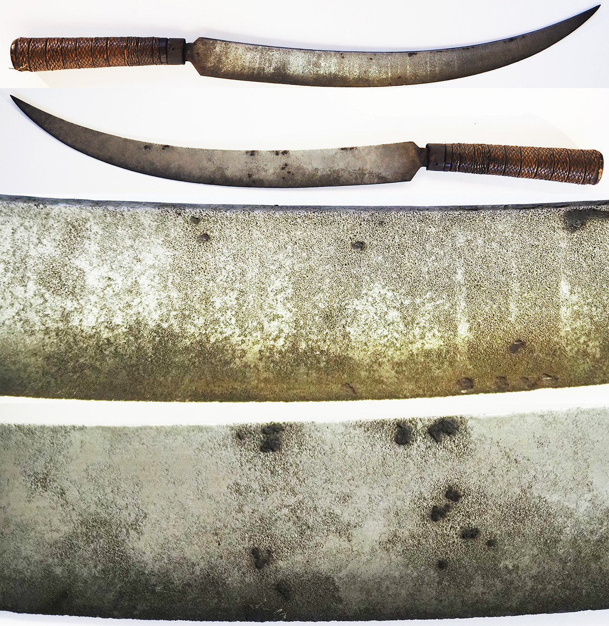

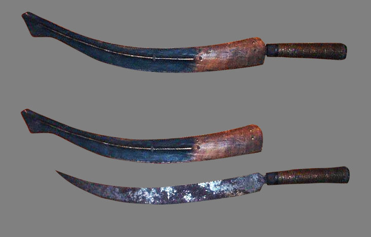

I was pretty pleased to win this Atayal knife yesterday on Ebay. It came out of a lot from Japan. I've cleaned up and organized the Ebay photos a bit. I think this would be late 19th or early 20th C. The darkened area on the back of the scabbard is interesting, it looks intentional but not particularly decorative. That would be the part of the scabbard visible from behind per the style of dress/carry in the attached photo. Perhaps for stealth?
My plan to attack the rust is to start with white vinegar soak followed by sand paper, please let me know if there is a more recommended method. I am also wondering about repair/stabilization options for the rattan on the handle.

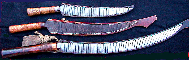

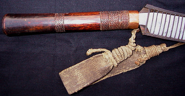

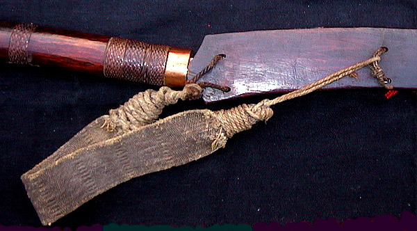

Here are some I have had. They vary considerably in size, from knives up to full sword length. Blackening on the back of the sheath of the largest one is also present.
This is very similar in style to your middle example. On the large one, is the baldric original?
According to the seller this one 63cm OAL and 71.5cm in sheath.

Hi Jeff,
The loop on the scabbard came with it and appears to have some age and wear. As far as the rattan, I would simply give it a light oil to moisten it up again. The rattan dries out in our climate and gets brittle over time.

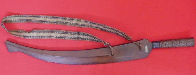

I guess it is much too short to be a baldric or even a belt. I was curious after seeing the one that yuanzhumin posted in 2011 (image attached) which includes an interesting woven baldric. I have since gone through, via web search, a heap of photos and written material and seen a range of carry options including over shoulder and at waist (and even both simultaneously), as well as another example of a short loop. Waist carry seems the most common. I've also noted a range of belt/baldric materials including simple rope, bamboo strip, and a range of woven and beaded examples.
One would think there would be a bit more common practice within a tribal group.

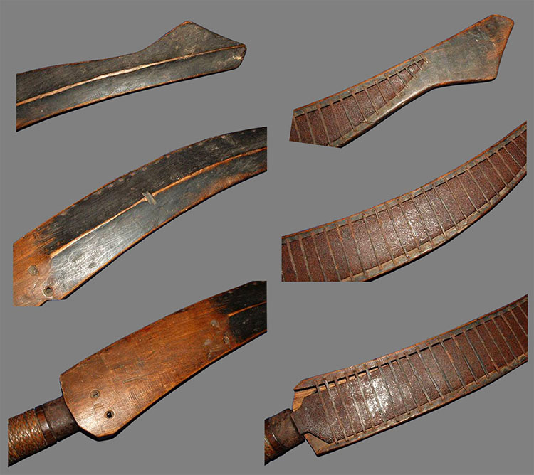

Here are some of the photos in case of interest

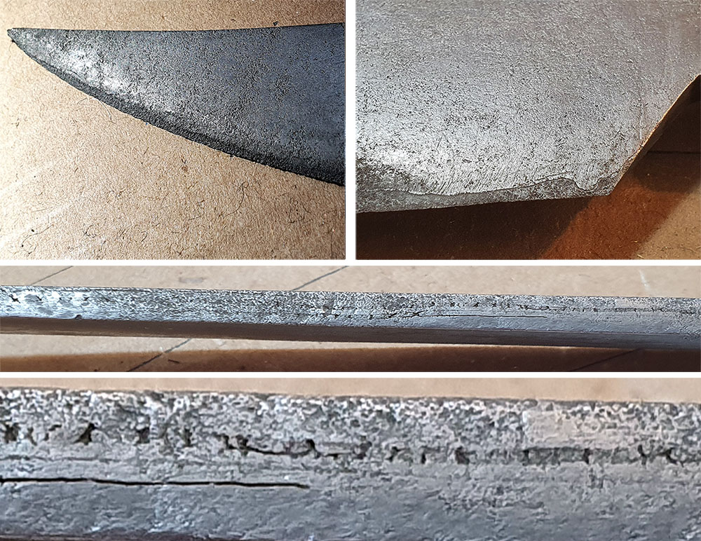

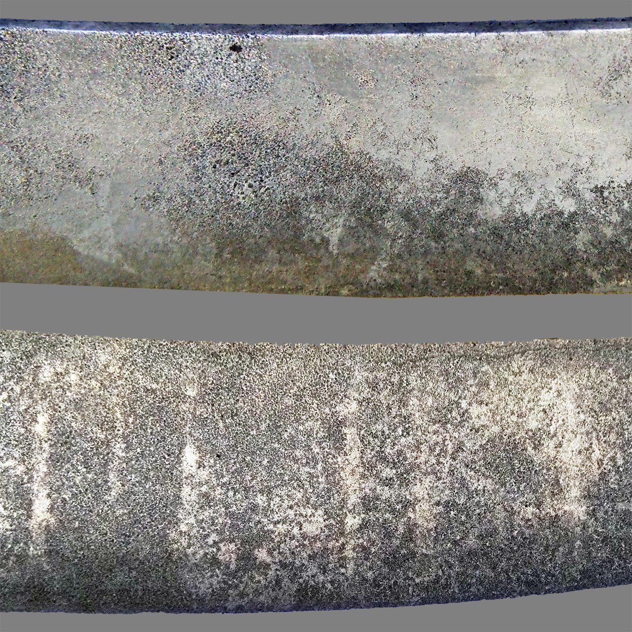

Hello - here is a 5 day update and request for advice. I've been doing vinegar soak followed by brass brush and Rhodes Grade 00 steel wool about 3 to 4 times a day. It has been in and out of white vinegar continuously this entire period. Definitely an exercise in diminishing returns, a few very stubborn rust spots as seen on the photos remain. Overall the surface is covered in pits, I wouldn't classify them as particularly deep but very widespread. If I continue on this path I will end up with the stubborn rust spots removed but the overall blade quite rough from pitting. Again I'm inclined to move to sanding, starting at maybe 320 to subdue the pitting and moving up incrementally to 1500 grit for polish.
Old 26th September 2020, 09:25 PM   #12
Hi Jeffs,
Keep going with the vinegar soaking.....it will shift the rust, but GIVE IT TIME. If you have a piece of rigid brass (sheet or bar), you could use that to loosen the caked rust. Use it like a wood chisel. Brass is softer than steel so will not scratch it.
It looks to me as if there is still rust in those minor pits also.
Stu

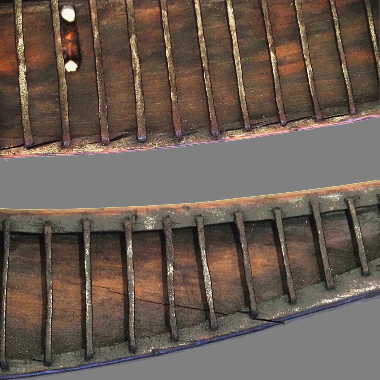

Here we are now. The bumped contrast makes the pits seem darker than they are to the eye. Except for a couple small spots I believe the rust is completely gone now, perhaps one or two more soaking rounds. Note the blade on the open scabbard side has much more extensive pitting, you can see the outline of the staples. The question is, what next?
Also, please see the scabbard photos. What options are there for repairing the cracks? I've been feeding the wood oil for several days but the long thin crack at the foot of the scabbard is not closing. The crack series along the staples have wider gaps but seem more stable.

Hi Jeffs,
Good job IMHO. I think you have now reached the stage where you need to decide how far you want to go. Bear in mind that the knife has age so unless you want something which looks "shiney new" I personally would not go any further with the blade (just my opinion) Some like to "restore" to the extent that all of the age patina is gone.
Regarding the scabbard, I would stabilise that long crack with a suitable wood glue, other wise there could be a risk of total breakage. The small cracks along the edge are probably age cracks, so I would leave as is.
Note the above is my opinion and no doubt others will have different suggestions.

Depends on how dry the wood is after you have oiled it. I would use PVA wood glue if the wood is dry enough. Apply glue and then clamp the crack together and allow time for glue to dry.
What is your plan regarding the rust on the staples? If you are able to remove them from the scabbard easily then maybe they should be soaked in vinegar also. I have never owned one of these knives so don't know how the staples are fitted. If they can not be removed easily then maybe rub some vinegar on them with a rag.
A word of caution....If you do remove the staples make sure you number them so they go back in the same place. They look to vary in length.
Stu

JeffS, I've been reading about your progress in the cleaning of your very nice and rare sword, and the only advice that I feel qualified to give you is"DO NOT REMOVE THE STAPLES."They will break, the wood will splinter and they will never go back in the way they came out. I would gently use the brass casing first and then sandpaper; make sure that the metal strips are supported from the underside as you softly apply pressure from the top.

Good advice on supporting the staples from underneath. I hope to be able to remove the active rust but not lose all the dark patina.

I agree with Drac. I had not thought of the staples being brittle. Leave them in and support from underneath.

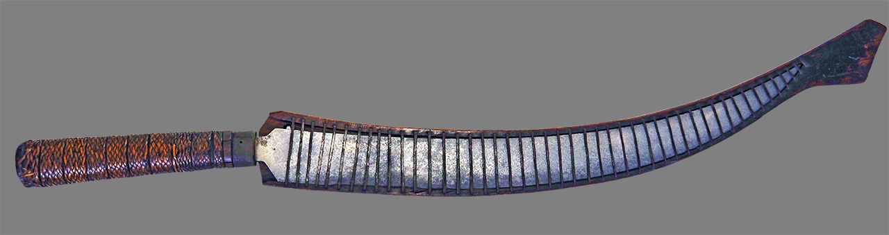

Here it is after finishing rust removal, oiling dry stuff and fixing cracks. Also, below is a close-up of blade detail. It looks like a layered construction versus an inserted edge to my novice eye. I find the perpendicular gaps interesting that track some of the layers.

Hi JeffS,
What a difference!! Great job if I may say so.
