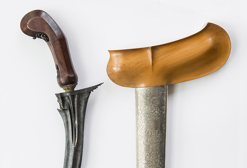

I would be grateful for any advice on the quality, age and pamor of this 3 luk Keris please. 47cm total length.

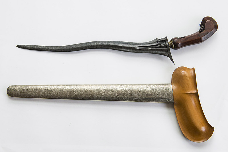

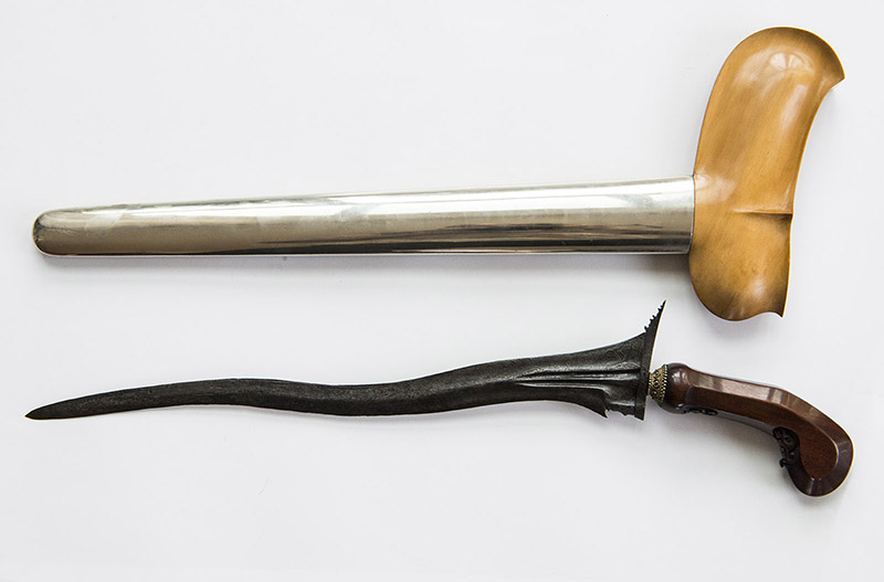

It displays some characteristics that can be interpreted as Majapahit, but I most sincerely doubt that it can be attributed to origin during the period of the Kingdom of Majapahit.

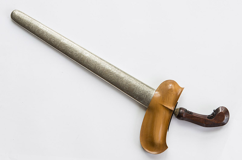

It is very probably East Javanese, possibly before +/- 1850, the dress is good quality, the pendok I assume is silver, and would weigh around 110grms, it is engraved and probably this would prove to be very well executed, but I cannot know this from these photos.

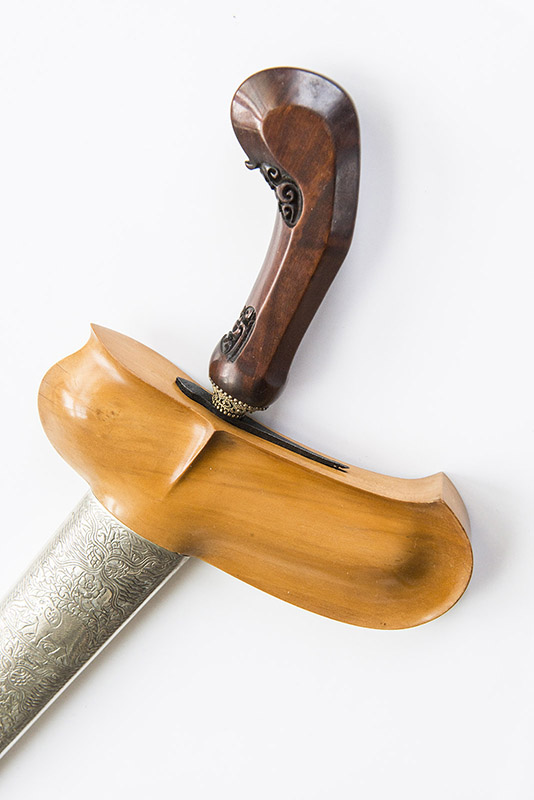

The wrongko is very probably scented sandalwood (cendono wangi), the grain is aligned beautifully, this wrongko is the work of a master.
I cannot say much about the hilt from photos, I would need to handle it, the mendak should be silver, but even so, it is a standard pattern lung wideng, nothing special.
All the dress is Solo work, and very good quality Solo work at that, I would guess that the dress was done between about 1985 & 1995.

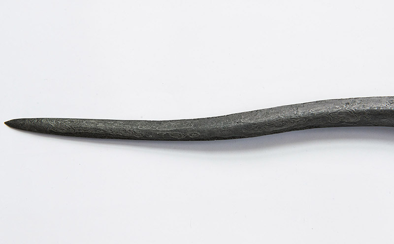

The pamor looks like random pattern, wos wutah.
This is overall a very nice keris.

I can only second what Alan has written, but wanted to remark that i see you have expanded from your usual interest in Balinese keris in respectable style.

Thank you for your detailed advice. I had no idea about the wrongko and what to look for at all so I have learned something new for which I am very grateful. I'm glad that you think the keris is nice overall.
