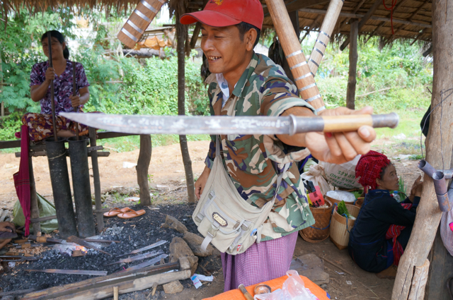

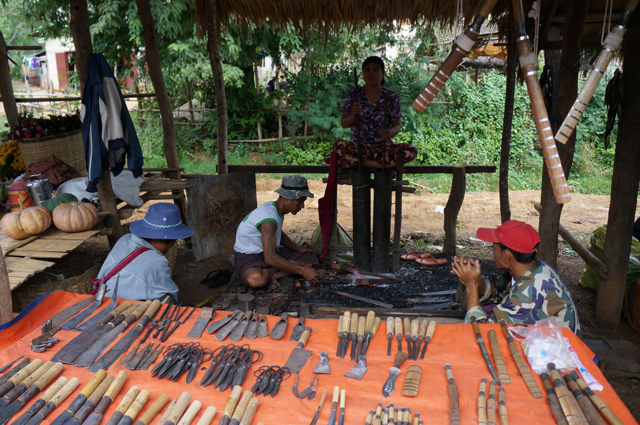

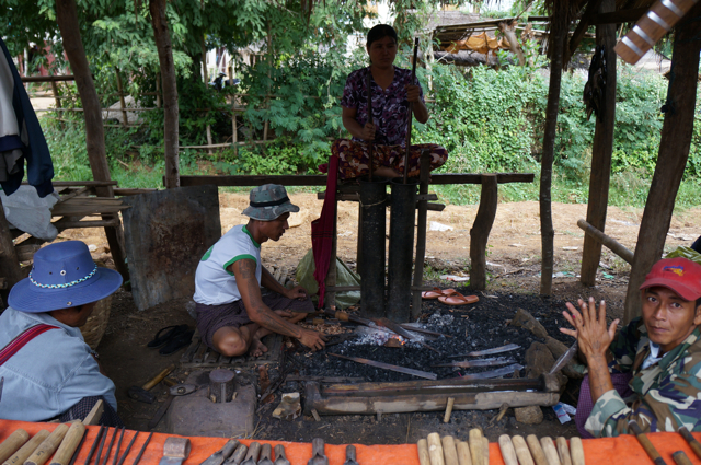

Hello. Here are a few from a trip to Myanmar last year. I thought some members might find them interesting. The forge was found at a market on the shore of Inle Lake.

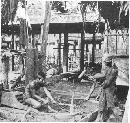

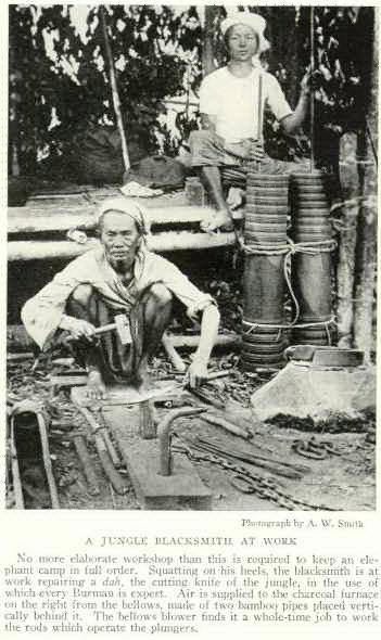

Some pics of Burmese forges from 1900 - 1910. Photos borrowed from the Dha Research Archive.
Thanks for sharing, always nice to see the traditions being kept alive.
