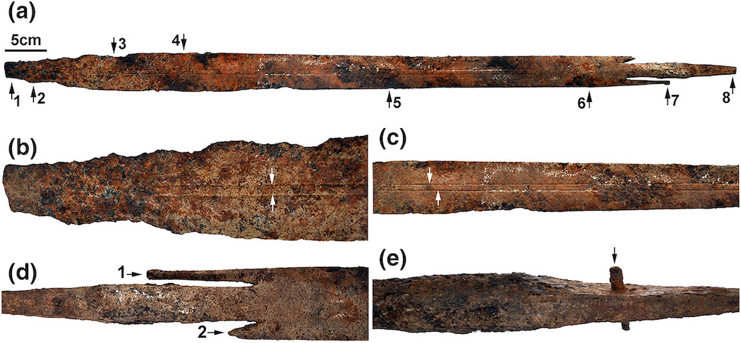

I have attached larger images of the sword, which appear as Figure 1 in this article and have the following description.
Figure 1
General appearance of the double‐edged iron sword under investigation: (a) general appearance, where arrows locate the spots from which specimens were taken for metallographic examination; (b, c) magnified view of the tip and the body, respectively; and (d, e) magnified views of the hilt.

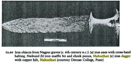

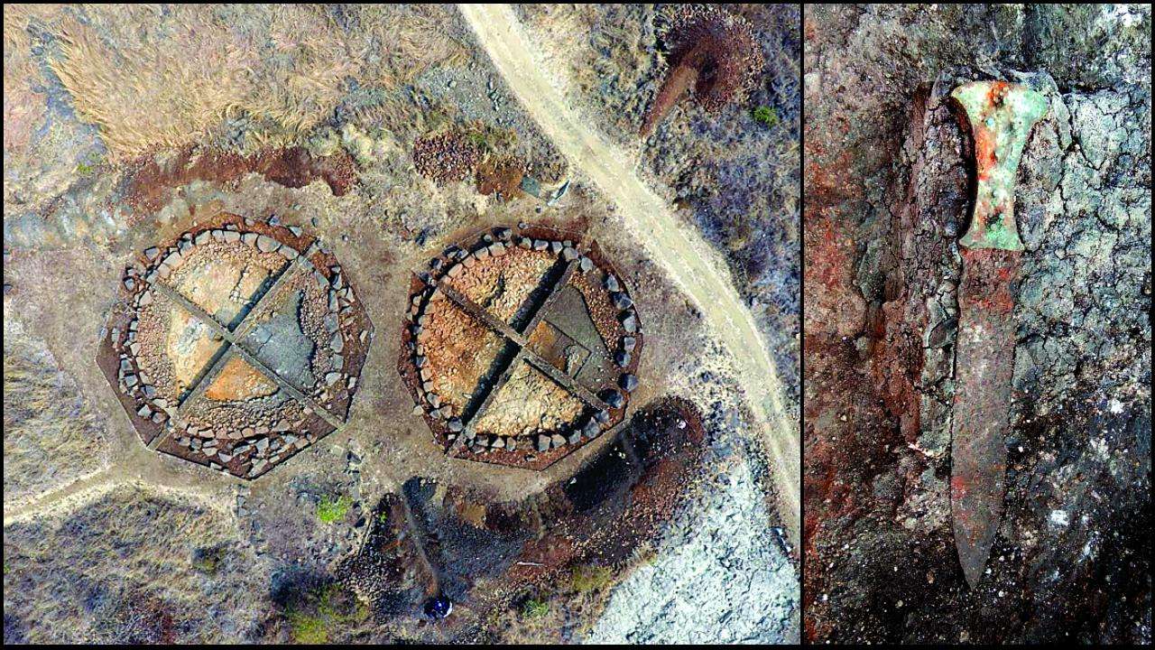

If it's a megalithic culture of S. India it's pretty old. Crucible steel production is known in early on S. India and Sri Lanka. Just not in the manufacturing of something like a sword however, until now.

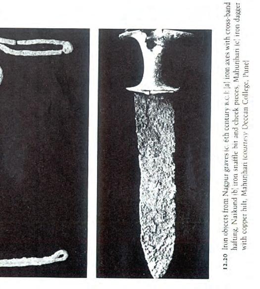

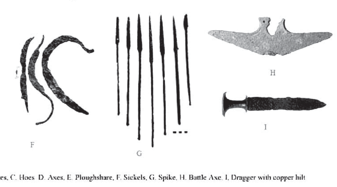

Recently they found a iron dagger, riveted copper hilt as well. With sheets of metal riveted together to form the hilt.
The first one is a recently found copper hilt with rivets. The rest are from an early dagger found dating 6th century BC without rivets, but similar hilt design.
https://punemirror.indiatimes.com/pu...w/68339114.cms
The hilt design is old as seen from the 2nd-1st Century BC warriors. I havent seen the hilt design again after 1st Century AD+, at least not in India.

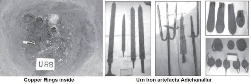

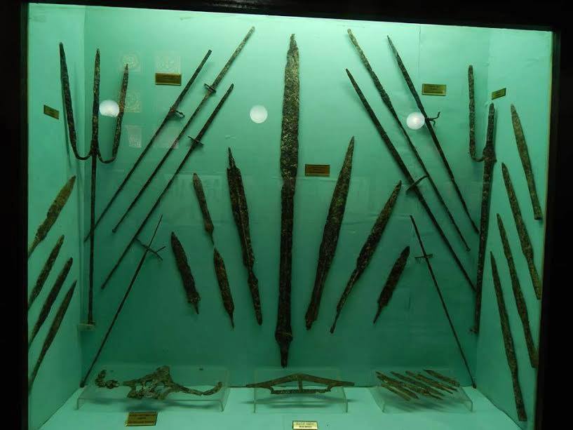

This might be interesting to some as well. Early Iron weapons are showing up in megalithic sites in the South. It's currently a developing topic.
The hilt design in one of the swords has a similar shape to the daggers above, and the relief, statue already posted.
“Even as the survey had begun for excavation, the Centre has decided to set up a museum at Adichanallur at least now, which would tell the world about the ancientness of Tamils and their civilisation. The carbon dating conducted on the products recovered from this site in Florida labs had proved that it was at least 2,900-year-old civilization. If the excavations are done properly, the world will be surprised to see how advanced ancient Tamils’ life was,” says Mr. Kamarasu.
https://www.thehindu.com/news/nation...le30716873.ece
Carbon dating of samples excavated from the Adichanallur site in Thoothukudi district has revealed that they belonged to the period between 905 BC and 696 BC.
The March 18, 2019, carbon dating report of samples that were sent to Beta Analytic Testing Laboratory, USA, was submitted to the Madurai Bench of the Madras High Court on Thursday.
https://www.thehindu.com/news/cities...le26737779.ece
