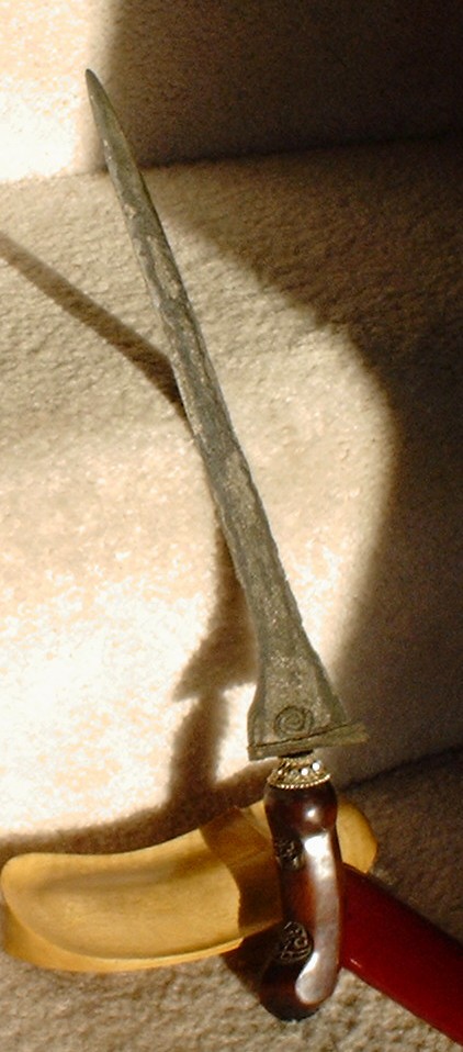

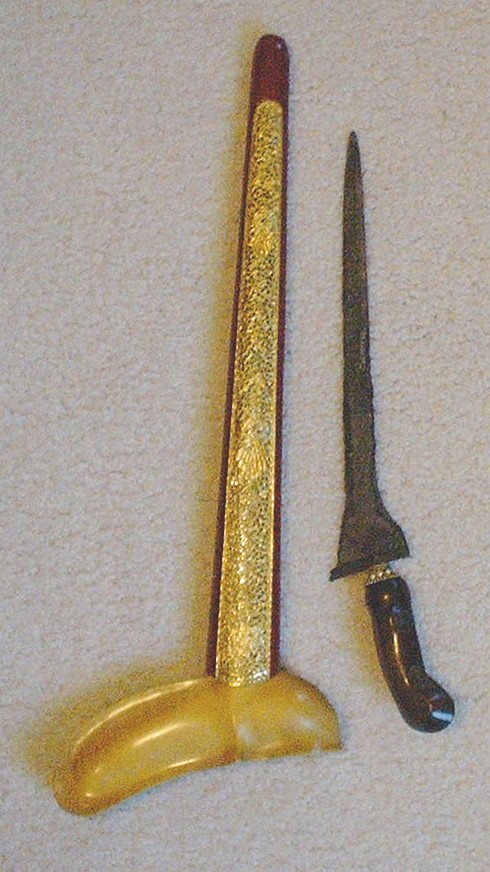

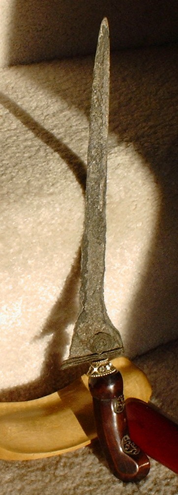

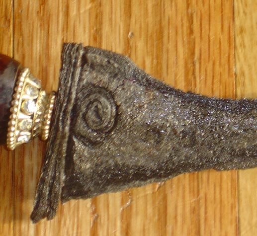

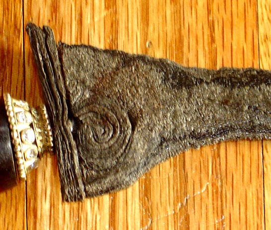

I took a chance and purchased this Keris... the blade appears to be very old with corrosion that looks like "mud cracks" and small pits. The Keris is small (the blade is about 24.0 cm) with what appears to be Kul Buntet pamor. The peksi is replaced, but you can see the original peksi between the ganja and the blade (where it is corroded and shows through).
Any ideas on how old this Keris may be? Genuine?

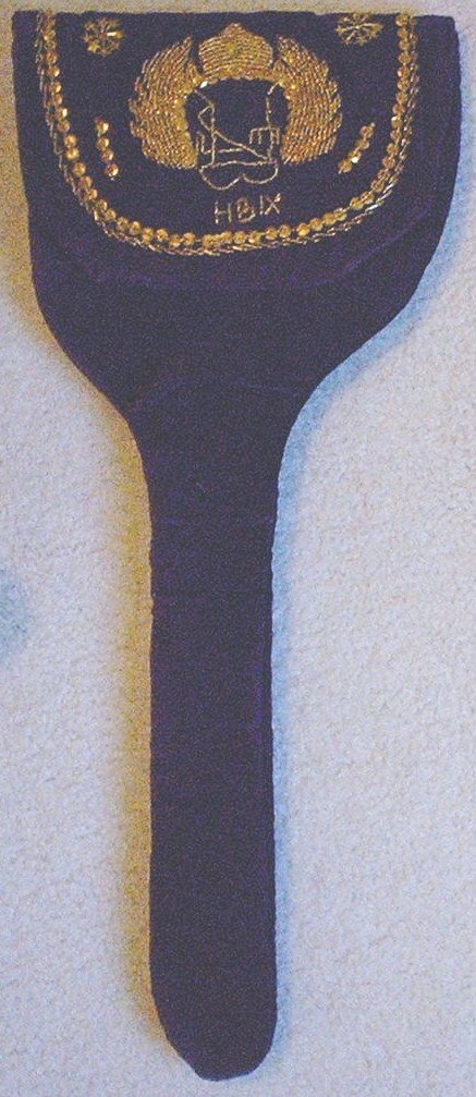

It came in this Keris bag, can someone tell about it too? Thanks!

It looks like pamor Kul Buntet to me. Looks also like a very old blade. What do you mean by "the peksi is replaced"? The peksi is the angle on which the mendak and ukiran is mounted and that is not visible. The Jogya dress is brandnew, but to me it looks like a very nice keris.

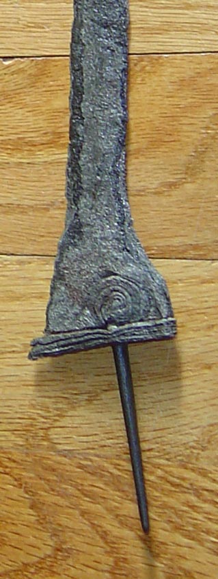

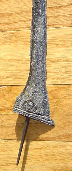

The peksi looks new (not corroded at all). It appears to have no pamor. It was an expert job in replacement... but it has a slightly noticable smaller diameter than the original (you can still see the original, as earlier stated). Otherwise it is perfect.

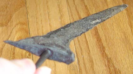

Default Here are some more Pictrues
I hope these are helpful...

Yes, that is a new peksi. Welded again to the keris. it is also possible that the old peksi is still present. The age of your keris and the many etchings might have eaten away the original peksi. This new peksi could be a tube on the lower site and placed over the remaining peksi. Nevertheless a beatiful old blade in my opinion.

the letters "HB IX" on the bag stand for Hamengku Buwana IX, the former sultan of Yogyakarta. He was the traditional ruler of Yogyakarta from 1939 until his death in 1988. He is still very popular and highly honored for his role in the struggle for Indonesian independence 1945-49.
The emblem looks similar to the coat-of-arms of the Keraton Ngayogyakarta Hadiningrat, his palace.

The blade looks like it has pamor; do you think it is with nickel or a phosphorus iron?
The dapur and size reminds me of a 14c Keris, any ideas?

The blade has pamor, thats for sure. Tammens wrote in his books about different colors of pamor depending on the kind of metalls that were used. Tammens wrote also about research on the metal of keris and that older keris show after analysis that during the forging-proces meteorite pamor was used. Meteorite metal contains nickle in different degrees.
In my opinion it is an very old blade but I don't have the courage to date it.

YES, IT IS VERY DEFINITELY AN OLD KERIS. IT IS IN VERY BAD CONDITION, BUT IT IS AN OLD KERIS, AND BEFORE IT BECAME SO BADLY DEGRADED, IT WOULD HAVE BEEN A FAIRLY ATTRACTIVE KERIS. FROM WHAT I CAN SEE IN THE PHOTO, IT LOOKS AS IF IT COULD BE PAJAJARAN, BUT TO CORRECTLY READ THE INDICATORS OF TANGGUH,IT IS OFTEN NECESSARY TO HANDLE A BLADE.THE CONTRASTING PAMOR MATERIAL IN YOUR KERIS PROBABLY IS WHITE IRON.

THE CLOTH BAG IS CALLED A SINGAP. IT IS THE WAY IN WHICH JAVANESE KERIS ARE NORMALLY STORED. EVEN WHEN A KERIS IS STORED IN A SPECIAL KERIS CHEST, IT WILL NORMALLY BE PLACED IN A SINGAP FIRST.

Also, the Keris bag (Singap)....
I did not expect to receive this bag with the Keris, so it did not influence my decision to purchase the Keris. I was a bit surprised to see the embroidery work (all the others I have are "plain")... and more than surprised to learn that it contained the initials of Sultan Hamengku Buwana IX!
Are there other Singap out there like this? Was this done to deceive or is there a legitimate reason for the embroidery?

Hi, there are lots of singap out there with initials of various Javanese kings embroidered/sequinned on them, not the least HB X. I have at seen at one particular shop half a dozen of such singaps, so don't place too high hopes on them. And on Javanese kerises, especially the pendok, one often sees the royal insignia engraved at the back, and I'm quite certain the kerises had nothing to do with the kraton.

I did not have any high hopes (in fact, I was suspicious of Keris when I saw the singap)... I was just curious if this was a "common" practice (maybe by power of association to have such an honored person/place embroidered on the singap) since I have not seen one like it before. The quality of the embroidery wasn't good enough to impress me that it would have belonged to a Sultan. The mendok doesn't meet the quality one would expect to see on a Royal Keris. The Keris was not advertised to be a Royal Keris. So I did not have any reason to expect an association to such a high person and place.... but I had to ask.
