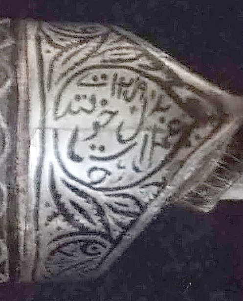

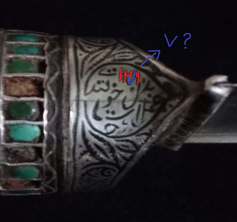

It has been a while since I posted something, so here goes.

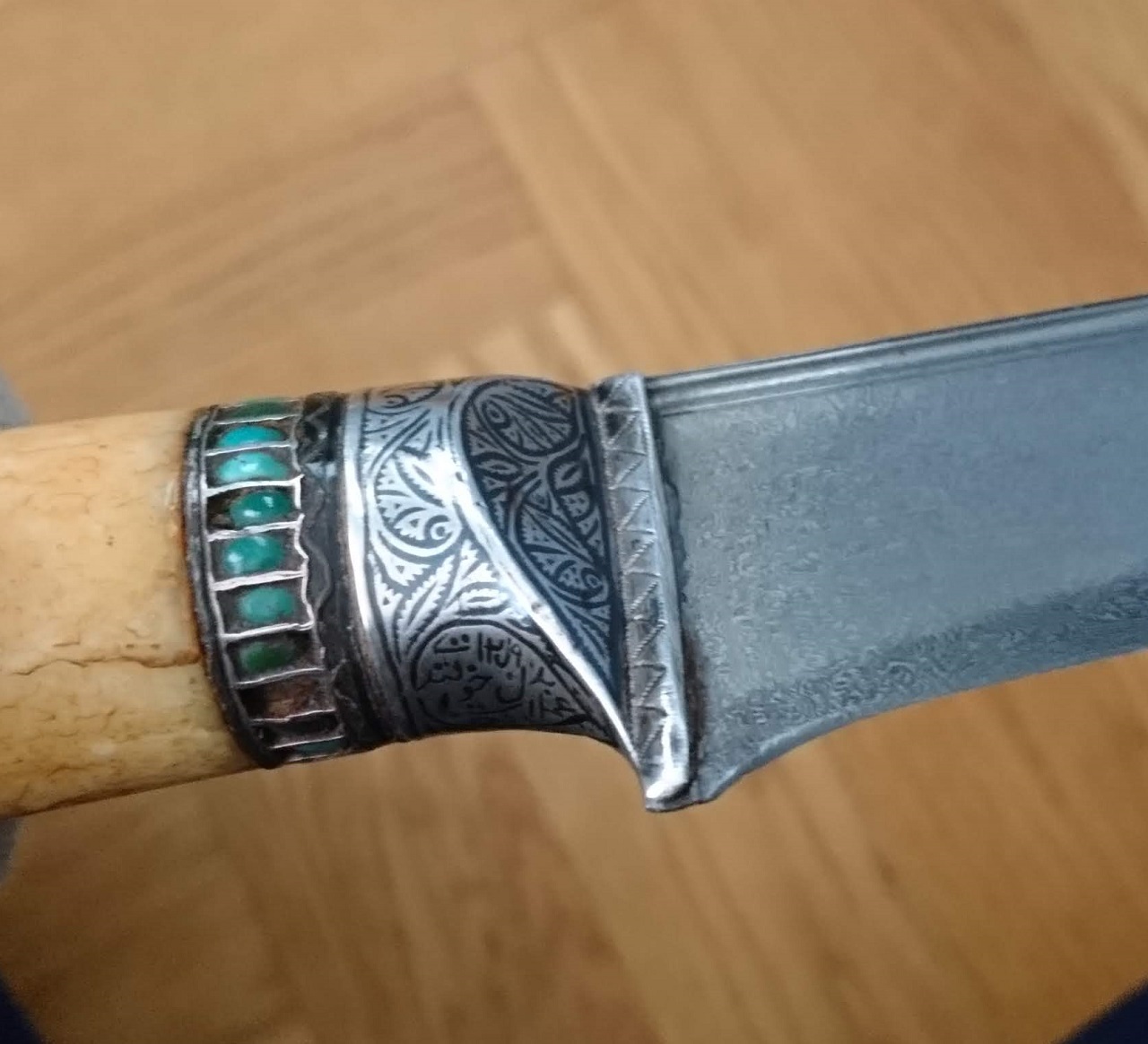

This is a large Uzbek knife that has come into my collection last year. It sports a very nice wootz blade, which I gave a light repolish and etch. The grip is made of one piece of walrus ivory and is separated from the bolster by a band of inlaid turquoises, unfortunately with a few losses. The silver bolster has typical niello decoration and additionally sports a cartouche on the underside, also executed in niello.
Now I have tried my darndest to decipher the cartouche myself, but I cannot make any headway. I can make out the 'amal' in the lower right corner, so I am pretty certain it is a maker's mark, and also the numbers 129 at 12 o'clock (read as 1129 AH this would correspond to 1717 AD which would be rather early).
I would be very grateful if someone more proficient could give this a try.

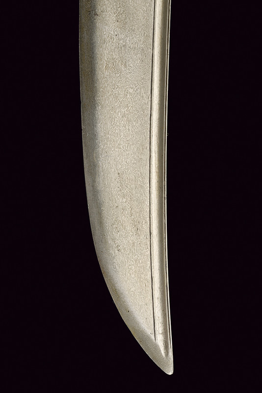

I do not think that the blade is cut down, take a look at this example from Czerny's (also re-sold on oriental-arms recently), which has an identical arrangement of the fullers.

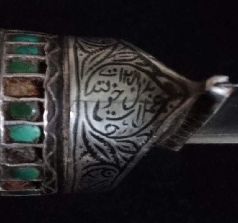

I think it says:
عمل استا بلال خوقندی ۱۲۷۹
"Work of Usta (Master) Bilal Khuqandi 1279 (1862-3)"
This locates it in Kokand in eastern Uzbekistan

Thank you so much, I never would have gotten that myself!
If I understand you correctly the 'alef' from Bilal is partially rubbed out and the 'lam' like sign inside the date is actually a malformed 'haft'?

Like this:
GePi is offline   Reply With Quote
Yes. I don’t think it’s rubbed out as much as written quickly. This is not a professional scribe’s hand. There is an extra dot within the lam of the name Bilal, which made me question this reading. But I can’t think what other name it might be
kwiatek is offline   Reply With Quote
Old 8th June 2020, 11:59 AM   #10
kwiatek
Join Date: May 2019
Posts: 156
Like this:
Yes! Again, not a professional scribe’s hand
Old 8th June 2020, 12:09 PM   #11
Yes, 1279.
If so, it is 1862-63 Gregorian.
High class knife, congratulations.
I think the extra dot belongs to the 'nun' from Khuqandi and has just wandered off to the side.

[QUOTE=GePi]I think the extra dot belongs to the 'nun' from Khuqandi and has just wandered off to the side.
Could be, yes. I can see there is a waw too below, so Usta is spelt اوستا, which I’ve seen in Central Asia

[QUOTE=kwiatek]
You are right, it's also not quite completely formed. That only leaves the sign on the left of that unaccounted for, which looks a bit like a 'jim' form letter connecting into the border of the cartouche.
