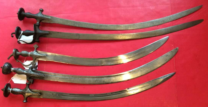

The majority of sabers from that area were used by mounted warriors.
Their blade length was calculated to be: a). sufficient to cover the entire body against a blow, be it vertical, horizontal or diagonal; b). sufficient for the mounted warrior to reach an enemy laying on the ground.
Usually, to achieve both goals the blade of a cavalry sword was ~30-33 " long.
Here are Indo-Afghani swords that pose a question.
The upper two are standard Indian tulwars. Blades 30-31". They are given just to provide a reference point.
The " swords of interest" (lower 3) all have blades 25-26"
Two of them are typical Afghani, one ( the upper one) is uncertain to me , with a Damascus blade, and I shall be grateful for a more precise attribution.
One Afghani and the " uncertain one" have blades wide enough to be defined as Teghas.
Dating of all is welcome.
My big question: what were they used for?
Unless their owners were riding donkeys, they are not long enough to reach the ground without the rider bending over.
Were they infantry weapons?
European grenadiers were often equipped with shorter and massive swords. This is a rather feeble argument, but it may suggest some parallelism.
Sorry, the order of pics is reversed:-(

The normal length of talwar is when a standing person keeps saber lowered and its point does not reach the ground a bit. For average men growth, this is talwar about 90 cm length. If a person is shorter (or Indian horses, which were almost like donkeys), then the saber length accordingly is less, but the mass of the saber must be sustained (about 1-1.3 kg), therefore they are more massive.
Infantry talwars should have been less curved than cavalry ones.

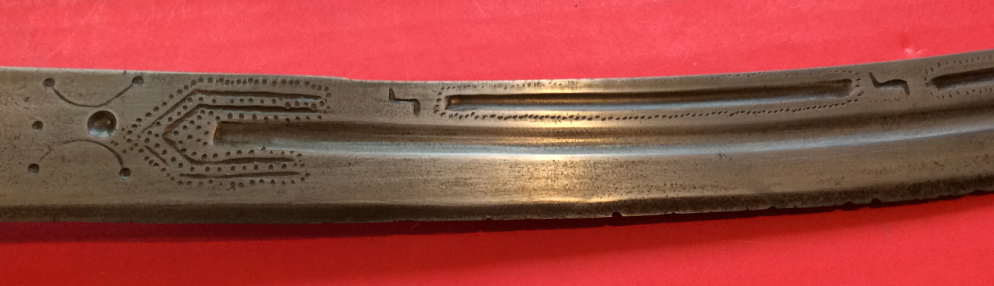

Short-bladed #3 ( the lowest) has a mail-piercing ( zirah bouk-ish) tip, implying stabbing as its significant function. Any thoughts?
Not that your original question want a good one, but I find this question very compelling. I am sure there are plenty of examples and that I have simply not thought to pay attention, but I don't think I've seen a zirah bouk tip on a curved blade (of sword length) of a form typically associated with slashing cuts. Is this at all common and does it prove the thrust was part of established tulwar play?

You are correct: “ zirah bouk-ish” Indo-Afghani swords ( not daggers!) are very rare. I can recall seeing maybe 3-4, no more. But they do exist. One could entertain an idea that they might have come to Persia/India from the nomads: kind of atavistic feature, akin to our coccyx:-) By many accounts piercing/stabbing was not a part of Indian swordplay.
Were the short-bladed swords merely individual orders for especially short individuals? Why all 3 have very broad and as a result heavy blades?
Usually we assume that short-bladed sword from N. Africa/Arabia belong to a “naval” group; tough to include the Afghani ones in it.
A whole bunch of open questions.

In regards to the "zirah bouk-ish" sword I would point out that the blade shape is both in form and decoration blatantly 19th century - which is to say it was made during the "twilight of the sword" when such weapons were more often carried for display & status than for anticipation of combat. Don't get me wrong, of course plenty of people were still using swords to fight and kill each other on every corner of the planet - and this blade is by no means an exception, I'm sure it could be quite deadly when properly used & sharpened - but this use was quite limited by the extensive colonization and use of firearms that defined the era. As a result, I would argue that this Afghan trade blade (as I have seen this particular blade type identified as) was made primarily with show in mind, and not to demonstrate or emphasize any particular martial concept.
In regards to blade length and curvature (in general), I would just say "different strokes for different folks." Some people fought more in close quarters, and as a result needed smaller blades. Given the emphasis of draw-cutting in Indian swordsmanship, it makes sense that the curve of these swords - as well as their weight - would be condensed to match their size, so as to not throw off the user when handling them (or at least that sounds like a logical reason for the proportions in my mind). Overall they're just Indian/Indo-Persian cutlasses, not much more to 'em.

In no way a blade with such curvature and width, could possibly penetrate even modest armour.
The shape of the tip is most certainly purely decorative.
As with regards to the blades size/weight, cavalry blades tend to be somehow longer and heavier.
However, this is valid ONLY when talking about regular, standardized military European units.

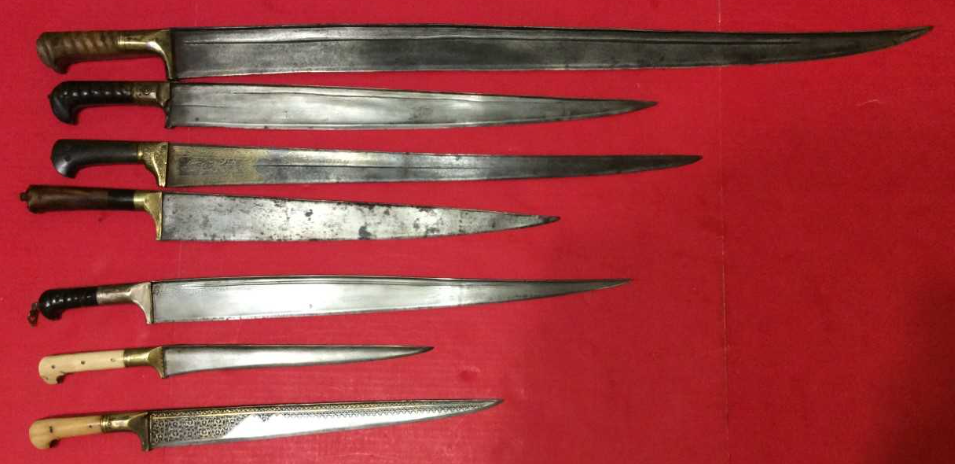

.....swords should be standardized like the late khyber knives for example.
OK, how "standard" are these Khybers, all 19 century, except for two potentially earlier?
