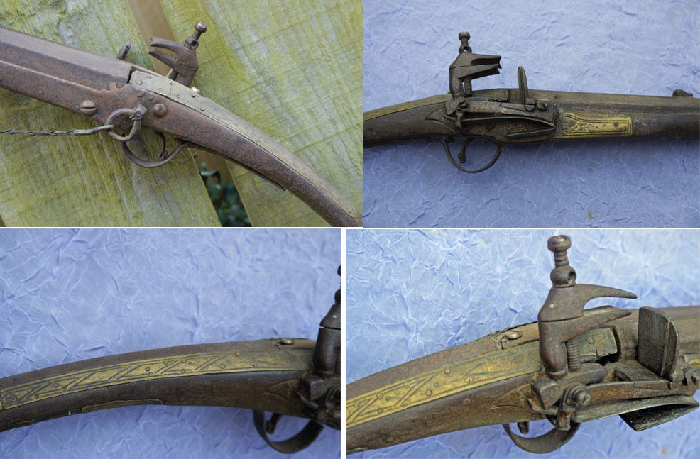

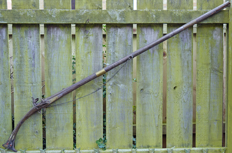

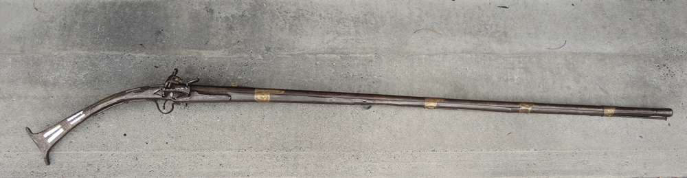

Lucky enough to find an attic fresh, untouched North African? Jezail this morning.
It's quite an elegant example with a slender stock but the thing that intrigues me most is that the entire construction is steel, apart from three inches or so, of wood set in at the base of the stock where it has some applied decoration. The frizzen looks as though it has at some time been re-lined, suggesting a fair bit of use in its lifetime. I think I can see some stamped markings on top of the breech but have not yet undertaken any cleaning other than a good dusting with compressed air.
I'll get round to some sympathetic restoration when my workshop gets a little warmer.
I've taken a few photo's and would welcome any comments.
Mel.

Your gun is actually Balkan, mostly associated with Albania, though it was used throughout the Peninsula. Nice gun, congratulations.

I agree this time
It's a Tanchika from Albania and / or Bosnia.
Look on the forum you will find plenty.
A Jezail is from Afghanistan
and a Moukhala for North Africa.

Thank you for a good start Teodor, that's given me a good starting point and I've done some looking, the name Tancica has appeared, does that apply here?
EDIT
I see that my question has been answered before I asked it.
Thank you Kubur.

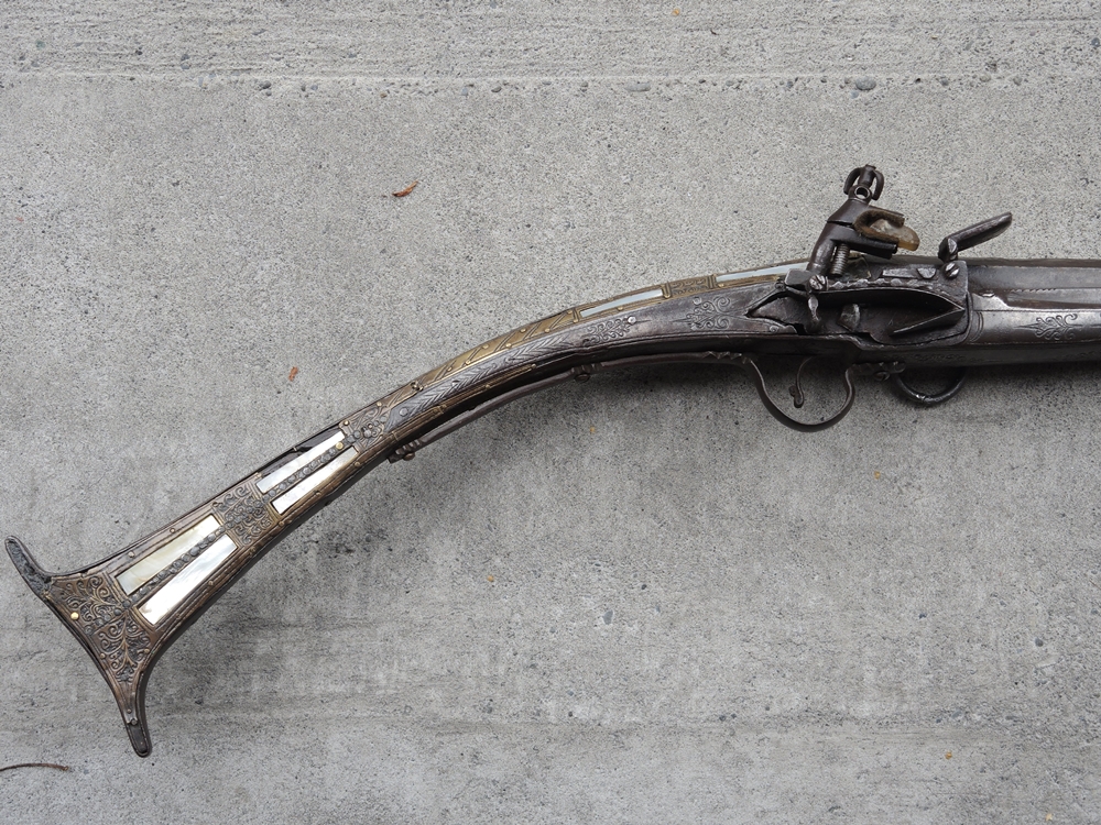

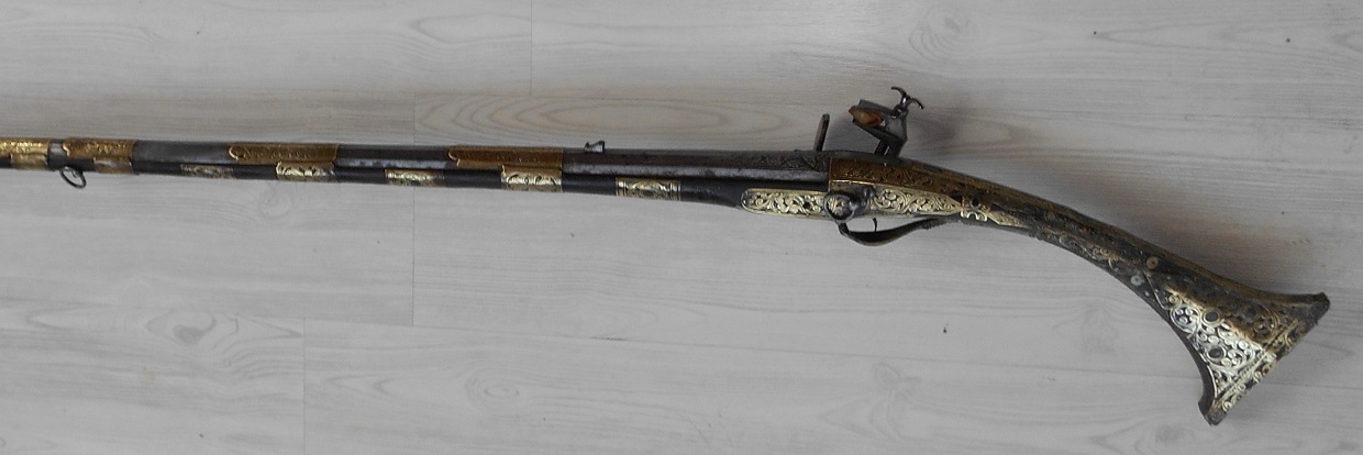

Hi Kubur, Stu,
Ring (in the middle of barrel) in this example of tanchika seems to be original, but maybe more preference of an owner. Usually both rings were on the same side. Attaching some example.

Looking at the example that I have, the ring near the centre of the barrel is fitted in such a simple manner that it could be easily changed to the other side if desired.

Hi
Here is mine and rings are the same side...

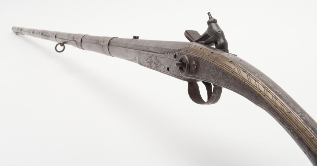

I would point out that the issue of ring placement originated on the thread of the Boyliya gun http://www.vikingsword.com/vb/showthread.php?t=25695, not this one re the Tanchika.
As you will see if you refer to the thread above, the issue of the placement has been clarified due to my incorrect observance of the pic which was quite dark. Both rings are in fact on the same side.
The comment placed here however is quite correct in that the ring fitment on Tanchika seems to be able to be fitted either side, but most have them on the same side.
Pic attached showing Tanchika "in action".
Stu

....and also a pic of my Tanchika.

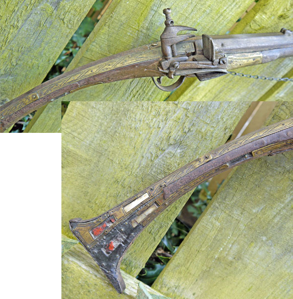

Hi Mel
Nice find. Yes, that one should clean up nicely. The front sling ring should be mounted on the left side. My reasoning I posted on the Boyliya Thread that Stu linked to above. But easy enough to reposition it during the cleaning process.
I too have a Tanchika in "attic" condition. I've never attempted to clean it since it's in 100% complete, unmolested condition. Also since I own 3 others. LOL But if it were my only piece, I too would clean it.
You will likely find the stock is mostly wood covered with metal sheathing.
Two things I notice with your gun: The barrel bands look as though they may be replacements (period?). But this would be common. Also, I notice the barrel tang screw looks to be a modern wood screw replacement (?) and threaded in from the top. Originally, the barrel tang screws were mounted from the bottom behind the trigger, inside the trigger guard and threaded into the barrel tang. If you look behind the trigger you will likely find the head of a screw or maybe just a hole. My guess is that the original screw became cross threaded or broke at some point and the barrel was reattached using a simple wood screw from the top. You can't completely remove the original screw from the bottom without removing the trigger guard, which is nailed to the stock instead of being set with screws. But the original tang screw from the bottom only needed to be loosened a small amount to separate it from the barrel tang itself. So the original screw never needed to come completely out anyway.The barrel tang screw mounting from the bottom of the stock and threaded into the tang is common with all Balkan style guns. But mounting the screw inside the trigger guard is strange to me. But it is common to every Albanian musket and pistol I have seen.
So you may want to look out for this while disassembling the gun for cleaning.

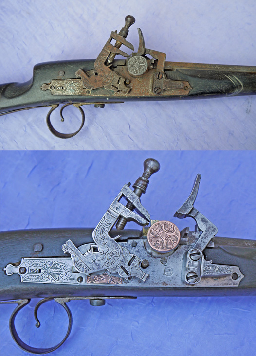

Hi Rick, It may be a while before I get this project started, there's a bit of a queue at the moment. Just to keep you interested, I've included a before and after of a rather nice Moroccan snaphaunce that I found a while since.
Mel.

Ohhh.....nice clean up on that Moroccan lock. You just never know what you will find underneath rust. LOL

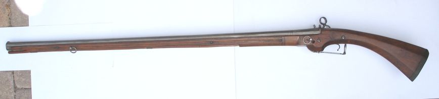

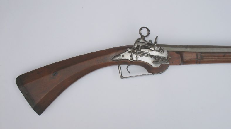

Default European antecedent: ring swivels
Here is an early miquelet-lock gun, ca 1630, fitted-up in Brescia (in Lombardy, northern Italy) in local style of the era, using an imported Ottoman barrel. The bulge on the bottom of the stock ahead of the angular trigger guard is a holdover from wheellock guns, here superfluous considering the shape of a miquelet lock.
Seen here on the left side are a pair of ring swivels for the sling. The buttstock profile is similar to that seen on a type of Balkan gun, common during the 18th-19th centuries, called a dzeferdar.
Note also that the barrel is affixed to the forestock by pins running through tenons dovetailed on the underside of the barrel, in a manner common to most European long guns of the era. This, as opposed to the use of capucines or barrel-bands characteristic of later Oriental weapons.
