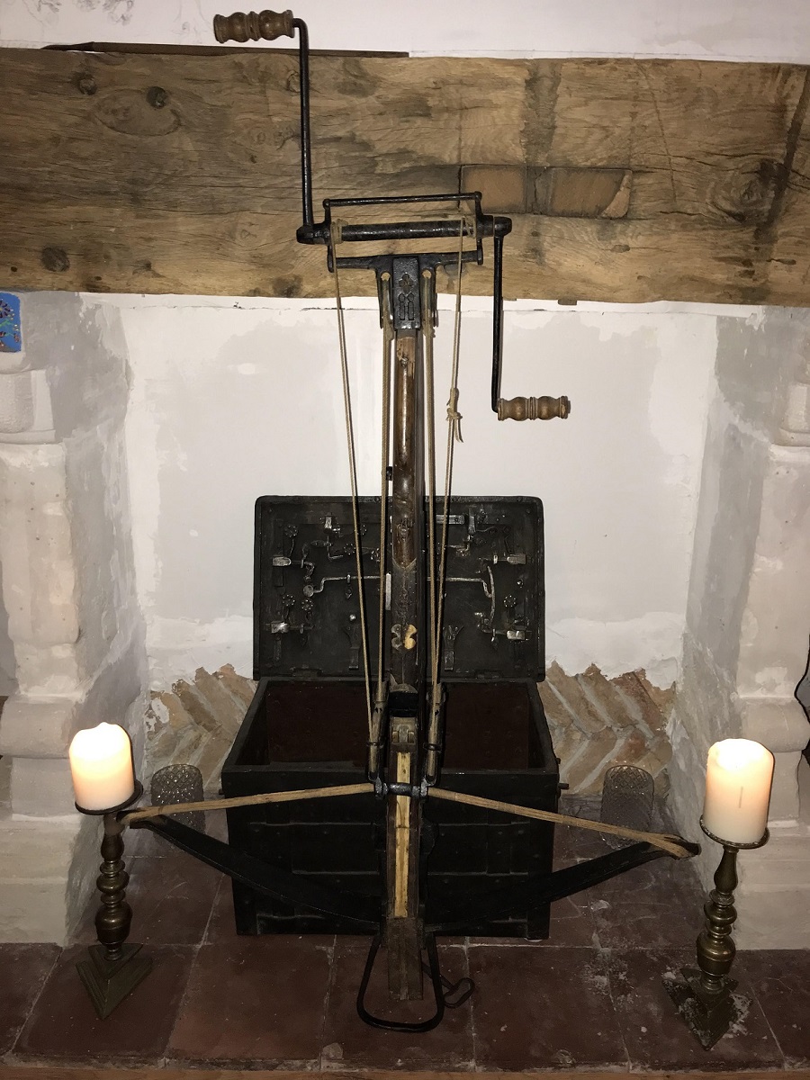

Default 17th century Low countries crossbow with windlass
This is an item i just wanted to have had in my collection, eventhough it is not my collection area at all.
Meaning as well that this is something i know little about.
Hope to learn more here
http://www.vikingsword.com/vb/showth...light=crossbow

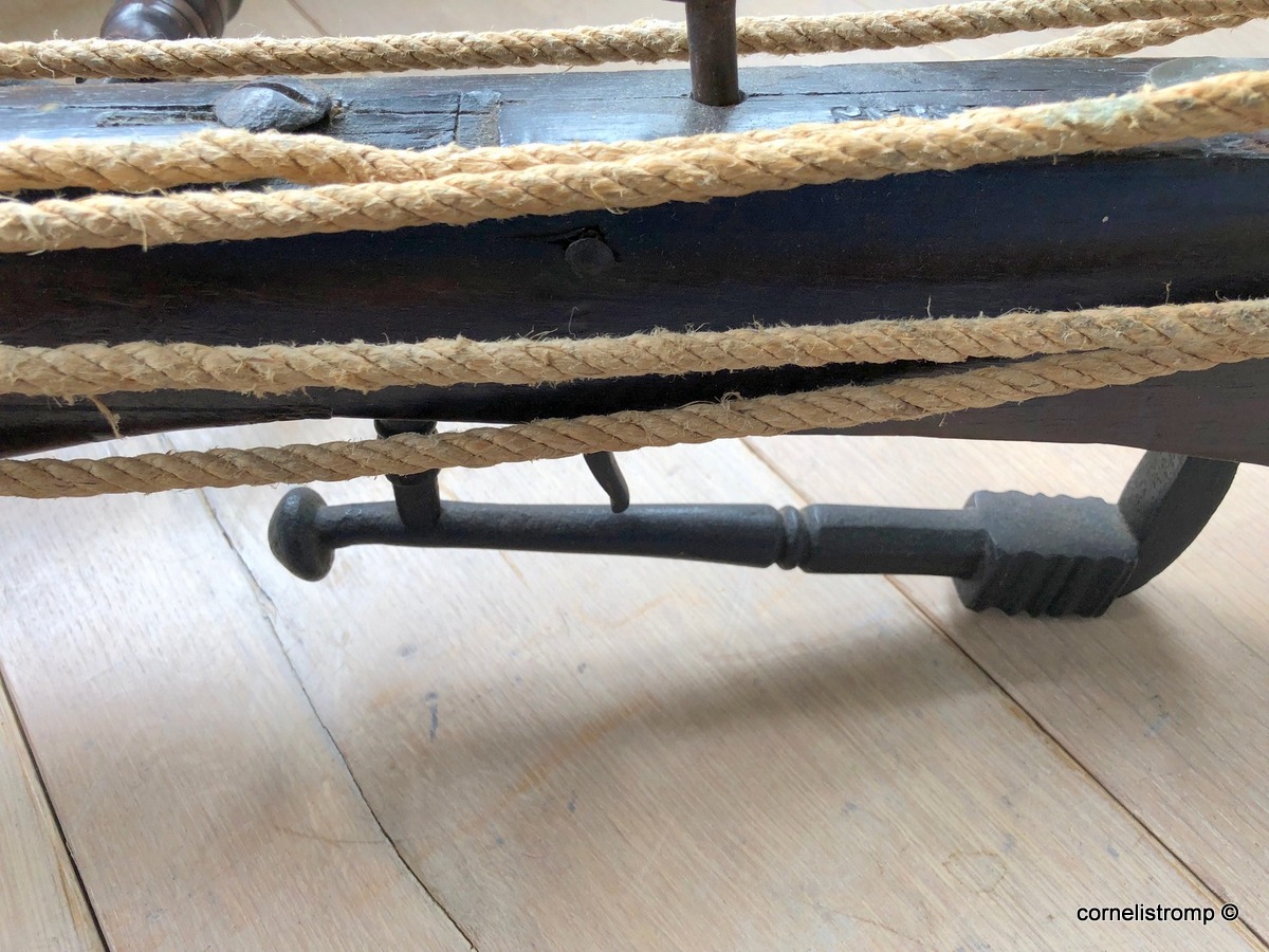

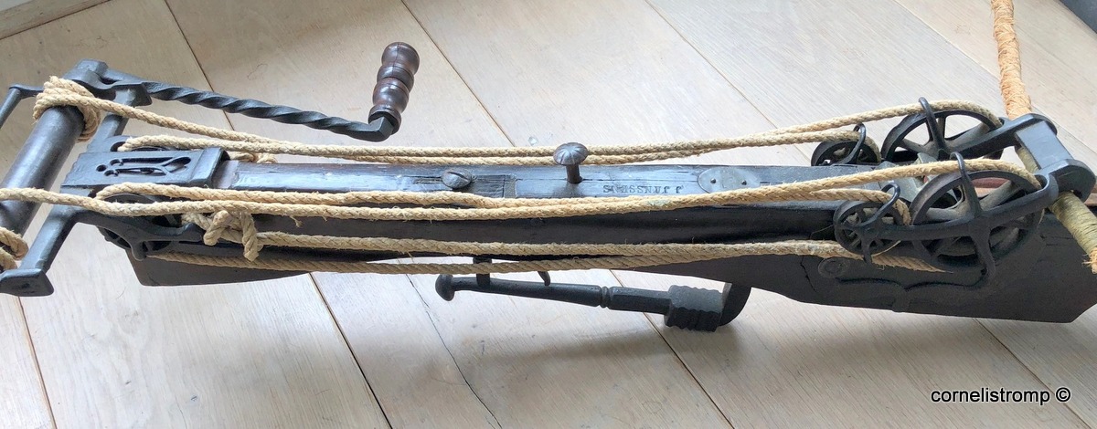

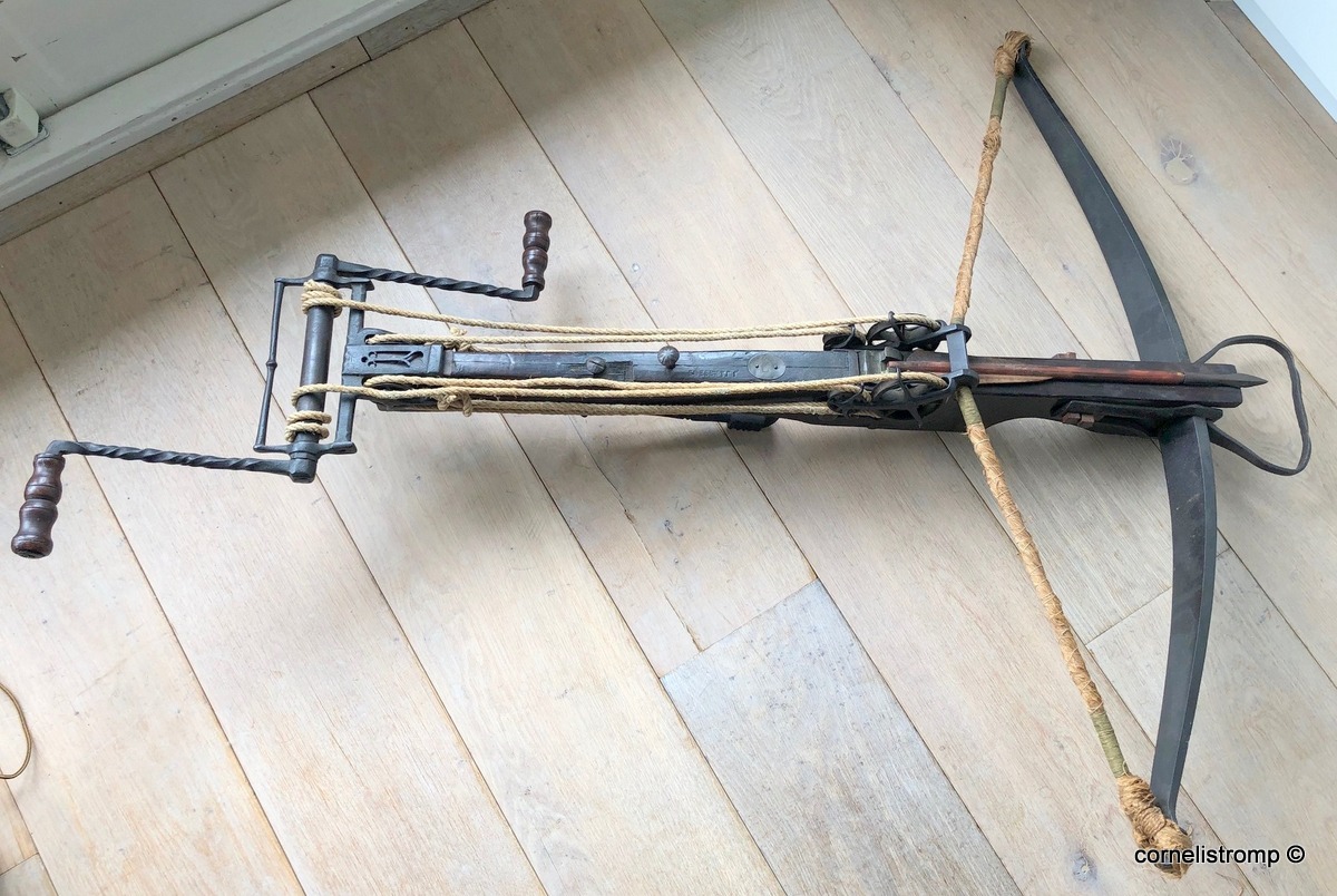

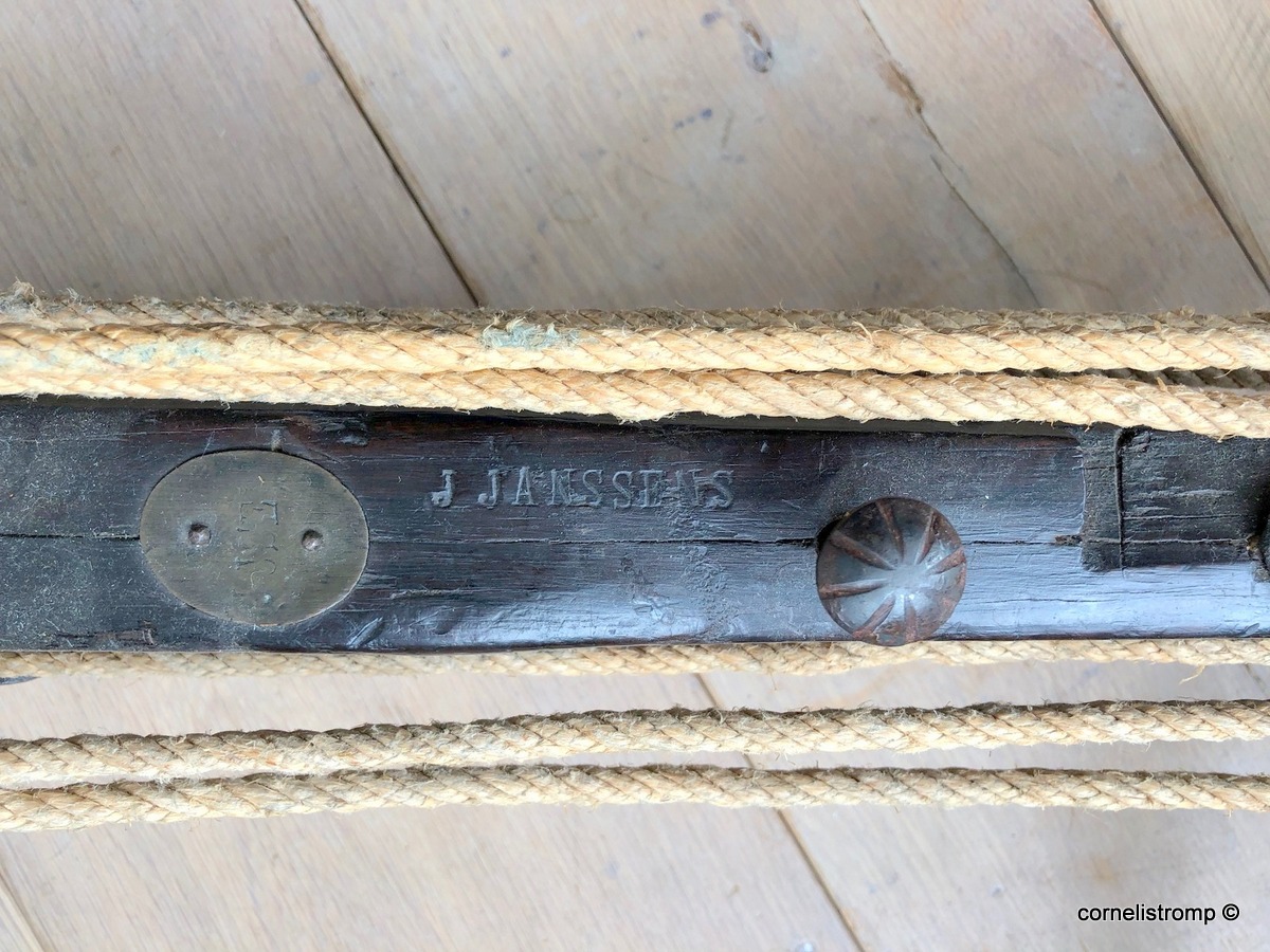

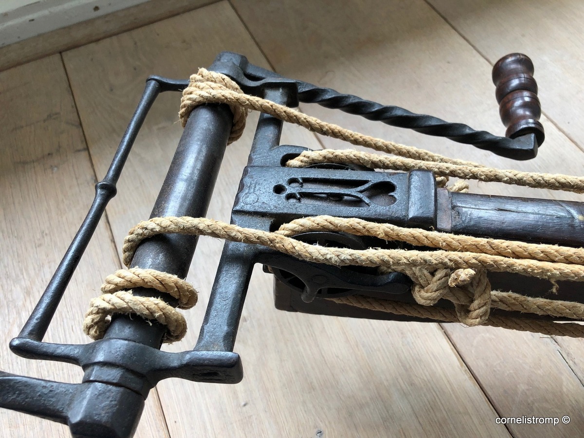

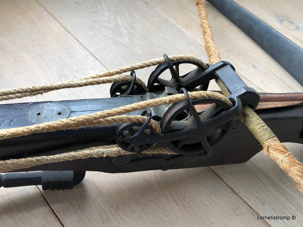

an authentic Target crossbow with so called English windlass with spoked wheels , the Nethelands first half - Mid 18th Century.
are there any marks on the bow? bull's head or rooster with stars.
best,
Jasper
attached one from my collection.

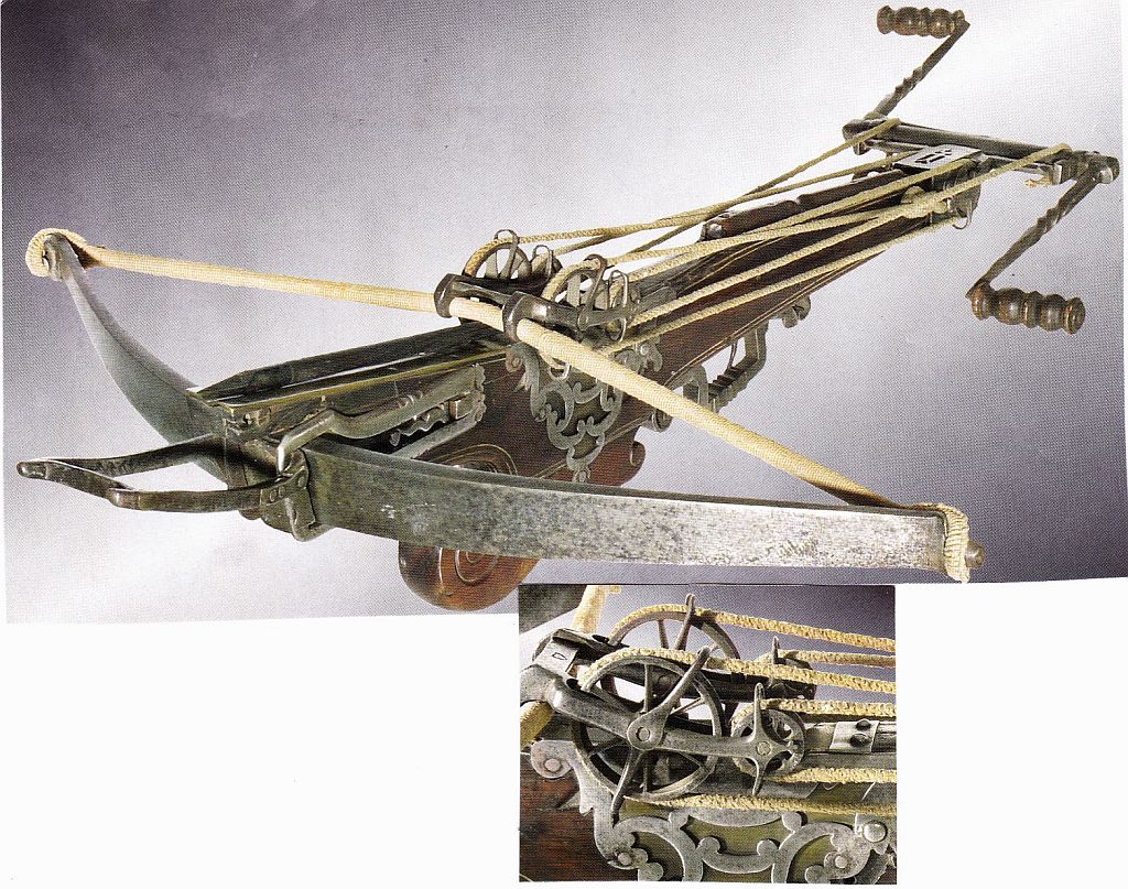

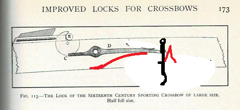

............and here a further piece of the Netherlands
corrado26

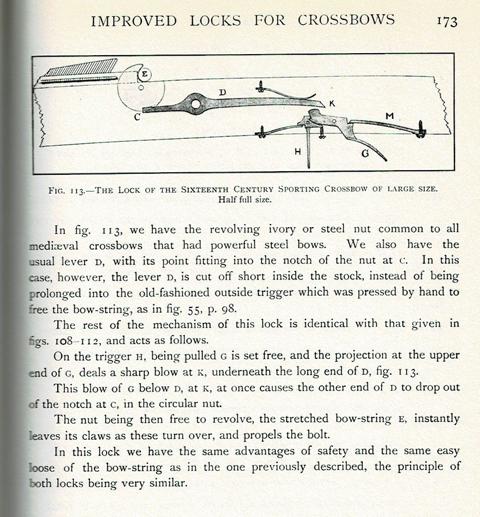

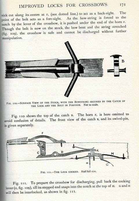

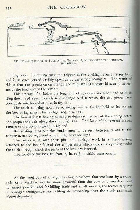

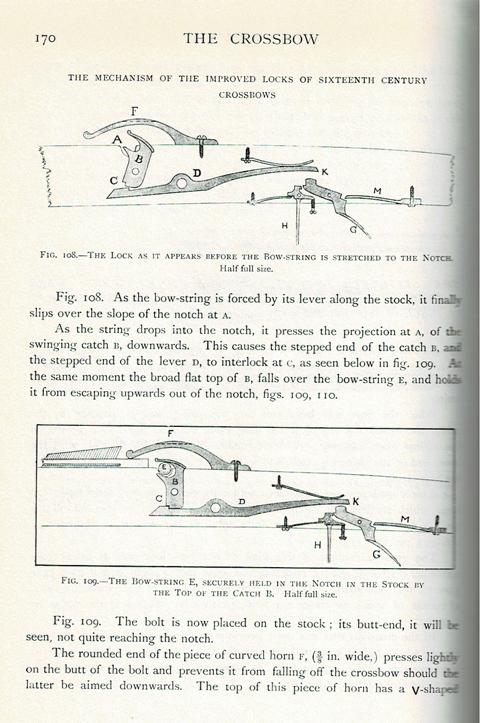

I hope these pages will help you
corrado26

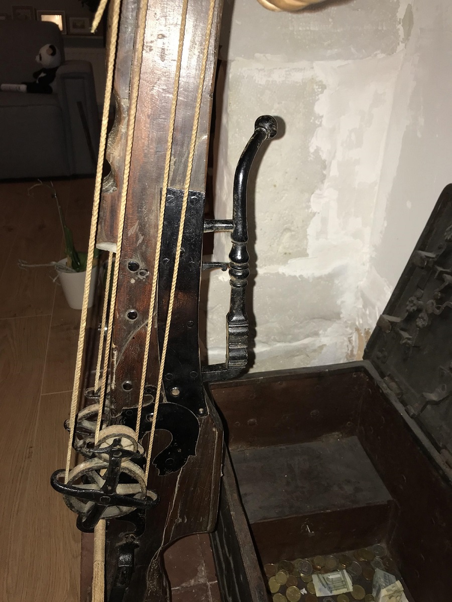

Thanks, i am breaking my head on mine though..
i attached a image of what mine looks like.. i understand how it works when its armed, but i can't figure out how it would work after releasing the trigger.
The trigger has a small nodge which keeps the trigger from releasing (and a bigger nodge for keeping the sear in bounds).
Whence the trigger is released the sear is pushed down without a force counteracting it. How it will be armed again with the sear on the trigger nodge...

I think after the shot you have to turn back (c) by hand until (d) will engage again, that's all. Then you can stretch the string again

Hi Marcus,

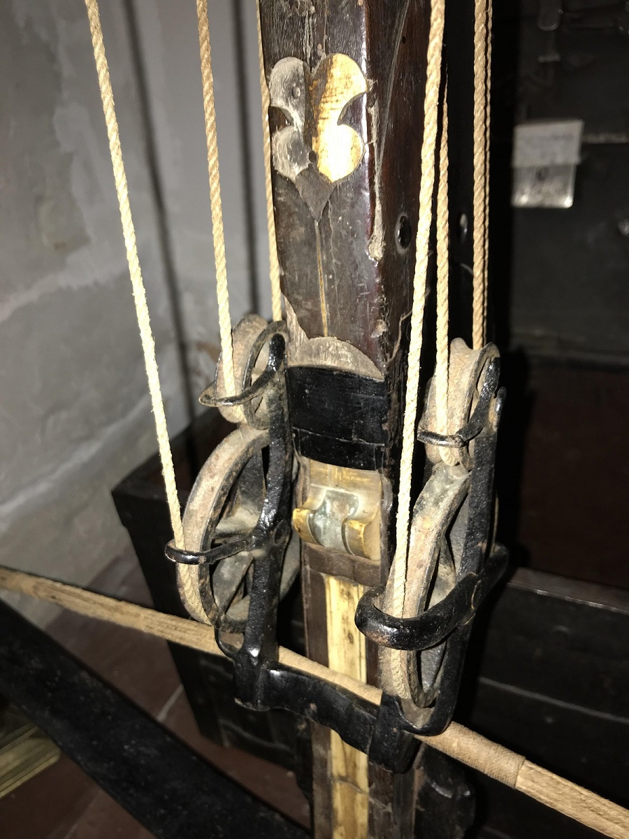

please see crossbow post #4, you have to push down the big mushroom headed pin , to arm the trigger mechanism again. At most crossbows this pin has been lost and there is only a hole to be seen.
best,
Jasper
Old 27th February 2020, 06:41 PM   #16
Marcus den toom
Marcus den toom's Avatar
Location: Netherlands
Posts: 543
Hi Jasper, thanks yes that is it.. simple elegant solution. I tried it and the trigger will catch on indeed.
