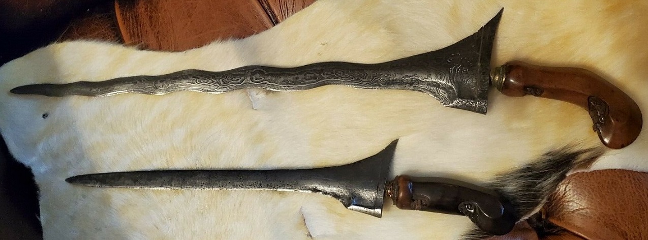

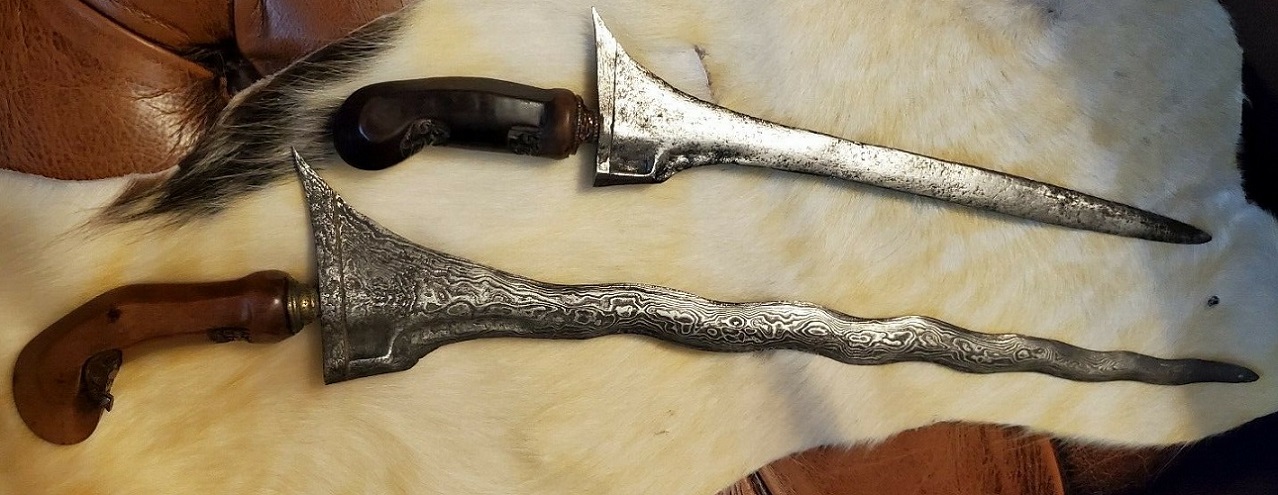

Default A pair of keris with highly stylized pamor
This is another pair I was curious to know more about. One has a highly stylized pamor and the other is rather smaller and not so flashy.
apolaki is offline   Reply With Quote
Old 21st February 2020, 11:11 PM   #2
Post
Both blades exhibit dhapur tilam upih.
The smaller keris may be just out of stain; it apparently has lost some substance due to age/erosion.
The larger one seems to be quite decent: the pamor family is mlumah (i.e. horizontal layers) and would be considered a random pattern.
Old 22nd February 2020, 12:45 AM   #3
Posts: 7,230
You are quite sure about those dhapur nominations Kai?
Old 22nd February 2020, 02:44 AM   #4
Posts: 7,297
I don't think tilam upih is ever wavy, is it?
Old 22nd February 2020, 04:13 AM   #5
Red face
Ouch, that was a no-brainer, sorry. Thanks, Alan!
13 luk, pejetan, and tikel alis: Make that out of pakem keraton Surakarta for the longer piece, I guess.
Old 22nd February 2020, 06:58 AM   #6
Posts: 7,230
Yeah, I think so.
But it could well be within pakem somewhere else.
The little one I'm not real sure of either, it looks like it might have a tikel alis, but its not real clear on my monitor.
