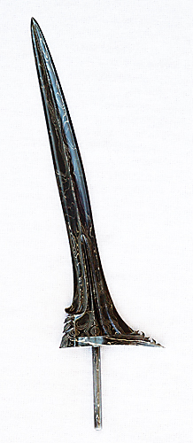

However, that said, staining a blade can be a very repetitive process. This keris is one I made, it took me two full days to get this stain on it, it was done in Sydney, in Summer, partially in shade, partially in full sun. |
