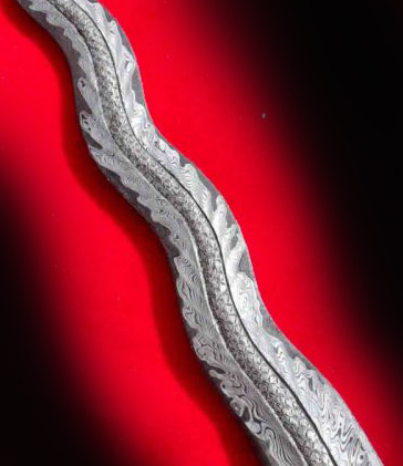

Default Bugis keris pamor pattern name

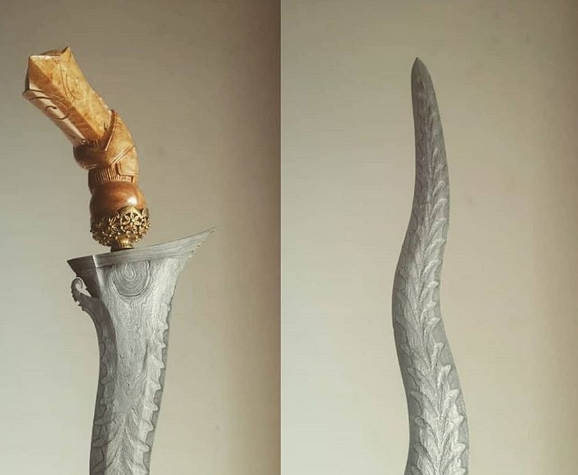

Dear members
Is this a new invented pamor or there is a name for it?
Anthony G. is offline   Reply With Quote
Old 28th January 2020, 07:56 AM   #2
Posts: 7,229
I'd call it a Wiji Timun (cucumber seeds) variation if it were Javanese. As Bugis I don't know.

Sorry but I do not see Wiji timun pamor and this is quite a recent blade. A batu lapak is visible at the sorsoran.

Yes Paul, i think Anthony is aware that this is a recent blade which is why he asked if the pamor pattern was a new invention.
Hopefully Alan will return and speak further about why he thinks it is a Wiji Timun variation.

I have made Wiji Timun, I have seen Wiji Timun made many times. This blade has been made in the same way. It is surface manipulation. The reason it looks different to the usual Javanese Wiji Timun is because the "seeds" are spaced more widely and the blade geometry is different to a Javanese blade.

WT is normally an arrangment of seeds lined up at the rigde of the blade but I have come across a similar modern blade with the WT variation just like the one in question. An eye-opener.

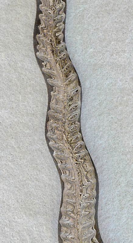

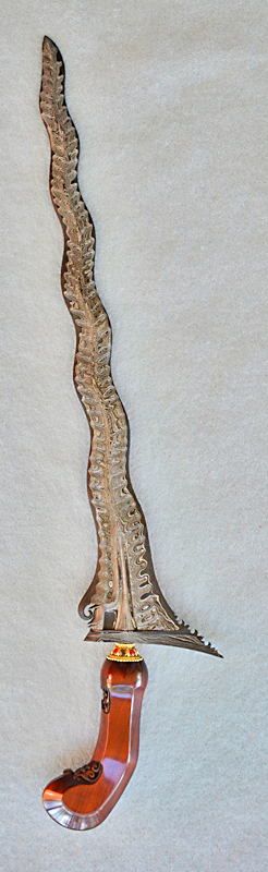

The pamor pattern of these 2 modern blades is quite different from the usual Javanese Wiji Timun pattern (see pics, pamor Beras Wutah/ Wiji Timun). The name game again....

Of the two keris that Jean has posted images of, I would give the one on the right as Banyu Tetes:- dripping water; the one on the left I would not attempt to name in a Javanese blade, I would describe it as simply "mlumah", or I might give it as "residual wos wutah", which way I went would depend on what impression I gained with it in my hand.

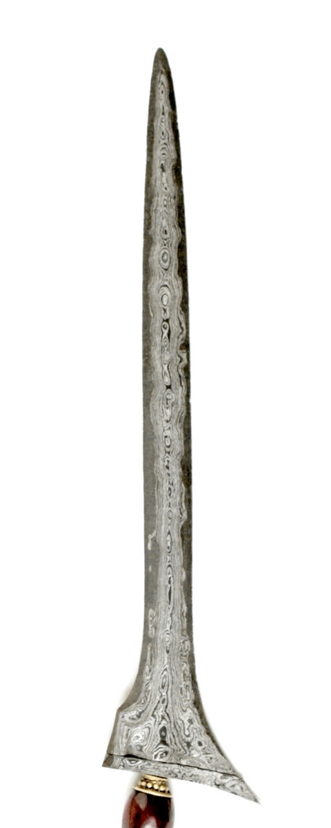

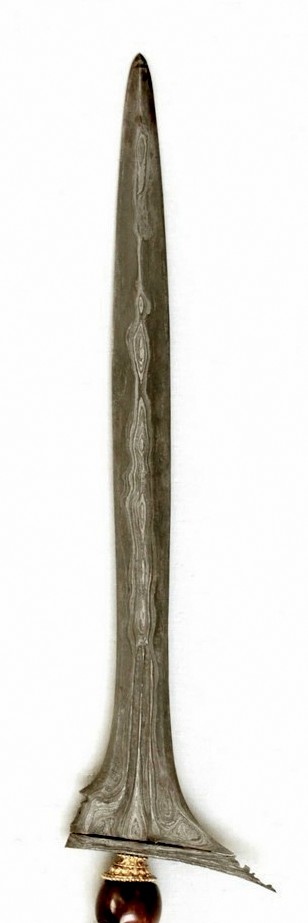

In Solo, Jawa Tengah every keris literate person I have known has named a pamor that has the "seeds" running in a line down either edge of the blade, as Wiji Timun. During the 1980's and 1990's, probably the most accomplished pande keris in producing this pamor was Yohannes Yantono, who was one of the original Anak-anak ASKI, and was probably the principal teacher of more hopeful and actual keris craftsmen in Central Jawa than any other single person. I do have a rather good example of his work, and I will post an image at my earliest opportunitY.
EDIT
Pande keris Yantono made this keris in the early 1990's, I think around 1993.
The pamor material is Arizona meteorite, I welded the meteor pieces and washed them in preparation for use as pamor material.
The pamor you see here is Pamor Wiji Timun in the typical Central Javanese interpretation.
It does looks like mine. Finally I got the name. Thanks Alan........

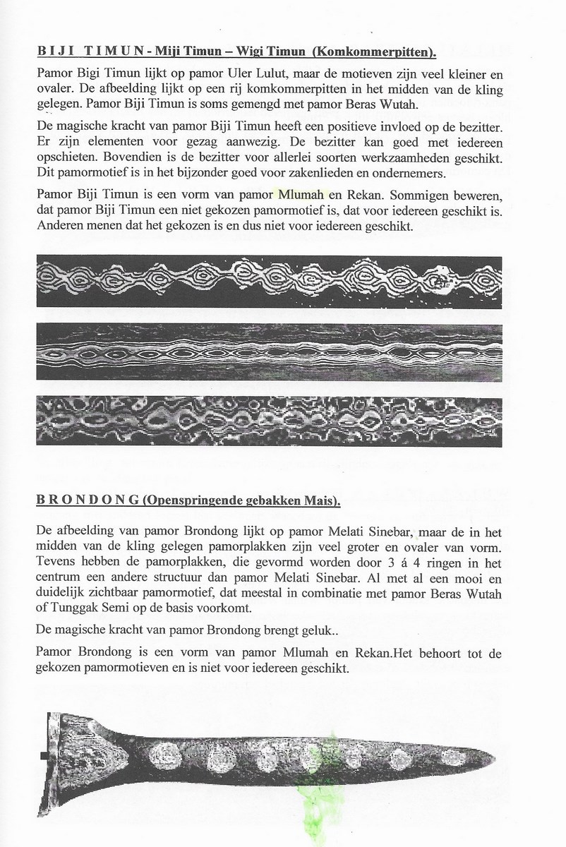

Just for reference, I attach the certificate from the TMII Museum for my blade shown on the left, and the interpretation of pamor Wiji Timun from the Pamoratlas (a recognized reference book in Europe).

Interesting Jean.
Perhaps now you might understand the reason why I take very little notice of books.
The names that this most respected publication gives to these illustrated motifs are, I have no doubt absolutely correct.
In Europe.
But regrettably, absolutely incorrect according to the people from whom I learnt, who lived, and in some cases, still live, in Solo Jawa Tengah.
Also, absolutely incorrect according to the gentleman who made this keris.
But really, we should not be too critical about the fact that the people in Solo who made keris with these pamors used different names for them than did the people who have written about them. They had probably never read the books , so they just went on naming these pamors as they had learnt from others before them.
As for the certificate, well I guess its a matter of exactly who we place the most belief in:- makers, or administrators.
Actually, these European sources do not stand alone. I think perhaps Harsrinuksmo might also use names that he sourced from somewhere other than Solo.
I've never seen this "Pamor Atlas", but I have seen the Tammens pamor volume. There is a bit in that doesn't quite fit in with Solo ideas too.
As I think most of us already know:- there is no universal agreement, my background is Solo, Empu Suparman, Empu Pauzan, several m'ranggis, several dealers, several other makers who were/are pandes, not empus. I'm happy to stick with my sources, others can select whatever source they wish.

I checked that Harsinuskmo also shows pamor Wiji Timun as a "row of cuncumber seeds" in the center of the blade (page 532 of the EK) and he may have been the source of reference for other authors like Tammens (vol.2 page 161).
As you correctly pointed out, the pamor pattern on Anthony's blade would be named as Wiji Timun in Java, but not applicable to a supposedly Buginese blade?
