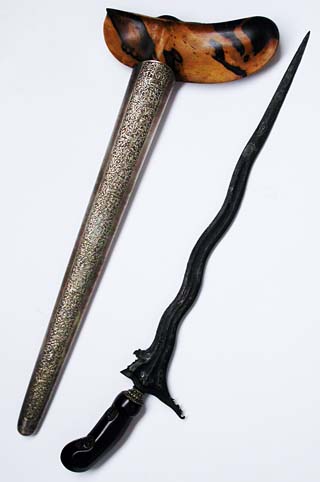

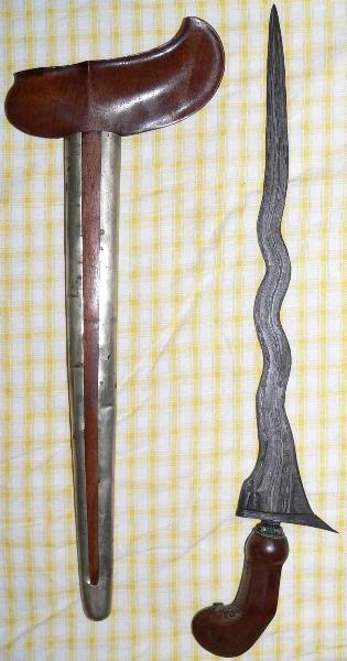

Marcokeris
Marcokeris's Avatar
Location: Italy
Posts: 928

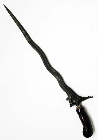

Default Megantoro
Dapur megantoro, pamor pedaringan

Hi Marco,
Like "Karna Tinandhing" (two sekar kacangs in one blade), this type of dhapur is also reflecting the brilliant idea of the creator -- combination of keris with luks and straight blade... Combined in one nice curving bottom lines of "ganja wilut"
I have one, but not as good as yours. In Yogyakartan sheath too...

Lovely blades.. I've always love this dapur.. this and Pulanggeni.. Congrats to all whom have this blade..

Hi Marcokeris,
Wonderful piece ! My compliments
Purchased during your latest visit to Java, I suppose.

Nice keris Marco.
Pak Ganja, would be kind enough to list the ricikan of keris dhapur megantoro for us?
Thank you.

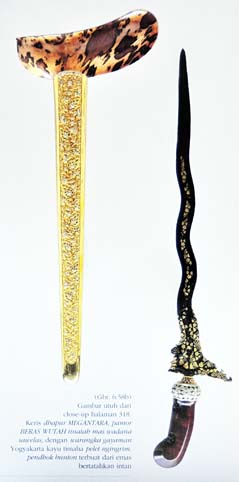

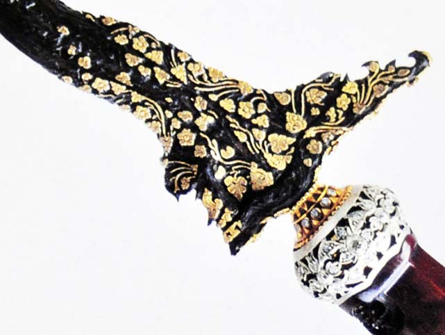

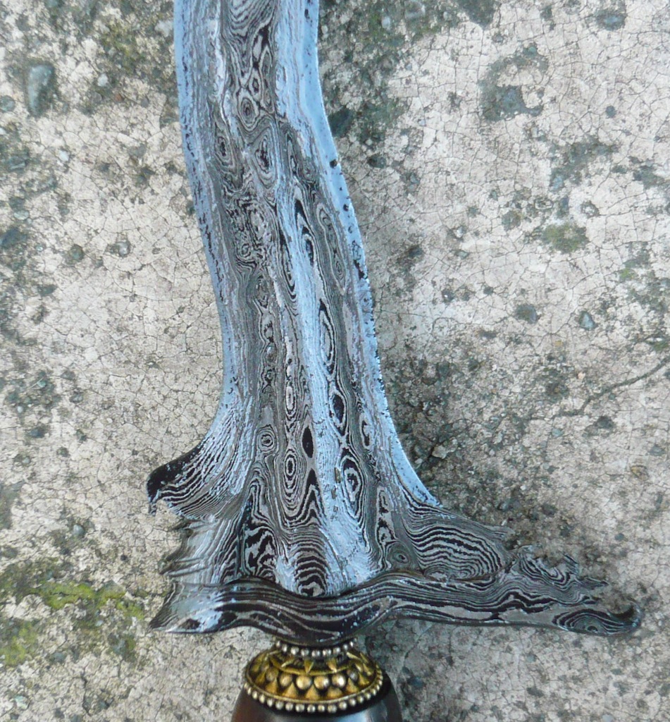

With pleasure, Alan, I try to describe it. This dhapur is one of my favorite for a long time. And one of the best Megantara (or Megantoro) I've ever seen in my hand is the one in the collection of Mr Haryono Guritno (as you may see in his book, "Keris Jawa" on page 319 and 358 -- picture below). A Megantara with tinatah emas (gold ornament) "wadana sawelas" (ornaments in eleven surfaces of the blade) in Yogyakartan dress of timoho gayaman ('ngingrim motif'), gold pendhok with diamonds... A truly elegant keris pusaka of Yogyakarta.
IMHO, from what I've seen from other Megantara kerises too, it is the type of "medium sized" keris. Mine is 33 cm length without pesi (almost 7 cm), compare to most Javanese kerises that usually measured 35 cm without pesi. All has "wilut" (double curve, or it is more precise -- "kelap lintah") ganja. And it usually has details of sekar kacang "pogok" (not full sekar kacang) but in a specific form of "kecambah" (sprout?) or even at a glance -- as cock's head.. Other details -- it has always seven luks, with one jalen, one lambe gajah, pejetan, tikel alis, greneng with curving end, and must have a kruwingan until 3/4 of the blade... It looks more feminine blade, than masculin...
Why always seven? It might be traced from its name "mega" or sky. In "candra sengkala" sky also reflect "7" score too. Also in Indonesian expression, we know this paraphrase of "... sampai langit ke tujuh" or 'until the seventh sky'.
I don't know who created this dhapur. But from what I've seen, at least from the pusaka of Yogyakarta in the hand of Haryono Guritno -- the tangguh supposed to be Majapahit...

So, would an accurate list of the ricikan that are found in keris dhapur megantoro be:-
luk tujuh, gonjo wilut, ada-ada, kembang kacang pogok, lambe gajah satu, jalen satu, kruwingan, greneng ?
Is there anything that I have ommitted?
Yes, I agree with you that this seems like a tangguh Majapahit keris dhapur, well, East Jawa at least.

Yes, Alan. And the last luk is longer, and even straight at the tip of the blade. So, always combination of keris with luks and straight at the tip of the blade... Perhaps Empu Supa's style, IMHO...

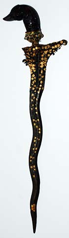

Will it be exagerated, if I supposed that this popular Si Ginje in the collection of the National Museum of Indonesia also was made by the same Empu? Empu Supa of Majapahit kingdom? Or which Supa? Look at the style and ornaments of this Sumatran keris...
GANJAWULUNG

So there is only one kembang kacang?
As you would appreciate, the attribution of a blade to a particular maker is very difficult. I'm well aware of the conventions that attribute blades to various makers upon the similarity in styles to agreed standards, however, if we were to accept without question these conventions, I think Empu Kinom must have produced maybe 10,000 blades or more during his lifetime. Quite incredible production. Similar production numbers can be attributed to other well known and popular makers also.
So, when we look at a couple of blades and see some similarities in those blades, I really do feel it is drawing a very long bow to attribute to the same maker.
It might be more wise to attribute to the same school, as we do with art works in other fields that possess similar characteristics.

Yes, Alan, I agree. The same school... Coincidentally, with the same luk -- 7 luks -- and the same style with kruwingan at 3/4 of the blade, and "gelung" (kanyut) at the end of the greneng...

Probably no coincidence, but intentional.
However --- one kembang kacang in megantoro?
Refresh my memory, if you would please, Pak Ganja. Briefly, what is the history of Si Ginje? Who was its first custodian?

Yes, Alan, one kembang kacang only but pogok in a specific style -- like "paruh ayam jago". On history of Si Ginjei, or Si Ginjai please refer to this old thread

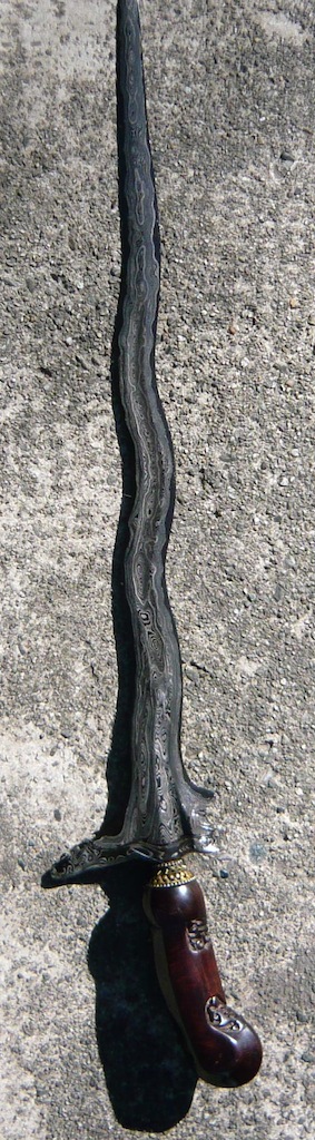

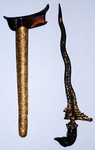

hello mister maisey the ricikan you appointed luk tujuh, gonjo wilut, ada-ada, kembang kacang pogok, lambe gajah satu, jalen satu, kruwingan, greneng ? so when a keris have his al than is it a dapur megantara??????? so like my keris
Yes, Semar, it seems yours is a megantara... The specific kruwingan until 3/4 blade is one thing I can see from your picture. Also the combination of keris with luks and straight blade at the tip...

May be I am wrong, but there are some old specimens showing two kembang kacang pogok (?).
Even keris posted by Semar seems to have two, but regarding this picture nobody can be sure about ricikan, of course .
About lambe gajah: has Marco's keris two of them?

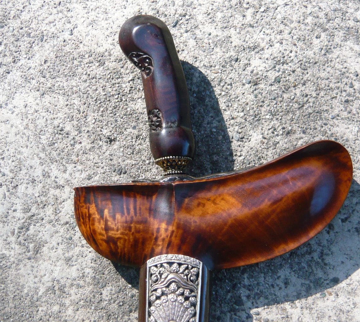

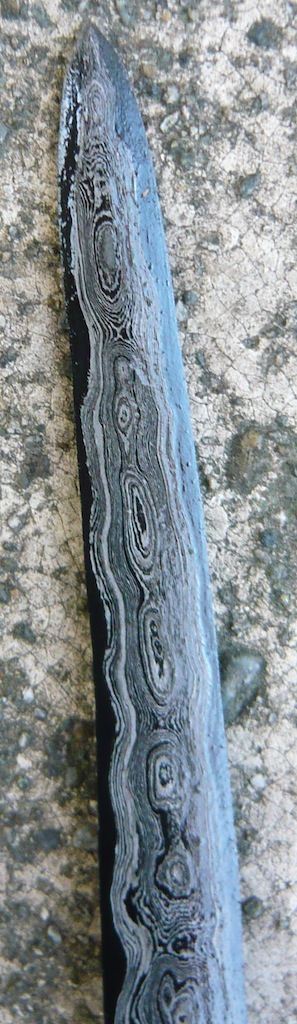

oke sorry mister maisey look to this one I think this one is also a megantara

Semar, I am afraid this one has zero kembang kacang...
Thank you for the additional picture of your first keris.

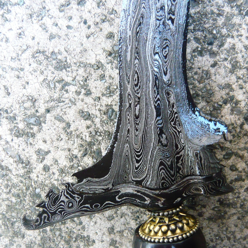

Thanks for your carefulness, Gustav. Yes, the two lambe gajah is questionable. (More close up on sor-soran and gandhik section of Mr Guritno's megantara...)

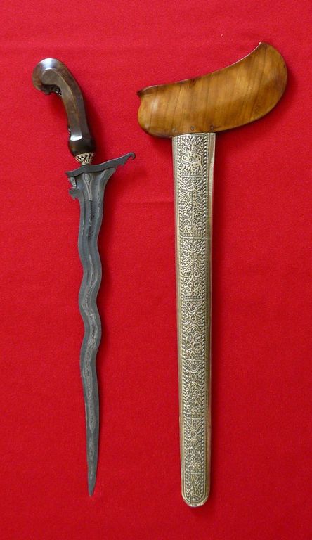

hello Gustaf can you tel me than the name of this dapur

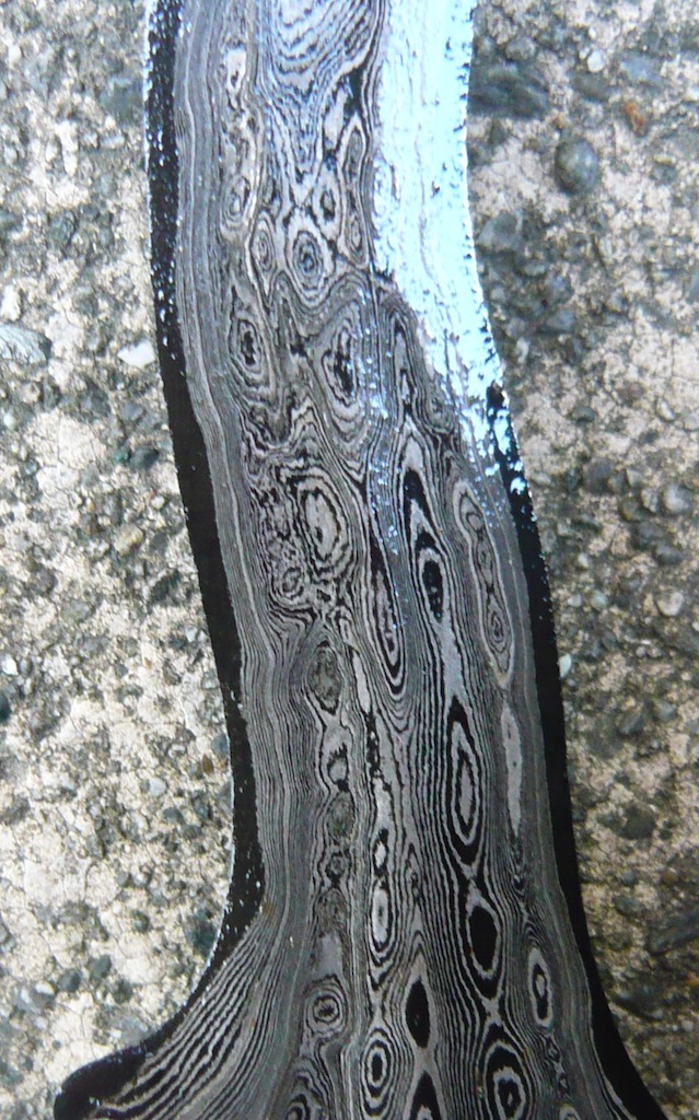

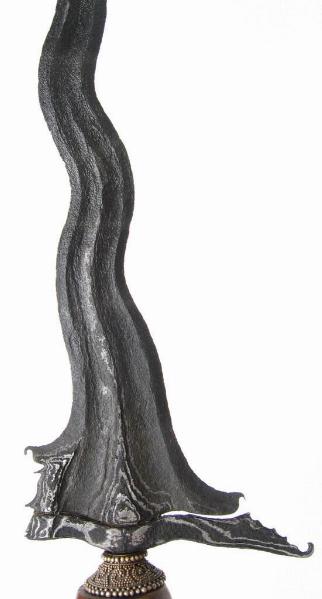

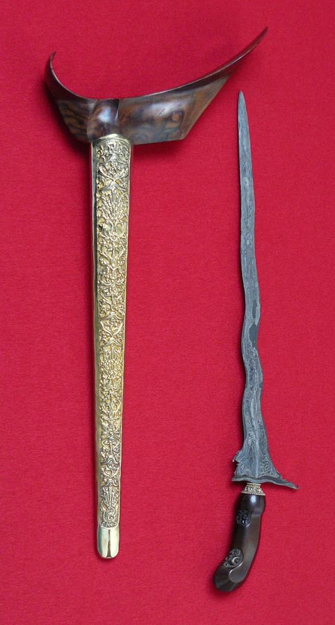

Hi gentlemen,
Two more keris megantara from my collection and to be shown in my new book. Sorry for the picture quality.
Best regards
Jean

Hi Hans,
This dapur does not match with any known Javanese type but could be specified as Jarang Guyang with some exceptions (the only dapur with 7 luks and without kembang kacang).

In my kris book pages 73 (picture) and 179 (description). Again your blade does not fully match with dapur Jaran guyang, it has no greneng especially.

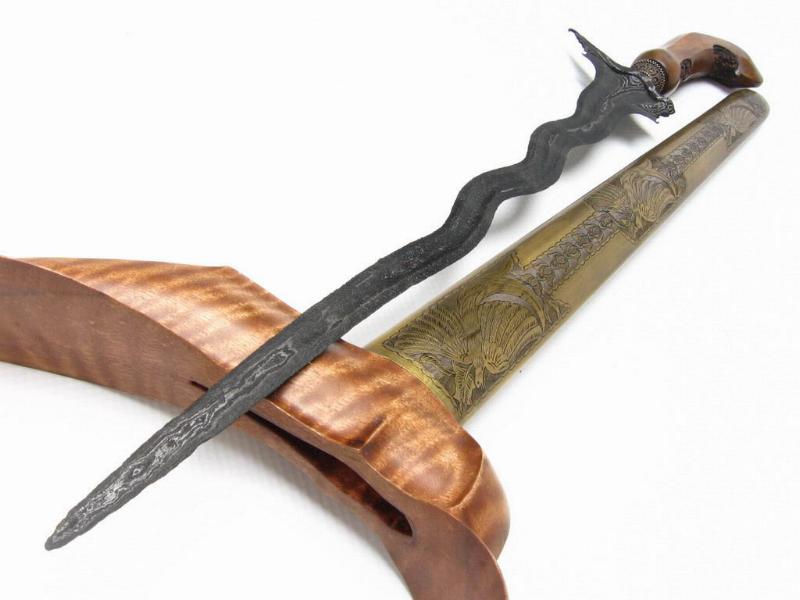

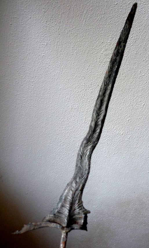

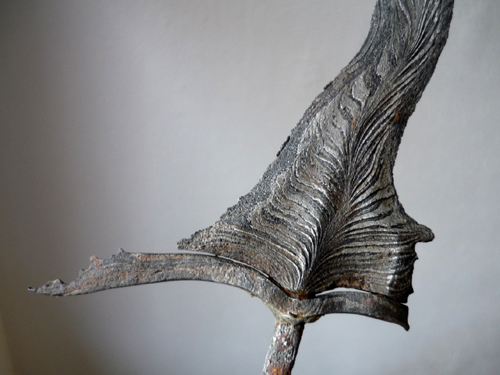

Wonder if my blade is a MEGANTORO...personally I would say it is.
Deep central groove and the (worn) kembang Kacang Pogok but it is not 7 luk blade ( which is part of the parameter?).
Wonder how old this blade is and the feather pamor type of pamor?
The MEGANTORO dapur is often seen in East-Java / Madura region?

I noticed this odd and worn blade at the recent Czerny's auction (replaced ganja?). Yes, the dapur could be identified as Megantara luk 5 although this is not a standard dapur. Dapur Megantara is not included in the reference book Dhapur (Surakarta pakem) but it is mentioned in the book Keris Jawa. The pamor pattern could be identified as Blarak Ngirid or Bulu Ayam.
