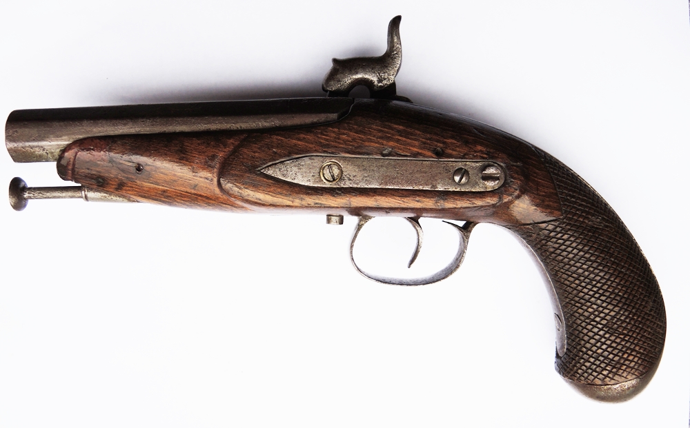

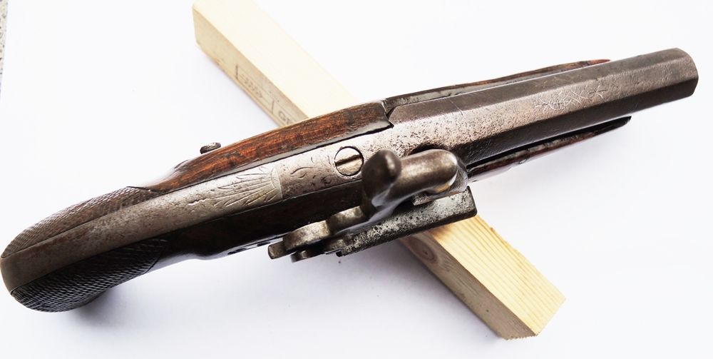

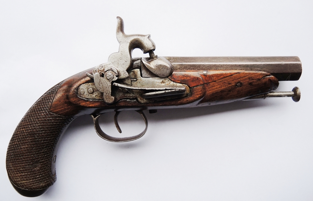

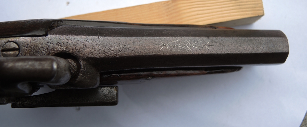

Just acquired this nice little pistol. Barrel length approx 5" (13cm) with a smooth bore of approx 17mm. Overall approx 25cm.
There are no proof marks of any sort, but 17 is stamped on the underside of the barrel. The barrel bore has a definite chamber for powder and a "flange" above that, which would seat the ball. The miquelet lock is in good functioning order.
I am leaning towards Spanish origin but could be quite wrong.
All comments welcome.
Stu

Hello
The third screw on the counter plate suggests that you must have had a belt hook. We would have to disassemble the counter plate and look where it threads and what sense it has. Is spanish

Hello
In the description of the "fashionable Madrid" miquetete there are several errors. The chock C is not half-cock, but is for full-cock, and conversely, the front chock is the one that acts in half-cock. In addition, the firing is not achieved by means of the spring appendix, but by means of a bar
Affectionately
