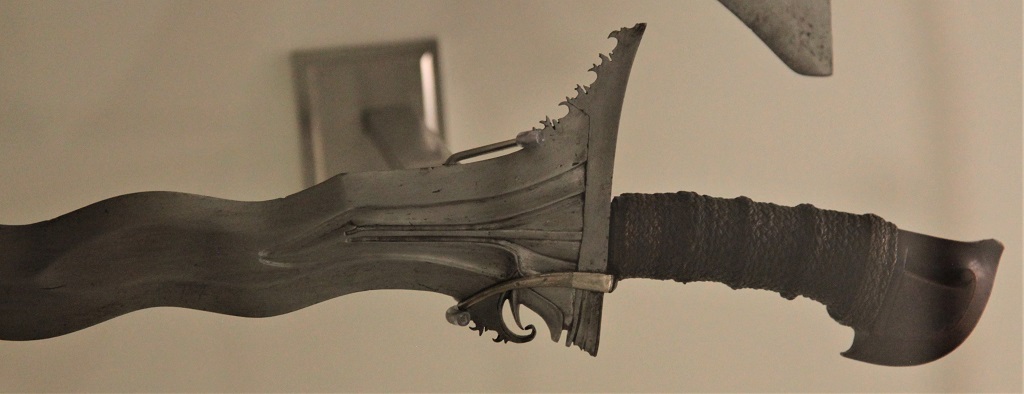

Question Kris behind glass
Here are a few images of a kris on display in an important museum. For now, I'll not prejudice the discussion with details from the museum's descriptive tag.

Ok, Lee, I’ll bite.
From the pics, I’d suggest that this kris is Sulu and from the second half of the 19th century.
It seems to exhibit some unusual details though - looking forward to hearing more about it!

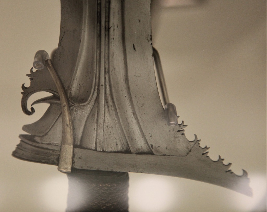

I agree with Kai on the dating bus would suggest that this could be Maguindanao. The fret work on the ganga is Maguindanao and the “eagle/elephant” front part of the ganga is perpendicular to the ganga lines, though it might appear a little slanted.

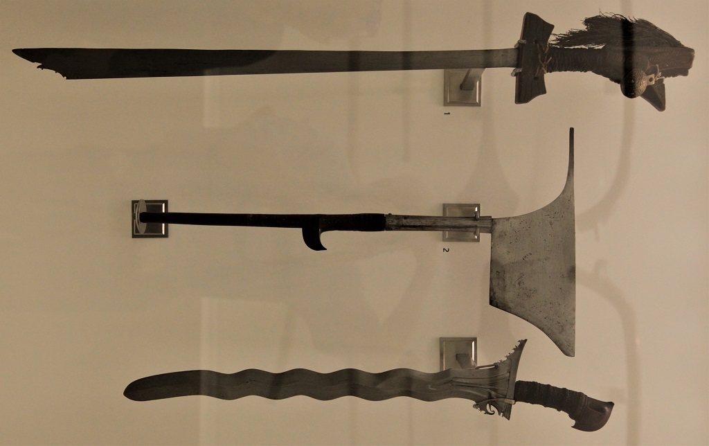

The Igorot axe looks Bontoc to me (possibly early?).
The kampilan throws me. I can't see any okir on it. It does remind me of one from Borneo. Again I'm not sure of it's origin. I do like the tiger bell on it.

Hi Lee:
That's a nice example that has been very well cleaned and maintained. I agree with the comments so far, although I think the carving of the blade is exceptionally good for Moro work--very refined. This one could be Malay in origin, or the blade could even be from Bali and rehilted in the Moro style. I'd say this was owned by, or presented to, someone important.
The last pic is taken at a slanted angle; the intermediate shot seems to be much better to assess the configuration at the base of the blade: For a later blade, the beak/trunk not being parallel to the gangya doesn’t seem to suggest a Maguindanao origin IMHO. Close call though...
