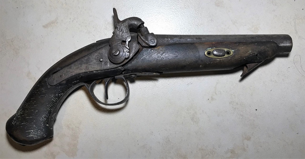

Hello Friends,
Recently my father gave me a Spanish percussion pistol as a gift.

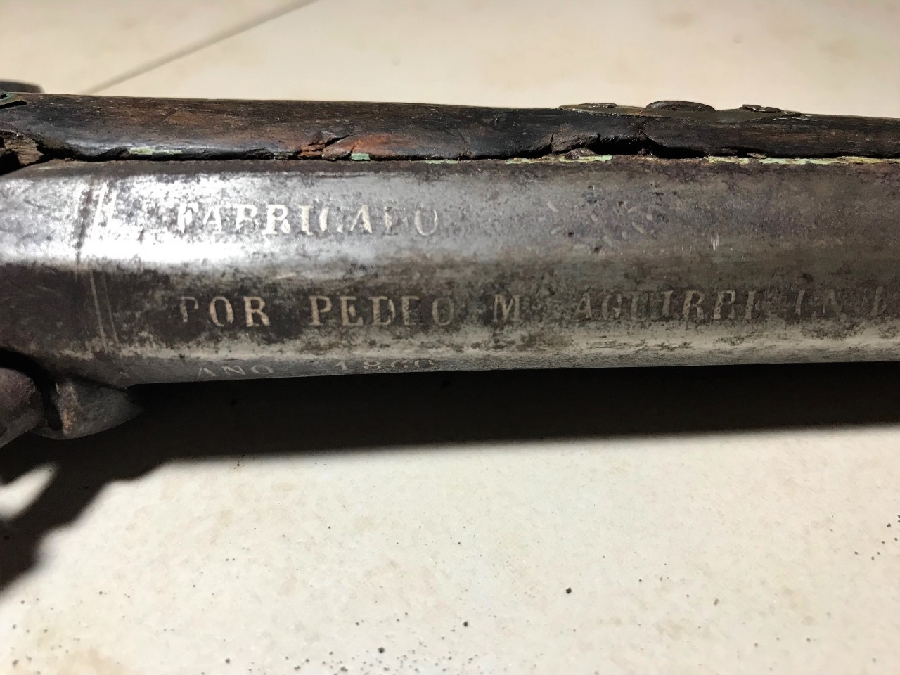

It was donated to him so there is no background info. There is an engraving on the barrel that says "FABRICADO POR PEDRO M AGUIRRE EN EIBAR 1860,"
(Made by Pedro M Aguirre in Eibar 1860). I have little knowledge about these pistols so any help in identify will be greatly appreciated. Doing an internet search I was able to find Eibar was a famous city in Spain know for its armories and that there is a gunsmith by the name of Pedro J Aguirre who started in 1864. I am wondering if Pedro M was the father.
The gun is in terrible shape so any tips on restoring would be great.
Once again thank you for your time,
Samuel

Pedro AGUIRRE is listed in the "Neue Stöckel" twice, one at Eibar in 1763 and the other at Eibar in 1840 to 1850. The second is also listed by W. Keith Neal, Spanish Guns and Pistols at Eibar in 1841.
So this second Pedro Aguirre must be the maker of your pistol. Unfortunately it is in a very bad state so you will have much to do in order to getting this piece in a collectable condition.

The correct signature is PEDRO Ma. (Maria) DE AGUIRRE
Eibar1840-1850
Ramiro Larrañaga "Historical Synthesis of the Basque Armeria", page 195
Interesting is the method of embedding metals in the legend. I guess it will be silver, for the brightness. I do not know the technique, I guess it will not be the oriental, and it does not seem to be traditional damascene

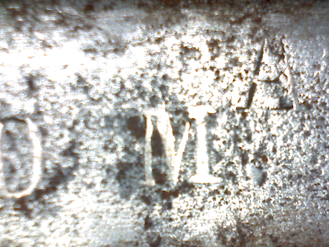

Old 11th July 2019, 03:03 AM   #6
Camoga
Join Date: Feb 2019
Posts: 5
Originally Posted by Fernando K
Hello
Eibar1840-1850
Affectionately
Your right, there is an A very lightly engraved above and to the right of the M.
The piece is in very bad shape but I would still like to have it on display at my house so I thank all of you guys for your help.

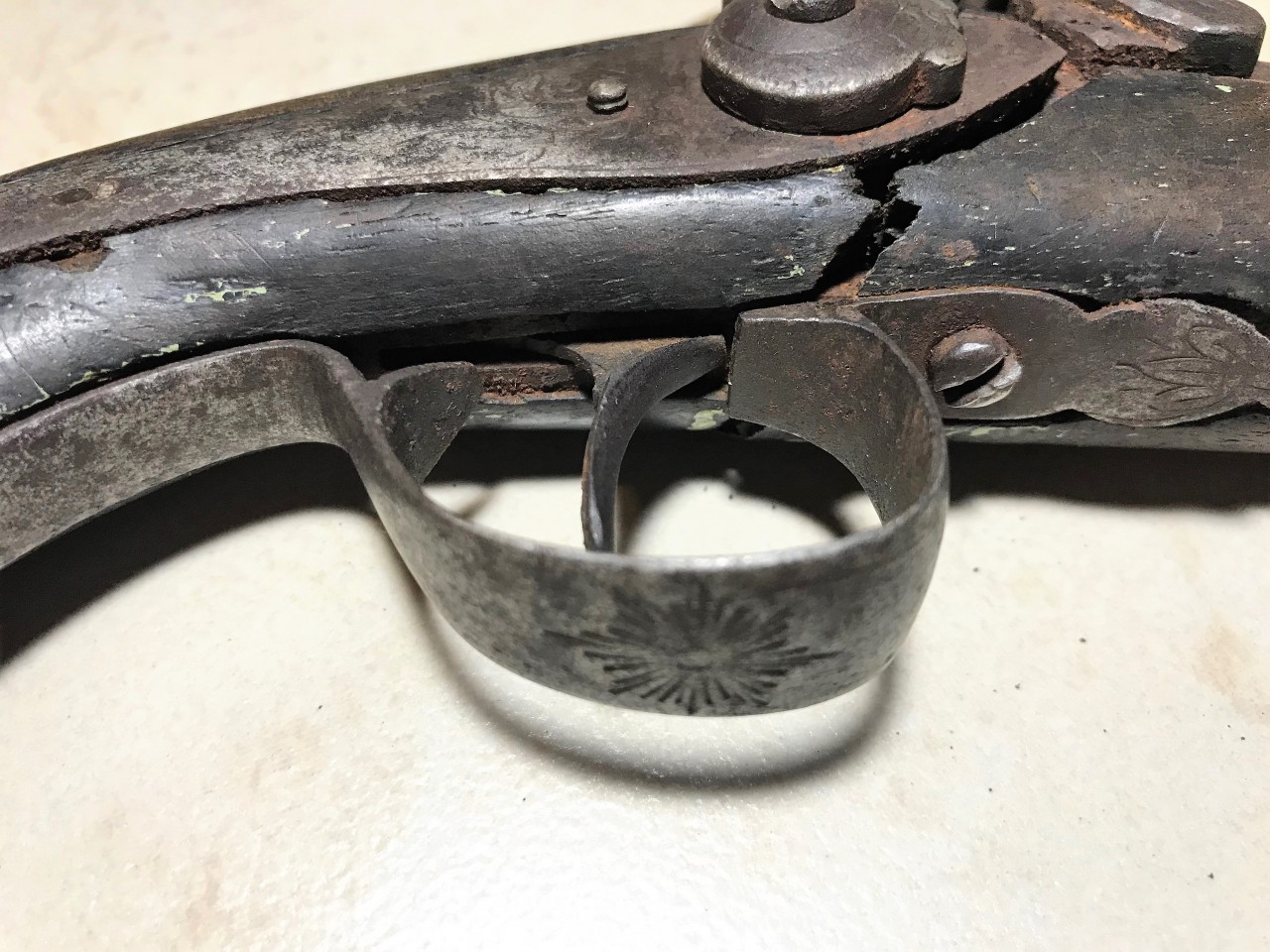

These kinds of pieces to be are incredibly and ruggedly charming, and for me the closest they than be kept to their 'in situ' condition, the better they reflect the history they have seen. I always believe in minimal control of any existing corrosion, with as much patination left as possible. With acid etching, it is often a fragile advance indeed.
That sunburst or starburst or whatever on the trigger guard is very similar to same seen on considerable material culture and weaponry in Mexico, and reflects the Peninsular heritage of these people. Some of my favorite arms are those of 19th c. Mexico and earlier in the colonial Spanish periods. While this is of course a Spanish made weapon, it certainly reflects the many examples which came to Mexico with industrious Spanish families seeking prosperity in Mexico.
