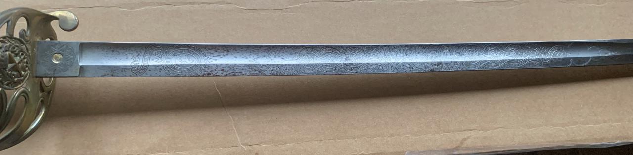

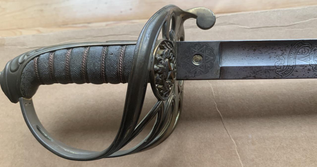

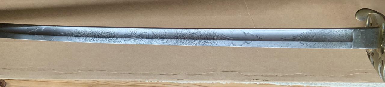

The blade is etched with 13 battle honours, IX, Britannia, HJ Wilkinson and his family crest. The guard has had the VR replaced with the general officers crossed sword and baton. Fenton was nice enough to have taken a photo of HJ Wilkinson on horseback.

The guard is the new pattern for the non folding hilt. He would have had the VR replaced with the general officers crossed sword and baton.

Adrian the guards regiments got new pattern steel hilts in 1854 with their own crests in the ovals.
This sword has the brass infantry officers hilt and the oval originally contained the "VR" and now has the crossed sword and baton for general and staff officers for when he went to Control Department.
