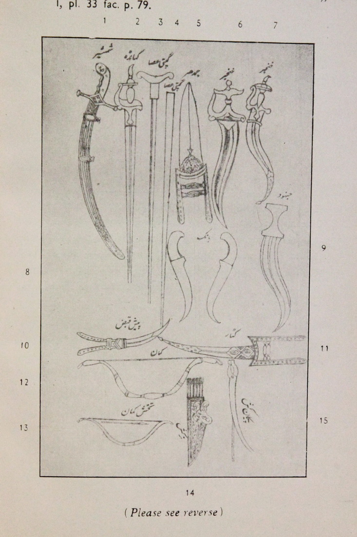

In Arms and Jewellery of the Indian Muguhuls by Abdul Aziz a plate with weapons is shown from A' in-i-Akbari (Akbar r. 1556-1605) - see the plate below. In this case it is nos. 5, 10 and 11 which is of interest. The text to these three numbers goes like this.
No 5 jamdhar, no 10 narsingh-moth 8 (according to Blochmann, in the plate the name is pesh-kabz) and no 11 katara.
All three we would happily call katars, but in the 16th century things seem to have been more complicated. It is interesting to see how little a weapon had to change before the name changed - especially when it comes to nos 10 and 11.
Pant wrote that a katar is not a katar, it is a jamdhar, and this seems to be correct, but only when it looks loke no 5.
Maybe it was Egerton, or maybe not, who 'collected' all there different daggers, and used the name katar.
As we dont know all the different names used for these daggers, my suggestions is, that we go on using the names katar/jamdhar and no other names, as it will only make the confusion bigger.

No doubt, old Hindus had some reasons to use different names for these apparently identical weapons, but we do not know whether this was due to linguistics, location, personal moniker, some feature that we cannot identify or anything else.
If in the future we manage to find out the reason, we may have to re-assess our current approach. Till then, katar is good enough for me, and the obsession with blindly subdividing 3 objects into five distinct groups may well be abandoned. Let's stop the madness.

Although Babur only ruled in India from 1526 to 1530 Baburnama tell us, that he amongst other things gave katars/jamdhars as gifts. Quite unusual, as he must have 'adoptet' the katar quickly, or it would not have been mentioned, and strange as other countries did not seem to think highly about the katar.
Another interesting thing is, that in the drawing is shown one katar with a straight blade, but two katars with a curved blade. To day the katars with a straight blade are found like 'sand at the sea', but curved bladed katars are rare.
This is a fantasy picture from A' in-i-Akbari edition of late 19th. Like the inscriptions on it
