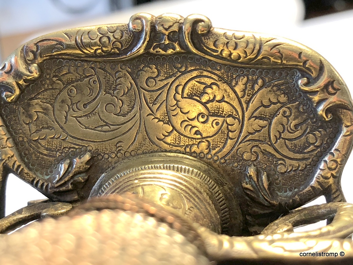

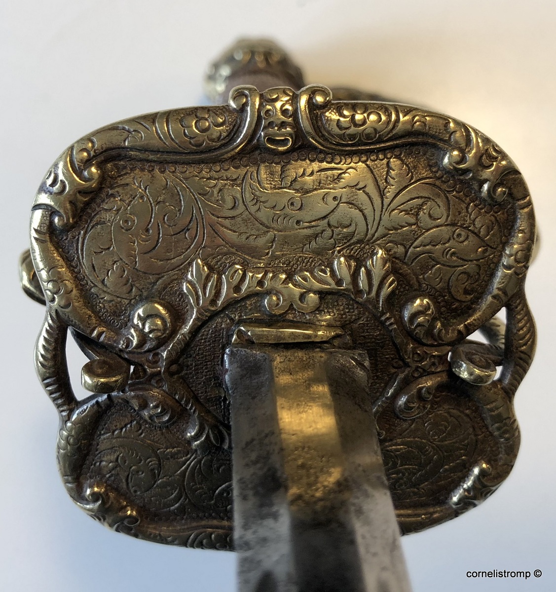

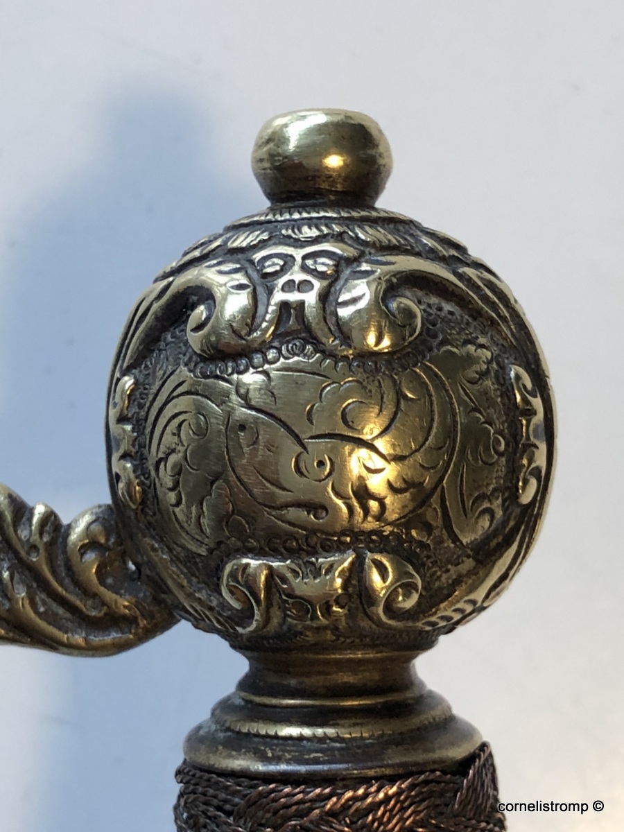

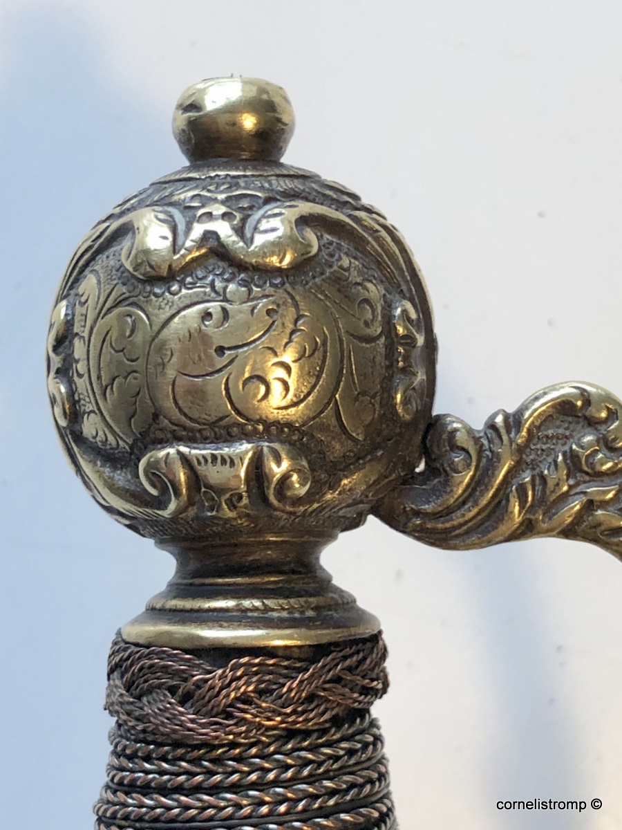

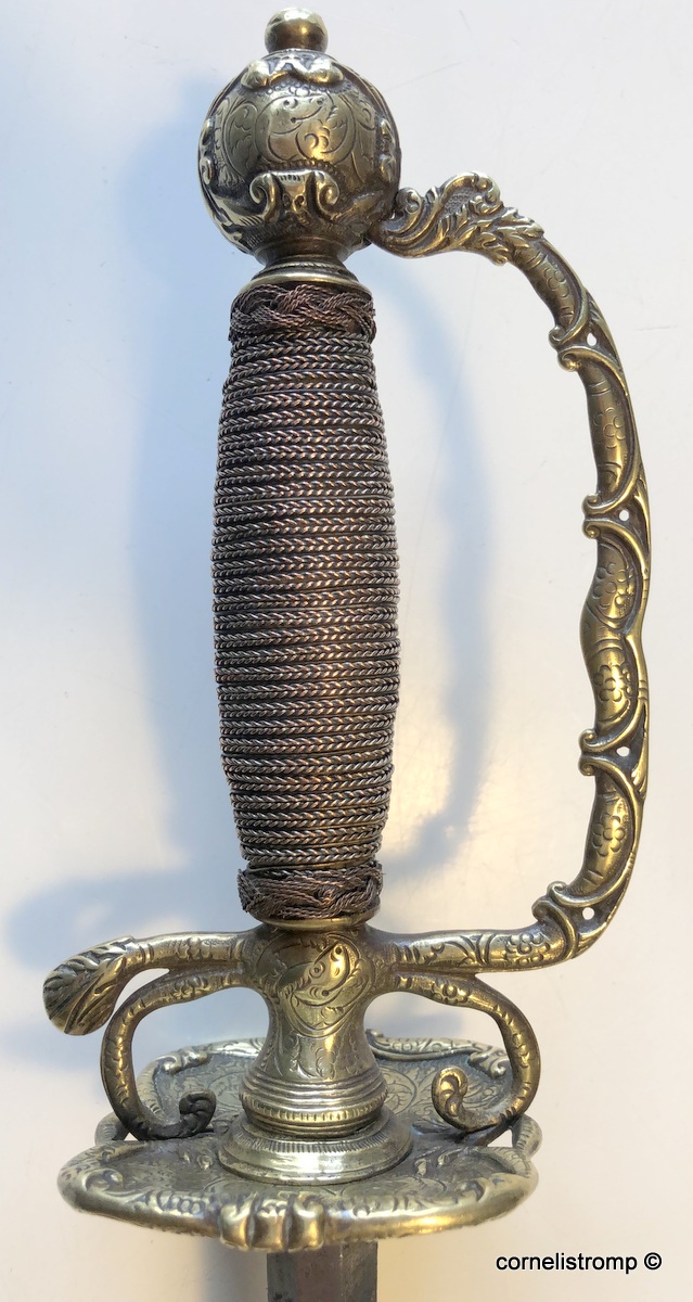

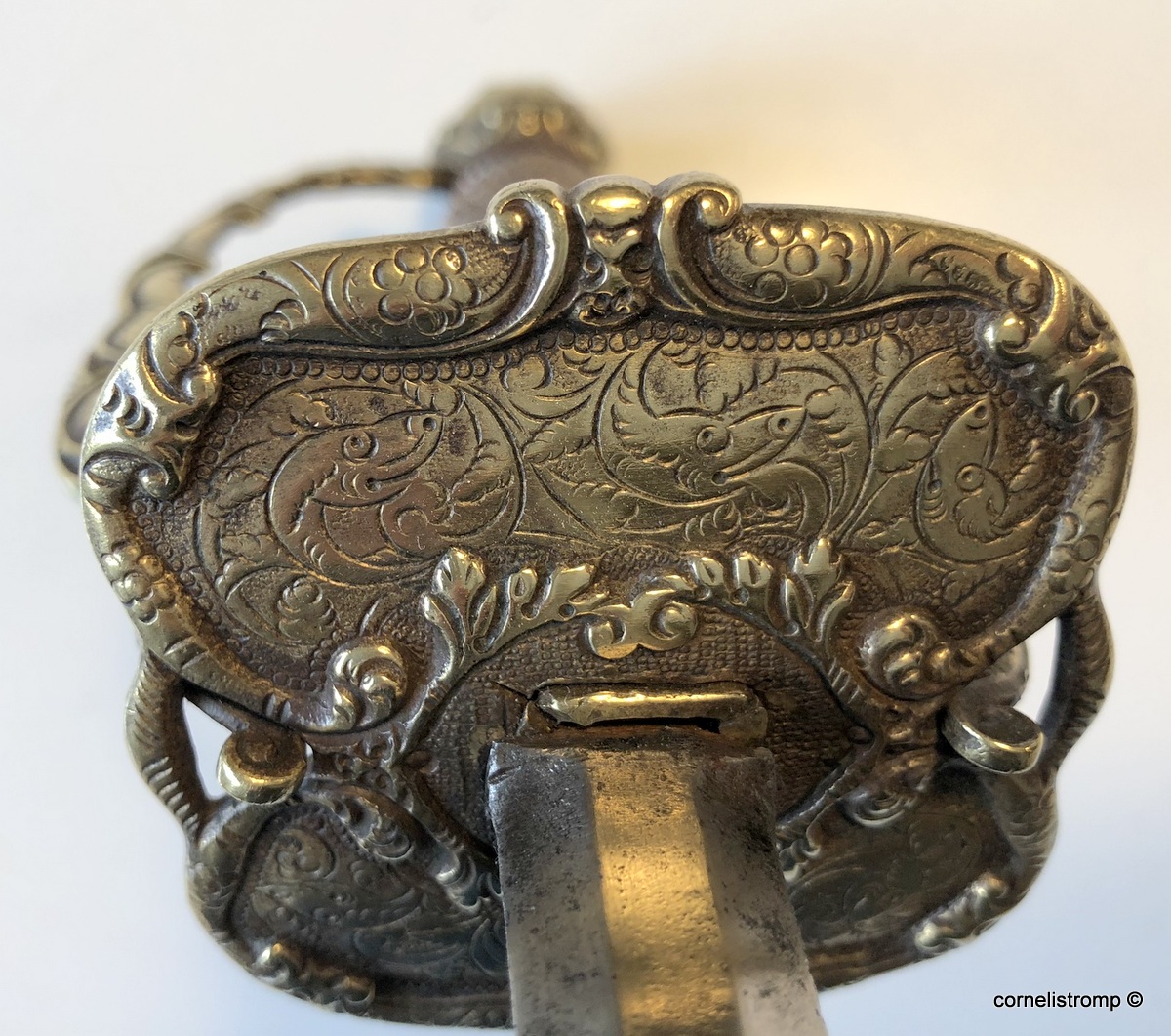

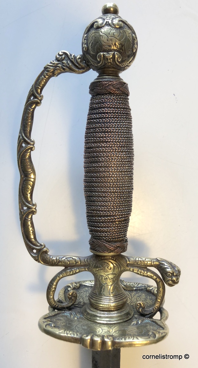

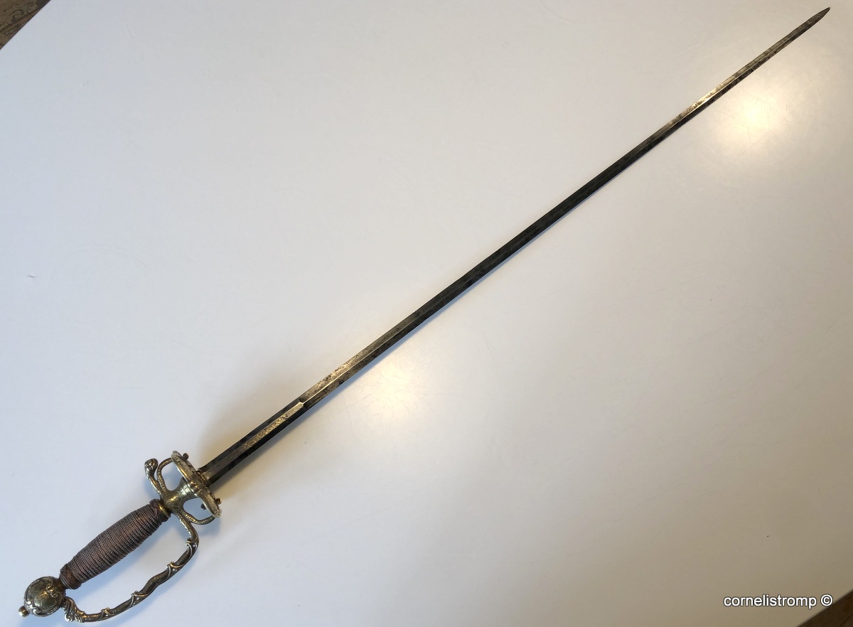

At the beginning of the 18th century there was a lively trade between the Netherlands, China and Japan.
A good example are the small sword hilts made of antimony gold and copper , suassa metal, the so called Shakudo mounted hilts.
These were probably produced in Tonkin China ( Tonkin under japanese influence) and exported to the Netherlands where they were assembled into complete swords by the Dutch swordsmiths.
The Asian influence also entered into the Dutch production of small sword hilts.

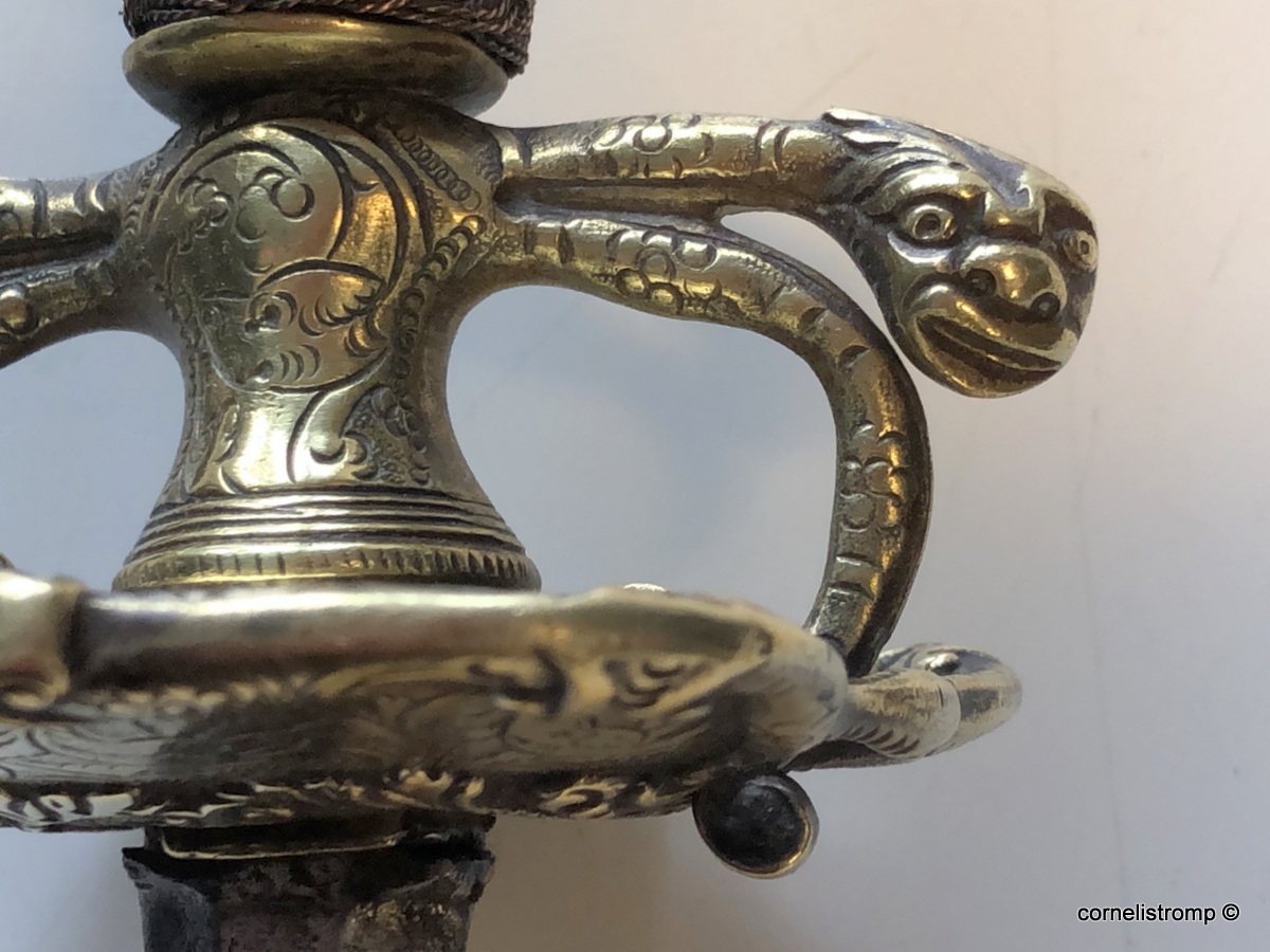

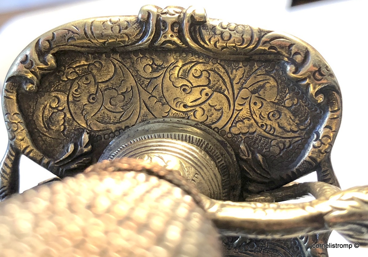

an example is the smallsword of this thread, not Shakuda, where the asian influence is clearly visible.
The nuckleguard is in the shape of a serpent tail, winding with scales, the guillon ending in the monster's head.
The holes in the knuckleguard could have been used to decorate colored yarns.
there are images of asian looking? masks on the pommel and on the Shells.

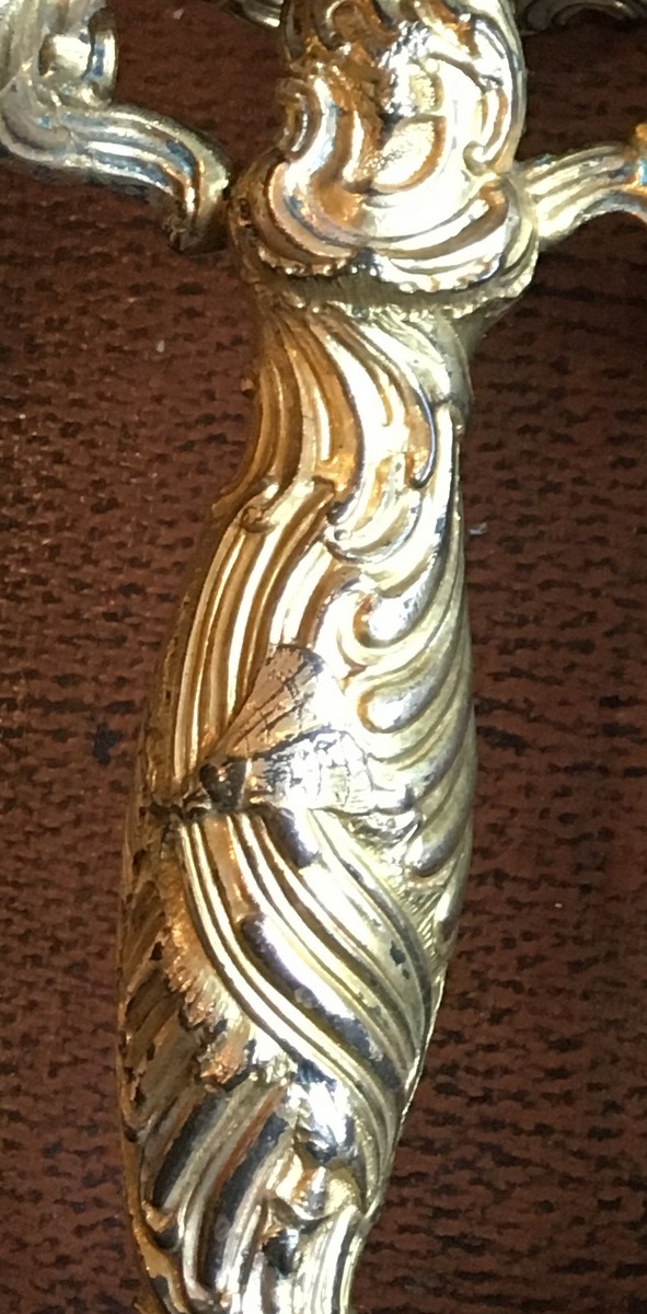

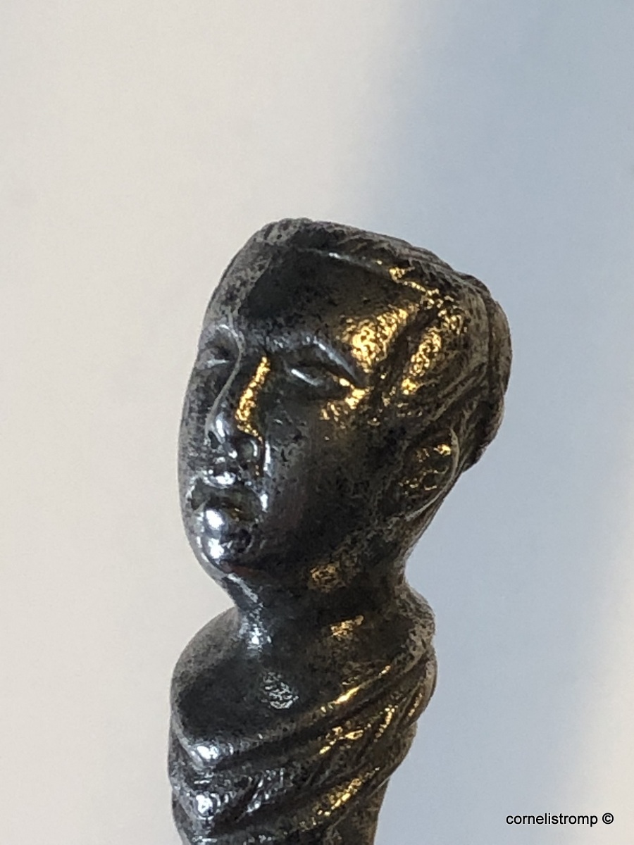

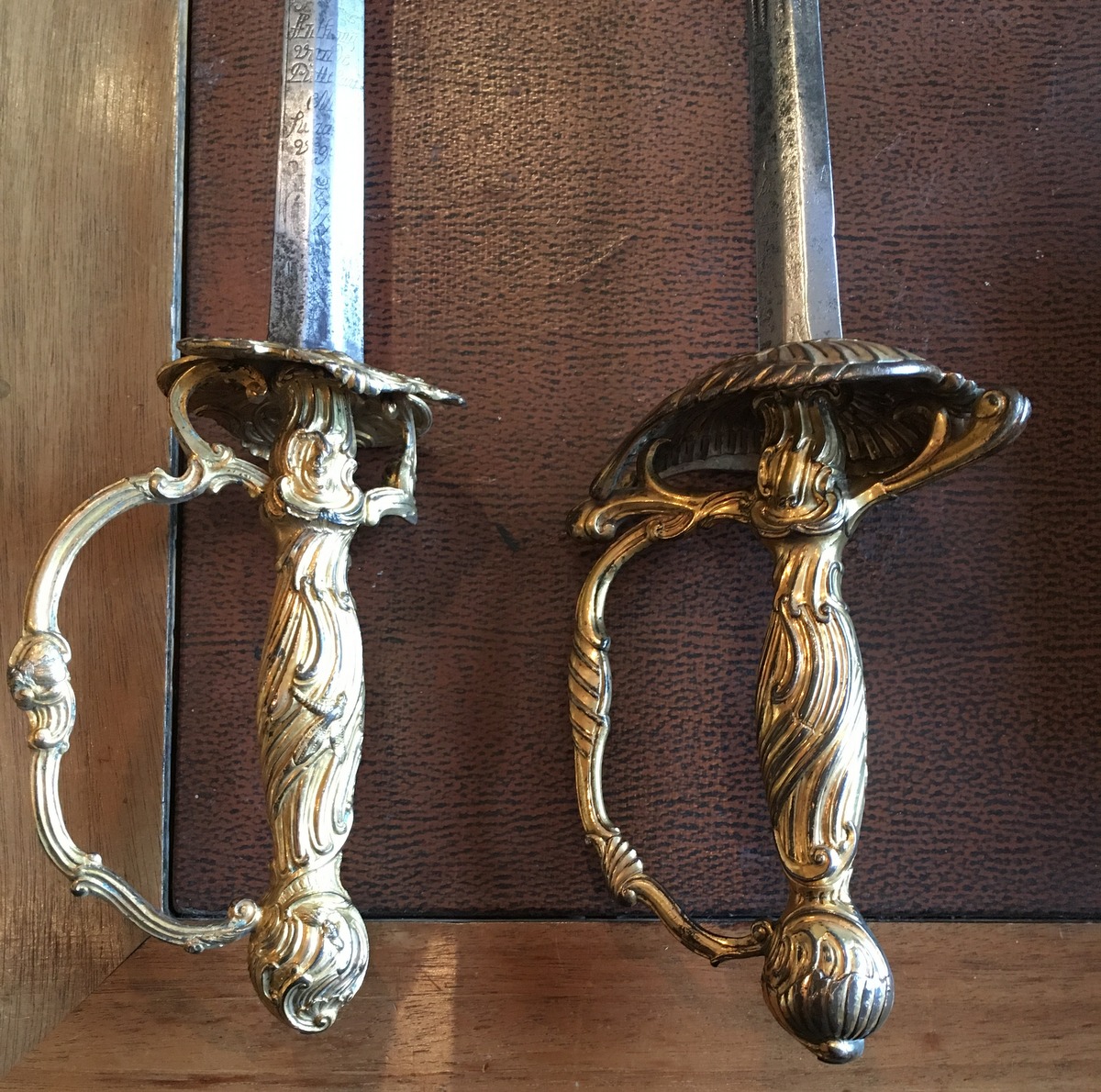

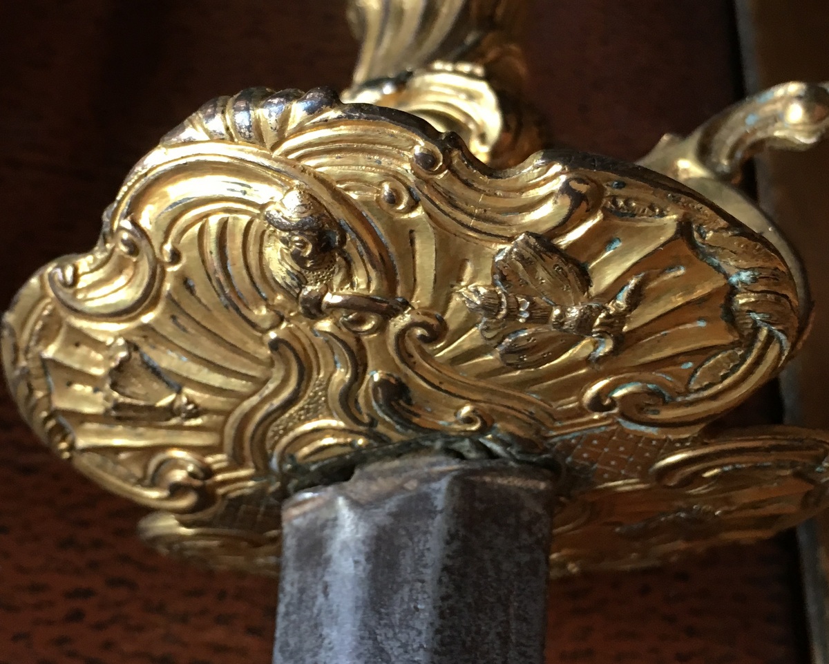

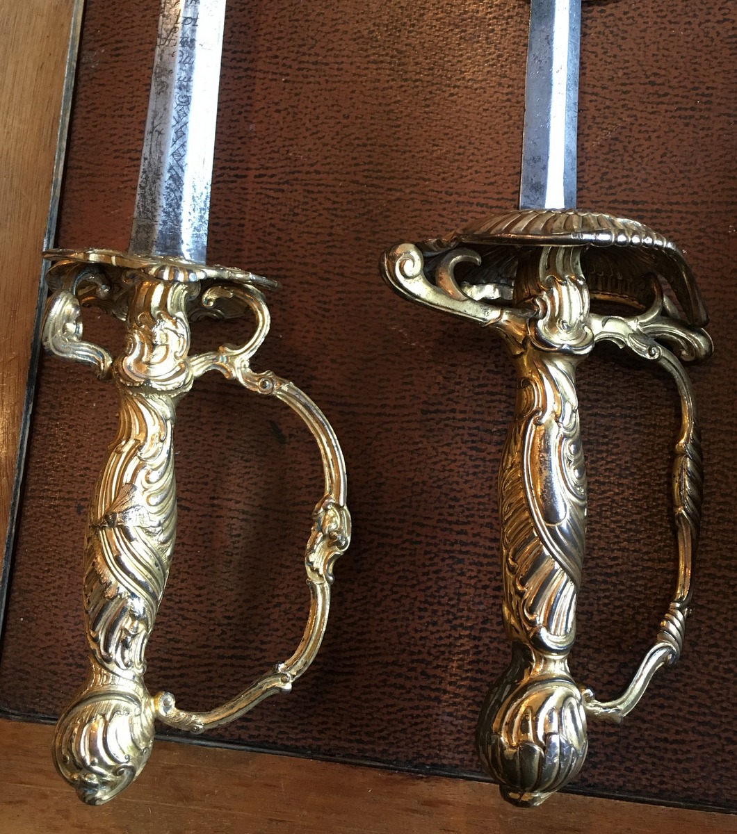

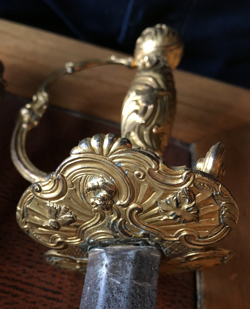

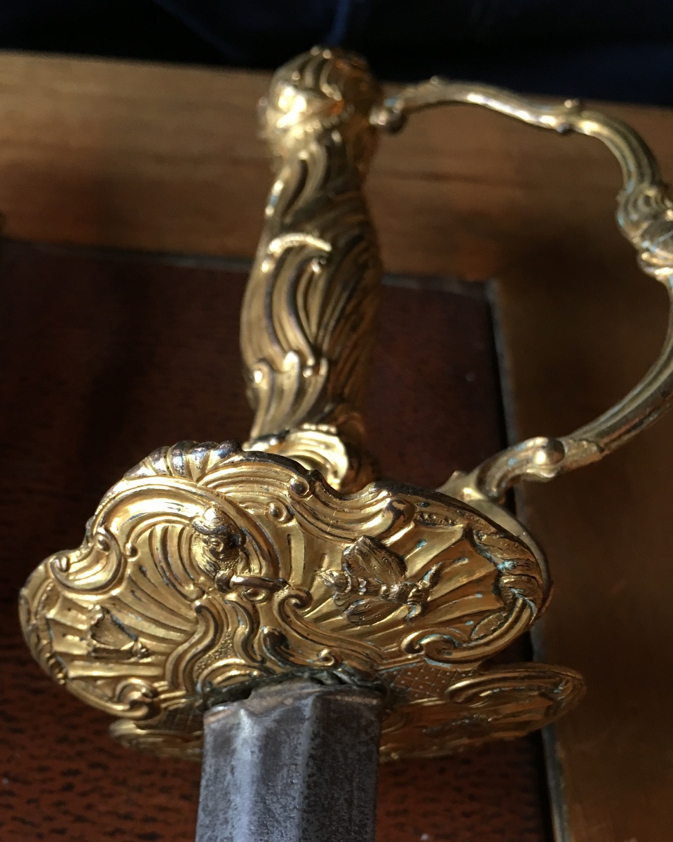

two similar 18thC smallswords made from black fire-gilt metal, Suassa ?
the grip pommel quilllon block and pas dáne are out of one piece, this requires a very high level of craftsmanship!
the lines are clear and sharp, really works of art.
one with the blade marked by the Amsterdam swordsman Jean Hossee, the other with Japanese ? characters.
The decoration of insects, leaves and Japanese? workers with the characteristic hats.
these hilts are probably made in asia and mounted in Asia or Holland.

Thank you Jasper for sharing these two examples which show fascinating comparison.
Aylward (1945. p.57) he describes 'Tonquinese' made in the Far East for the VOC between 1710 and 1750 but claims this could not be correct as Dampier (from "Dampiers Voyages", Mansfield, 1906) in noting all the manufacturers at Tonquin, there is no mention of swords being made there. He notes further that the VOC withdrew their factory there in 1707.
Here he suggests that the work went to Peking, and that afterwards, "..the company brought over some Chinese workmen to Europe, who produced in Amsterdam 'hilts of similar character' which were fitted with blades made in Holland and Solingen".
This seems contradictory as if no swords were made in Asia, then what hilts of 'similar character' were made by the Chinese workmen in Amsterdam?
Also, you have noted that Tonquin (whose location is not specified in Aylward) was actually/probably Tokyo. The shakudo (black bronze) described is, if I presume correctly, a Japanese alloyed metal and process...not Chinese.

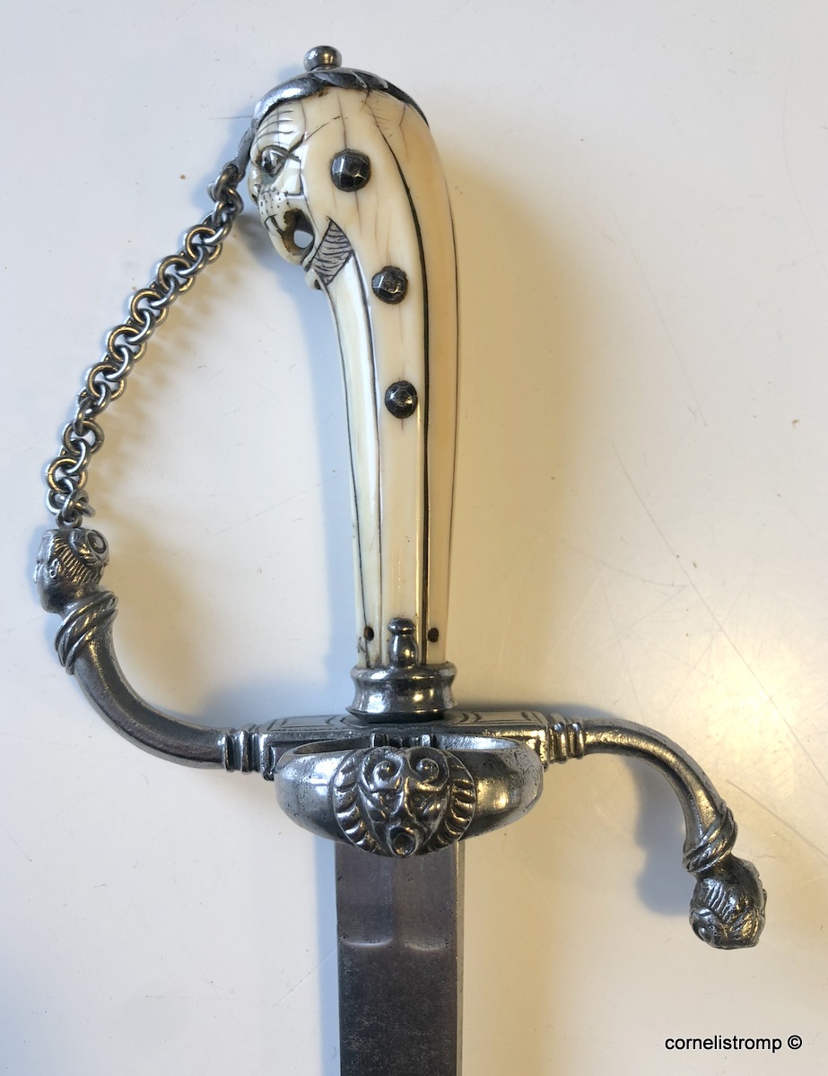

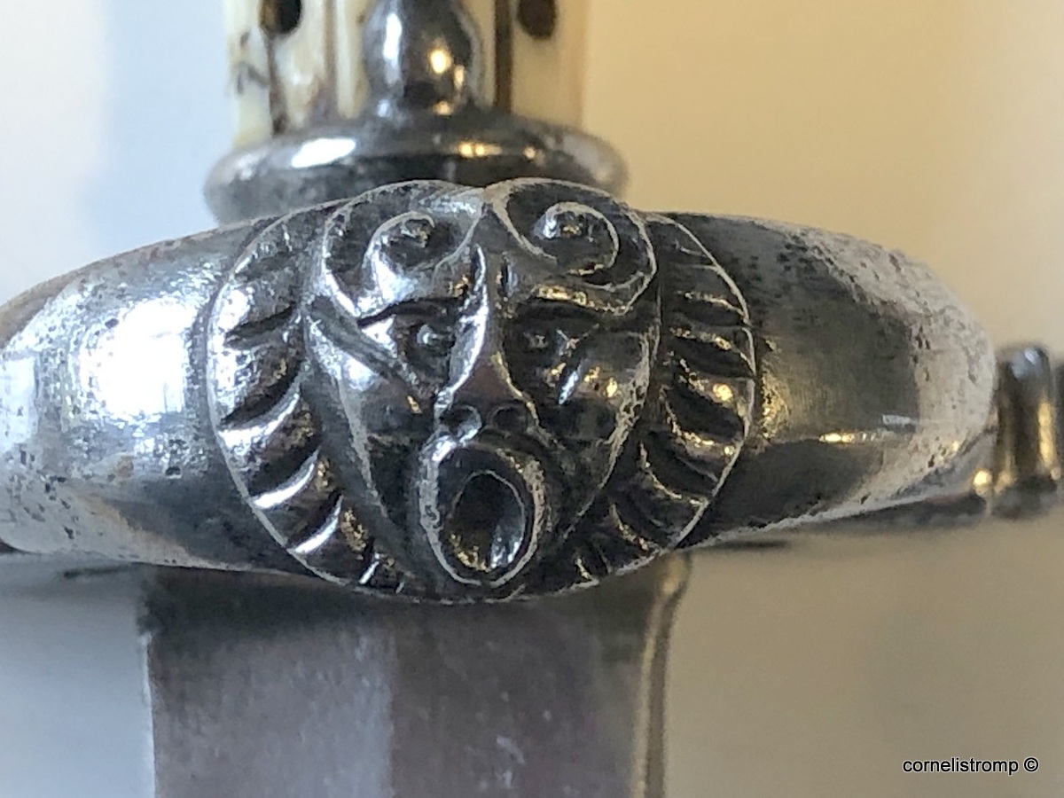

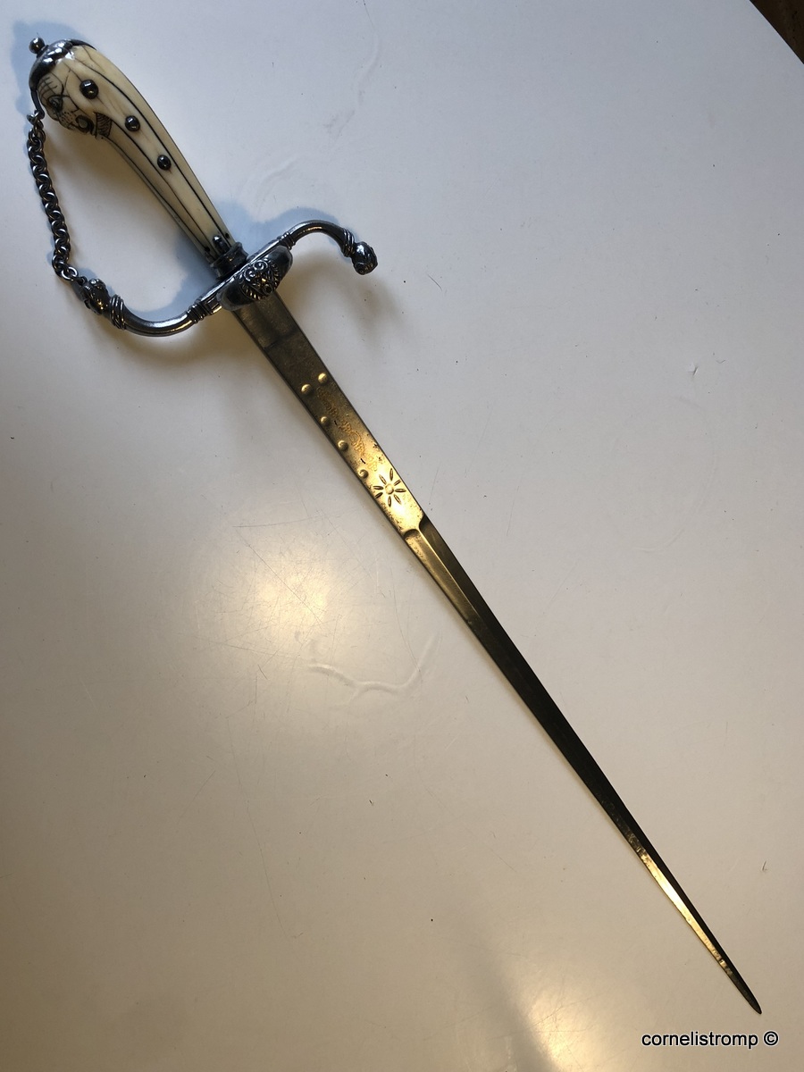

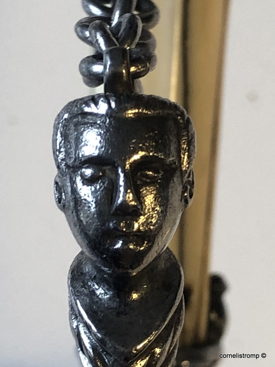

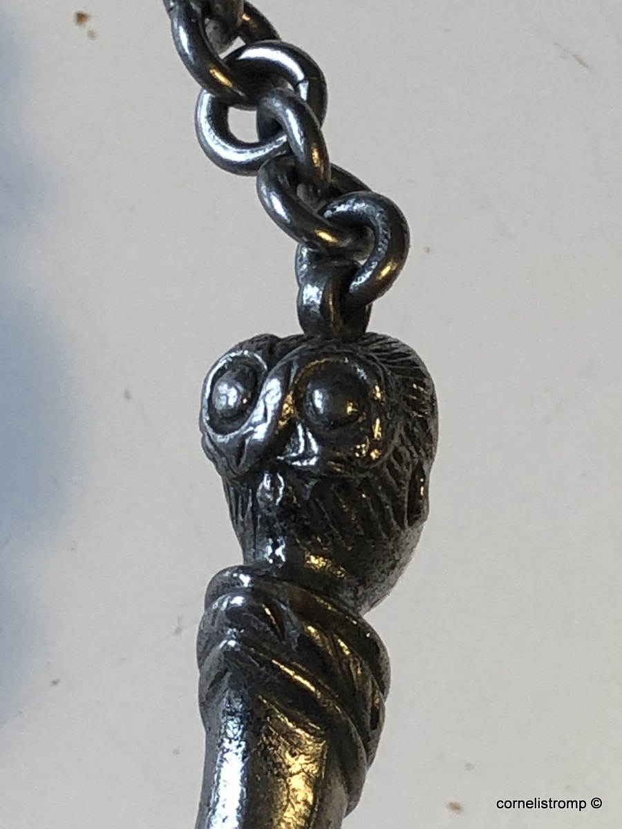

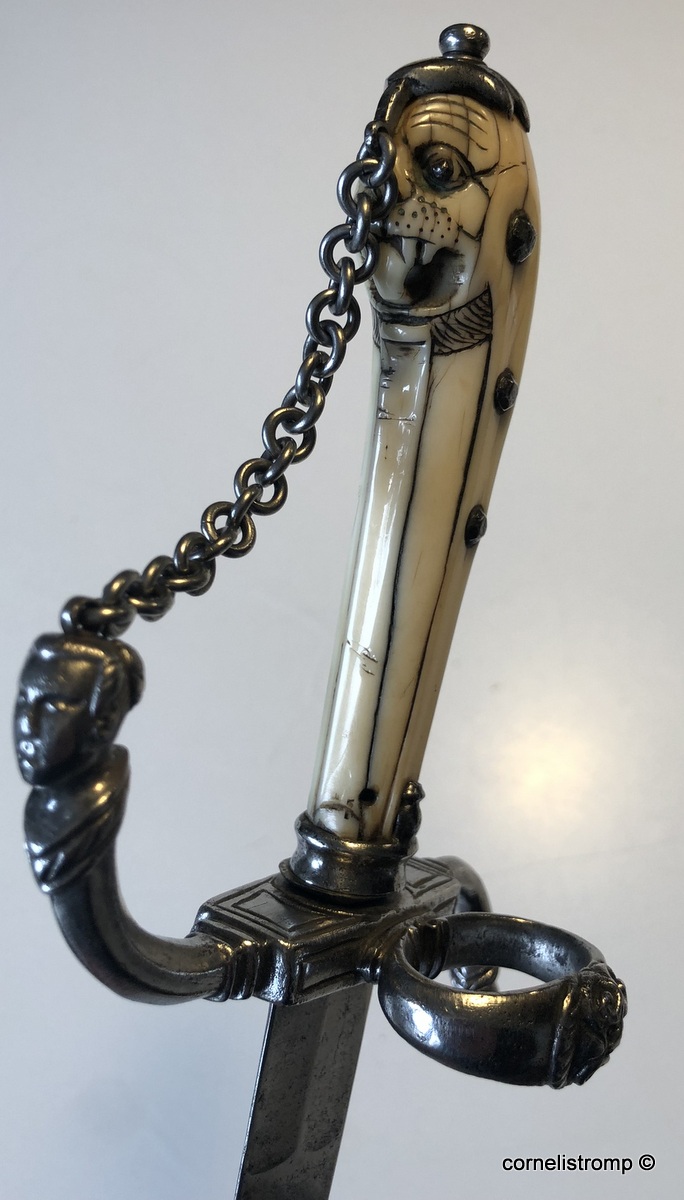

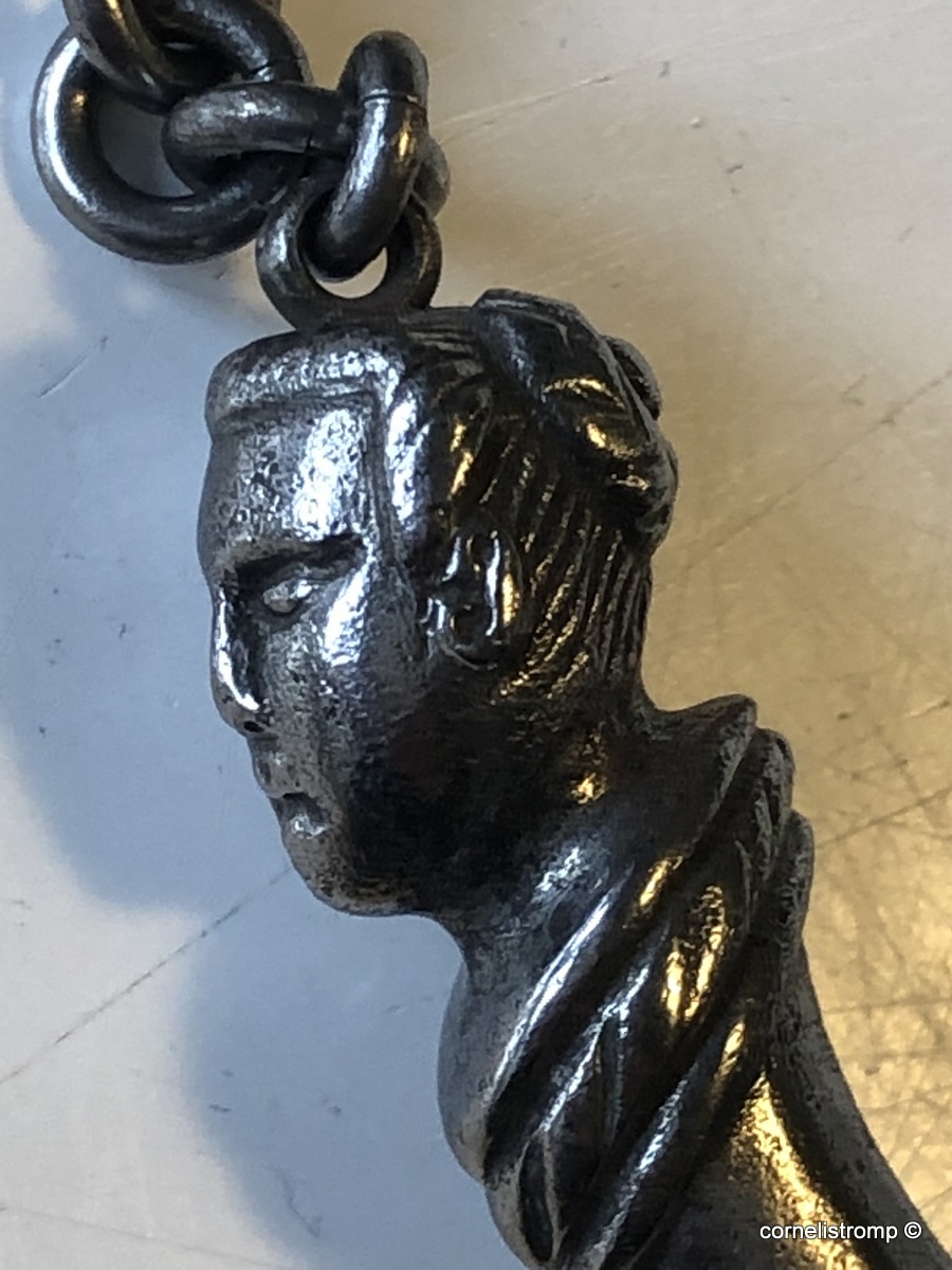

a mid 17thc hanger/smallsword with a chain between the guillon and the pommel cap and a paternoster carved on the blade which are both typical characteristics of Dutch 17thC smallswords.
note the carved ends of the guillons in the shape of the head of a Samurai and the demon mask carved on the loopguard
re: Asian Hat of post 5.
Luyken, Caspar and Engelbrecht
Boucquet. Portret Kangxi, keizer van China.
1698. Rijksmuseum, Amsterdam.
see attachement of emperor of china.(Dutch art)
best
jasper

Another breathtaking example Jasper, and as you note, the familiar Samurai hair style is seen......the illustration of the Chinese man also shows the hat similar as previously discussed.
More evidence of the stylistic exchanges between China and the Japan/Dutch trade alliance in Dejima (near Nagasaki). In Peter Bleed's article he notes the profound influence of Dutch (European) artistic style in the work in their famed tsuba (disc guards) on their swords. The Dutch in kind, adopted clearly Oriental motif in their hilts.
An aside, there were profoundly represented hilt styles produced in Sri Lanka for the Dutch, who also adopted their motif and kastane style in some hangers, and I believe a good number in ivory.
