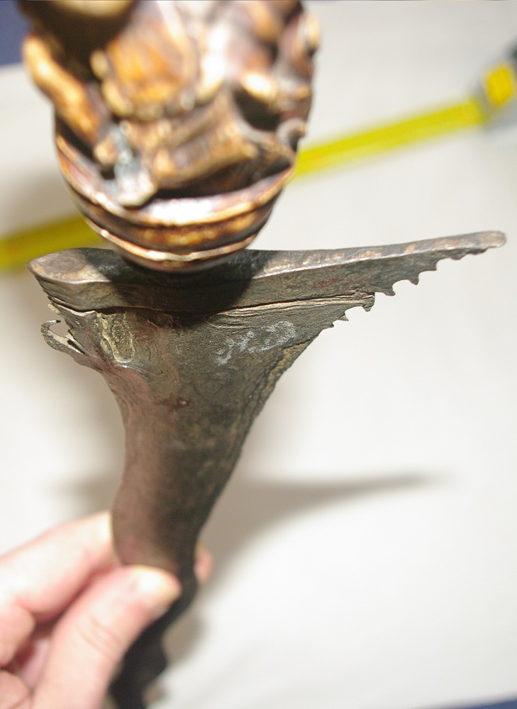

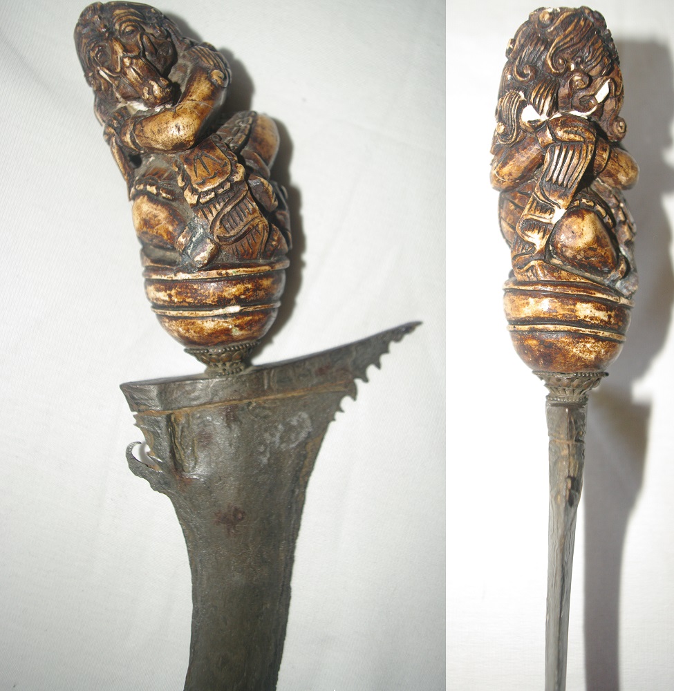

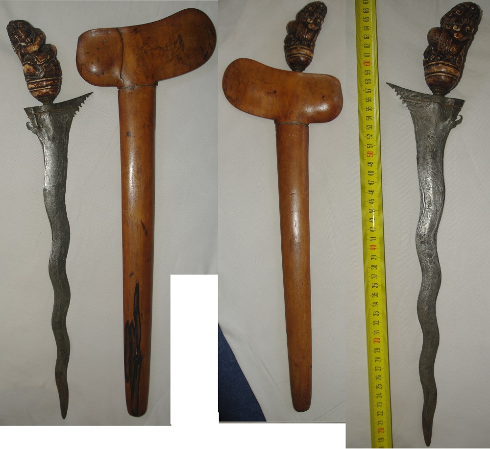

This keris has many javanese features (Sheath, blade surface, mendak), but also others are strange compared to my other javanese keris (the size: 40cm for the blade) and the hilt representing Ganesha.
The scabbard measures 47cm and fits well with the blade.
The hilt was broken and repaired with a lot of glue in the past, impossible to remove. It looks like plaster (or resin?) painted to imitate old ivory.
The hilt probably dates from the second half of the 20th century but the blade seems older.
I think this Keris comes from East Java (or Madura?), but I don't understand the mix.
What do you think?

In the case of this example we have a keris of Balinese size, but of very distinct Madurese style, and dressed with the Madura-Bali wrongko.
Forget the hilt. Put it on ebay and look for the correct hilt for this wrongko, like a Bali bondolan, but a little bit fatter and shorter.

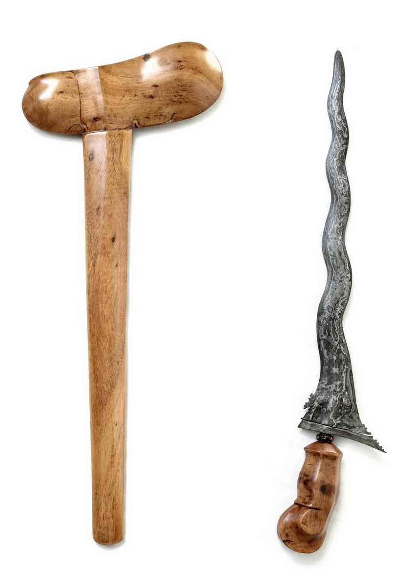

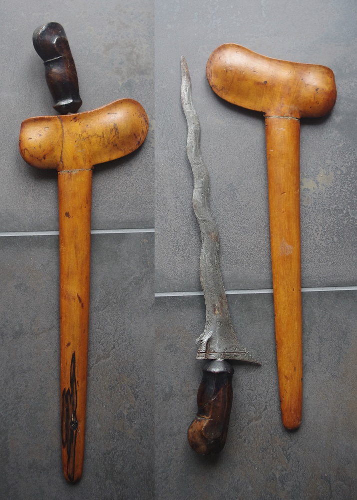

A similar blade and a similar scabbard as those shown by Athanase.

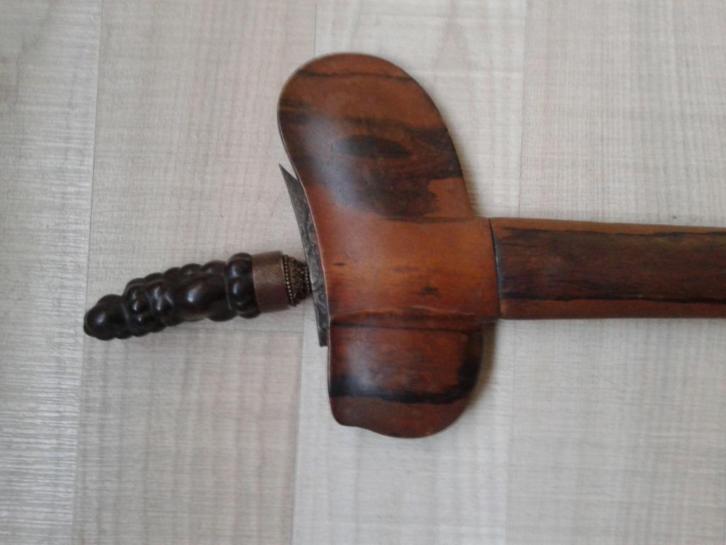

I have a little question :
With the bondolan hilt, I keep the Javanese mendak or not?
