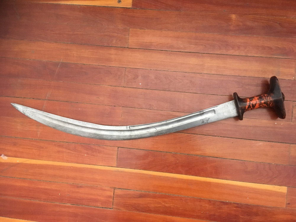

Default ethiopian sword/arab blade???

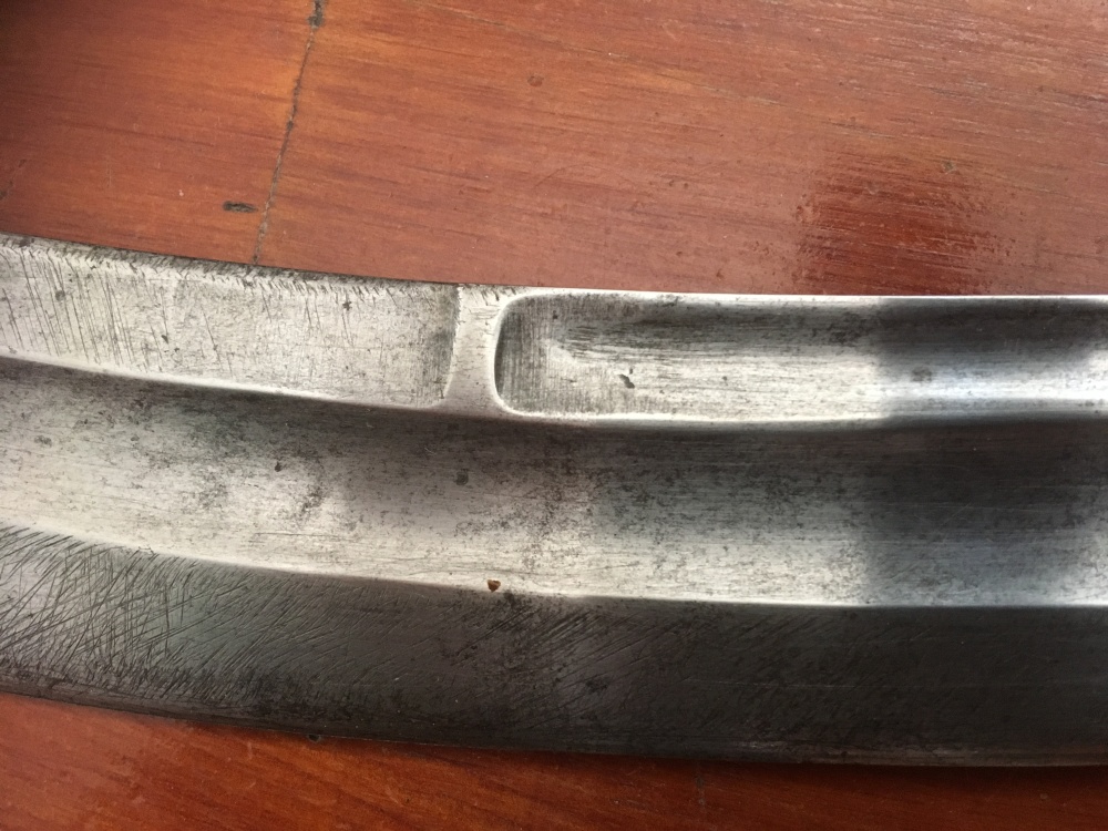

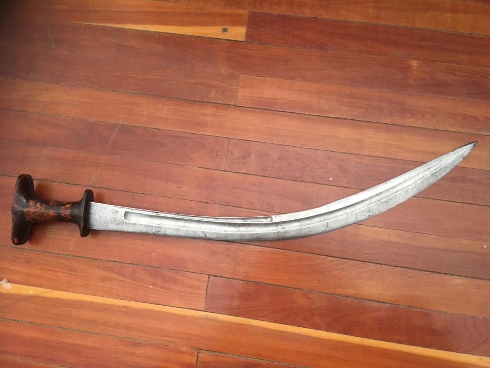

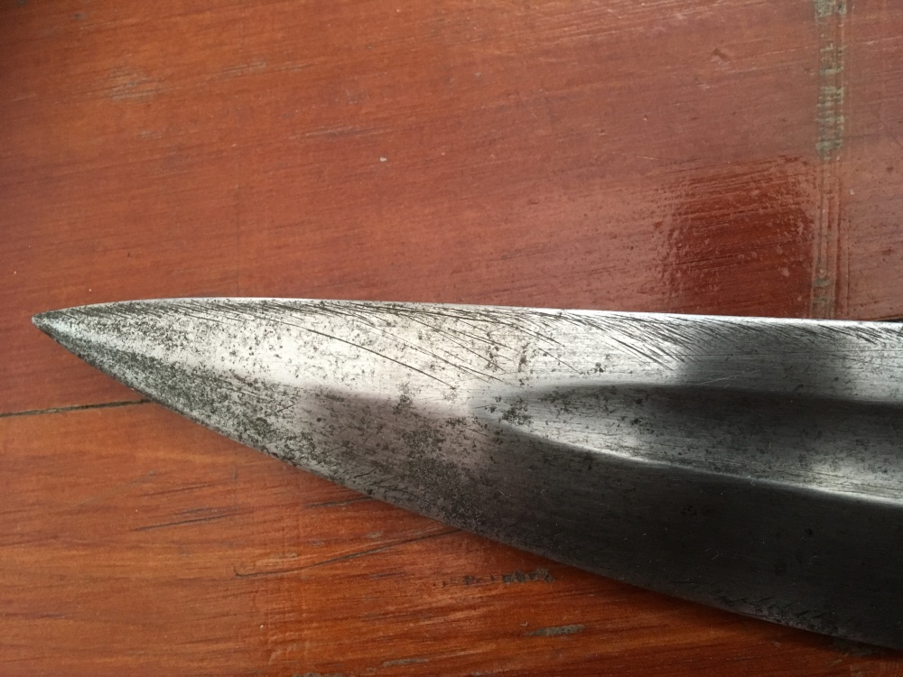

I just got this gorade. I need an expert opinion to identify the blade. I think is "Arabian"? Maybe from North Africa? Any idea about the age? Cheers.
Old 26th December 2018, 12:01 AM   #2
I am inclining toward European trade, German more likely.

I agree with Ariel that the blade is likely Solingen from where many blades were supplied to Ethiopia. Wilkinson of London also supplied many blades to the region.
I would discount North Africa or Arabia as point of origin as it is most unlikely that any blade from there would be decorated in the manner shown.
As to age, the blade is likely 19th or early 20th century though the date of mounting could be any time.

Based on what I saw coming to the market, most gurades sport European blades. I have one German and one Russian, Zlatoust dated 1853.
Wilkinson made shotels as well, but all I have seen were obviously local.

I am also of the opinion it is rather European blade, but it does not seem to be one of those typical custom-designed (decorated with etching "on Ethiopian requests").
The blade from Zlatoust dated 1853 could originally be a property of one of the cossacks or dragoons accompanying Russian envoys by the end of 19th century. Such blades are not common on gorades...
I saw one gorade with interesting - probably Persian or may be Turkish blade. I hope I´ll be able to post a photo later. But such combination is also not common.

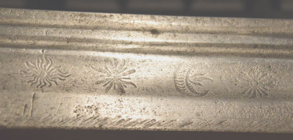

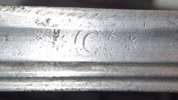

Back to the subject of this thread: these crescent and star symbols are obviously Muslim and I recall seeing similar markings on Yemeni mounted blades. Swords generally traveled from Ethiopia to Yemen because of the rhino hilts, but it is possible this European blade traveled in the other direction.

These 'cosmological' markings are also typical of those found on various European blades in both talismamic themes as well as makers marks. Firms such as Schimmelbusch & Kirschbaum used these kinds of stars and comet and others used the crescent moon. These were often adopted and spuriously applied on trade blades in various entrepots receiving them.

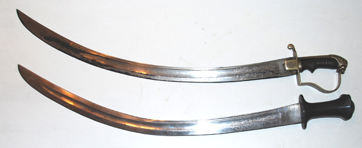

Here are two Russian swords from Ethiopia. Both have the two-headed Russian Imperial eagle and the puzzling sun with 4 letters. Initials of an Armenian merchant???

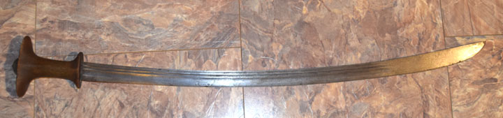

....I saw one gorade with interesting - probably Persian or may be Turkish blade. I hope I´ll be able to post a photo later....
Here it is

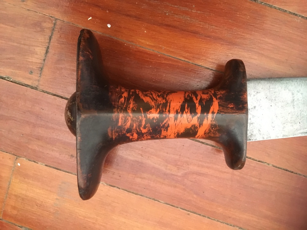

I forgot to ad: The blade is cca 1 cm thick at its base, The "yelmen" part takes ca half of the total length and is sharp from both sides, The sabre is heavy and the blade is not flexible. Pronounced grooves are deep.

Rather unusual. What is the hilt\handle made of?
It looks like some kind of root\burr wood.
Richard

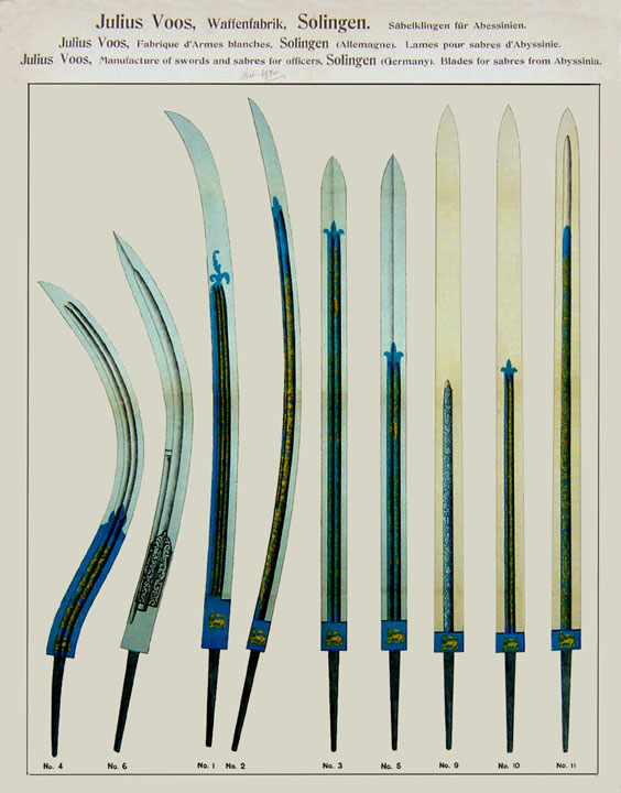

The gorade is a Solingen blade. It appears on Julius Voos catalogue of Abyssinian blades as #6. I have seen 6 so far. All of them are plain, with the exception of the one I have in my collection, which has an inscription in Amharic naming Count Leontieff as owner.

Re. Colored handle: not plastic, I presume?

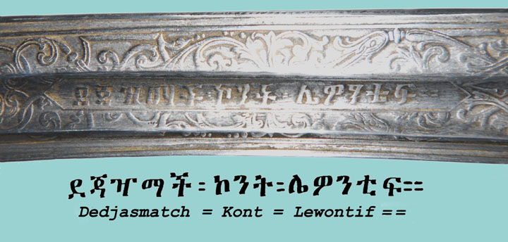

As to Leontieff’s gurade: outstanding find!

Sorry for the late answer, I was travelling a little.
First of all, thank you roanoa for the identification of the blade, I did not see it before (and thanks for reference to Julius Voos catalogue, which I also did not know).
The handle is made of plastic I think. Maybe imitation of tortoisesshell
Is it plastic or bakelite?
https://en.wikipedia.org/wiki/Bakelite
Many old jambiya have bakelite hilts... I'm pretty sure that your hilt is original...
