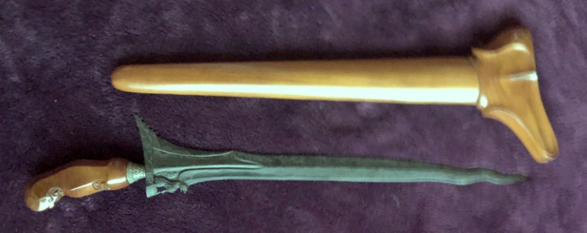

Looking over some articles on keris I saw one of my keris with a Singa Barong ( I think). I believe that most of Indonesia is Muslim with the exception of Bali (Hindu). And yet a type of Hindu symbol of the Singa Barong has been pictured on Javanese keris.
There seem a few other questions, what about the blumbangan? Is it somehow incorporated in a non-traditional way?
What with the extended sogokan?
Of course, the Muslim influence overlays a more primitive animistic religion. Seem the Indonesians just incorporate "new religions" over the old, existing.

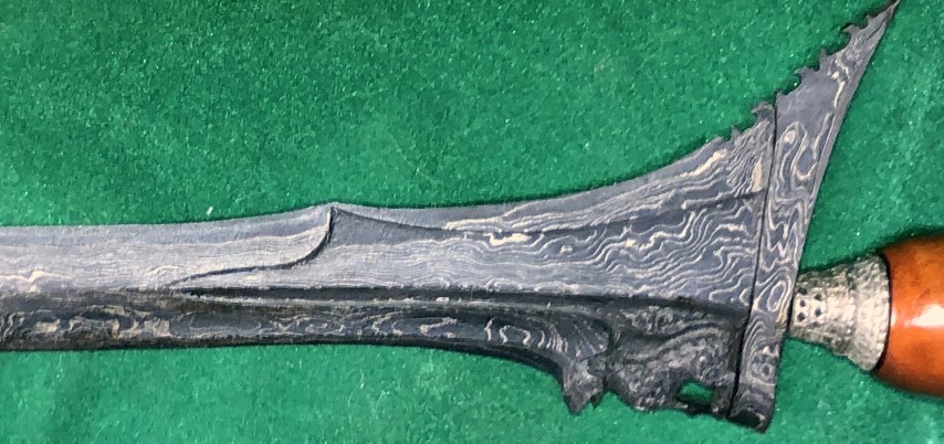

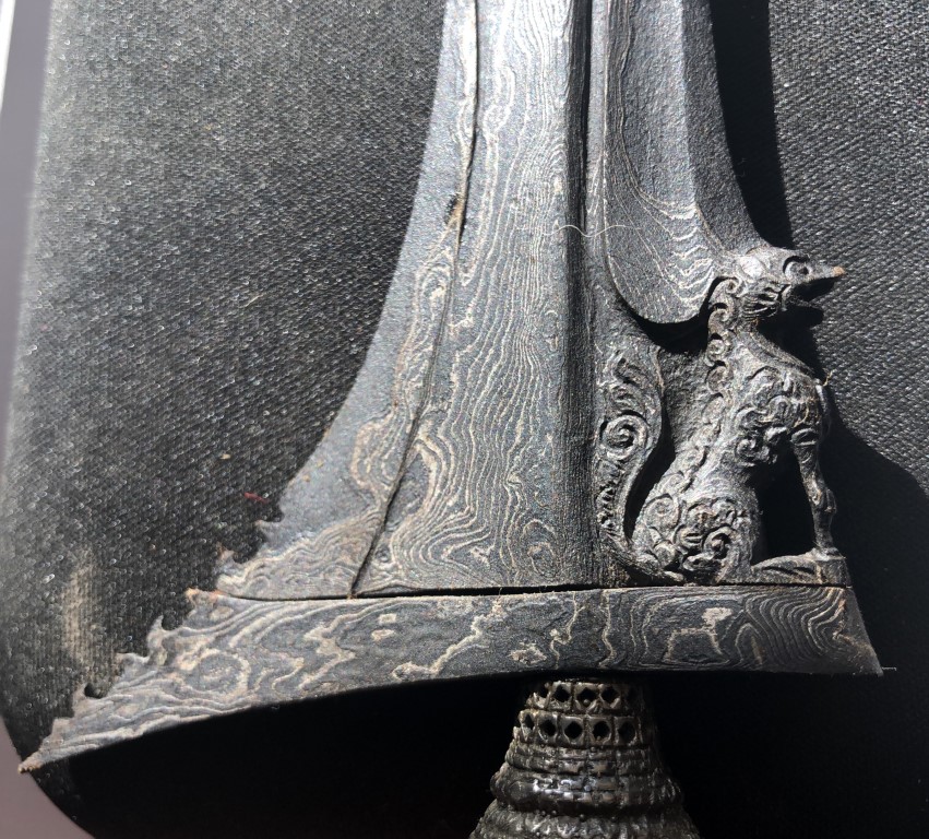

This seems to be a recently made blade with a Singa Barong motif on the gandik and a peculiar dapur which I would call Sineba (the protuberance at the back)/ Urubing Dilah (the 3 luk at the tip), and which is not a standard dapur matching with the SB motif.

Yes, this is a keris Singo Barong. To my eye it looks fairly contemporary.

I believe you have misidentified the backside sogakan as blumbangan. The blumbangan, sometimes also referred to as the pejetan, is located in the area where the hind quarters of your singo resides. Is this what you meant because i don't understand your question otherwise?

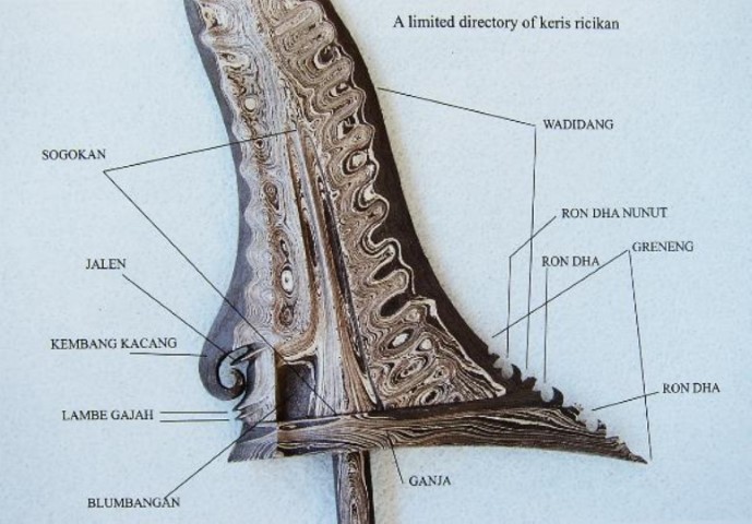

David, Trying to learn and I, as always, appreciate your input. My questions regarding the terminology. I am trying to regain some knowledge about terminology.
"...... about the blumbangan? Is it somehow incorporated in a non-traditional way?
"What with the extended sogokan?"
I was trying to relate the terms by this picture.
In "picture" keris (i. e. those with figural carving at the gandik), the blumbangan is usually reduced.
