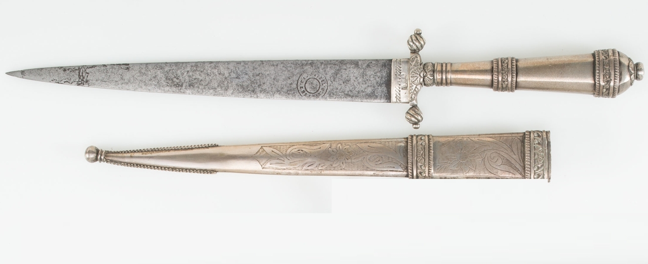

Hi gents,
Do you know what year it mas manufactured or what years this makers mark was used? It marked with "Sheffield Cast Steel" and letters TPV.
Any additional information is appreciated.
Alex

Originally Posted by alex8765
Hi gents,
Alex
A very interesting piece.
It is not clear from the photo how the sheath attaches to the belt. Could you please clarify this?
Any other markings on the spine of the blade or hilt?
Cheers
Chris

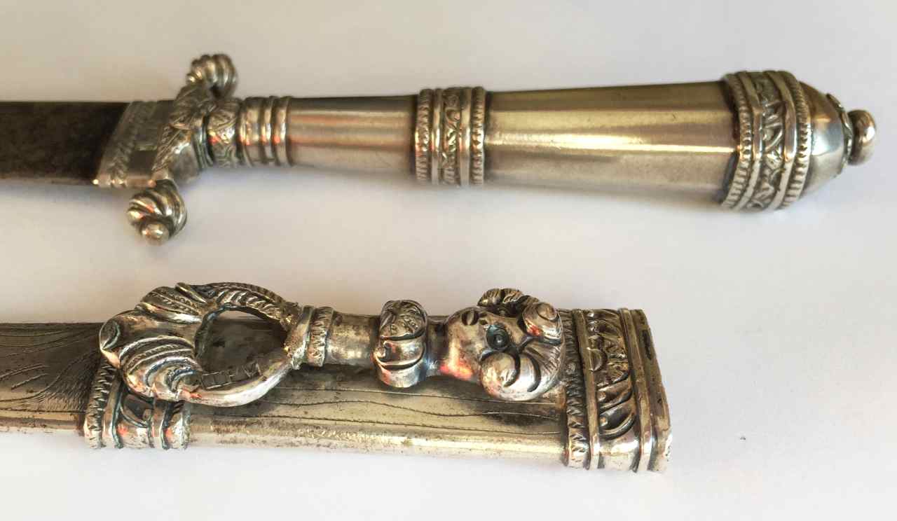

Hi Chris,
The scabbard is attached via belt clip, see picture.
Alex

Hi Alex,
Thanks for the photo.
You have a very interesting and somewhat unusual high quality knife pertaining to the Pampean regions of South America.
It is in all probability an old one, with an English trade blade mounted by a local silversmith, though it cannot be ruled out that it was made to order elsewhere, as many in use in that part of the world were.
The original owner of this knife would have been a man of some wealth and status as they were the only ones who could afford such a fine piece.
By modern Argentinean classification, it is a "facon" and not being a working knife, the ownership of these in the course of the 19th century was highly discouraged, effectively banned, for all except the military, ranch owners and their overseers.
I looked through two lavishly illustrated reference books, one being Domenech's Dagas De Plata, and could not find one quite like it, the unusual part being the elaborate handguard/quillons; Local silversmiths favouring a guard fashioned from a flat piece of metal.
Could you perhaps tell us where you obtained it from?
If you like a more positive identification, I suggest that you write to Mr Abel Domenech in Argentina, who can be contacted at dom_reloader@yahoo.com

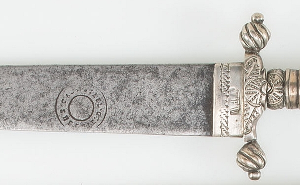

The letters T P V indicate the name of the silversmith who added the sheet.
On the other hand, I think a sheet that has been re-used, because the brand is off center.

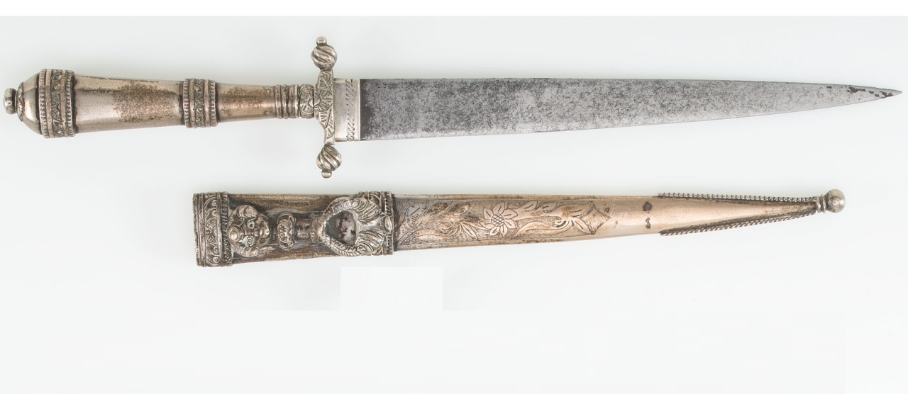

I received the reply from Mr. Abel Domenech regarding this knife:
As you may know, gaucho knives can´t be classified in a very strict basis because they were made locally adapting blades coming mostly from Europe and sheaths and handles were made by skilled silversmiths following the aesthetic taste of the epoch.
The present accepted classification of "facon" "daga" "puñal criollo", etc. etc. is a modern convention generally accepted by collectors but was never used in the past in same way as today because in those far years knives were named in a very confusing manner and they called cuchillo (knife) daga, facon, etc. following their fancy or custom without paying much attention to the shapes or characteristics of the piece itself.
In this case your knife follows approximately the shape of a "facon" but I wouldn´t classify as that as it seems to me it has a blade of around 23 centimeters only.
Real facones were fighting edged weapons which sported longer blades of around 35/40 centimeters up to 50 (and of course there existed with longer blades taken from swords which received the name of "caroneros" because they were carried between the leather "caronas" a part which composed their horse saddles)
Now... How I could call your knife? Well I could say it is a dagger or pointed knife which was carried by its owner as a sign of wealth and power and/or as a personal defence edged weapon. In Brazil this shape of blade was very popular and known as "faca de ponta" (knife with pointed blade).
Of course the handle and sheath follows the shape of gaucho knifes but please note: this is NOT a knife made or employed in territories of which today are Argentina or Uruguay and of course not in the Pampas.
Definitively this is a knife made and used in Brazil.
This knife follows the decorative taste of Brazilian knives and those in use in the southern region of their Country where a gaucho culture similar to that of Argentina and Uruguay existed and exists today, but with some distinctive differences.
Most probably the original owner of this interesting knife was a wealthy owner of a "Fazenda" (name given to ranch in Brazil. In Argentina we call them "estancia") and not belonged to a gaucho as gauchos usually were poor working men with little resources to buy this kind of knives.
I can also tell you that the initials "TPV" both in the reinforcement of joint of handle with blade and on the "hook" of sheath used to hold the knife against the belt or a cloth sash are those of the Silversmith who made it.
The female head on the sheath hook is typical of Brazilian knives and same can be said of shape and decoration of sheath. Most of these knives were made in the region of Sorocaba (south of Sao Paulo) or in the city of Sao Paulo itself.
The blade as it was usual with gaucho knives of South America came from an European blade (a larger knife or any other edged tool or weapon).
It is of English origin and it has been reshaped by grinding a blade from some knife or larger blade to the required shape.
The position of the "Cast Steel" stamp clearly shows that.
This inscription also gives us the clue that it was of British origin (most probably Sheffield) and gives us a hint of the age of the blade of around 1850/1870´s I feel.
