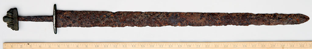

It is always frustrating to find a sword that does not fit into the classification schemes that one knows and this is one of those swords. The fairly heavily encrusted double edged blade does not appear to have a fuller and the encrustation prevents detection of pattern-welding, if it is there.
Overall length is about 32ľ inches and the blade measures 27Ľ inches in length. The pommel and upper guard appear to be a single casting of bronze and the end of the tang is exposed at the tip of the middle lobe. Dot within circle within larger circle 'raindrops' decorate the pommel. The non-matching slender guard appears to be made of silvered bronze.
There does appear to be some genuine age here, so I do not believe this to be a modern fantasy. The theme of lobed pommels started well before the Viking Age and this hilt does not fall into the expected Viking types. The theme of 'raindrops' may be seen in many cultures and times, and one of those is the Migration Period in central Europe which is what I am thinking about the origin of this sword.
Your knowledge and comments are invited.

Hi Lee,
Thanks for sharing this... I have some thoughts on the pommel in particular, and am looking forwards to hearing other members opinions on this item.
If it is genuine, I suspect that this sword is of Baltic origin. This type of bronze-cast lobed pommel has been found in many archaeological finds from the territory of the pagan Curonians in modern Latvia, and in smaller numbers in neighbouring countries. These swords date to between the 11th and early 13th centuries, and may represent a local product of the pagan Baltic tribes derived from the more familiar, earlier Scandinavian styles of lobed pommels. The dot-in-circle motif can be found decorating several other pommels and crossguards.

Mark,
I find your attribution most compelling! Thank you! Though not included with my photos, the aperture for the tang at the top of the pommel is very similar to that in the second photo that you have shown, though perhaps a little bit smaller and this upper hilt does appear to be solid. Also the dominant bulbous central lobe as seen in all of your photos is often associated with an eastern European origin in the Viking Age, so why not in closely following times?
In your last image, the similarity between the sword presented in this thread and #6 was striking (and searching the place name gave me only one hit: original paper Artūrs Tomsons: Ornamentation on the Hilts of Couronian (T1) Swords from the 11th-13th Century).
I have generated a side by side comparison of the pommels, brightening the image so that at least one 'raindrop' is evident on that central lobe as well. The cross guard still remains a mystery as the cross guards shown in the cited paper are more robust and consistent with the upper guards.
Thank you, gentlemen, hopefully more members will also share their observations.

Talking The Internet can be amazing...
So, off I went searching for 'Couronian sword' and I found a picture of this very hilt featured on the Hurstwic site; following that clue and having to rely on Google's cache of an old SFI thread from 2008, there is someone looking for information on this sword. I am assuming that Arthur Thomson from Riga, Latvia is the author of the paper above and he was looking for more information on the sword being considered here. He remarked 'To my mind it seems that it can be of Eastern Baltic origin and can be dated approximately to 11.-12. centuries. I am writing an article about Couronian swords and any info could be useful!'
Further searching yielded another paper from 2012 -
Artūrs Tomsons: Symbolism of medieval swords from the territory of Latvia during the 11th–13th centuries available here!

I agree that the crossguard seems a little out of place, and completely dissimilar to every example of Curonian swords I have seen so far.
Tomsons seems to be the authority on this subject, and has a few other relevant articles, but not in English as far as I know. Vytautas Kazakevicius has also done some work on this, and compiled a list of 64 examples in museums in "On one type of Baltic sword of the Viking period".
