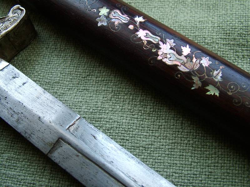

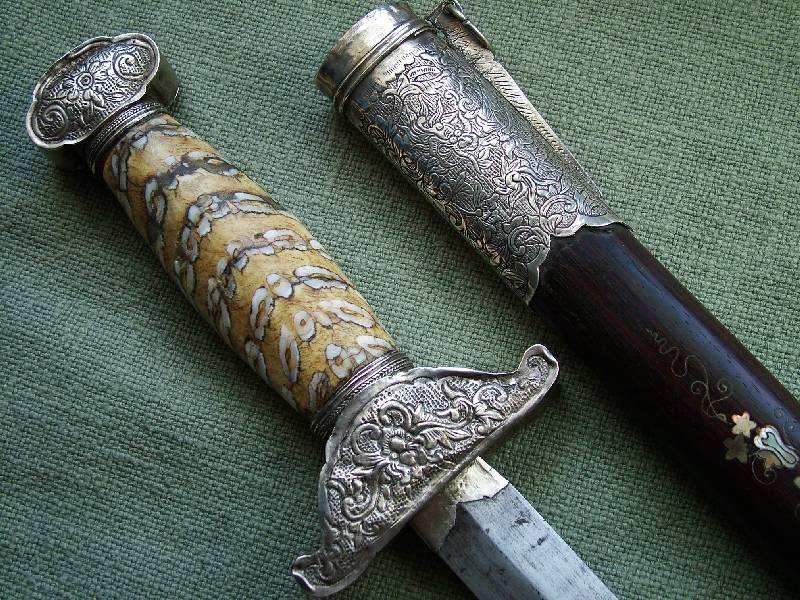

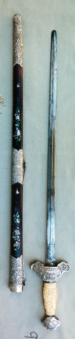

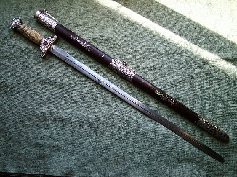

It was in a friend’s collection for some years. I always liked this puppy so recently I made a deal with my friend and I got it. And I want to share the pleasure with you. Also you may know something more (as usual ).
It is Vietnamese / Indochina but not the usual type. These swords are usually with curved blade and hilt with guard. This is straight and vintage.

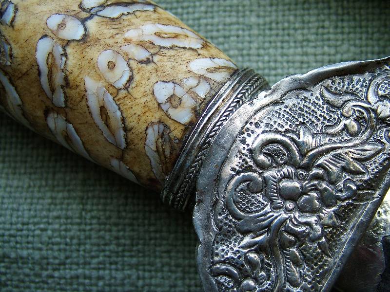

The hilt looks like Chinese in the shape. It is made from one piece of elephant molar tooth (not ivory!) and repousse silver.

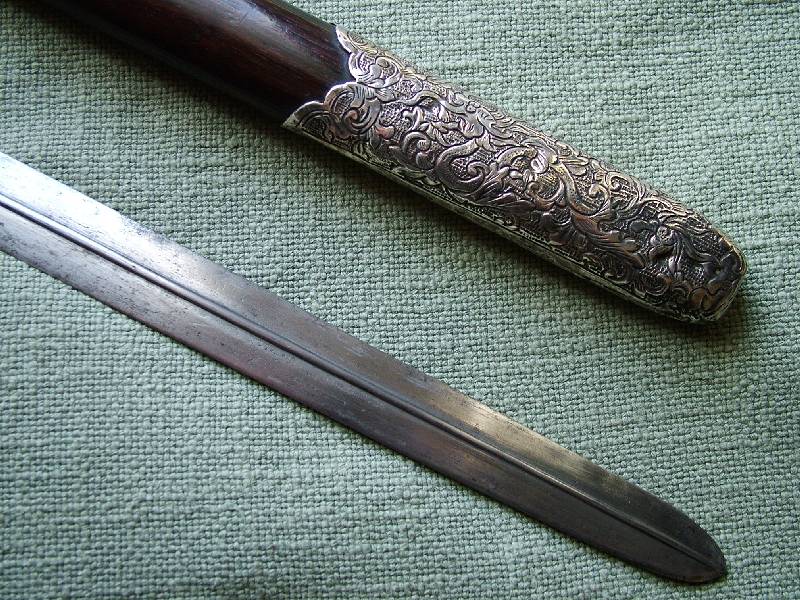

The blade is straight, double edge with central rib and a very long ricasso.

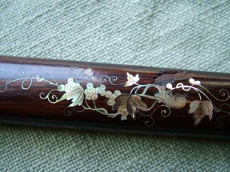

Scabbard is wood with big fittings of repousse silver and inlaid with a fine mosaic of mother pearl pieces with flowers, butterflies etc.
Yannis is offline   Reply With Quote

Yannis:
Gorgeous Vietnamese sword. Clearly modeled after a Chinese jian, but the blade seems more European in style with the ricasso. The central rib is also unusual for a Chinese blade. The finely inlaid decorative work on the scabbard resembles that seen on some of the so-called "parade sabers" from Vietnam in the 19th C. There are pictures of the latter on the Oriental Arms web site.
Just a lovely sword and quite rare. I know that you have just acquired it after pursuing it for some time, but if it should ever need another home ... well, you know, just give me a call ...

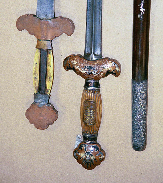

Here are two examples from the Oriental Arms web site of Vietnamese swords that sold some time ago. The top one also has an elephant molar tooth for the handle and has silver mounts similar to your example.

Thank you Nick. I accept anything you say about artistic style but I have a problem with the opinions about the blade. Maybe my English do not help but I cannot see the point. There is NO fuller on this blade. There is a clearly raised rib both sides.
My first thought was of a European small sword but this blade is hand forged. I surely don’t know why is like this and if it is rare.
If it helps, the blade is 680mm long, 29mm wide. Even without the rib it is diamond cross section. The ricasso is 66mm long and the rib is 6mm wide in the start.

Hello Yannis,
Some images might help.
The first is a piece from my collection. It dates from the late 19th to early 20th century. Note the fairly wide double fullers (which is very common for kiem of this period).

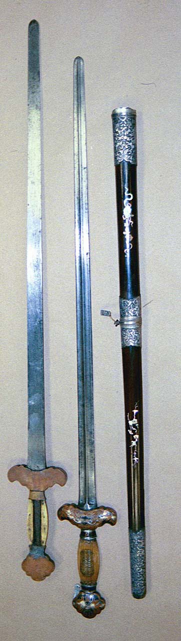

Posts: 54
Now, THESE images are of a double kiem (song kiem) from the Metropolitan Museum of Art (I took the photos myself). Again, double fullers, but they are so pronounced as to almost completely take up the blade. If you look closely at the ricasso of your weapon, you'll see that stock was removed from the ricasso forward, that is, the fullers run completely off the blade.
Ordinarily, I'd say this is a case of perspective, as in, I see two very wide fullers, where you see the median ridge. However, because double fullers are SO prevalent on kiem, I think it's more correct to think of this as very exaggerrated fullering.
Nick Wardigo is offline   Reply With Quote

Posts: 54
photo 2

Nick, thank you for showing these photos. Now I got your point. But because these swords have fullers I cannot imagine fullers in mine. There are not. As I wrote before, it is quite the opposite. A diamond cross section!
Now that I have seen these swords I know that it is a local blade. Look this very long ricasso. But my bladesmith didnt wanted fullers. I dont know why. Maybe it was against his values. It is not wide sword but I think it is strong enough to hit with the edge and survive. And it is spring. A really deadly weapon in the hands of a connoisseur .

What might have happened with Yannis' kiem is that the double fuller evolved to a raised ridge by someone taking the idea a step further. Looking at the photo of the ricasso, I see a basically diamond cross-section blade, meaning that the fullers seem to have run completely off the edge of the blade, leaving the ridge. I don't see any of the concave effect evident on the older blades Nick has posted (not to say it isn't there, but I just don't see it).
The elephant molar makes for a great effect in the grip.
