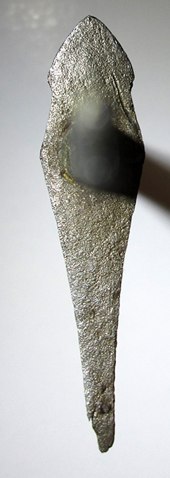

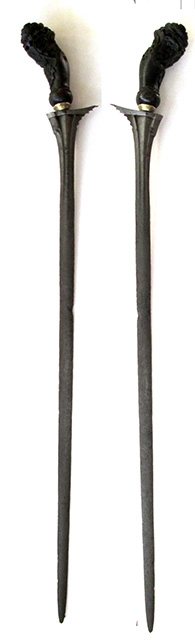

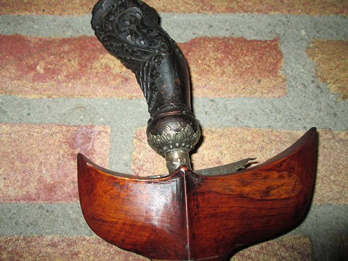

I was lucky to added this keris panjang to my collection

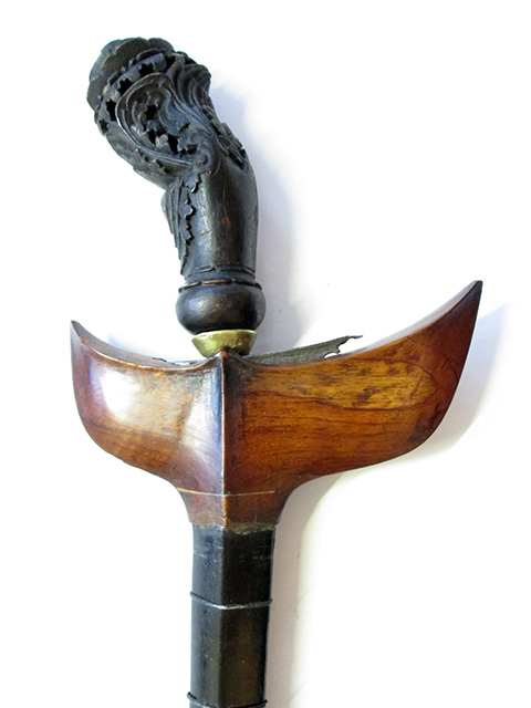

total length of 69cm/27,1” -the blade without pesi 56,5cm/ 22.2”

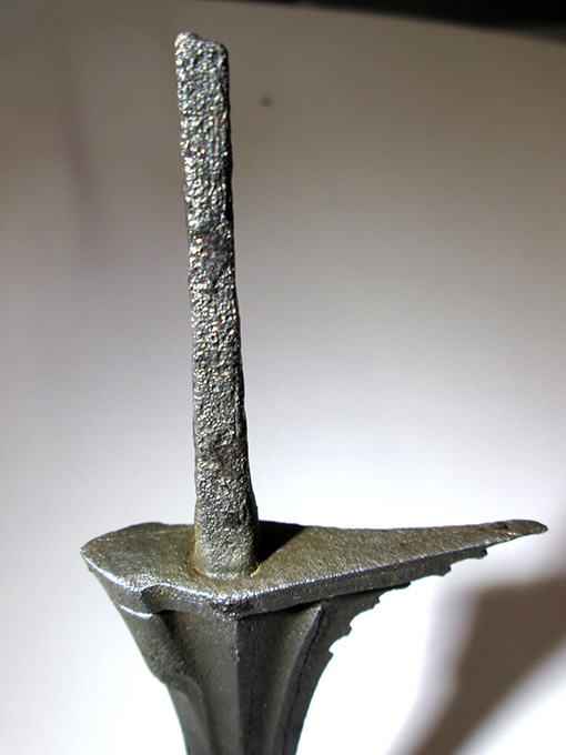

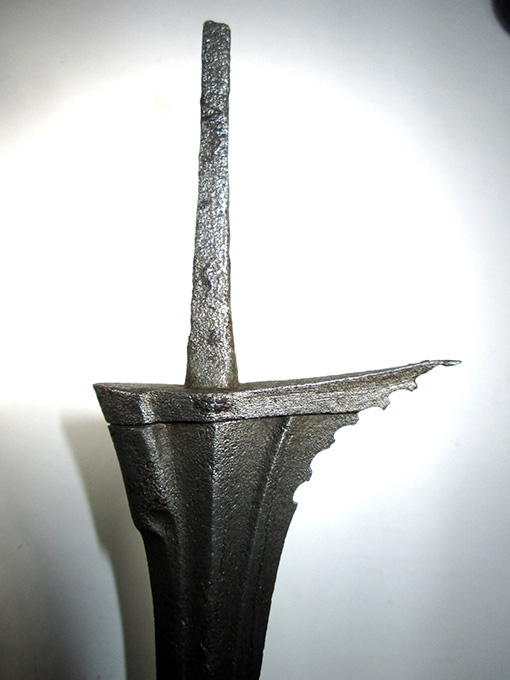

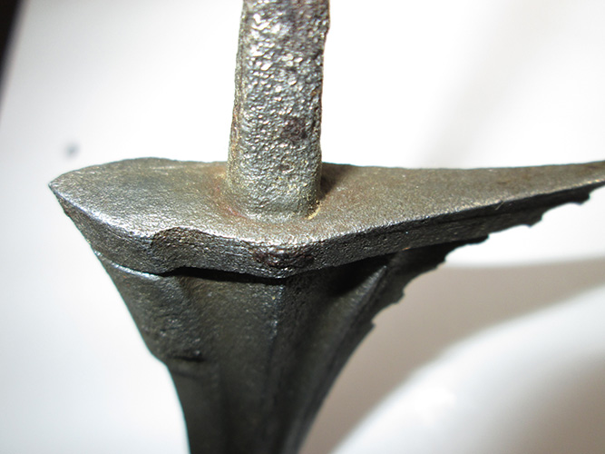

a nice keris was hidden under a lot of rust and dirt, a blade without pamor en with a square pesi I think the middle part of the gandar is made of horn
I will welcome any and allcomments about this keris,

Nice example Sirek.
I'm not surprised to see no pamor as that seems normal for most older examples of these.
The squared off pesi seems pretty unusual though.

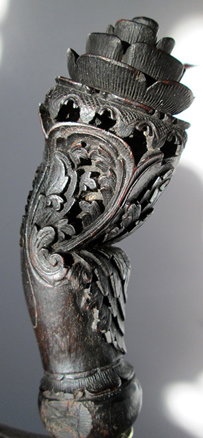

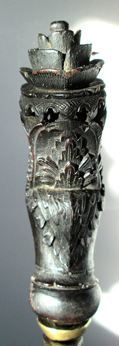

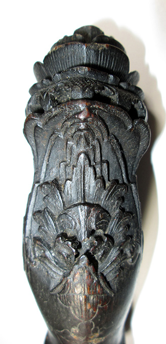

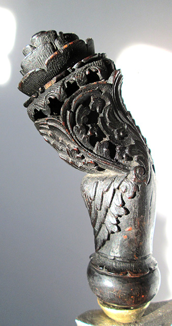

Is the hilt wood or horn?

Nice old kris indeed, congratulations!

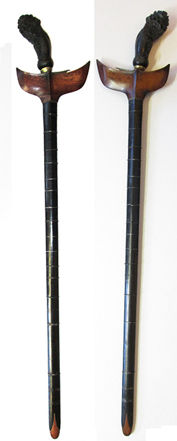

I think that the hilt is made from black horn (see chip at the base). The blade & scabbard may not be originally matching. You could do a bit better on the cleaning process as there is some residual rust.

cleaning is not finished yet, but clean enough to show him in advance
and i also believe that the hilt is made of horn

I am surprised we aren't getting more comments on this squared off pesi. I certainly isn't unheard of, but it is unusual.

Also wondering what folks think of the "mendak" in place. It seems too small to refer to as a pendokok. It seems out of place in this ensemble and if this were mine i would probably seek to replace it with a proper pendokok.
