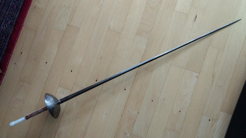

I resently purchased this interesting Cup/Ball hilt Epee togheter with some other swords fromn an old castle estate in nordseeland Denmark.

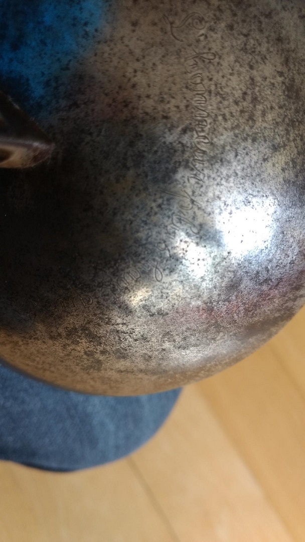

Unfortunly it havent been possebly to find positive ID/dating on the blade and Cup ( the handle is added in lack of the original one an is only to get the feeling of handle) så only blade and Cup are original, onthe Cup is ingraved in french ( i suppose )" Līhonorable plus haut que la vie" Markers mark on the blade just above the cup, looks like a cresent moon, beside the cartuche with a star or crown with R,B or P ? , on the blad other side is inscription i cannot read, hope the weapon of arms on the blade give a clue - i will apriciate any clue and help!
Best regards Kjeld.

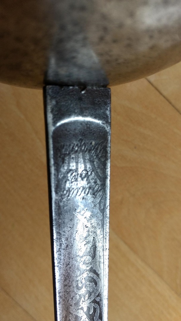

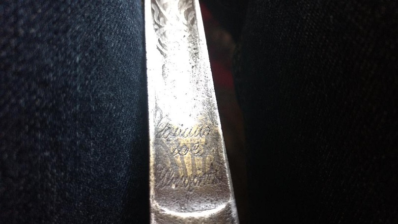

If I am right this is not a rapier but a florett and the script at the inside of the blade is "Manufre de Klingenthal" what stands for the French Manufacture d'armes de Klingenthal/Alsace.

More exactly an Epee.
Most likely late 19th century.

Could this be a "épée de combat" Duel veapon?, wich put the script on the Cup/ball in understanderable context, "honour outweight life" (freely translateed fromn the french script) and if so, what dating are we talking about? best rgards - Kjeld

Ok A florette it is then, could it be a" épée de combat " Duel veapon?, makes the script on the Ball/Cup in right contekst ( honour before life )

Florets are not for combat but for (school) fencing.

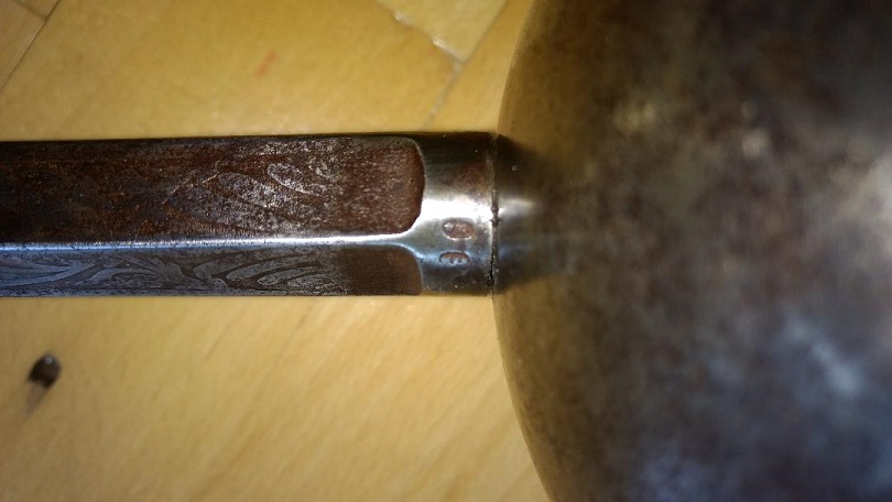

The very small oval mark with an "S" under a star directly under the hilt could perhaps be the mark of Francois Antoine Schütz. He has been controler of blades since 1853 in the armsfactory of Châtellerault. May be he was controler at Klingenthal in the years before too.
The second possibility is that the blade has been made by the armsfactory of Châtellerault and afterwards was sold to Klingenthal, where it got the signature of Klingenthal.

Not really for duel, but for sports and training.

It certainly has the form of a sport epee, possibly early 20th century, except for the sharp point! So perhaps it was intended for the duel, not to the death but to first blood. Sport epees at this time had a short triple point tip, just enough to catch in the clothing. Nowadays they have a flat spring-loaded tip and are all electronic.

Yes, the original FLEURET had a protected point called "La mouche".
