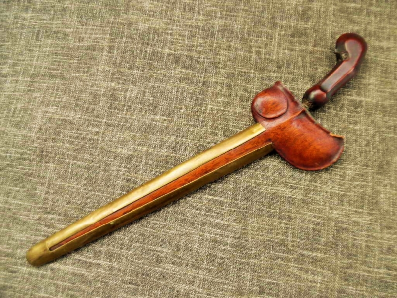

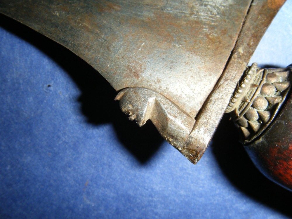

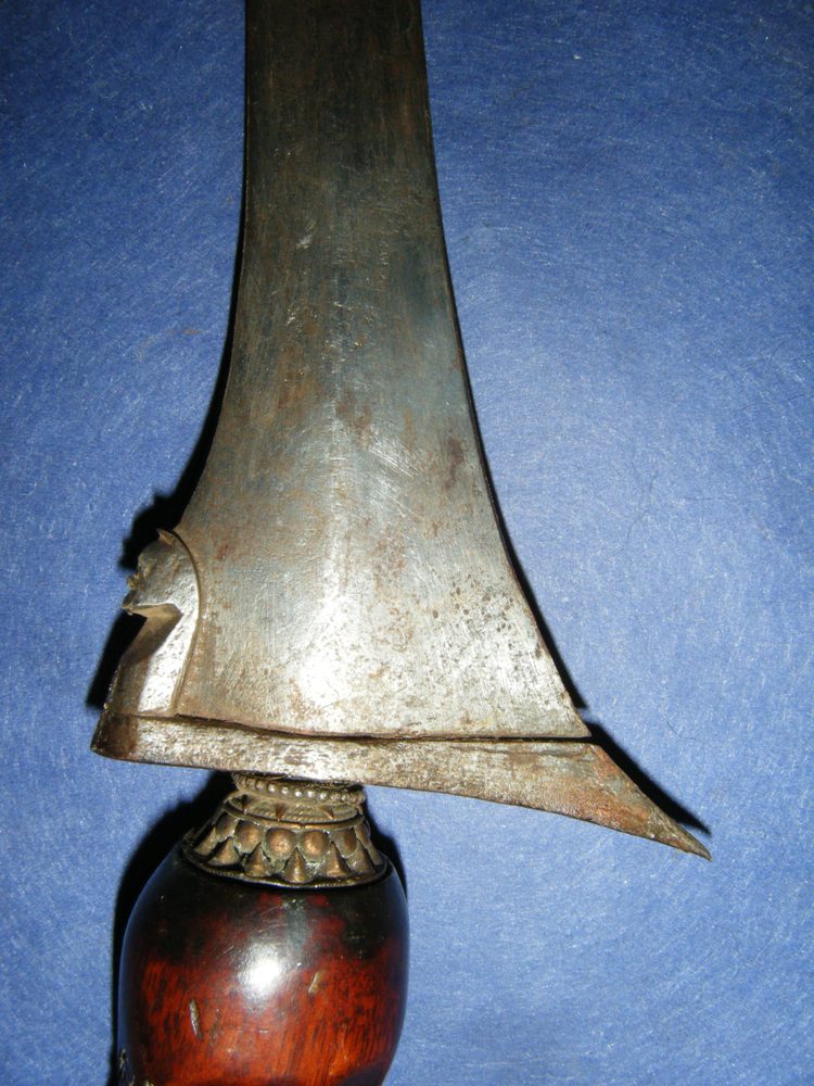

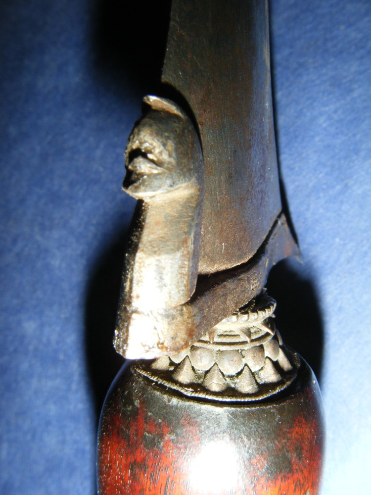

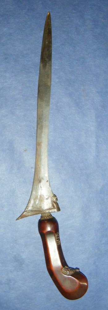

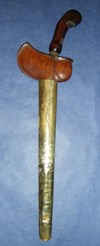

Just have received this unusual keris puthut, I never have seen before such a scabbard, my best guess would be that it is from East-Java or from the North coast, I am unsure about the blade since one of the previous owners seems to have cleaned the blade but it look like it was made this way originally. All comments are very welcome!
480 mm long in the scabbard, 390 mm without, blade without pesi 280 mm.

For me it's possibly East Java, but I'm not sure because I've never seen this form of sheath and blade.
This keris is very original, I love it!

The wrongko looks unusual to me as well, though i see why you suggest a possible East Jawa origin.
Unusual blade as well. I would not argue against it being puthut, but i wonder if that is its true intent.
While this seems to be a nicely formed Surakarta hilt it looks wrong with the rest of this ensemble, even when just looking at the blade without the sheath. Are you considering swapping it out?

It was once a worthy wrongko, iras carved, sadly it's broken but hidden from the pendhok. I think that the North coast could be the origin as well.
You are correct David but I want to show the keris like received. But it would be great to know from where the scabbard coming to change the hilt to a better fitting one.

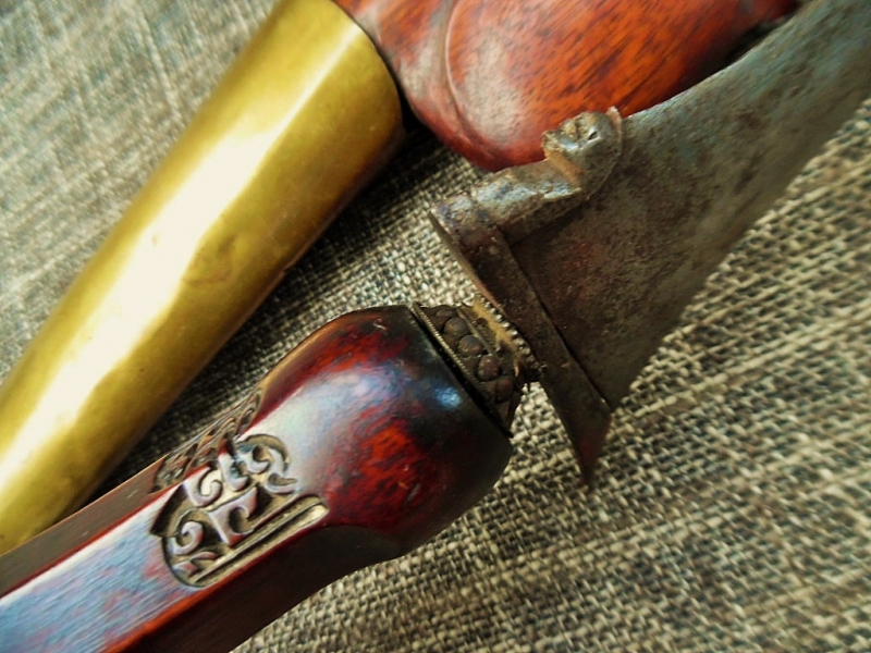

There are several things that disturb me with this keris:-
1) the mendak is old, it looks as if it has been in place for a long time, but it is incomplete, I believe that when the hilt is removed the mendak will be found to be damaged
2) the wrongko is one-of-a kind, it reminds me a little bit of a style that is usually attributed to Banyumas, but it is not exactly the same as that style, just tending towards it. I do not know how many keris I have seen and handled, but it is certainly into the five figure level. I have never seen this exact style previously. Why?
3) the pendok is an old fitting to this wrongko, but it had been used on a different wrongko before it was fitted to this one.
4) I have real problems with the blade, the thing that immediately strikes my eye is that the tail of the gonjo declines to the blade, this characteristic is associated with a North Coast classification, however, there is an odo-odo, and that should not be present with a gonjo of this style.
Then there is the mating of the gonjo to the wilah, it is very imprecise, except where the puthut meets the gonjo, and the puthut itself has much cleaner and sharper edges than the edges of the gonjo. Why?
The surface of the wilah and the surface of the gonjo do not have a similar degree of polish. Why?
This ensemble raises far too many questions for me. I look at it, and I immediately remember the very large old Tuban blades that were re-manufactured into more desirable forms in the late colonial period. I am not saying that this blade is one of these re-manufactures, but I am saying that it displays too many inconsistencies and raises too many questions. One thing that is rather amusing is that these large old Tuban blades that nobody wanted in the past are now extremely desirable and quite expensive collector's items, for the simple reason that not many of them survived the re-manufacture process.

The wrongko is definitively old/antique and very well used over a long time while I agree that the pendok is fitted later to it but this with some understanding and I agree again that it was some time with this wrongko.

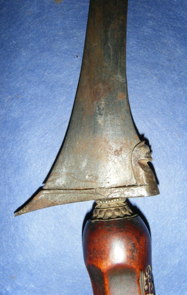

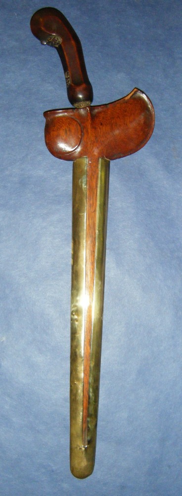

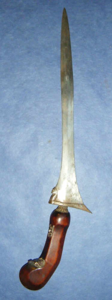

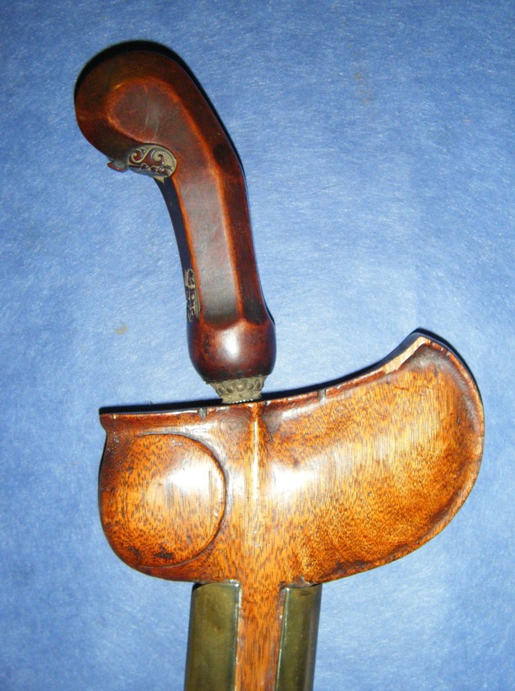

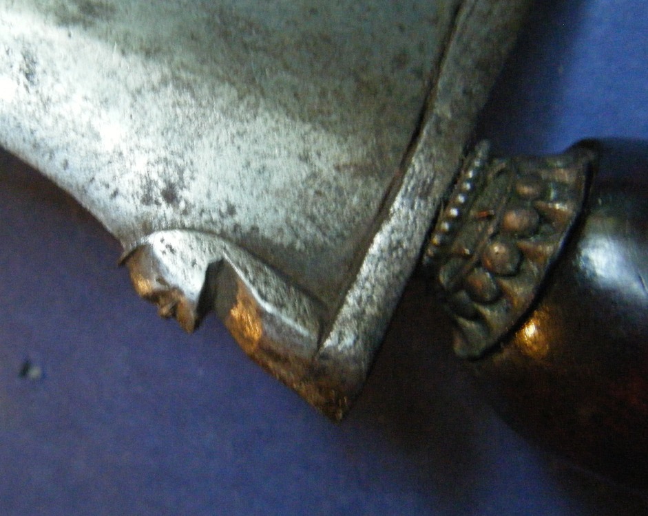

Here two pictures from the auction.
Old 30th September 2018, 11:45 PM   #8
Posts: 7,263
Yes Detlef, everything has a value, so it doesn't matter what something is, if you can buy below perceived value, you have a bargain.
Incidentally, I did not mention this previously, but the auction pics drive it home:- the hilt is incorrect, certainly in respect of proportion, possibly in respect of style.
