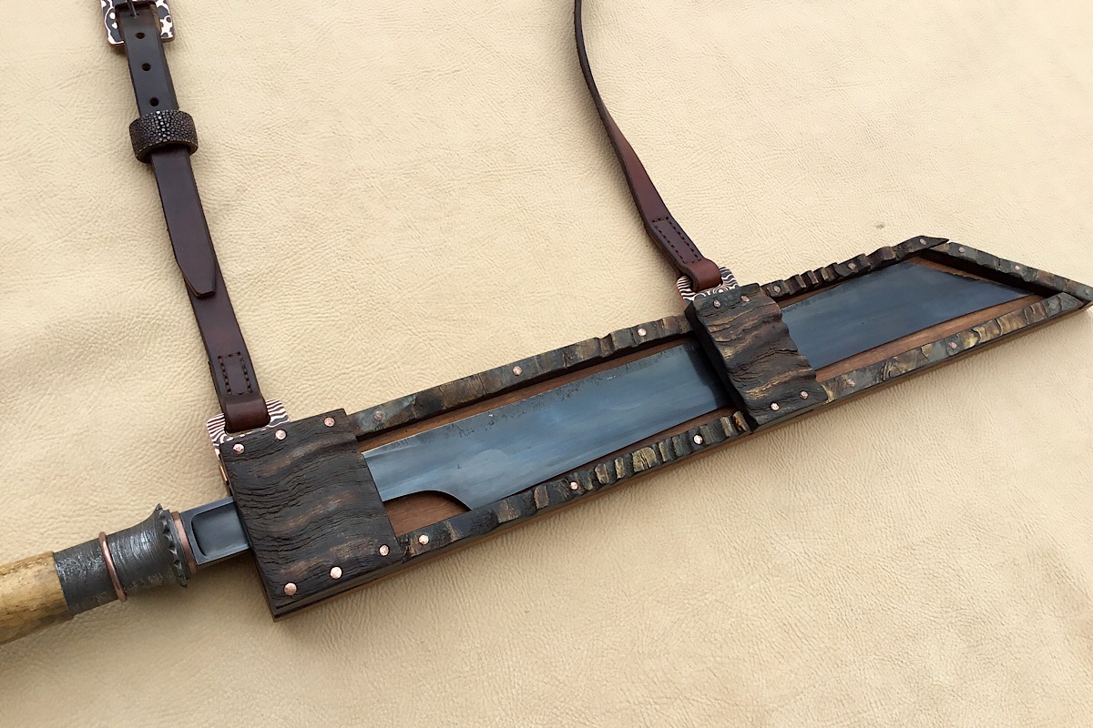

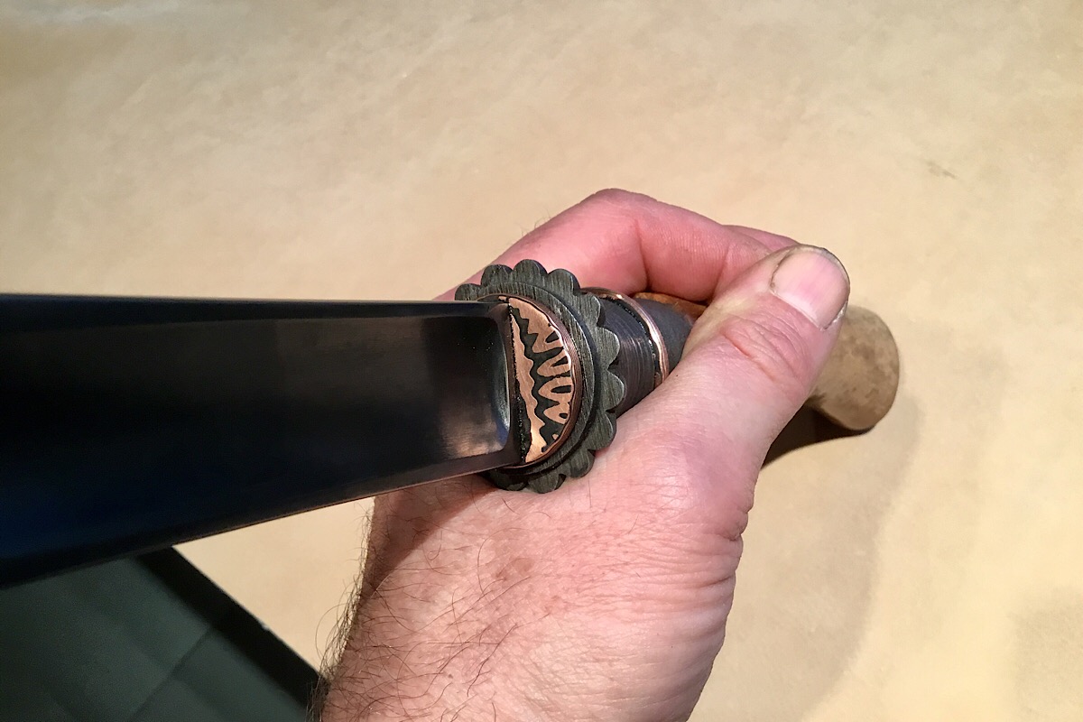

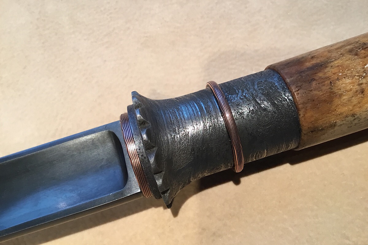

Hello
Admin feel free to delete if this will be an unwanted thread.

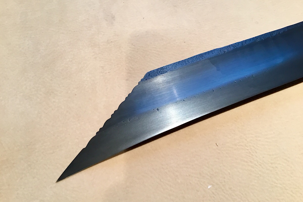

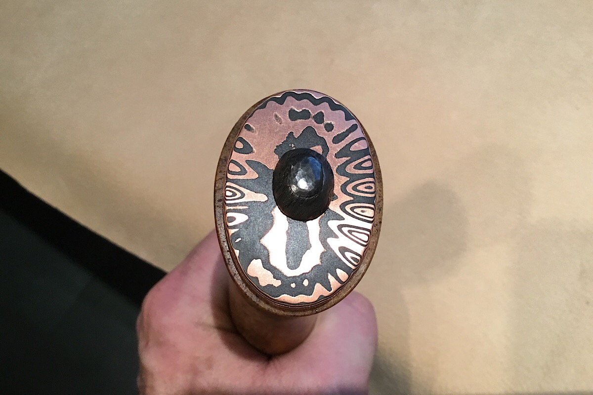

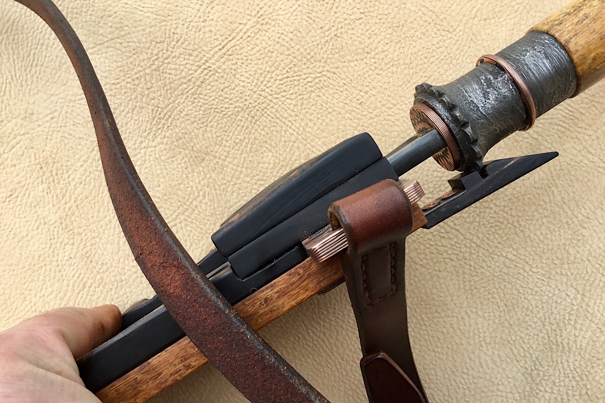

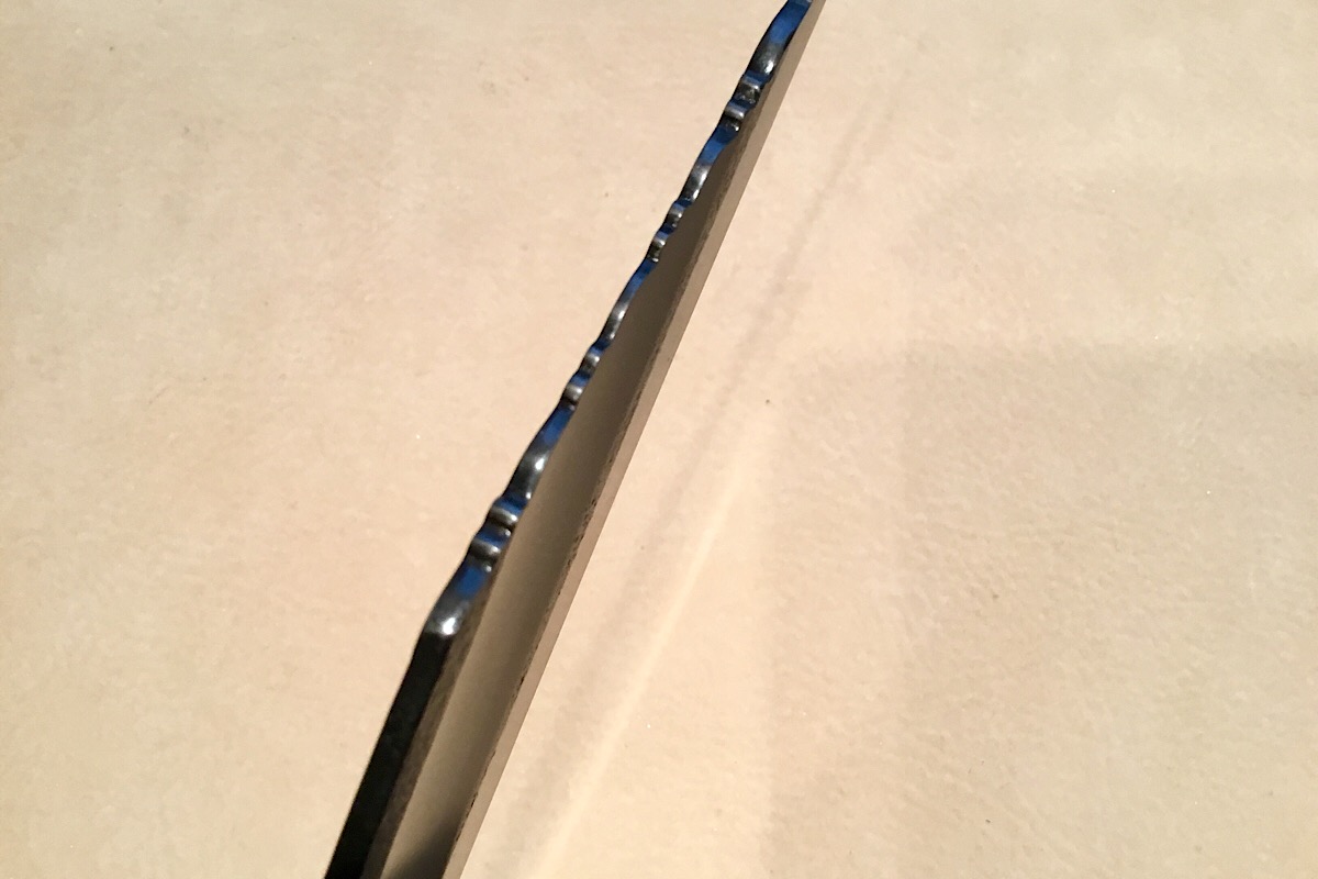

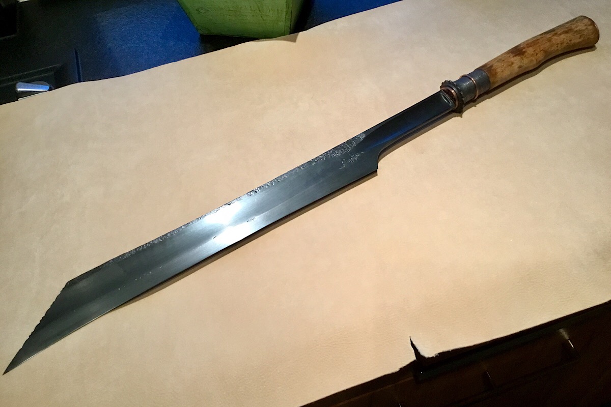

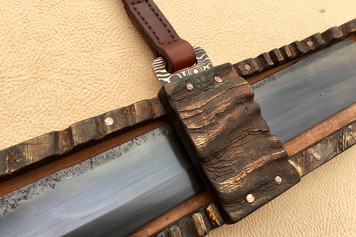

In my first thread I told you, that I‘m also a knifemaker and I wanted to be inspired by antique pieces for my own work. So I like to show you a piece made this year in spring. It is not a typical style , but there are some design elements that I wanted to use. The blade is a little bit inspired by mandau with filework and fullers from a cojang. You can grip it in front of the guard for smaller cutting operations. The guard is inspired by sikkin pieces. The long grip for two hands by kachin-dao. The own made mokume-gane by japanese usages, the open scabbard again by kachin dao. All from pieces in my collection. People who knows me as a knifemaker will find some typical own elements too.
80 cm in total. Din 1.2604 swordsteel, grip from extinct stellers seacow bone, guard from copper/iron mokume and antique wrought iron(by the way, I have some hundreds kilo of iron from 1600 to 1850. if anybody will need a piece for replacements, feel free to contact me ). Scabbard modern bamboo wood and water buffalo-horn with mokume and copper pins ( all pinned without a drop of glue )
Well this was a lot of more than standard work for me. I would like to say, that with every hour, my respect for the master bladesmith of the past has grown higher and higher. Remembering just the work of forging the fullers and grinding them........incredible work that the masters has done in the past. Maximum respect.
Best regards Thomas

Nice work, like the bolster/pommel & blade, kind of an eastern langeseax. I think I'd have squared off the end of the scabbard and left it open, and would carry the blade spine down, like a seax, to keep the edge from rubbing, sidewalls should just be tall enough to let you insert the blade w/o it flopping side to side between the bridges and the scabbard back perpendicular to the blade flat. Taiwan swords use an open scabbard with wire staples and/or zigzags across the open flat, which is also a cool way and could be used in addition to the bridges.

I love this!
I love your use of mokume copper as well and the way you etched it to give that worn feel on the scabbard. Also I like the scalloping of the end of the blade. The hammered and patina'd copper nails/rivets are a nice touch.

Thank you very much.
At the end there is not a nail. Its the tang going thru the grip full lenght. The tang is not hardened at the end to rivet it with a ball-hammer the old way.
Thank you all
Best Thomas
