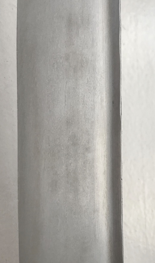

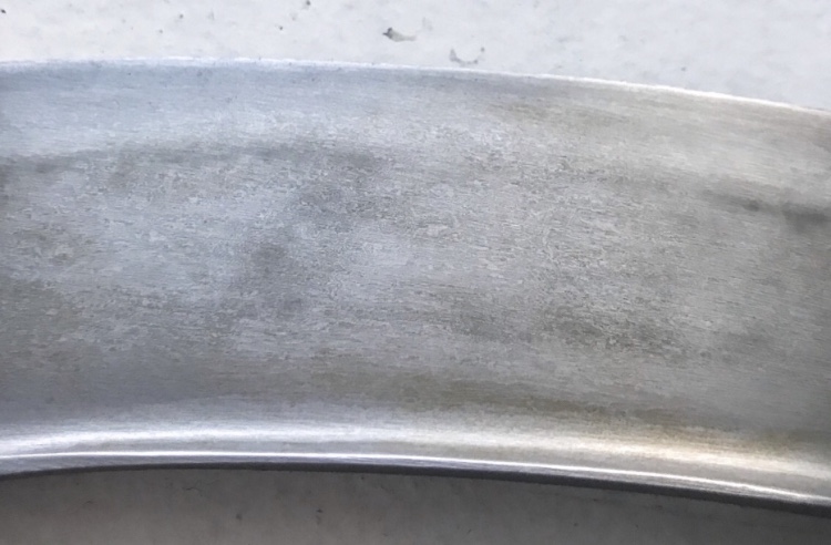

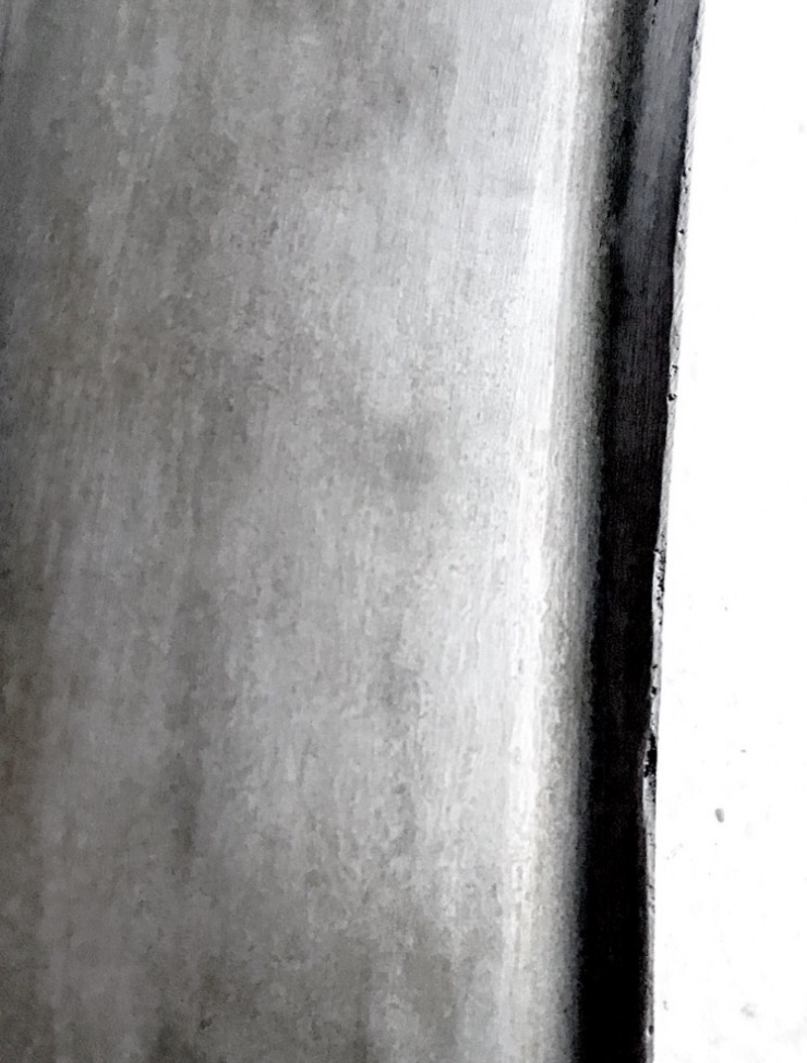

i was hoping this tulwar I have was wootz, so i cleaned the blade a little bit and the pattern slightly matches my other wootz tulwars but also matches other Skela, or Watered steel, tulwars I have. Here are a few patterns on the blade but let me know what you guys think. What could the blade be?

I honestly cannot see any kind of pattern. Try polishing the blade, then etch it and if it is wootz the pattern will be clearly visible.

I can see the pattern in your original pictures but they are not clear enough to determine if wootz or pattern weld. India. Crystalline Damascus can have a very tight grain structure and not jump out at you. Additional etching is not going to improve the grain. Your best bet is to take the pictures in good sunlight and angle the blade to try and capture the pattern. From what I can see it looks like Indian crystalline wootz steel.
