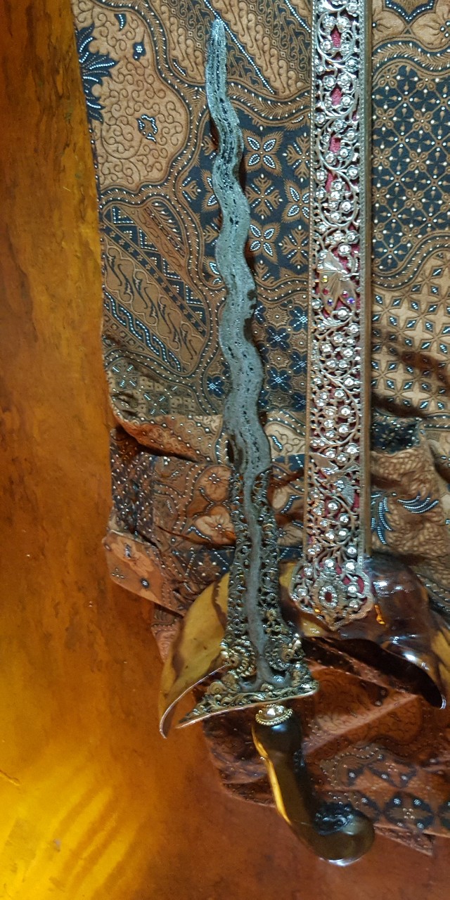

Dear Forum

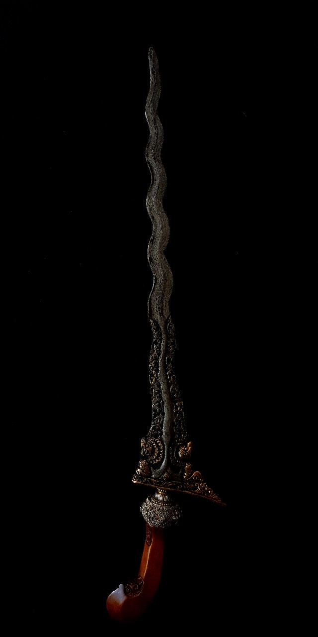

I have this Keris but i dont know the dhapur, the blade look like Singo Kilin,but this keris have two Singo Kilin.
Please give your opinion cause i cant find another picture in the internet similar with this keris.
Thanks.

Hello Ridho,
Looks like a double Naga to me (gandhik naga penganten).
I don't think any dhapur can be assigned to this keris: IMHO it does seem to be a Karmadikan blade that doesn't follow any traditional pakem AFAIK.
I hope some of our forumites will contribute similar examples for comparison. I've seen a few (apparently of lesser quality than yours) - can't post any currently for sale though.

Yes Kai, Kemardikan, no legitimate Surakarta dhapur.
I specify "Surakarta", because that is the only documented one that we have.

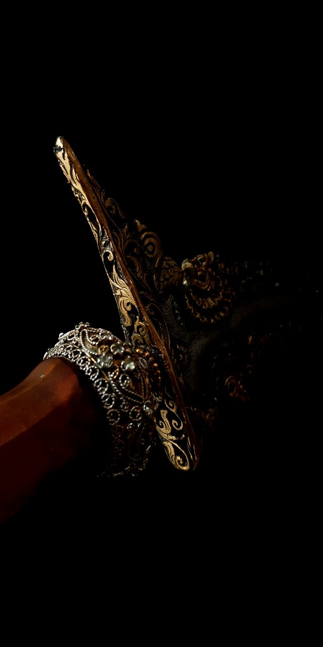

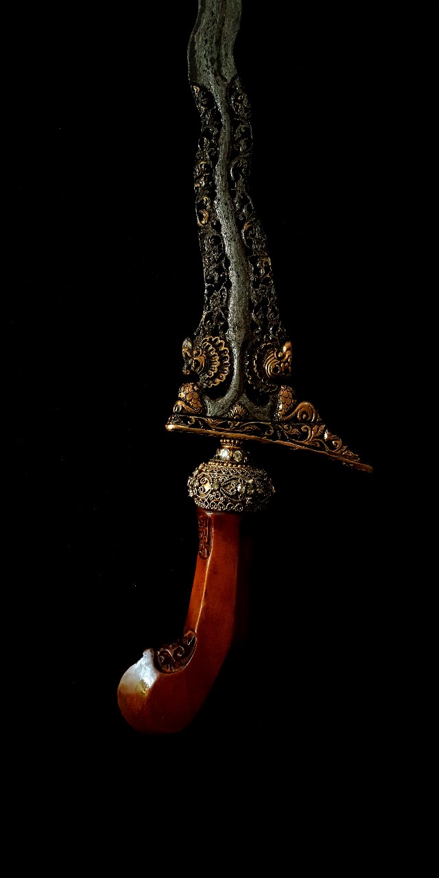

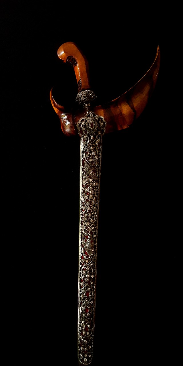

Hi guys..
Hope this picture can make you more clear about this keris.
Regards.
Ridho Pulungan

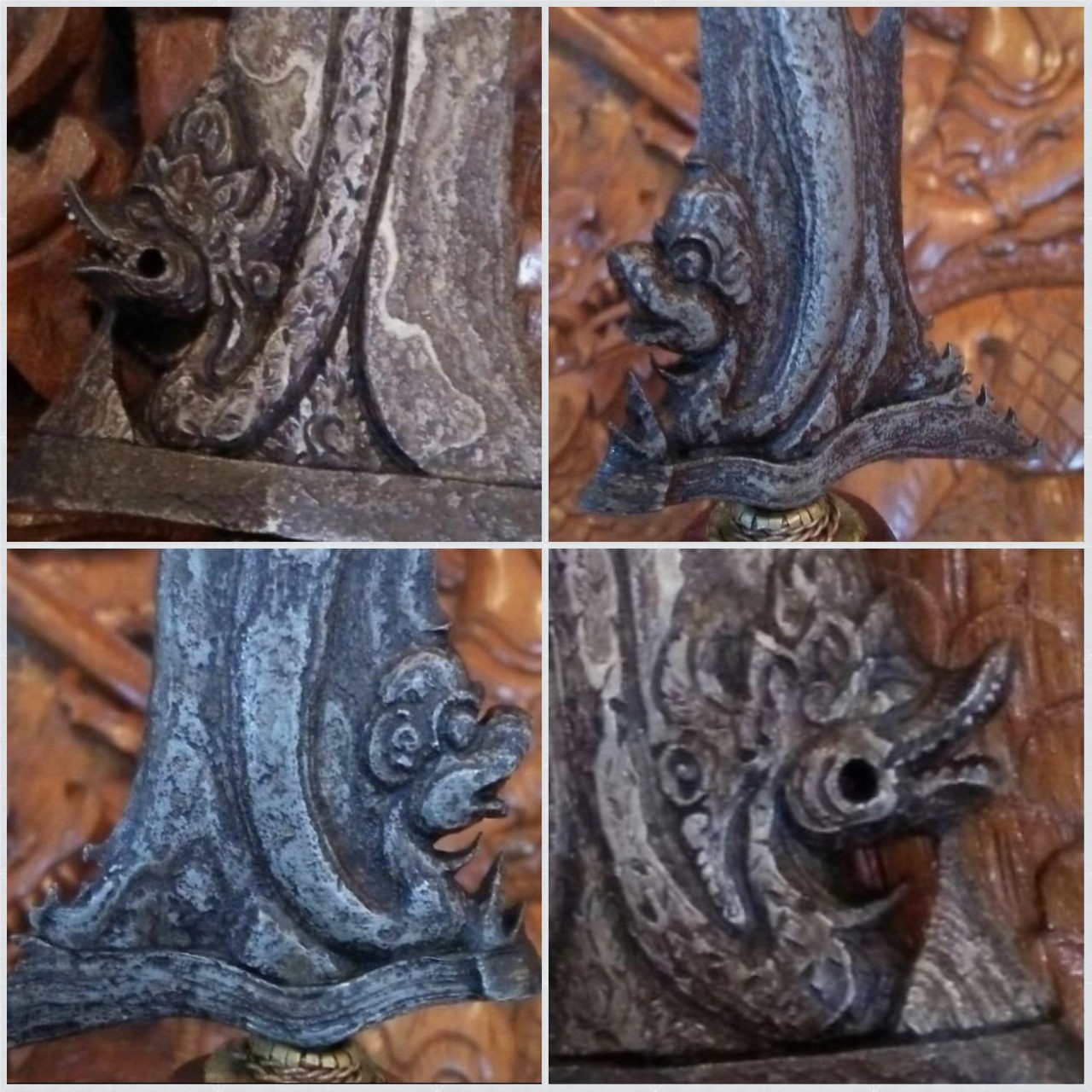

Thank you so much for the link thread Kai. I'll soon post a new picture of this keris.
But Kai,according to what i know (this maybe wrong because my lack of my knowledge) this keris isn't dhapur Naga,because ,the Naga dhapur always crowned by a different crown depend on the naga.
This is several of keris with dhapur Naga from my own collections. Please correct me if i was wrong. I'm just a learner. Be patient with me ok Kai, and Alan..you're my idol. Seriously!

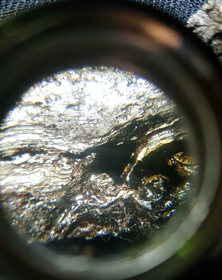

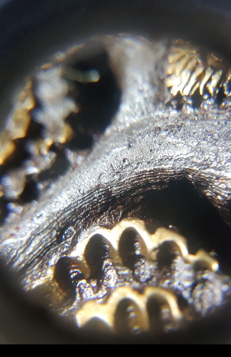

Default For my Guru Alan..

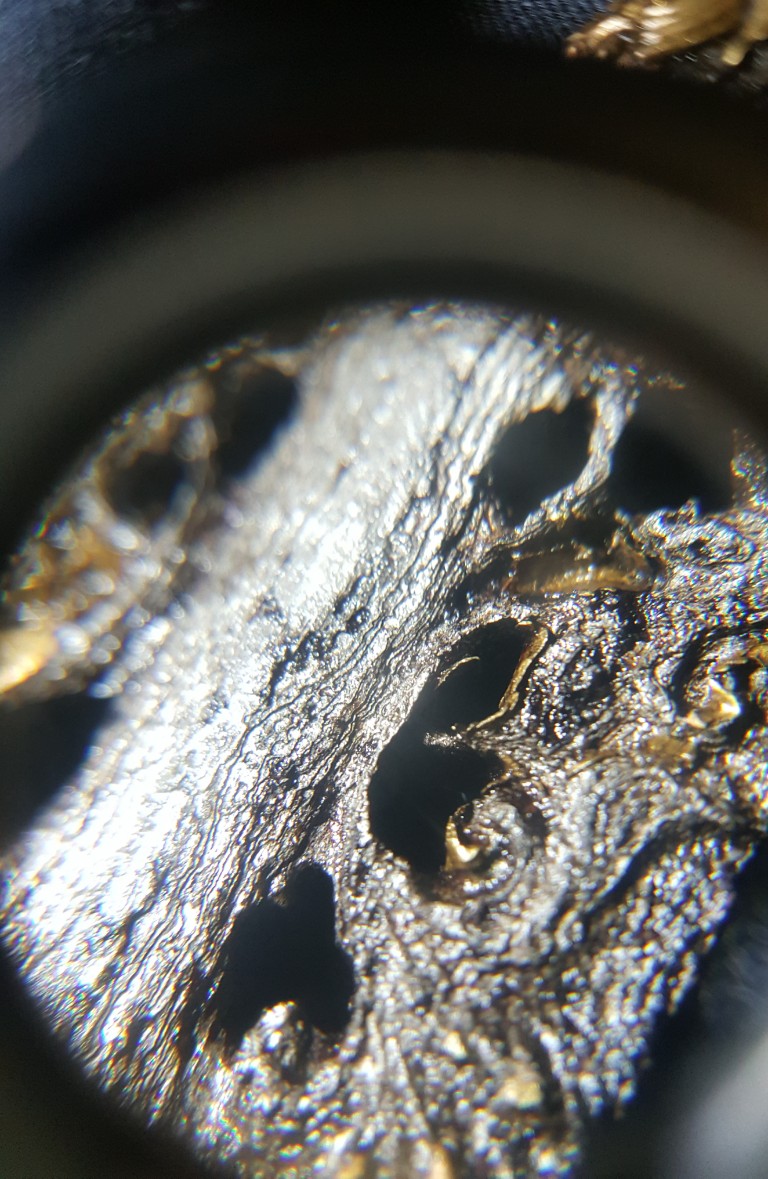

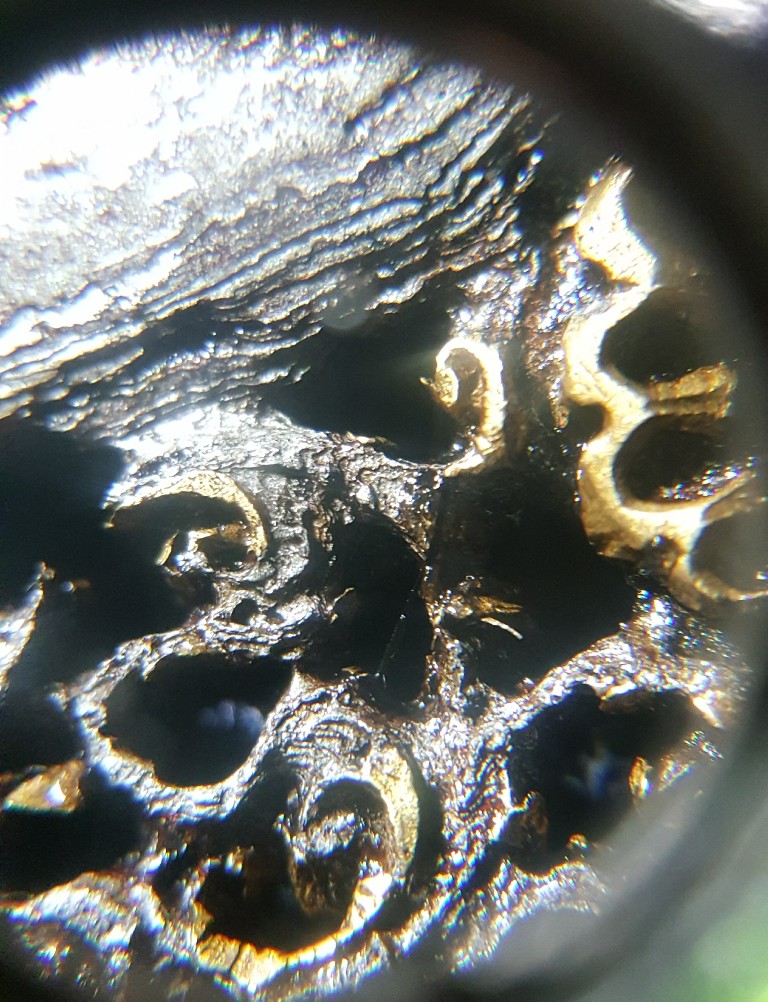

Please find the picture below Alan. That the layer of the keris under the magnificiant lens that might be interesting.
Best regards.
