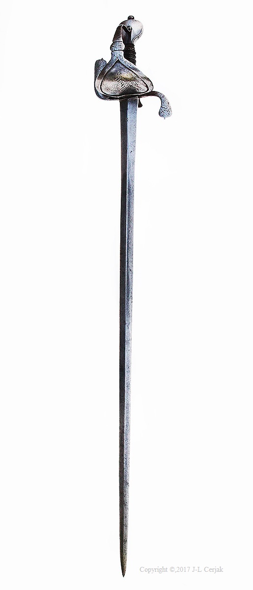

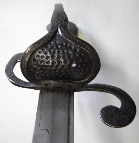

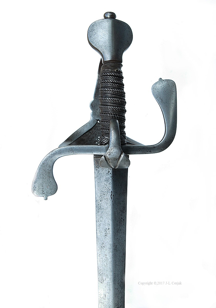

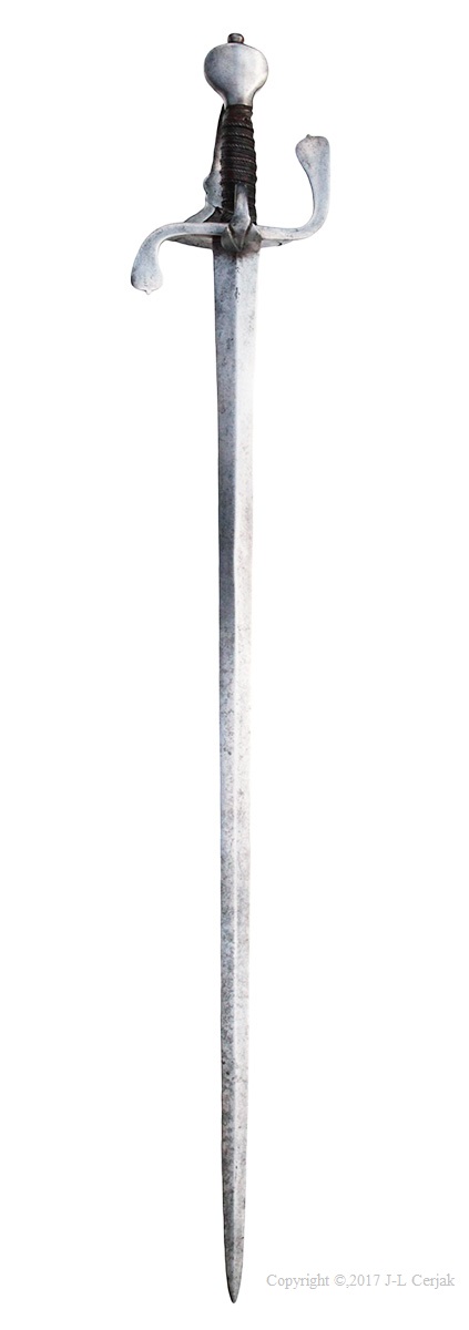

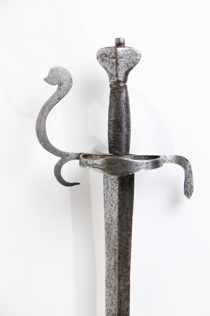

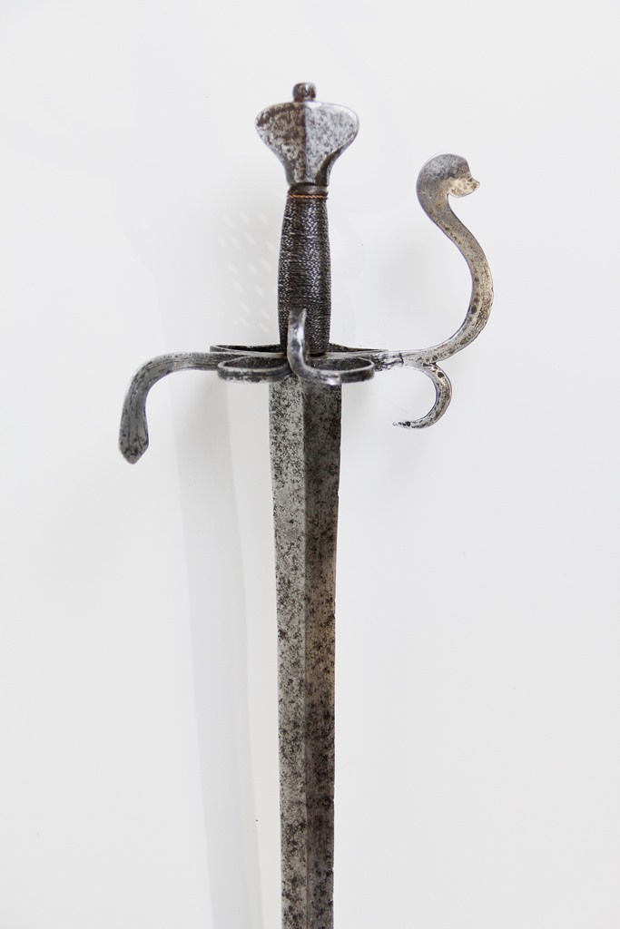

Default North European military sword C.1610-1650

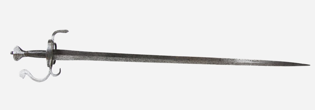

O.L. 104 cm ; blade L. 90 cm; blade width at hilt 3.5 cm
Blade of thick diamond section, tapering uniformly through its length
Pommel :Flat heart-shaped with strong button of type 43
Origin : used by troops from Sweden and the Netherlands very popular during the 30 Years War (1613-48)
Any comment on it would be welcome.
Best
Cerjak

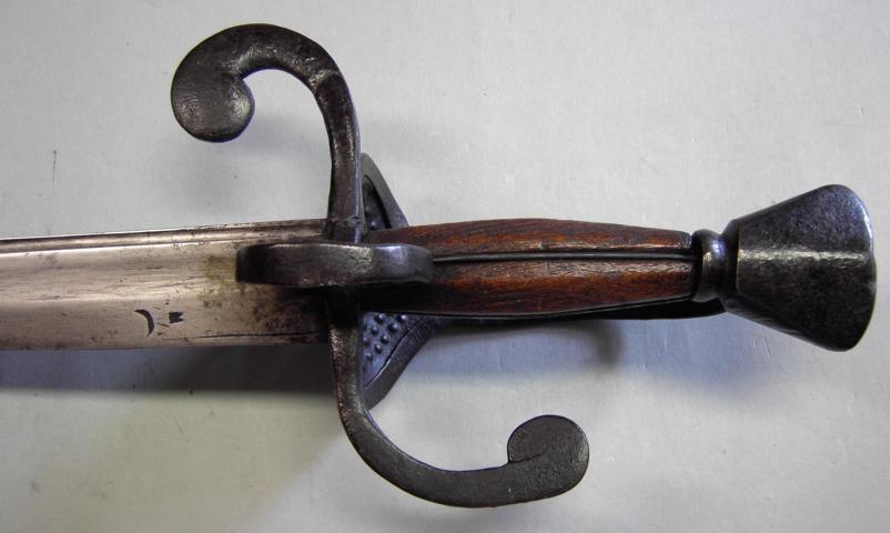

Hello Cerjak,
I would say this is a beautiful so called "Felddegen" (Field Epee) for military usage. The period you mentioned is ok but I would add Germany to the list of possible countries of origin.
Roland

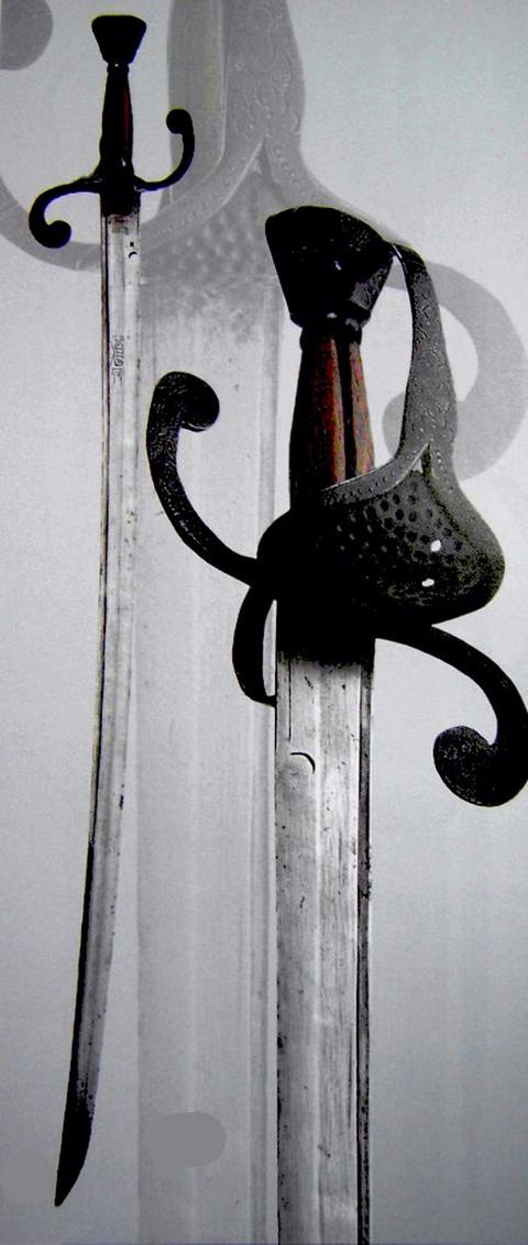

I had posted it earlier: My "Feldsäbel" is a very similar example to yours
corrado26

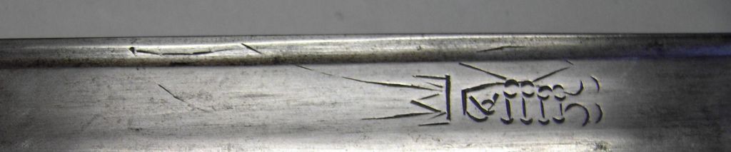

this is the sabremark of Christoph I. Staendler, Munich
best,
jasper
best,
jasper
Jasper, thank you for noting that. While many of us may know this maker and his marks, it is great to have this noted for the volume of readers who will be viewing this thread. No matter how redundant or elementary a key reference might seem, it is incumbent on those writing to include these notes as these threads become archived references.
yes Jim you're absolutely right.
some variations of the mark from;
Inventar der waffensammlung des Bernischen historischen Museum in Bern-
Wegeli. 1929
best,
Jasper

Thank you very much Jasper, and for citing the reference source as you always do. Quite honestly these old eyes could barely discern the image on that blade was actually a falchion
corrado26

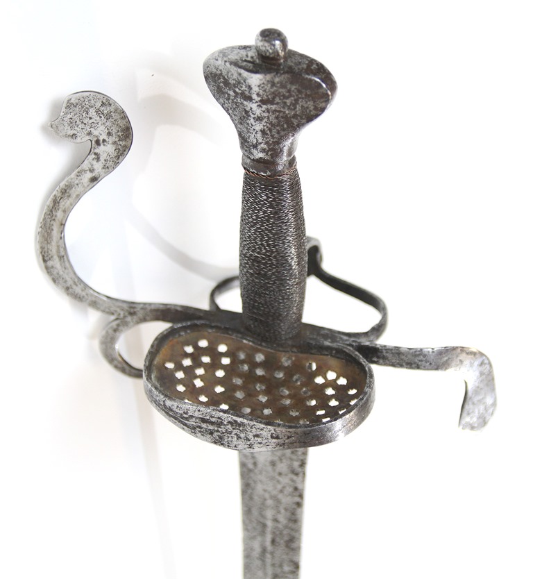

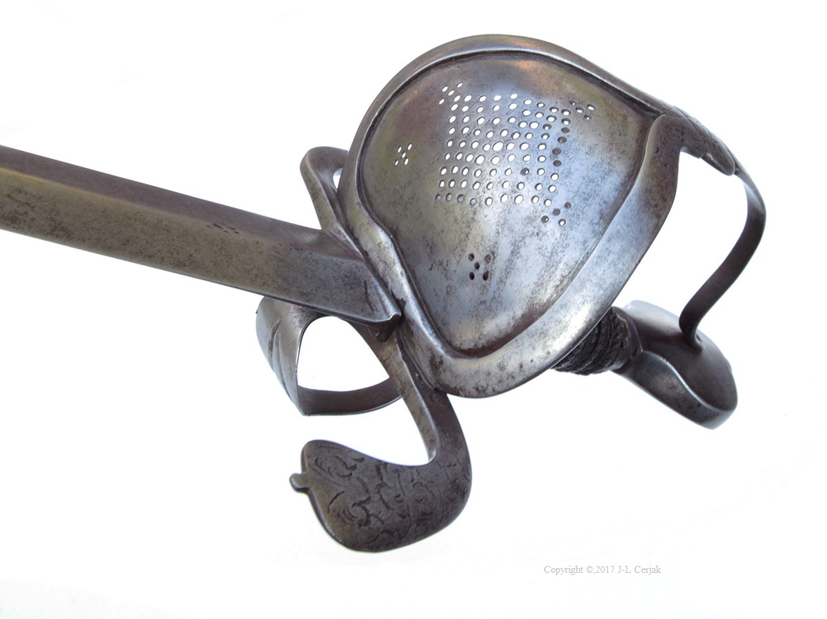

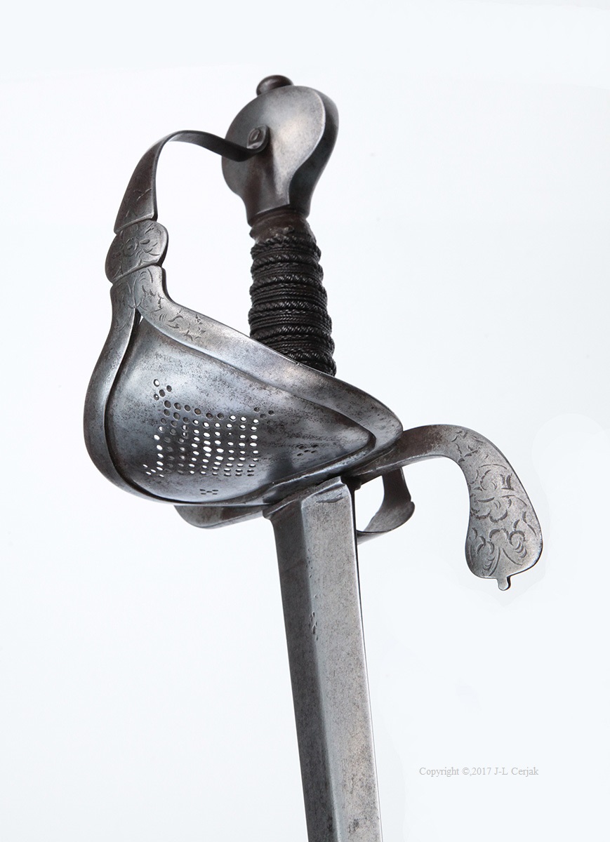

Dear corrado,
Thank you for your post
It is a very nice sword from the same family but quite different ,it’s a sabre and you have a knuckle guard and also the quillions in my case are in the shape of a monster and it was one of the reason why I have bought this sword.
Best
Cerjak

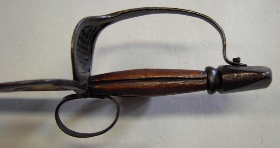

Old 8th May 2017, 03:59 PM   #10
Cerjak
Cerjak's Avatar
Join Date: Jan 2012
Location: FRANCE
Posts: 1,065
corrado26

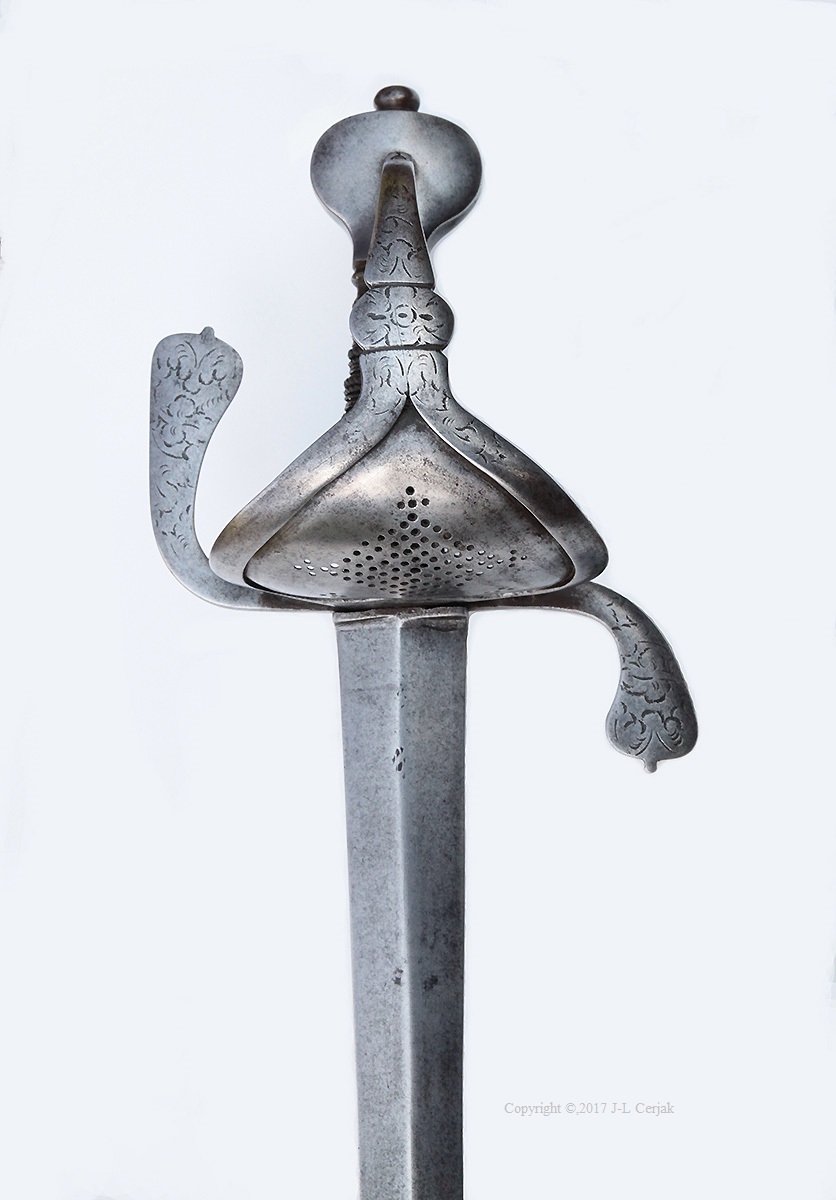

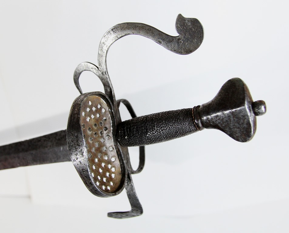

Corrado
This sword's hilt is more similar to yours
Best
Cerjak
Best
Cerjak

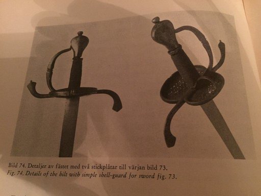

Nice sword Cerjak! The typically simple Dutch-Swedish type swords (S-shaped quillon and heart shaped pommel) don't have knuckle guards, but later during the 1640s some did although they tend to be attached to the pommel. Gustavus Adolphus had to import large quantities of these Dutch swords which were used from around 1620 and throughout the 30 year war. Many of the imported swords were fitted with Solingen blades. Expert Walloon sword smiths were also imported to Sweden, and domestic production began there led by the enterprising Louis De Geer. These type of swords were also produced in Germany and Switzerland. There are some of these swords in Edged Weapons in Sweden (2014) by Staffan Kinman, and Svärdet och Värjan som Armevapen (1955) by Heribert Seitz from which the pictures were taken.

My pleasure, Cerjak. Sorry I can't be more specific about your sword (the first one). In my eyes the knuckle guard design looks too elegant to be Swedish. Swedish weapons have an emphasis on functionality which gives them a particular charm of their own. There were also many Germans serving in Gustavus Adolphus army during the 30 Year War. I attach another photo from Seitz's book, this time of a sword more similar to your second one.

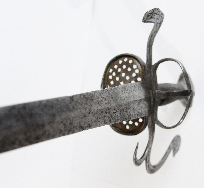

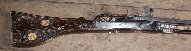

it can be a Dutch sword as well, the end of the knuckle guard has the same shape of an animal head as seen on matchlock muskets (fuse holder) from around the first half of the 17th century.
fe see http://www.vikingsword.com/vb/showthread.php?t=18207

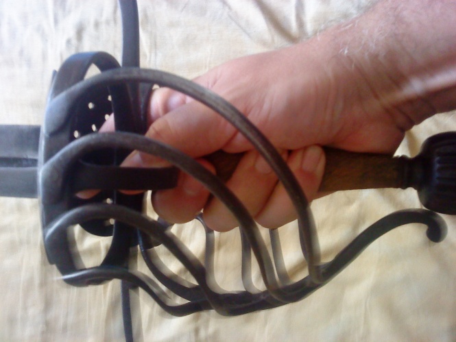

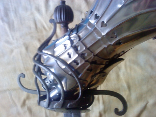

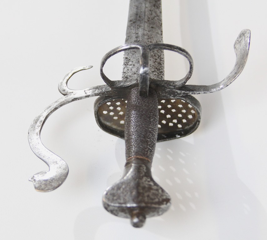

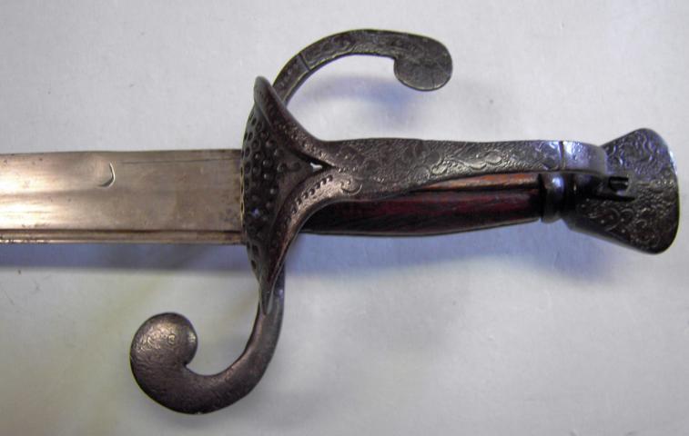

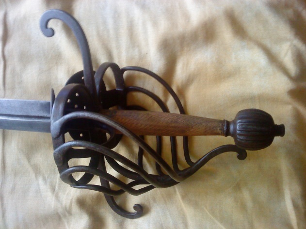

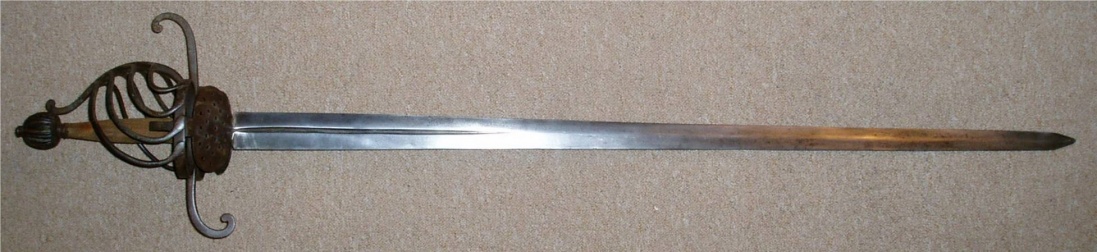

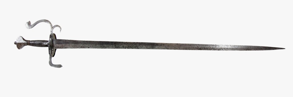

Hi,
in 2005 I bought this sword and since then I have not seen anything like it. Maybe it is a Victorian mongrel. If I remove the branched guard and the ricasso perforated plates, I can imagine I will finish with something similar to the Dutch-Swedish felddegen... but still the pommel will be atypical.
What do you make out of it?
Measurements are something like 117cm total length, 93cm blade and 1495gr total weight. There is a thumb ring. The handle shows wire marks. The front edge seems to have been sharpened more often than the back.
As you can see from the pictures, the hilt is huge and the thing seems to have been constructed to be used with gauntles. It handles nicely with them on.
