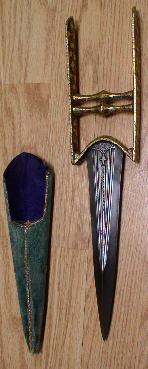

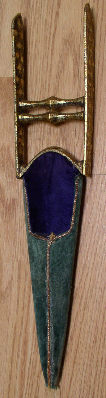

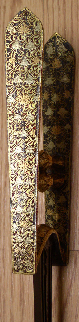

Here's a kattar (Katar? khattar? I've seen several spellings) That I picked up three years ago. The koftgari is excellent, and the blade is very fine wootz, with a massive armor-piercing point. I believe that the koftgari on the side shows the imperial family's parasol. The detail is done in several colors of gold, and the small inscription in Devanagari script was translated for me as "Ram protect me".
I have a couple of questions. Would it be feasible to etch the blade to bring out the wootz pattern better? should it even be done?
I welcome all comments!

Lovely Katar. In regards to the wootz, it is hard to say without close up shots of the pattern. Often in Katars, though, the wootz would only be visible in the fullering and the edges would be polished bright. Indian wootz tends to be of low contrast to begin with so if the pattern is consistent in the fullering, you may not get any additional "pop" by etching it. However, if the wootz is barely visible at all, you might get a good "pop" by etching it. However, I advise leaving it up to the professionals. Especially on a piece as nice as this.

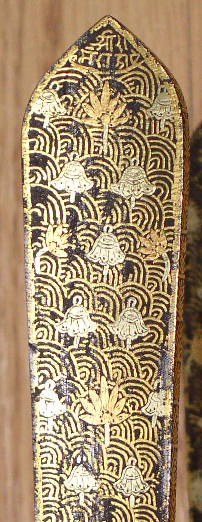

You have an old and very nice katar – congratulation. The midrib on the blade is the ‘Kundalini flame’ or the ‘Tree of life’ springing from a lotus bud.
I agree with RSword that the question about etching or not is a difficult one. You know what you have, but can’t be sure of what you will get. Normally, if the pattern is very week, I would etch the blade – but the decision is yours.
I am not sure that it is umbrellas shown on the side guards; my guess is that it is flowers, but I am not sure. Have a look at the picture shown, do you think it is umbrellas or do you think it is flowers? I think they are flowers.
It may be easier for you to see if I add the picture - sorry .

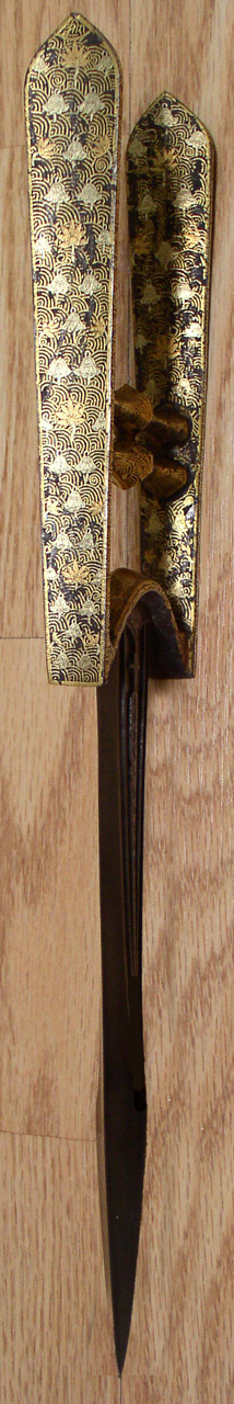

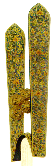

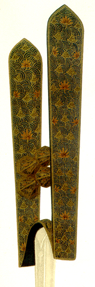

I remembered to have see the decoration on the side guards before in one of my books – but in which?
I started with Hendley, and in the second I found. ‘Damascene Work in India’ it is on plate 25. Here is what he writes about it.
‘Hindu thrusting dagger. False damascening in gold from Kotha, a great State, an offshot from Boondi in Rajputana; cost Rs. 50. Here gold of different tints has been employed with good effect.’
Using a magnifying glass I can't see that the two side guards can be closer to each other.
Even the number of flowers seem to be the same.
Sorry, I forgot, the book was printed in 1892.

Dear Jens; thank you so much for finding that photo of the katar in your book; it does seem like the same thing, except for the inscription at the top. The similarity is amazing! excellent detective work!
Dr Feuerbach- thank you for the caution. I will probably leave this piece as it is, since the wootz pattern is visible in some places, and it's in very good condition otherwise. I would be delighted to know about your etching process, if it's not a trade secret. If it is, I would be willing to trade for some of my secret recipes for curries!

Some may have wondered where the places mentioned are, besides being in India.
Rajputana is roughly coextensive with the modern state of Rajasthan, Boondi/Boondee is now called Bundi and Kotha is called Kota. Try the link below, and you will find Bundi and Kota in the lower right corner of Rajasthan. http://www.mapsofindia.com/maps/raja...travel-map.htm it is always interesting to know from where the weapon comes, and in the book Th.H. Hendley tells us, from where the katar in his book – Damascening on Steel or Iron, as Practised in India, comes, from this information, we also know that the katar shown in the book was made before 1892 – the year the book was published.
I will add the picture once more as I have lightened it, to make it easier to compare.

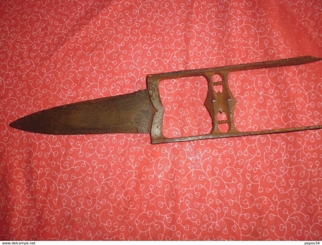

( I was looking for informations about etching blades on kattar daggers and found this post ... )
I have an old all rusty kattar with perhaps wootz/damas blade and with little gold koftgari remains on the handle.
I wonder if an vinegar-acetic acid bath will destroy the koftgari...
Any advice for clean it in the best way ?
Thank you

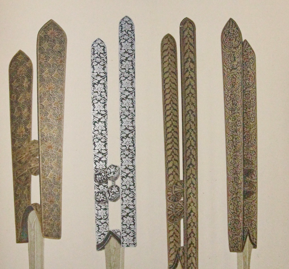

francantolin, I would clean the blade and etch it, to see if it shown any pattern, and then clean the side guards and the cross bar carefully, not to remove the remaining gold.
Montino, I hope you take good care of your nice katar, and I was surprised to see, that no one of us told you from where it is.
Hendley in his book Damascene Work in India, plate 25 writes that it is 'false damascening in gold from Kotah.
To me it looks like a Deccani kater decorated in the north.

I think it will be easier for you to see the difference of the katars if I show all four katars on plate 25. The three other katars shown are said to be from Delhi.
