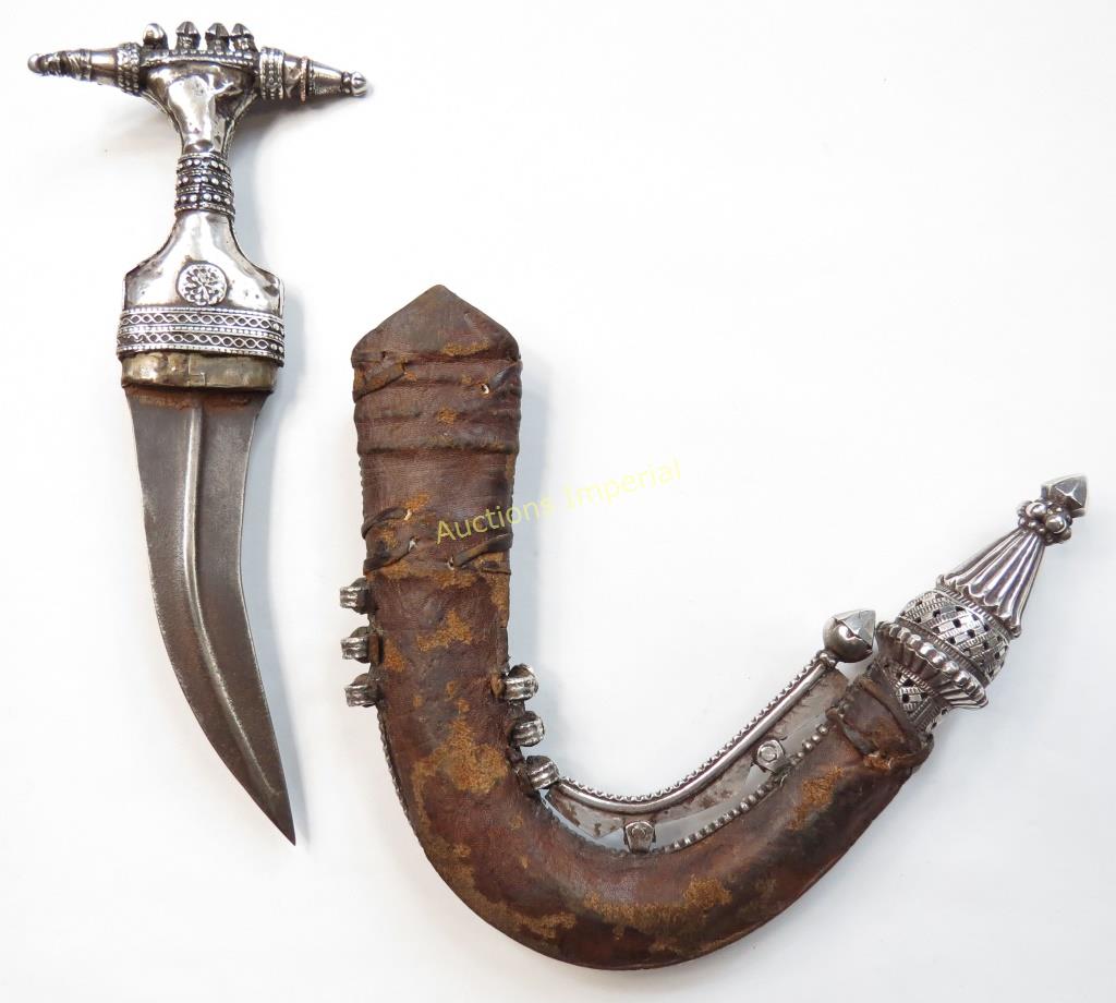

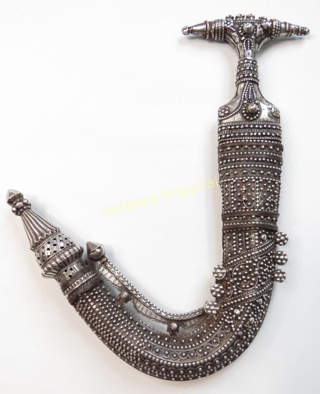

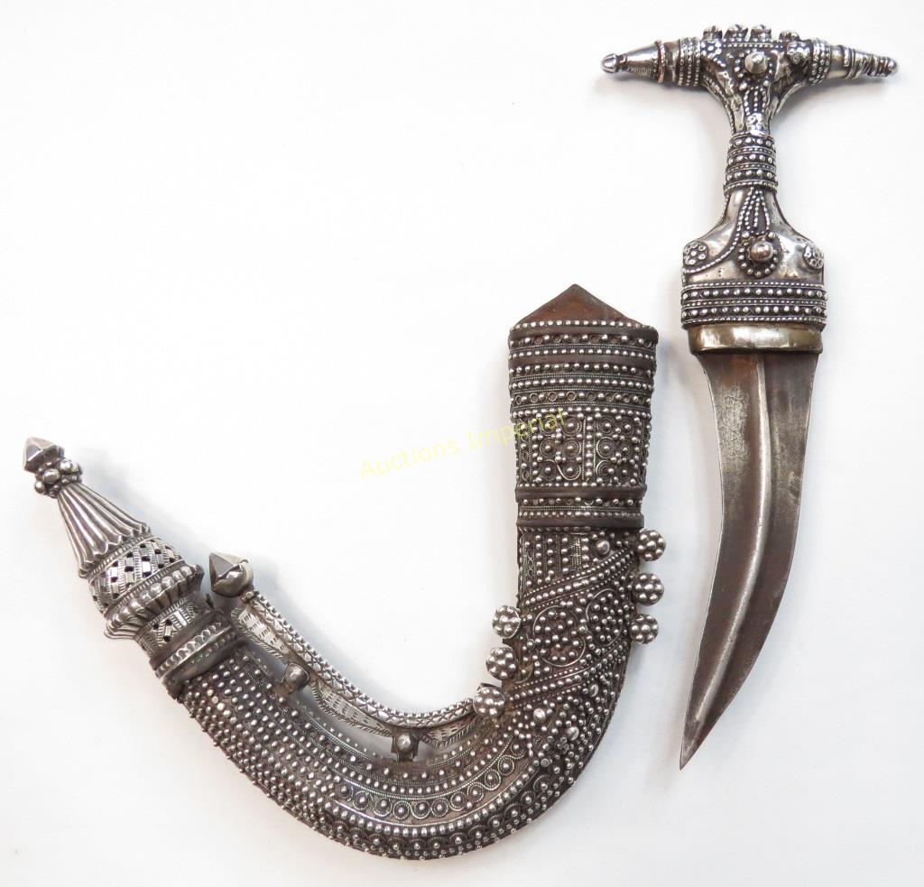

Yes this is out of my usual field, but I got this jambiya from Auctions Imperial recently. This is what I surmise so far:
1. It is possibly an Assib style jambiya.
2. This is a rare example.
3. It is from Asir in the northwest region of Yemen.
(These statements are based on Artzi's descriptions of 2 similar examples.)
4. Based on the filigree work, my guess is that this is from the early 20th century.
I have been looking for a good and complete example of this for many years.
What are your thoughts and insights on this piece? (Zukran in advance!)

Here are 2 of Artzi's examples of similar jambiyas that he attributes to being Assib style and from Asir in northwest Yemen. Notice how the top one matches mine almost exactly. Both are made of silver.

Very nice jambiya, congratulations. Gracie shows a very similar jambiya on p.130, described as Zabidi, from an area 50 km south of Hodeida. So not from Asir, but further south along the coast.

Very handsome piece. The blade seems a bit worn down at the edges, but I can't really tell from a photo. Small relative to its furniture; is that typical?
What was it that set you to search for this particular example, outside your usual area of interest? Filigree work, perhaps?
Artzi places his comparables firmly in the 20th century. Are there earlier similar examples?

Bob, yes it was the filigree and the "T" hilt. However some styles of these I never liked because the "waist" of these hilts were to thick. This piece has a thinner hilt midsection, which I like a lot.
Other similar examples, well yes, but not much info in the sources I have seen so far. I must confess though that I don't have extensive sources.

Oh and yes Bob - the blade is worn (and not a 2 ply welded newby) and this is typical of some of these pieces. I once had one I think from Oman, newer made (looking back). Even then, the scabbard was much larger than what was needed for the blade. However, I have only seen this feature on Arabian pieces and pieces from Sudan (if I remember correctly) where the scabbard is upturned at the end.

Another thought. For me chasing is much easier than filigree. Filigree is hard enough, but THIS level of filigree is insane!

It has been brought to my attention that I forgot to mention the granulation work as well as the filigree work. One more reason why I like this piece!
